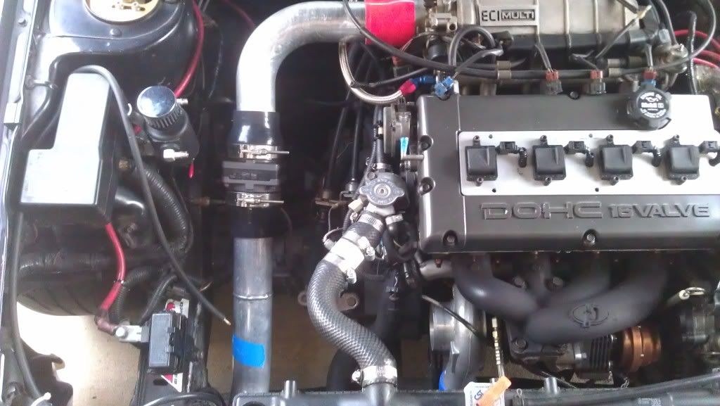

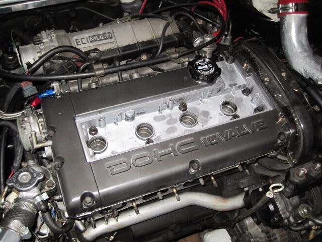

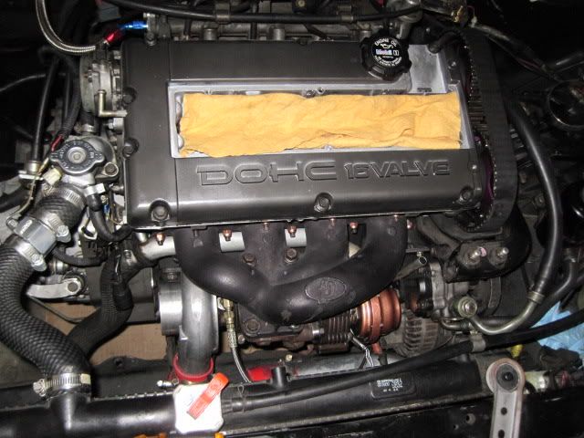

Wifey, my son and my little baby girl all fell asleep...so this gave me time to work on the GVR4 and finish up its new oil catch setup. Had the welding work done at Kings Performance in Orlando by a guy who is big on DSM's. Looks like I am going to take Stitch there to get a couple things done. Also got a new Hyundai VC wrinkle coated with all new Hyundai specific VC Gasket and spark tube gaskets as they are slightly bigger than the Mitsubishi gaskets as i was having a oil leakage from the VC with the Mitsubishi OEM gasket. I also had my coolant temp adapter welded to the thermostat housing to eliminate a source where coolant can leak.

Ryan...I used this stuff. Pretty simple to use and apply. Just make sure the surface is prepped nicely and let it cure and it will hold up. While changing the spark plugs the socket came off my wrench and hit the VC and the paint didn't chip.
VHT Wrinkle Plus coating
I got it from a local Race shop while purchasing some AN fittings, but I believe some Pep boys or Autozones may carry it.

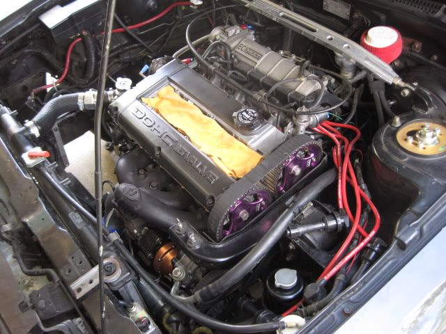

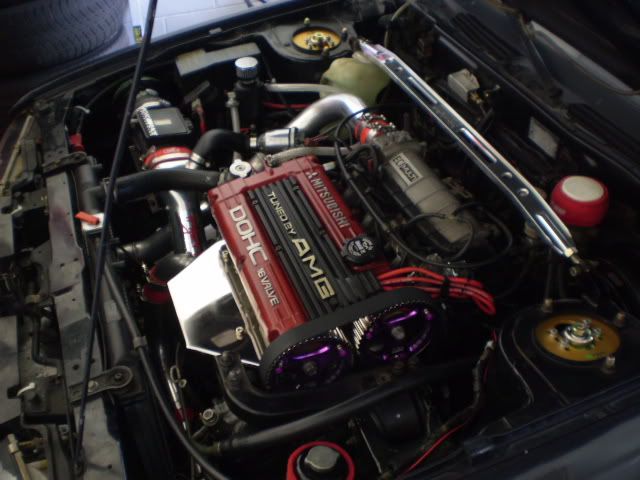

Bored at work..so decided to add some "prequel" progress pics. /ubbthreads/images/graemlins/crazy.gif
Taken in 2006 when AMG wing and Evo Enkies were installed

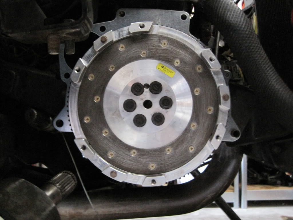

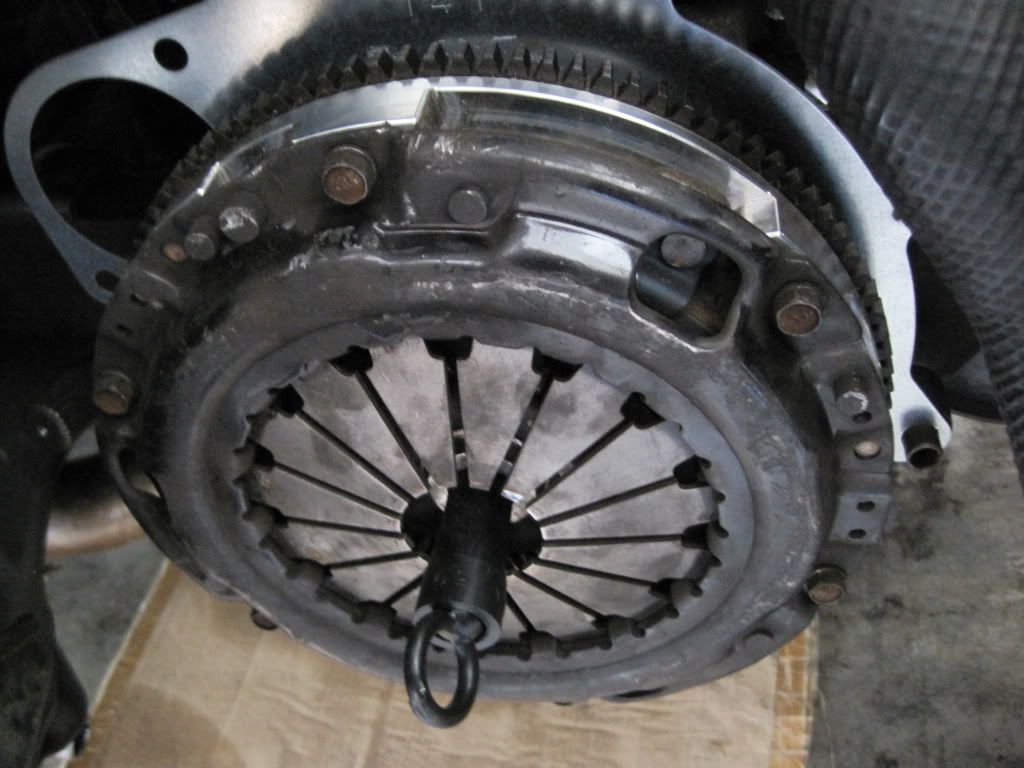

Fidanza 4.3 Clutch kit with flywheel

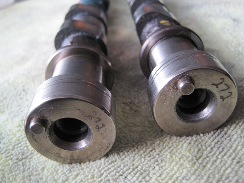

DKS 272's

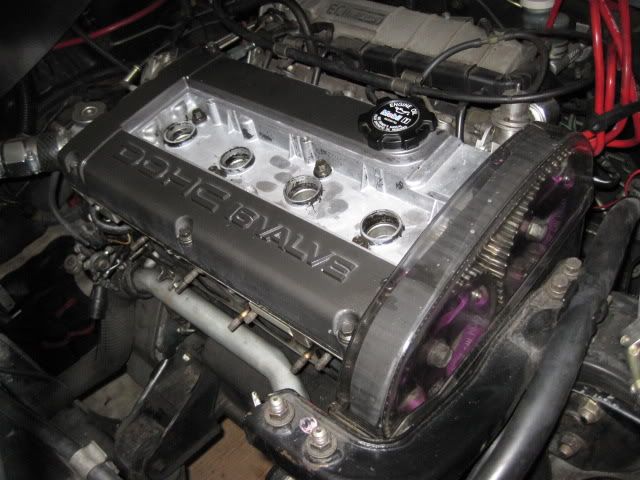

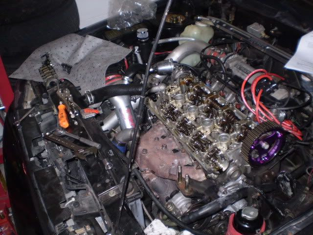

After installing the cams..switched to a Hyundai VC with all hardware and Hyundai gaskets.

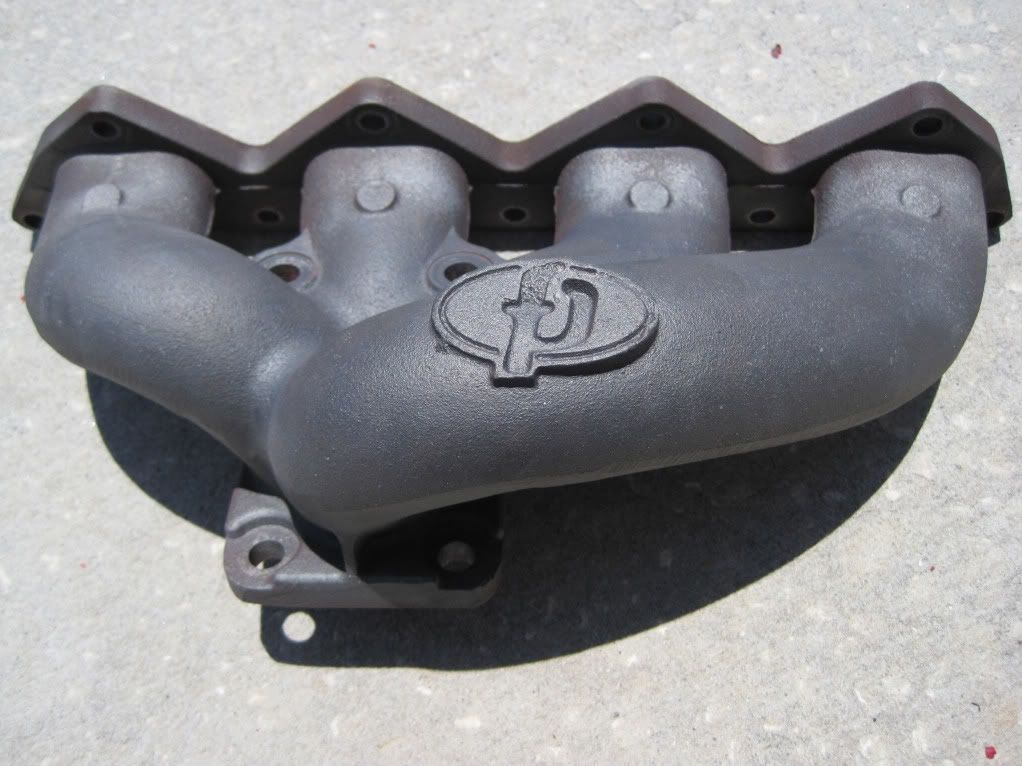

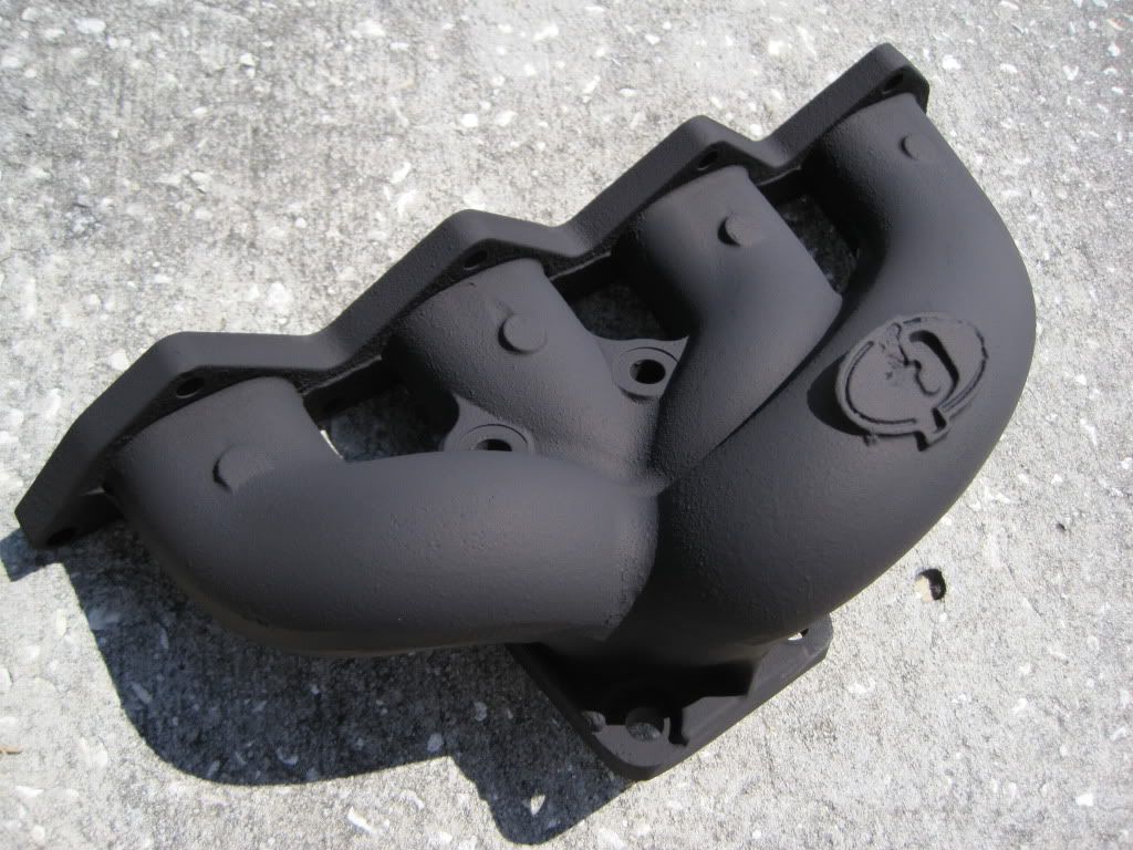

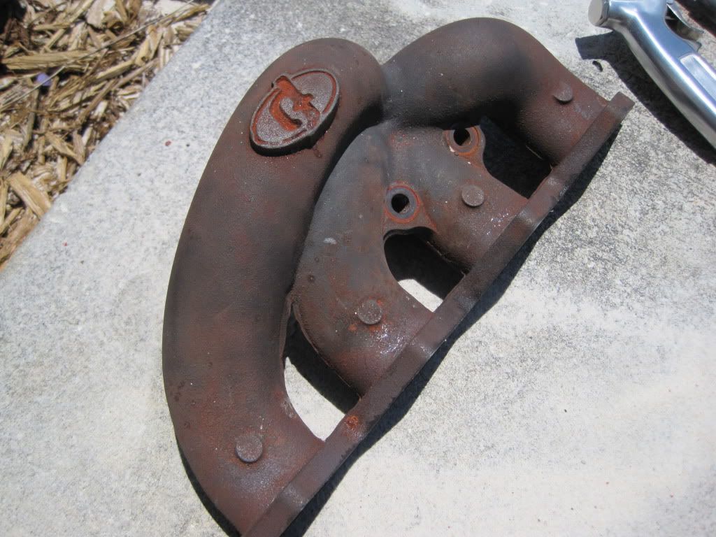

Some Before and After pics of sandblasting and coating the manifold and misc brackets under the hood from surface rust.
TRE transmission reinstalled and freshened linkage hardware.

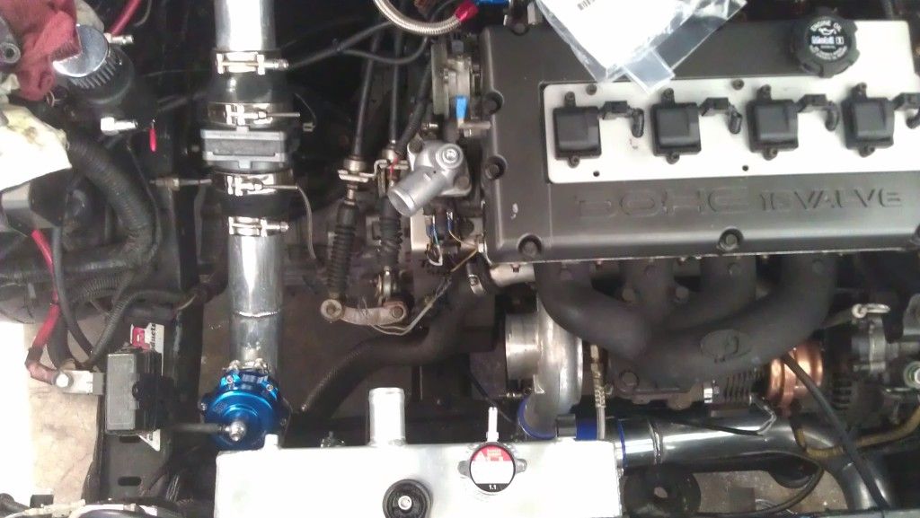

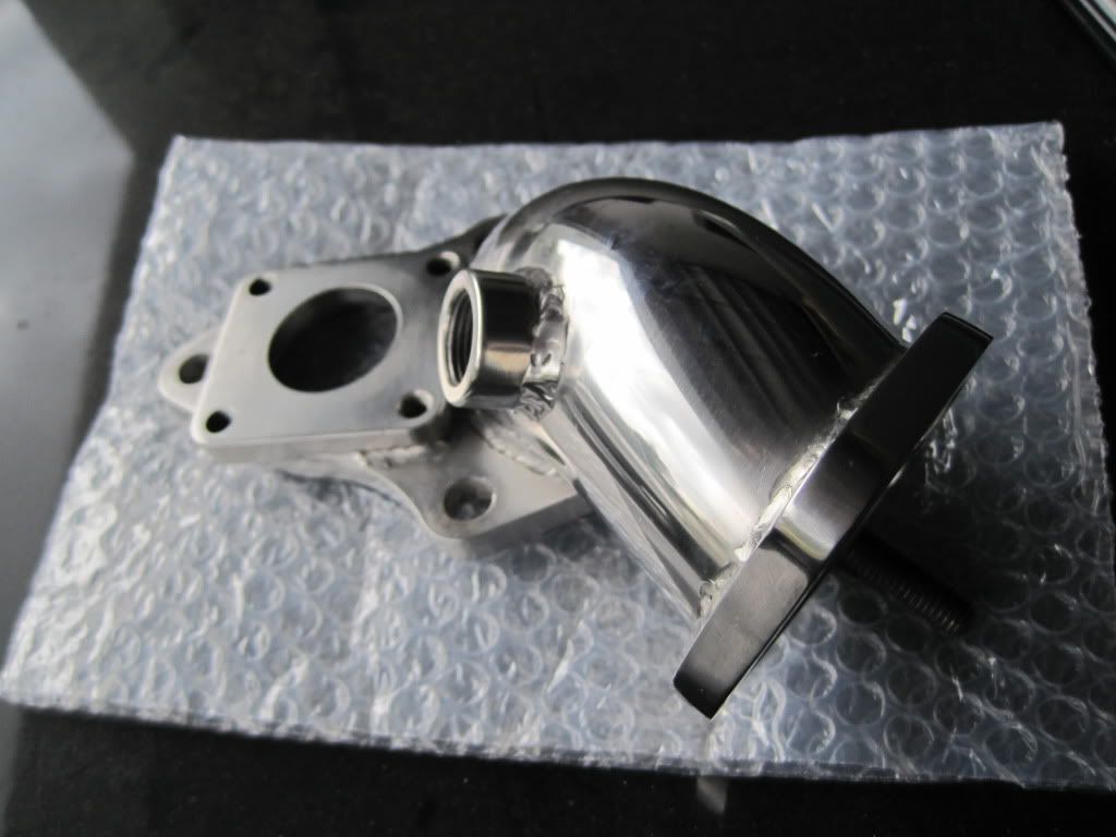

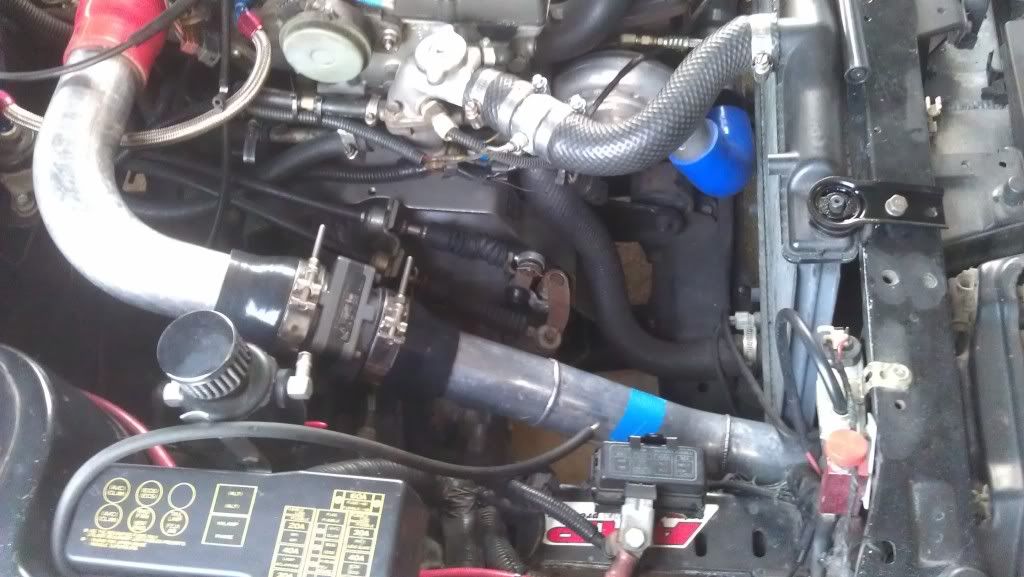

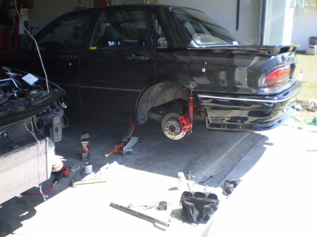

Marking where the GM will sit and where the new Tial bov and flange will be located for welding.
All done

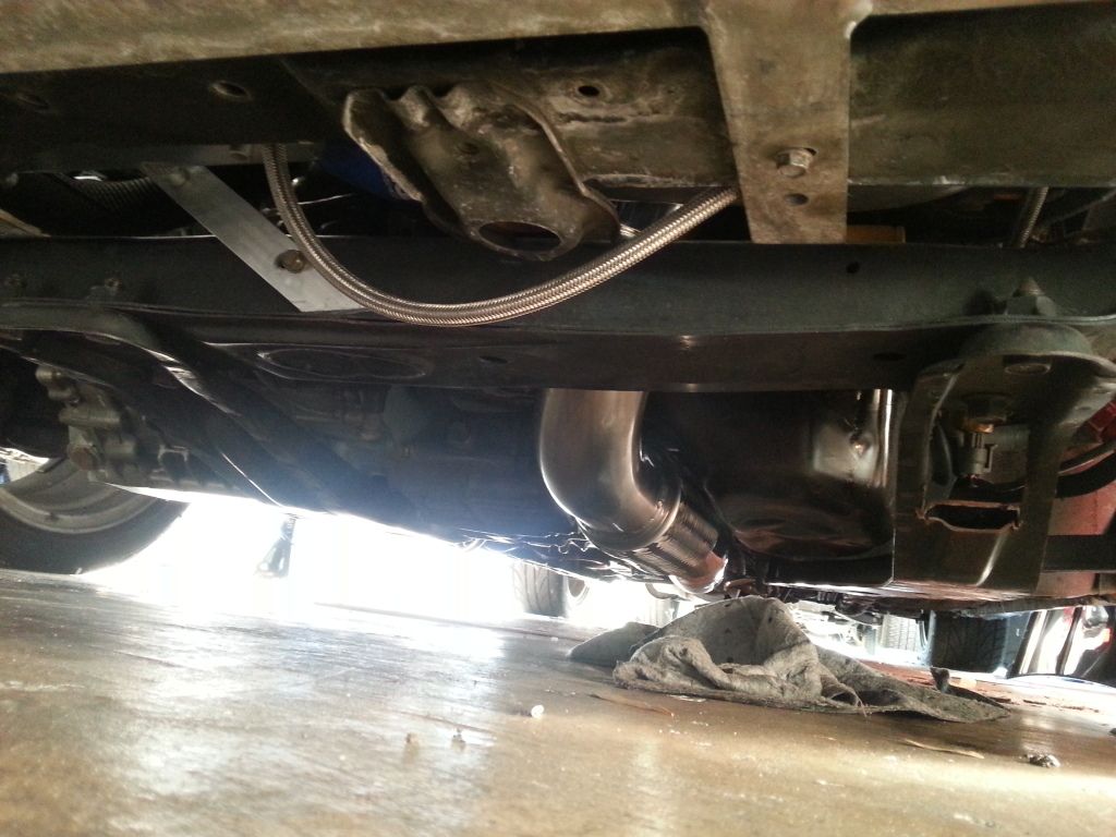

Well after 7 years JSBing going through a rebuild and upgrades..1948 finally went on public roads so I can finally finish the exhaust after changing a few things up. Car still have a few kinks to work out and a couple more things I want to upgrade but felt damn good driving it again.

Looking good, except foe that muffler. That manifold coating doesn't look like it's holding up either /ubbthreads/images/graemlins/grin.gif

Yes..you are right G about the manifold coating not holding up. I used some VHT stuff several years ago to coat the manifold when times where tough and getting it ceramic coated was out of my budget. One of the things I am planning is to get it ceramic coated.

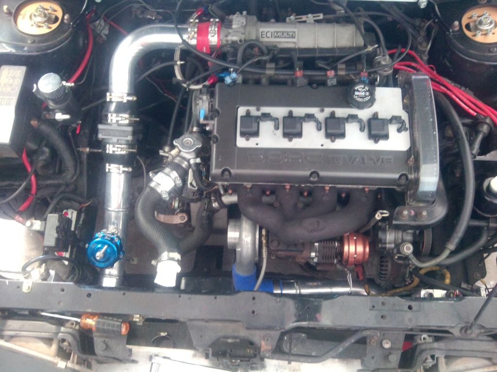

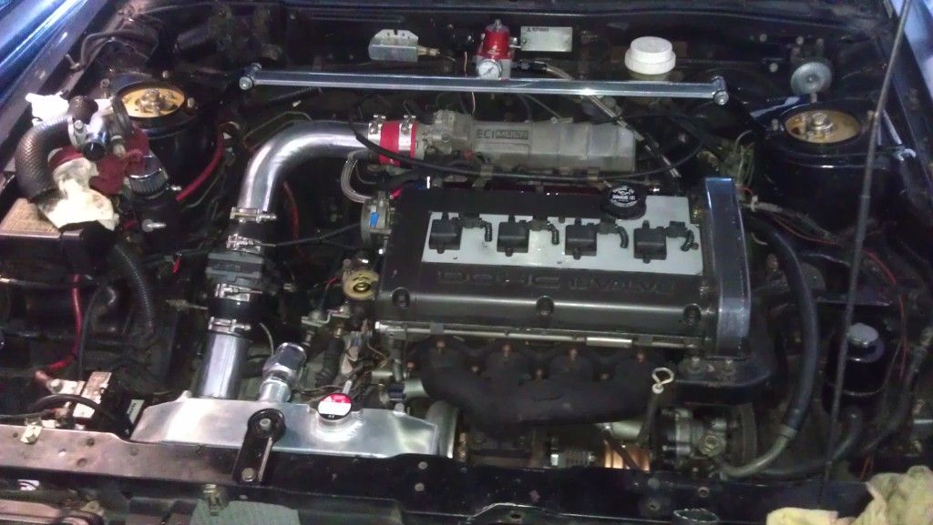

Wanted a more unified color scheme in the motorbay so I got the COP plate and intercooler piping painted matte black. Replaced the broken Zanklee clear cam cover with a HKS one and installed a RCI billet fuel rail and finally tucked my throttle cable.
Now the Magnus Black cast intake manifold is calling my name more than ever. /ubbthreads/images/graemlins/crazy.gif
