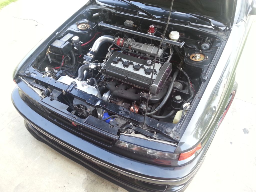

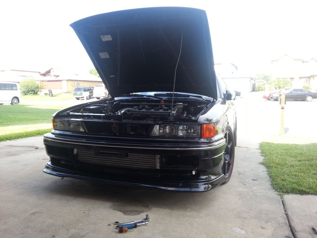

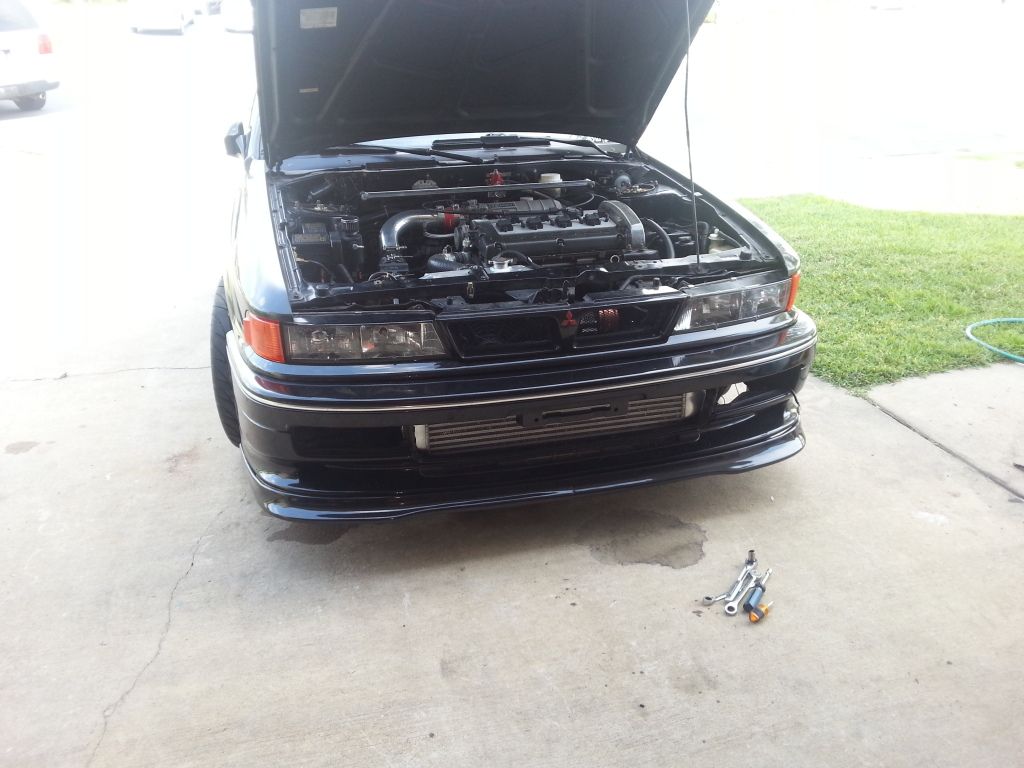

Well after I got the Gvr4 running again...I had to repair a massive coolant leak on our Montero and the A/C compressor for my house decided to take a dump too. Been staying at my bro in laws house till I got the compressor replaced on our a/c unit and fixed the Montero. Luckily had the weekend off so decided to put some work on the GVR4.

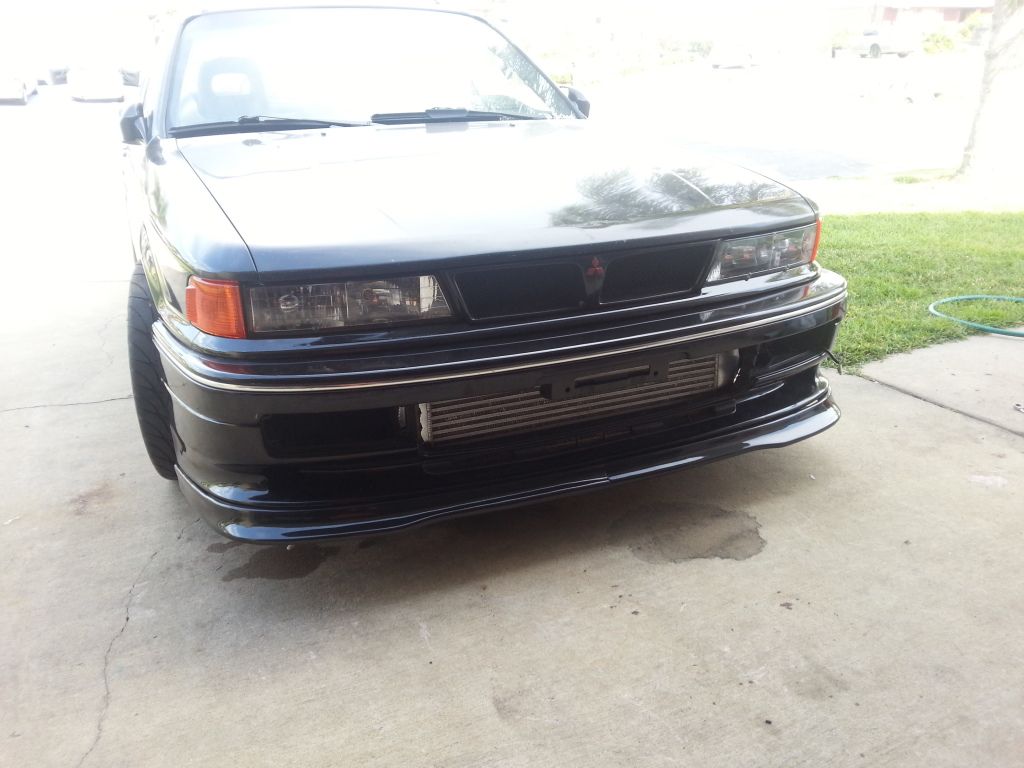

After I got it running the main issues I had was it wouldn't idle on its own and it had a misfire and wouldn't rev past 4k. I finally had some time to diagnose the issue and finally install the front bumper, my BoostX front lip and AMG corners and rewired the bulb sockets for dual filament turn and driving lights.
Now with the idle and misfire issue and not able to rev past 4k....well found out the black ground pin on the MAFt plug was not making full contact to the Galant harness plug. Once I pushed the pin in..the car ran better and it was attempting to try to idle on its own. After messing with the settings on the MAFt and adjusting the BISS and CAS timing I got the car to idle on its own constantly. It needs more fine tuning but for now at least its idling.

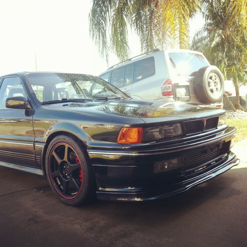

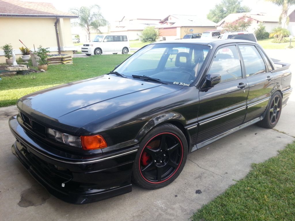

New wheels BBS RX 17x9 +28 offset
Currently on Dunlop Direzzas 205/50/17 but going to swap to 235/40/17 Dunlop Star Specs in a couple months
Pics taken and edited with my Samsung Galaxy S3
GVR4ZUM
Jul 8, 2002
1,455
SoCal, USA
Looks real nice with those BBS wheels you picked up from DC_Style, I like them if only they were 4 lugs... /ubbthreads/images/graemlins/frown.gif
11,993
You're gonna need a lot more camber once you go to a wider tire. Those are good looking wheels though. /ubbthreads/images/graemlins/smile.gif
