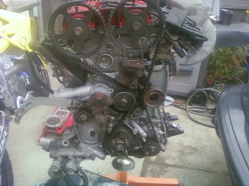

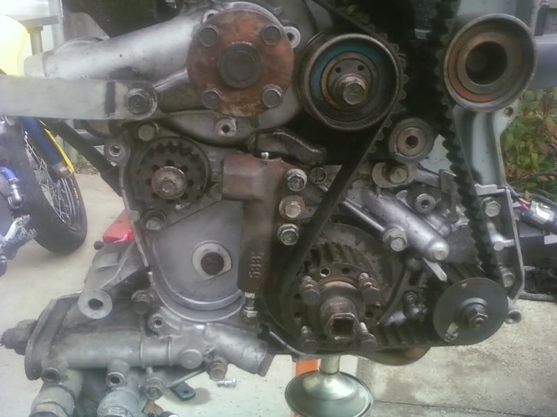

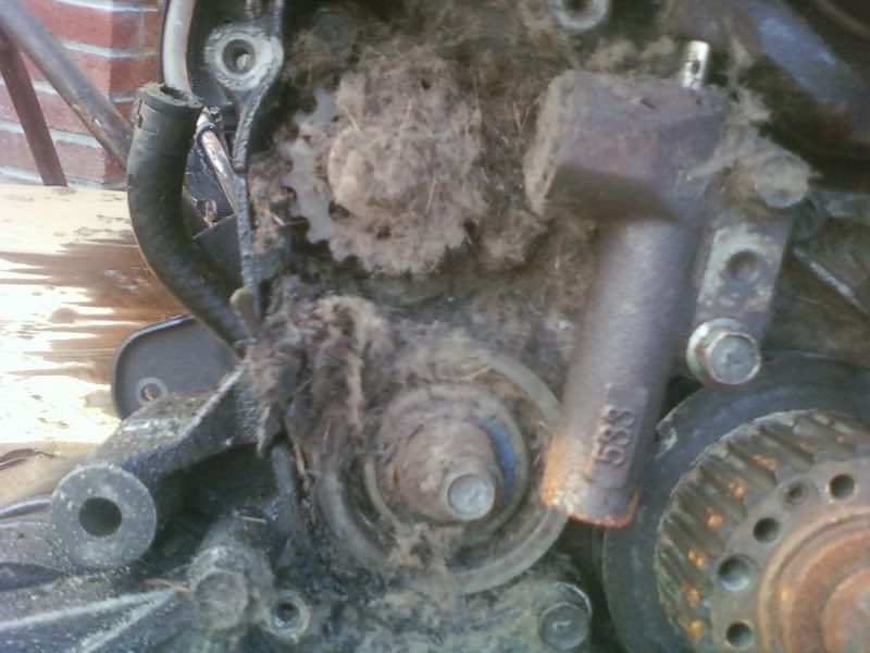

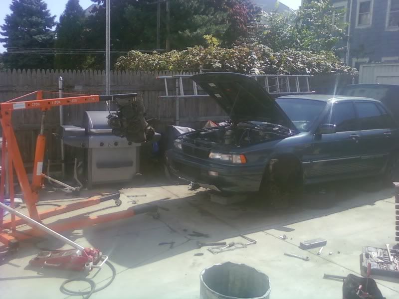

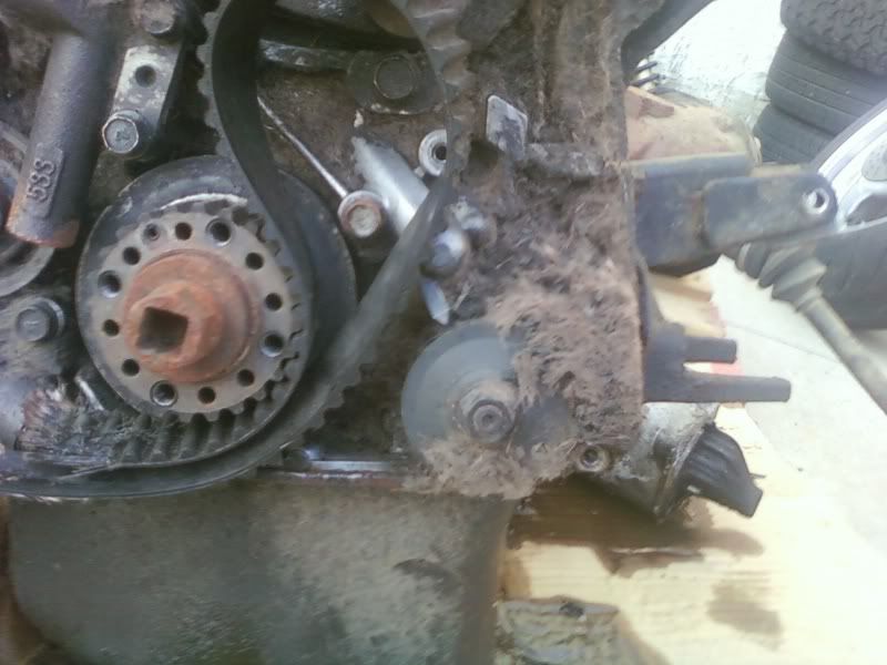

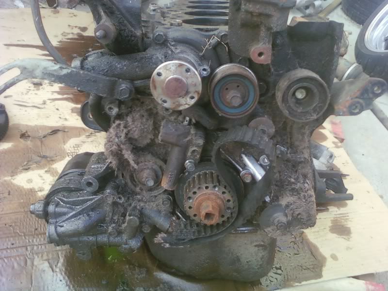

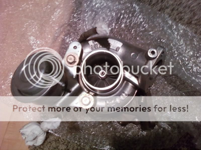

well i have updated in a while, my T-belt snapped last april. its been sitting all summer, i started working on her again 2 weeks ago. here's a pic of how the motor looked when it blew...

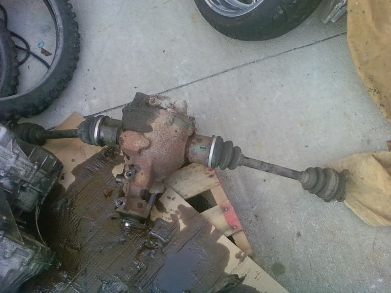

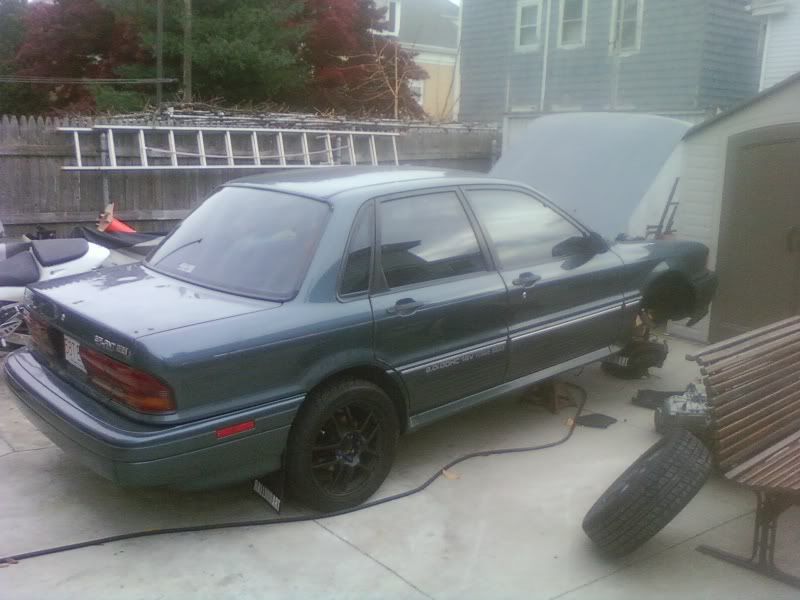

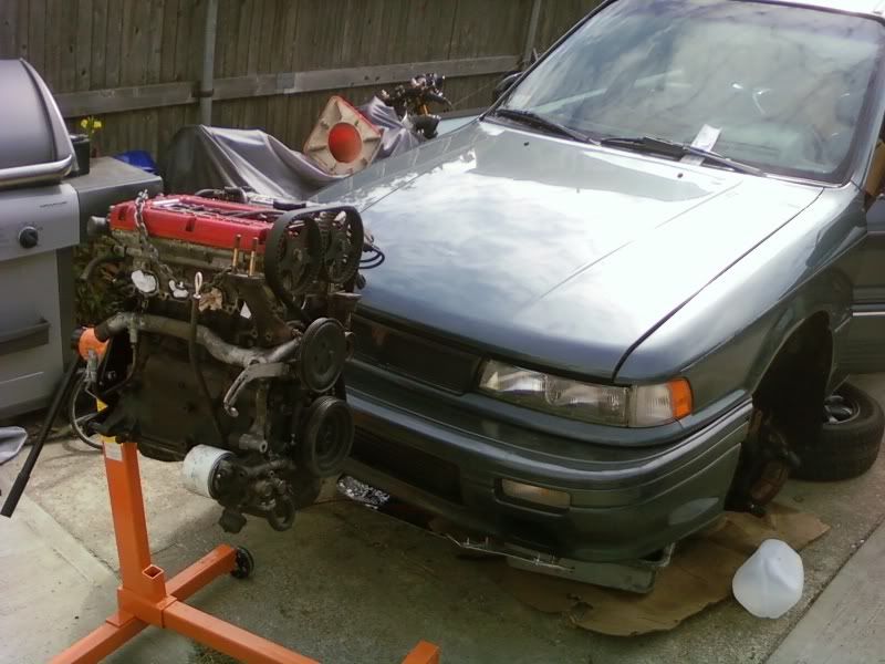

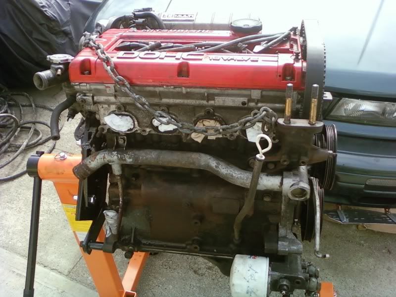

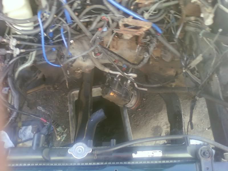

Ok so i been doing a lot the last week, i bought the 92 tsi donor car, both motors got pulled from the cars. i pulled off both trannys and clutch/flywheel setup, i removed the 4-bolt rear from the talon, 90% done removing the galant rear, 1 more bolt, it was a pita so i moved onto something different, start back fresh on it today. the motor is pretty clean looks like it had a fresh head job recently, and even some freeze plugs on the bottom end, new Gates t-belt and OEM water pump, even looks like a new oil pump front case.
turbophein
Feb 17, 2009
683
mass

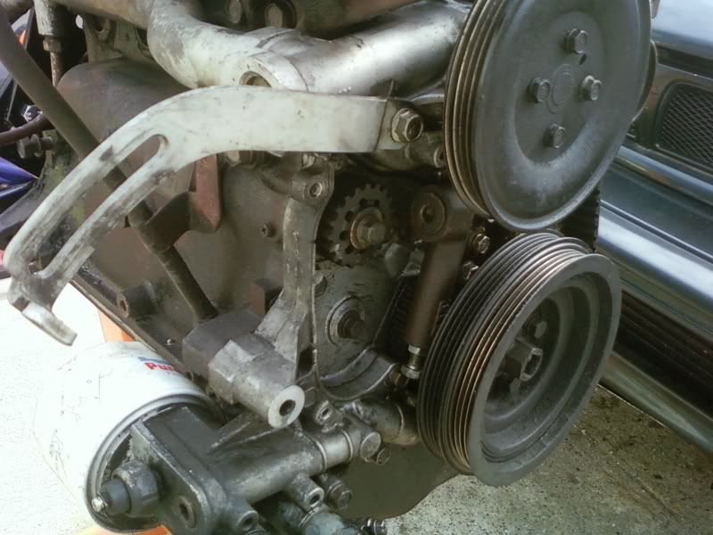

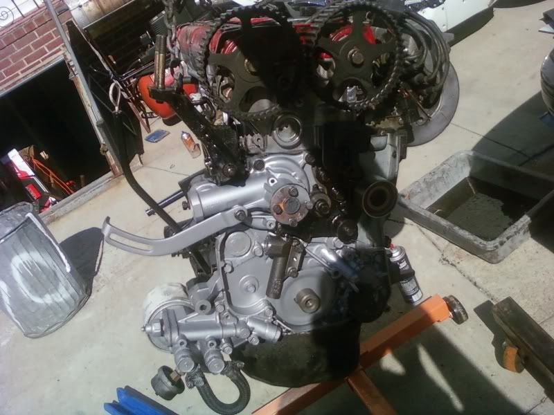

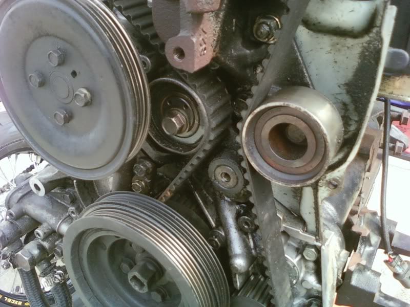

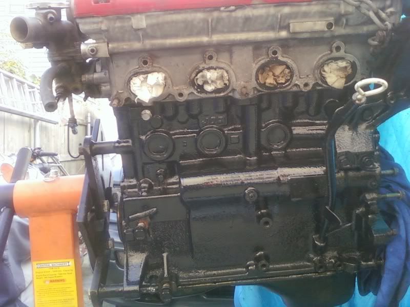

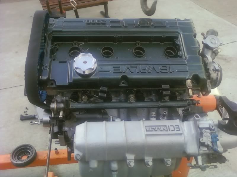

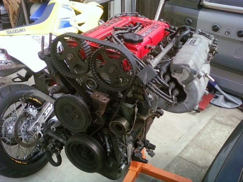

ok so i been cleaning up the motor all day here are some pics from before and after
turbophein
Feb 17, 2009
683
mass

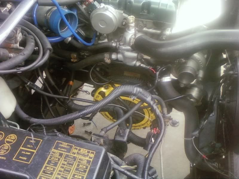

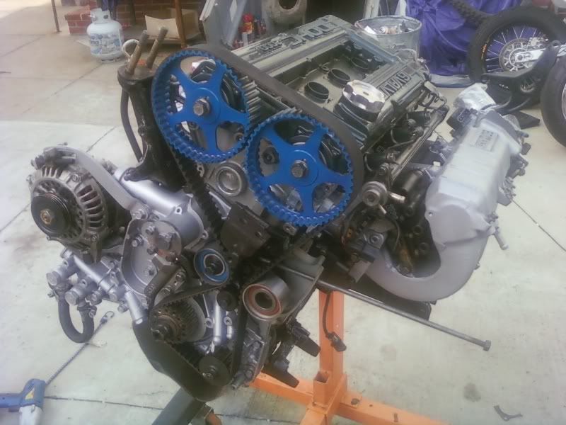

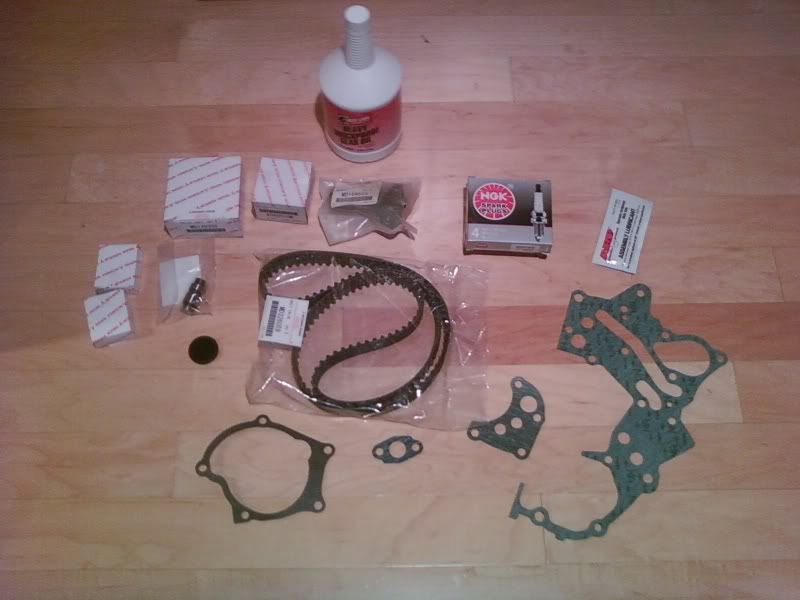

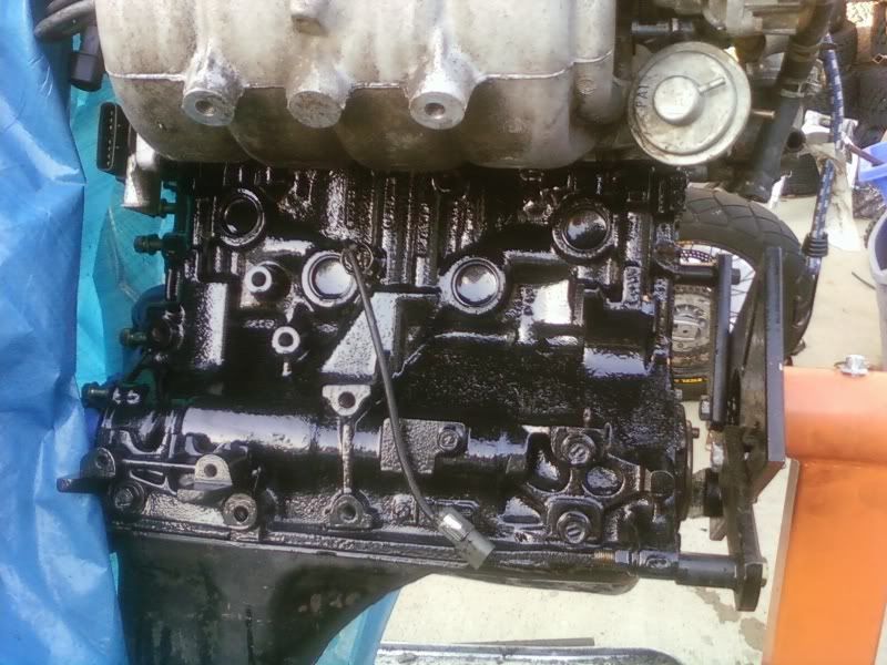

ok so here is what i have been doing.
After degreasing the engine...
POR 15 the block and brackets

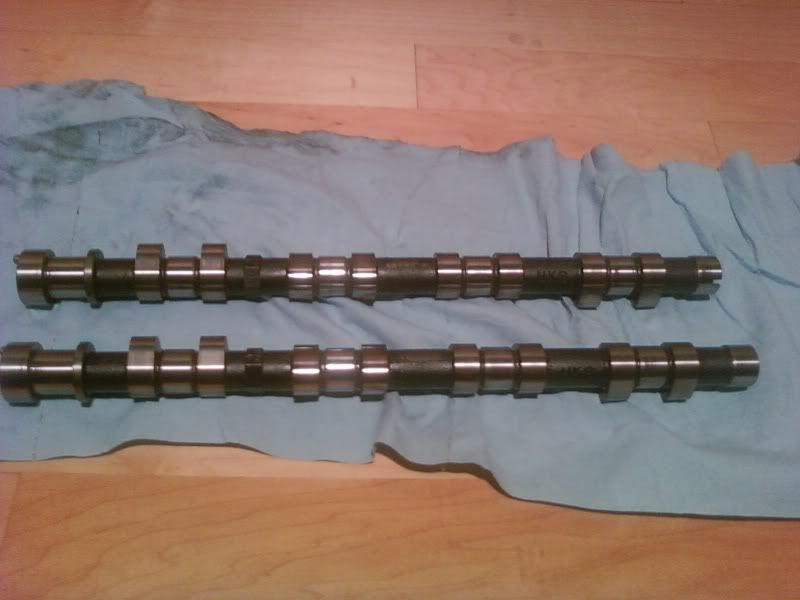

Installed HKS 264/272
Installed 3g Lifters

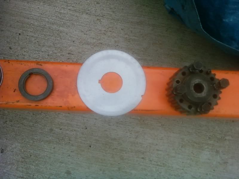

Installed BSEK used a mirage spacer instead of BS sprocket
all new gaskets (except head gasket)
All new OEM timing components
POR 15 the engine bay rust spots

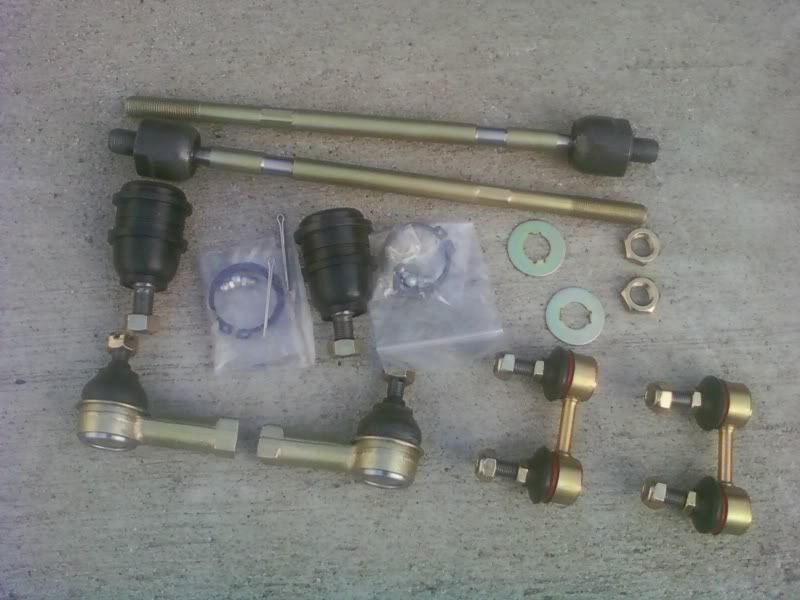

Installed, new ball joints, tie rods and sway bar links
cleaned and painted everything

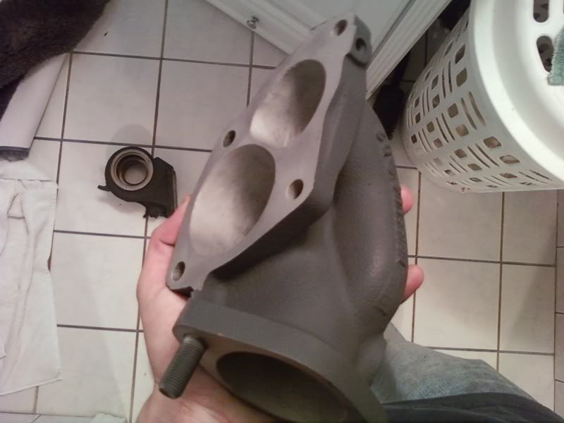

installed my IM after cleaning it out good (so much crap in there) same with the intake ports
here is some pics

look at my under hood pics a couple posts up, the blue should all tie in nicely, and it won't even be seen until i get a clear timing cover

Quoting salisbury:
how does the color matched valve cover hold up to heat?
Held up fine! no problems. this thread needs a update! will do it right now...

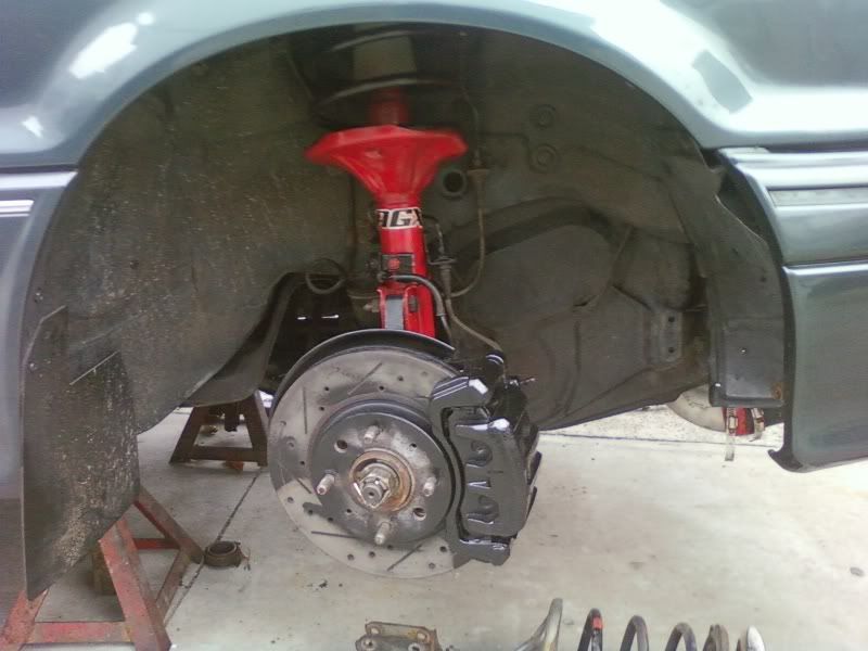

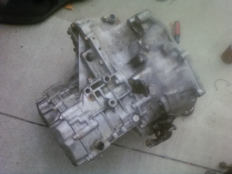

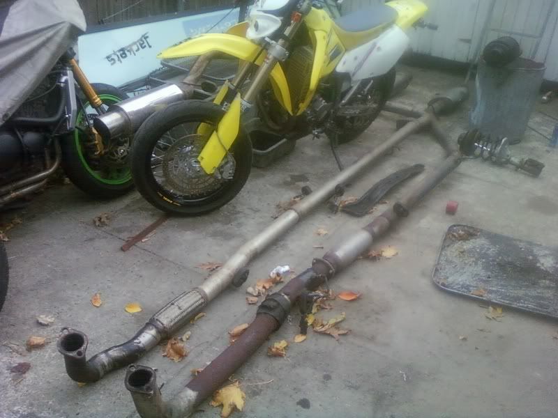

Ok so there has been a bunch of stuff going on since my last update, i have been installing a bunch of goodies from the parts VR4 i bought, saved lots of money this way!

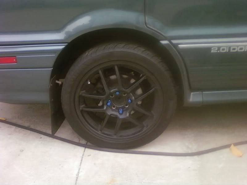

Ro-Ja Light Weight Wheels 17x7 34 lbs each with tire, the blue lug nuts are being replaced with black ones, before you guys start commenting

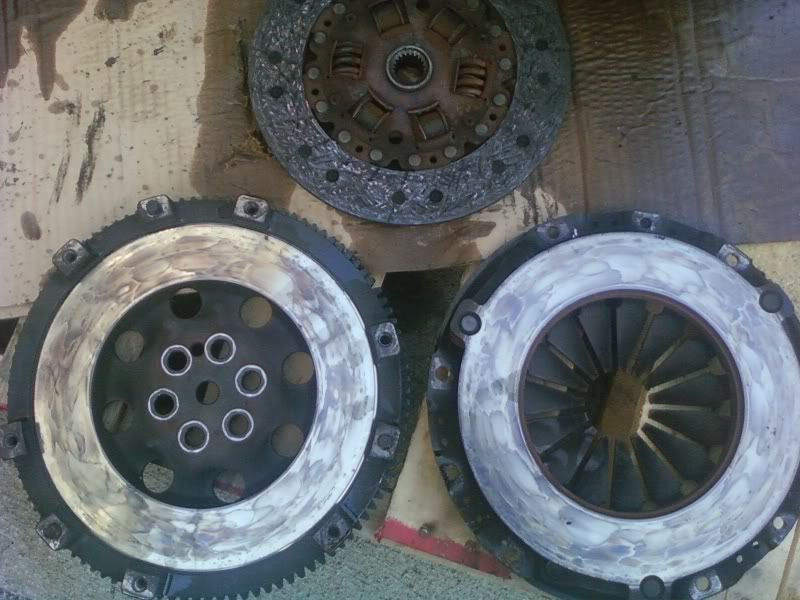

ACT 2600 Clutch
Used Shep trans
KYB AGX's
way better/newer exhaust
nice J-Pipe

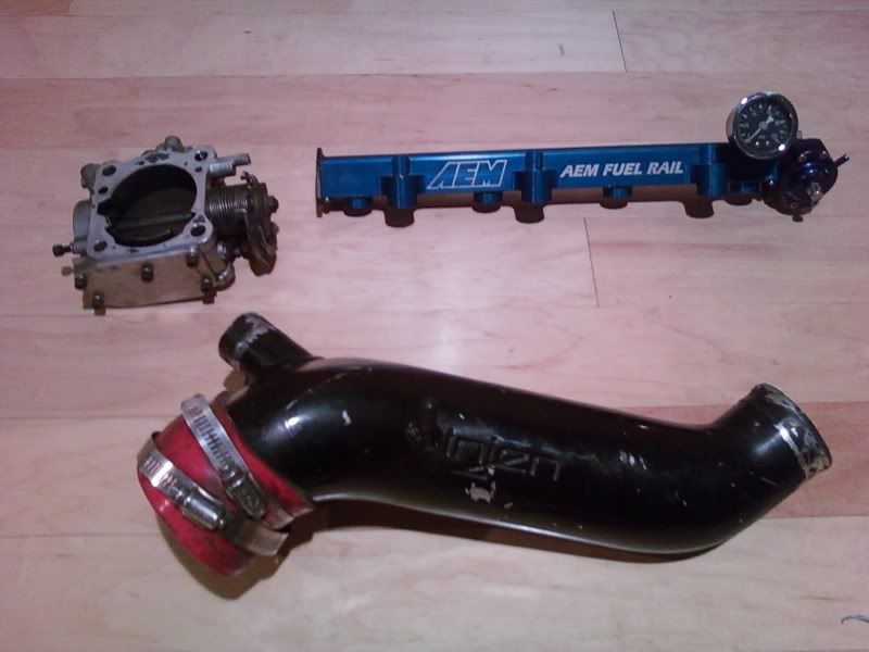

a couple months later, i have a bunch of new parts that i need to install.

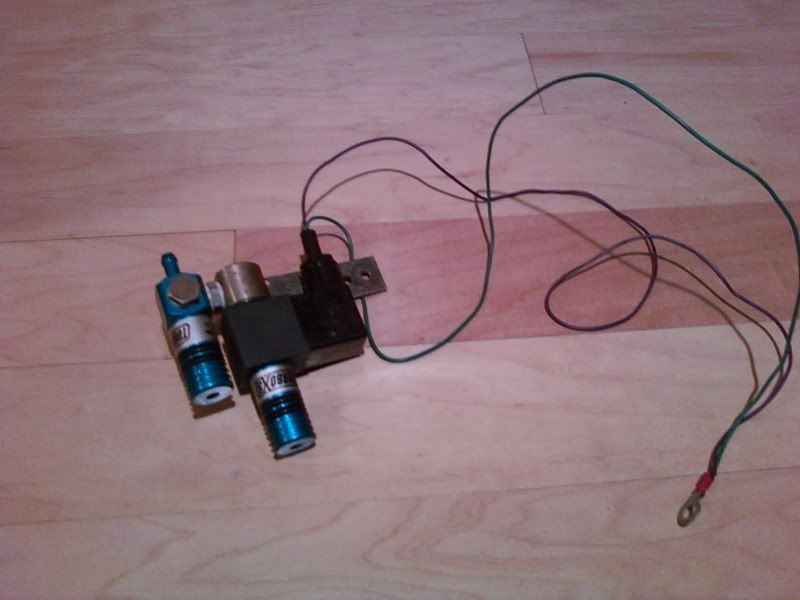

i got a dual stage Boost controller
AEM Blue Fuel Rail, gauge and afpr
Real injen 2g Intake that i need to take the paint off
Rebuilt TB
FP Manifold (being ceramic coated with a 7cm hotside)

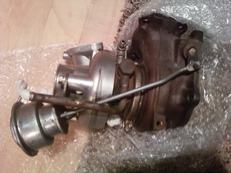

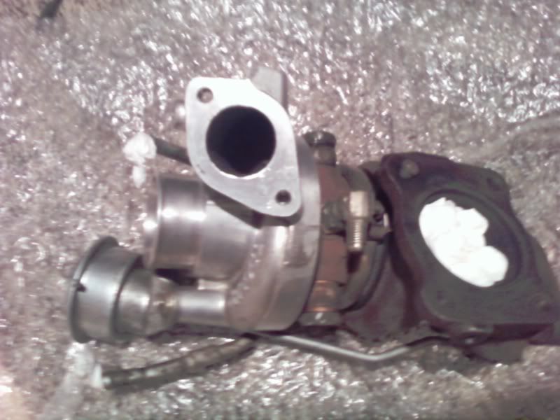

Like new EVO III 16g Turbo

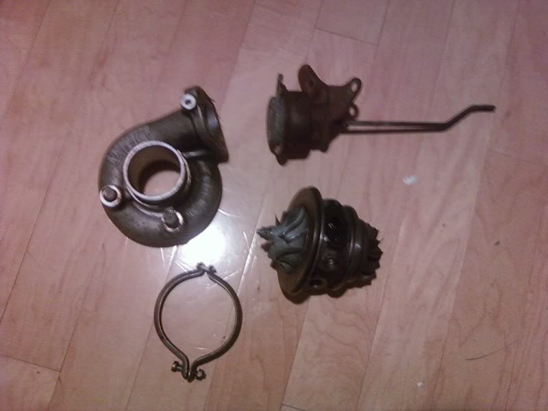

I also got a FP 18g cartridge and hotside, sent out a stock compressor housing and Cartridge to FP and got it machined for the 18g and checked for play. well within specs.
Blue spark plug cover (plan on making a vr4 plate to cover the Hayame probably my vr4 #, also the valvecover is going to be painted a wrinkle semi gloss black)

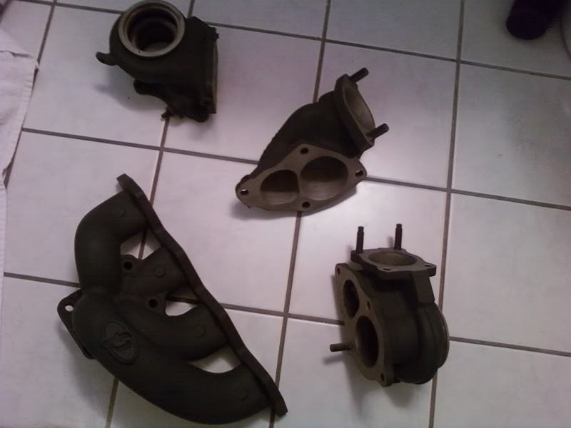

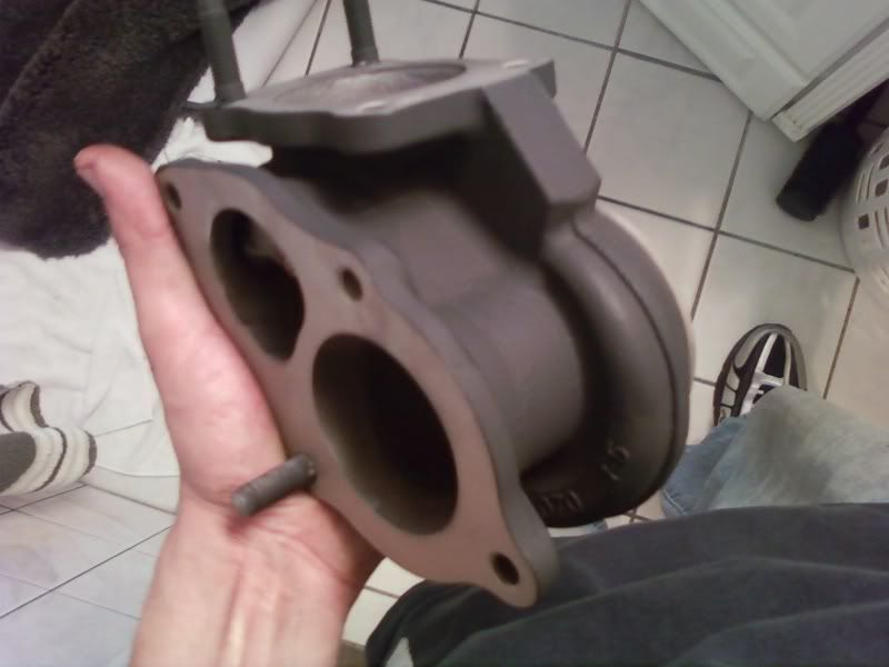

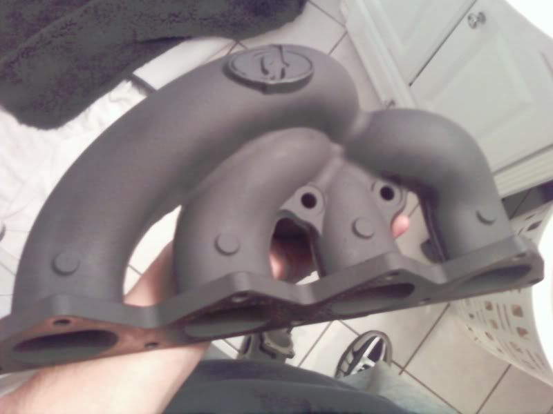

just got this stuff back a few days ago, and have been doing some stuff the last couple of weeks.
i just got my turbo parts back from the ceramic coater they look great, can't wait to get them on, they all look new again! i had both the evo 16g and 18g hotsides coated, i don't know what i want to use yet, most likely the 18g.

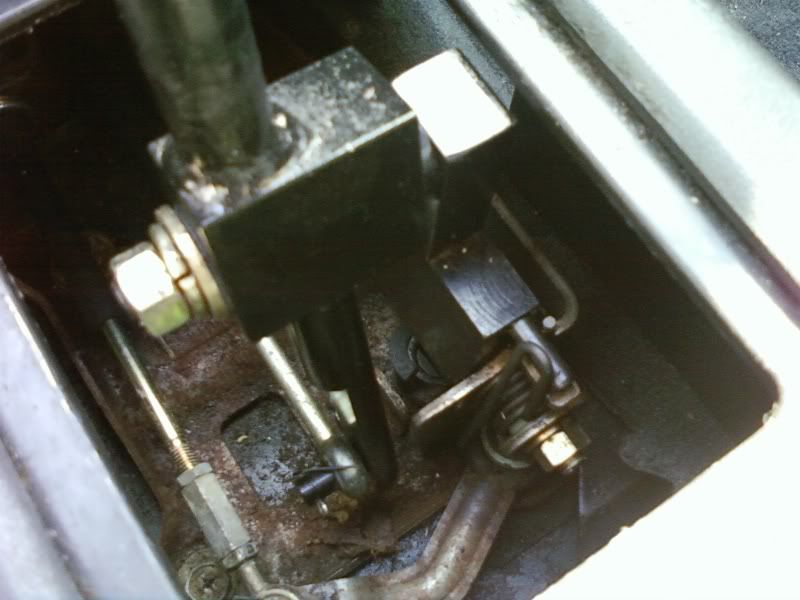

i also been tearing into the galant like a mad man, dyed the headliner and visors Black, installing a oil cooler with earls fittings, new boost controller, new temp gauge, new oil pressure gauge, replaced my dash with a nicer one (not unglued) new shifter bushings, got a FP 18g Turbo, swapped out the interior for some nicer/softer seats from my parts vr4,found some type of short shifter, and pretty much a lot of cleaning up, tucking wires, make everything legit!

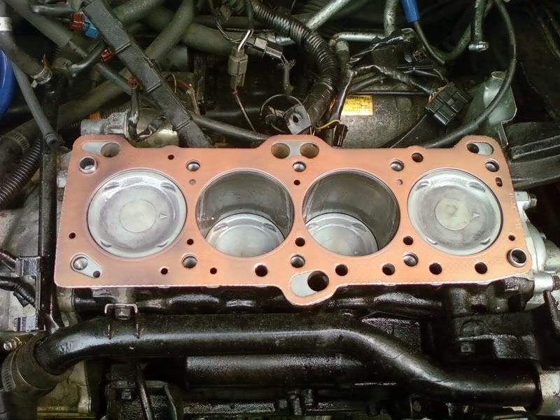

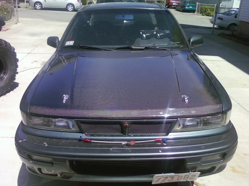

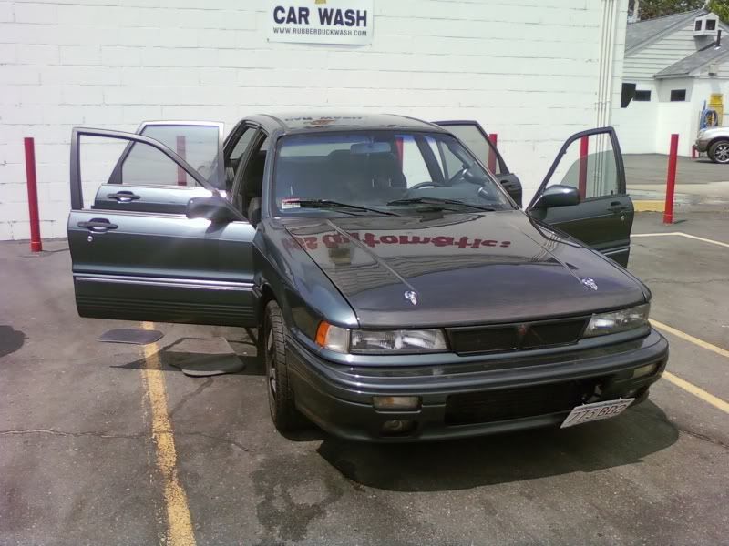

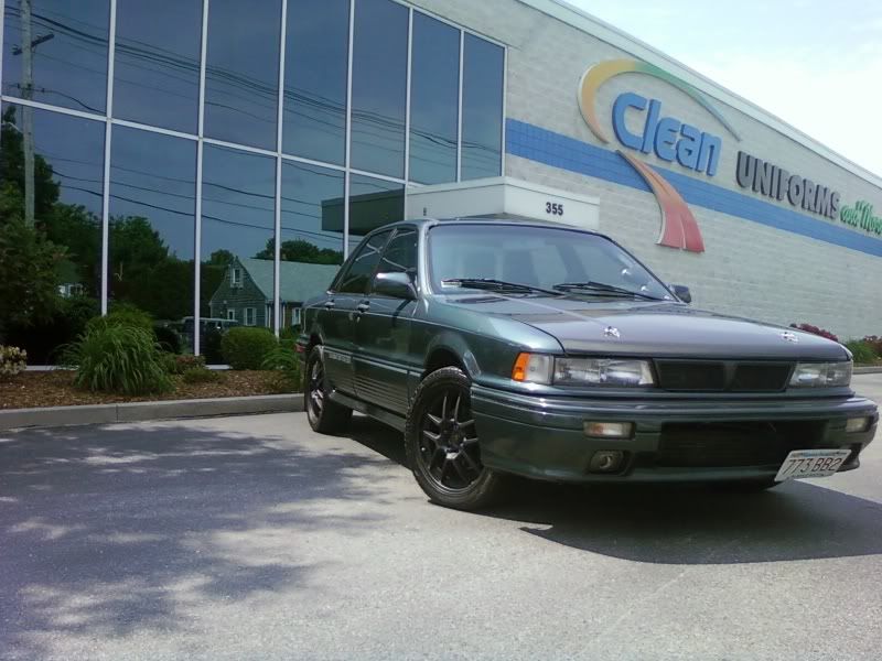

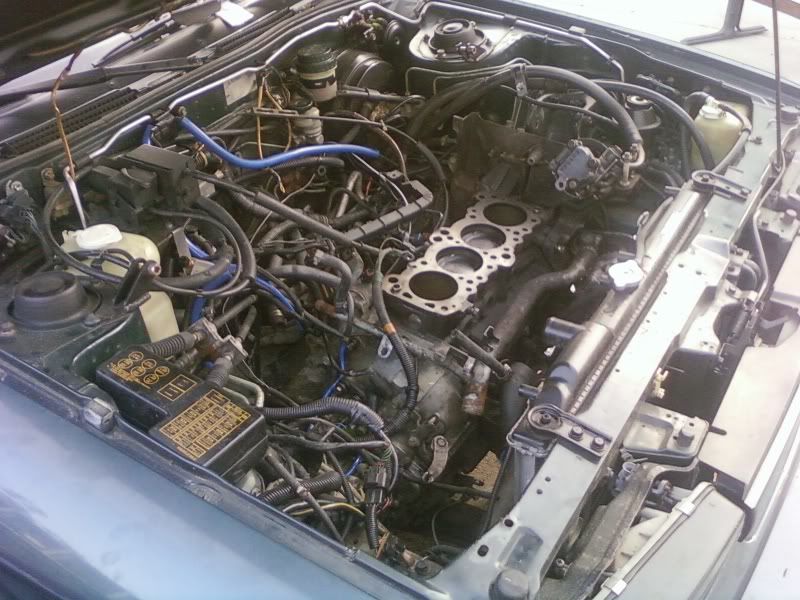

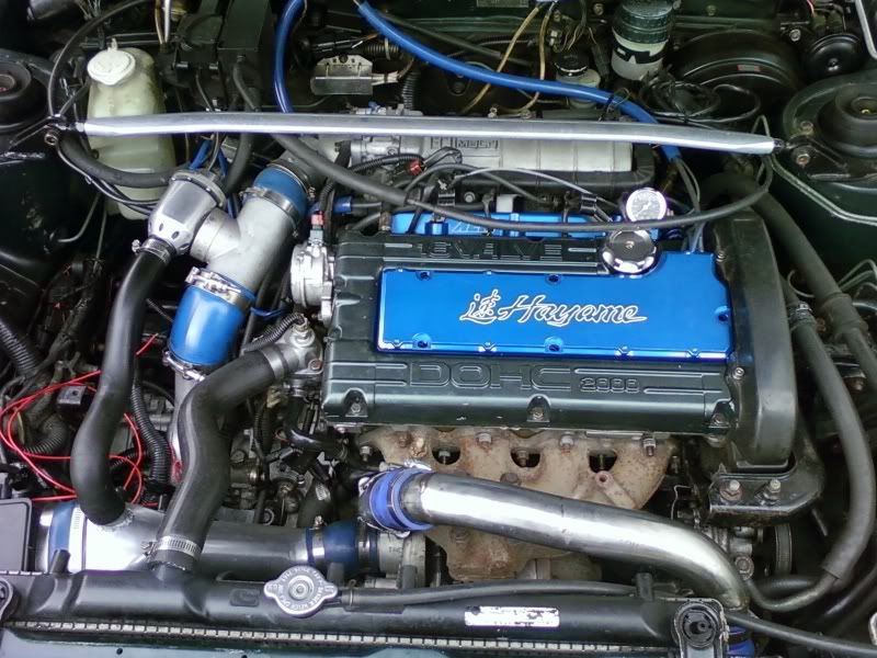

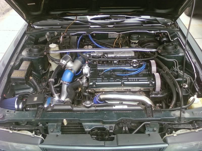

well after figuring out i had a broken ringland, i rebuilt the motor. was fairly easy to do inside the car/engine bay. new rod bearings, piston & rings, hone'd the cyl's, copper manifold gasket, and a oem headgasket. i also bought a carbon fiber hood. the car runs great so far, i have almost 50 miles on it. i cleaned it up and took some pics
