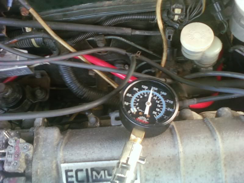

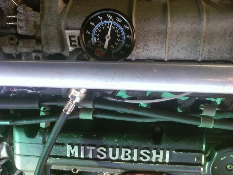

did a compression test with a autozone rental??? i know... but this is what the readings were #1-130 psi, #2-135psi, #3-135 psi, #4-145 psi. which i think is great considering, the tester was leaking a little and i was doing it myself, i was running back and forth and i could see it going down every second, so i figure i can add at least 5-10 psi to those numbers heres a couple pics.

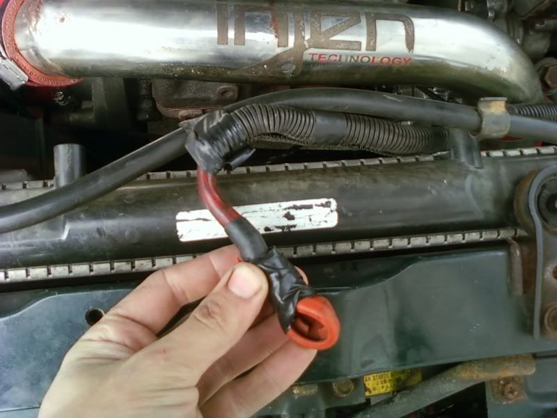

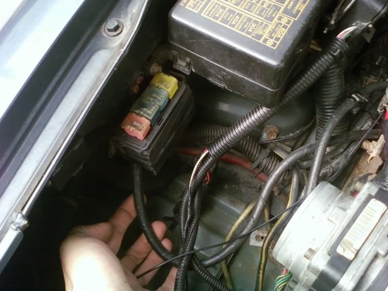

i almost forgot, here's the pics of the wire that is just hanging there, and i took a pic of where it goes to(fuse panel)
That's the alternator positive wire. Your car must have been upgraded with a heavier wire or something.

thats what i thought it was, how many wires go to the alternator? i have only 1 wire going to it, same as when i removed it, is this why it blew in the first place?
