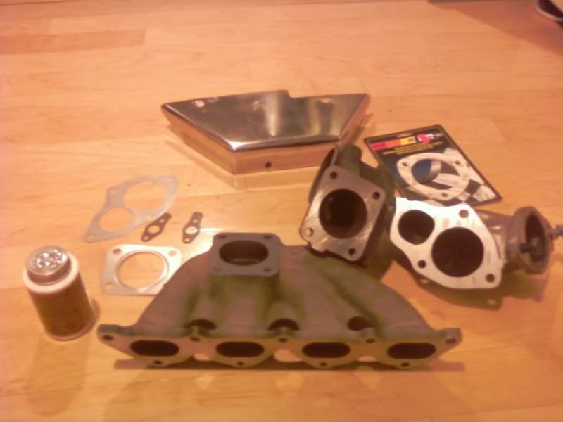

just ordered some ARP headbolts, evo III manifold, evo III o2 housing with SS gaskets
also got my aem wibeband and 1g to 2g plug in today!!! everything should be good by the time the manifolds get here and i can finally drive it again.

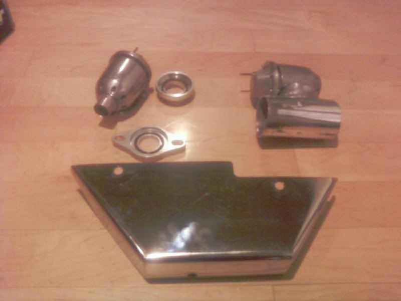

ok just bought some parts from a member on another forum, a SS Heat Shield and the old style HKS SSQV with 2 different flanges, plus i bought a fake one with 2.5" piping off a different member a while back for like $15. now i have to build some IC piping for the cold side and i will be in business.

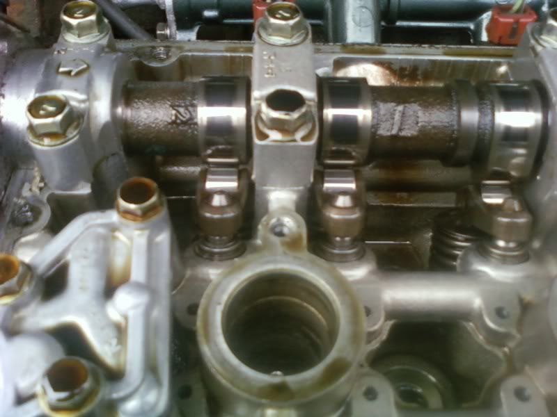

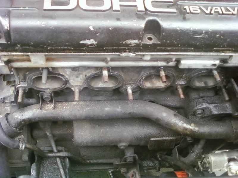

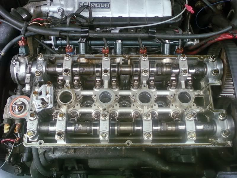

Also installed the arp's, when i took the VC off, i was surprised to see the head so clean, it must have been rebuilt like the PO said, even though everything else he said was wrong.

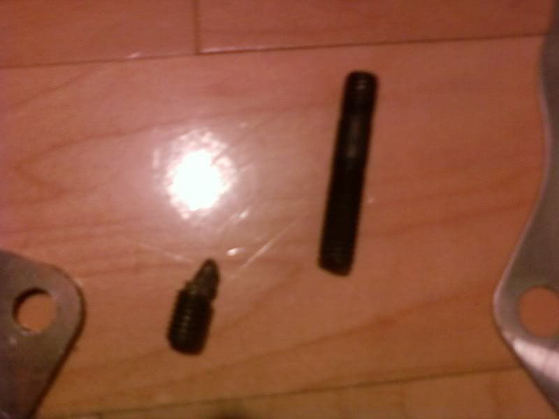

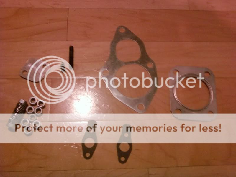

i removed a broken manifold stud, with the welding trick, worked perfect in less than 5 min. and i bought all new nuts and washers, and new gaskets. also got a EGR b/o plate

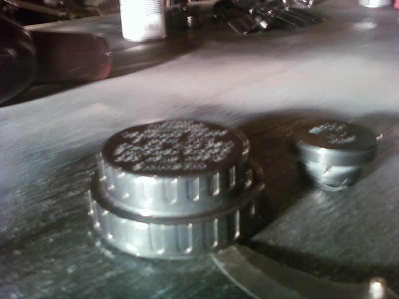

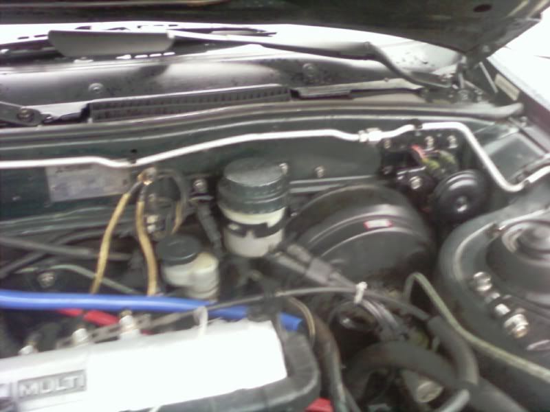

painted my brake and clutch master covers.

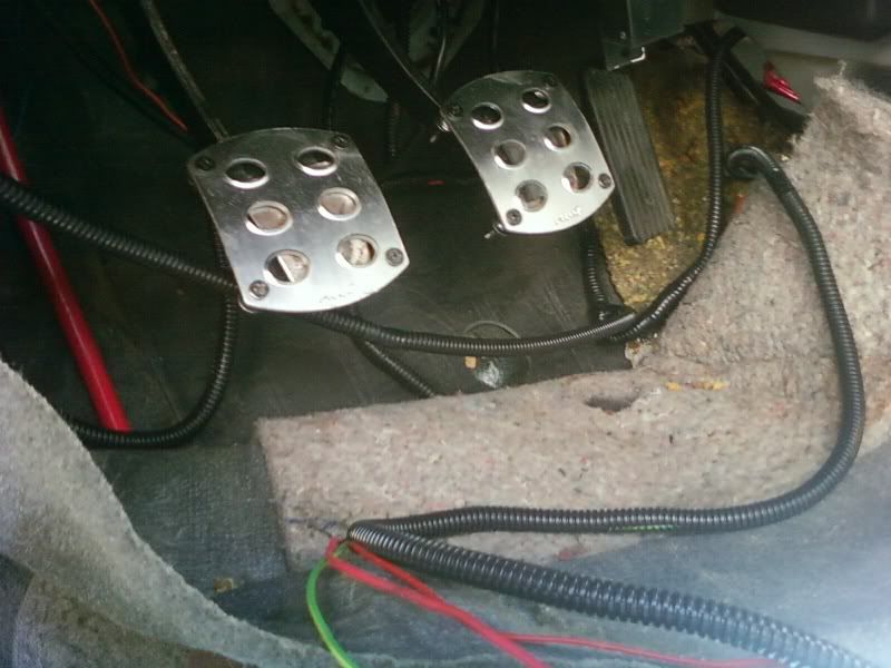

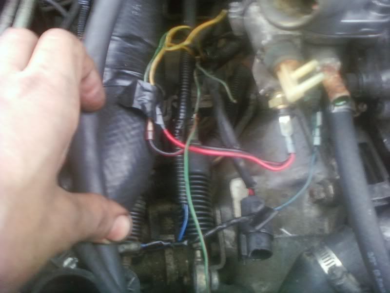

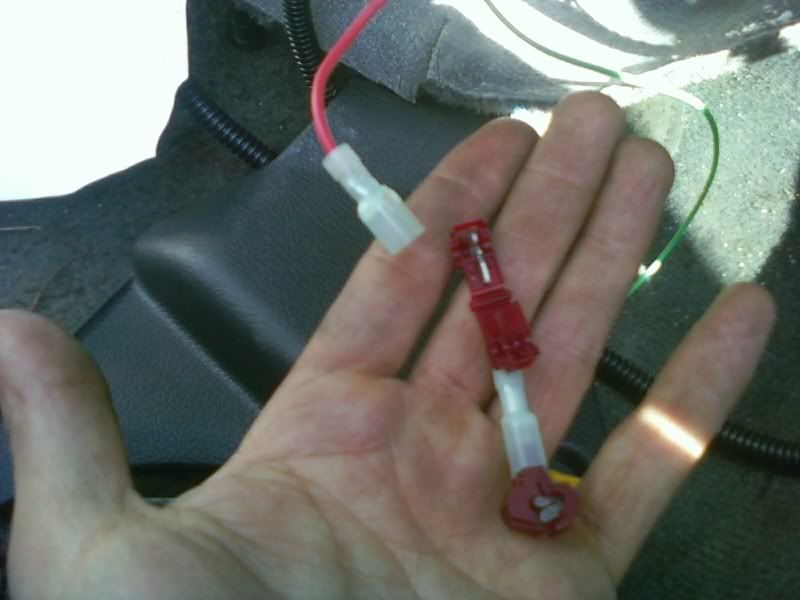

here is the mess in wiring i still have to deal with: easy

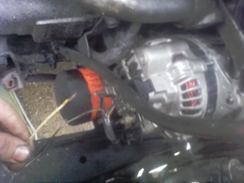

i found this lose wire coming out of the alternator wire loom, i can't seem to find where it goes! there are no other broken wires that i can see. Anyone???
CarRacer
Jun 28, 2007
4,372
Shakopee, MN
Car looks good. Attention to detail goes a long ways on any car.
The yellow wire looks to be the one that goes to the bottom of the power steering pump. There is supposed to be a "bullet" style connector on the wire.

wow quick response and helpful too!
i will look into the wire under the PS pump, and change my oil filter, thanks for the heads up!

car is not done yet, finally got my (evo 3) manifold in, to find out its a 2g manifold, my ported 2g was bigger, so i have been waiting on a manifold i am not going to use. drop my old one off at the machine shop to be resurfaced, won't be done until monday or tuesday. then it all has to go back together.

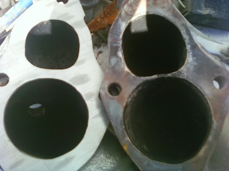

ok so i got all my parts resurfaced, including the evo manifold and o2 housing, and after comparing them to my TRE ported 2g o2 and manifold, i decided to reuse the TRE stuff, take a look at the pics. i can't seem to find the 2g manifold side by side with the evo manifold, but the TRE 2g was the same size port on the runners and bigger on the collector.

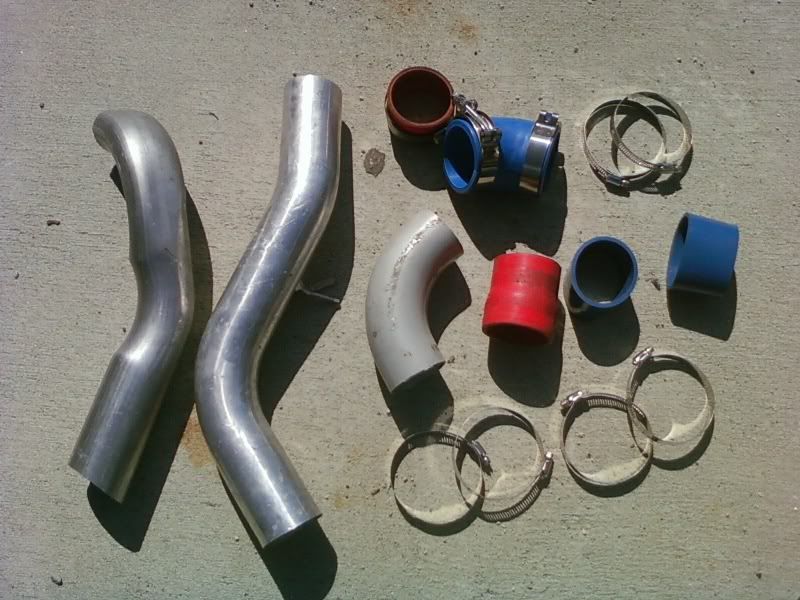

also made me a cold side IC pipe, thanks to patty for the 2.5" pipes, all i had to do was get one pipe bent at the muffler shop (press bent), its a short piece, not that big of a deal, way better than the stock piping. i also had to order a new BOV flange/pipe ($20 ebay), the one i got from a member kept blowing off. installed the HKS BOV, also from a member on here, along with a recirc tube. bought a 45 degree elbow w/t-clamps and three 2.5" couplers, and i was in business.

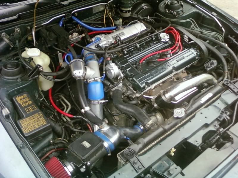

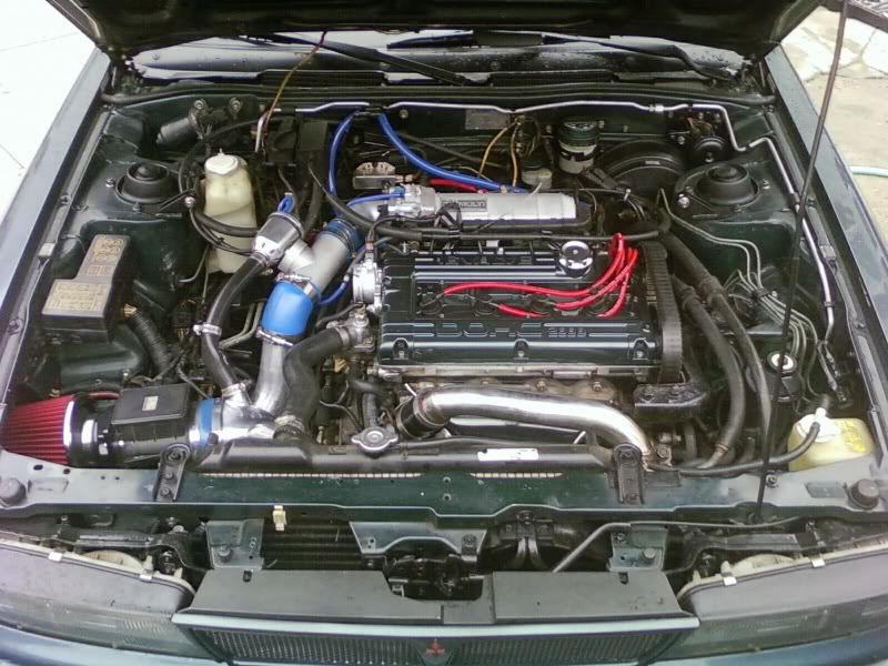

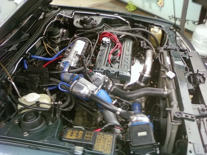

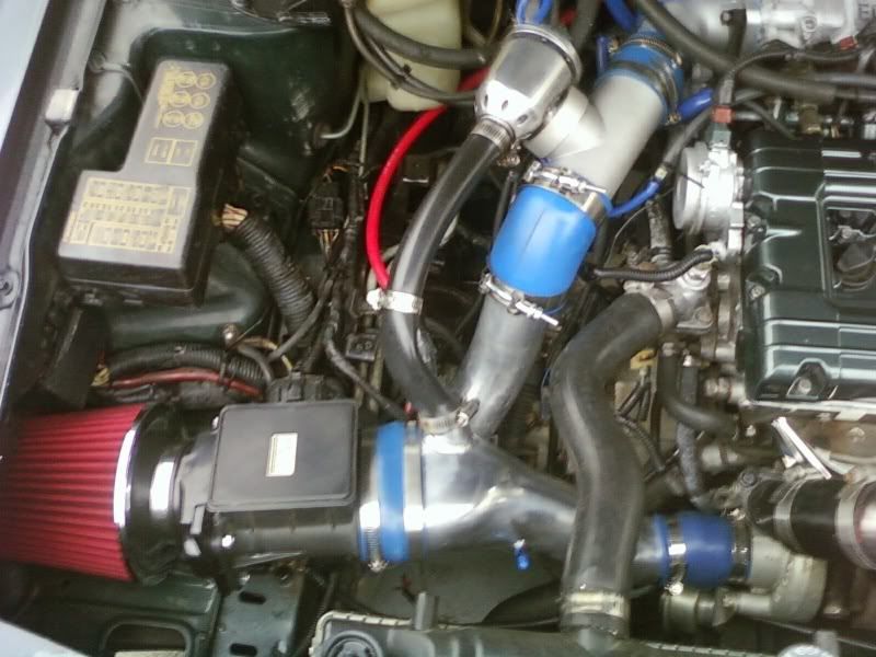

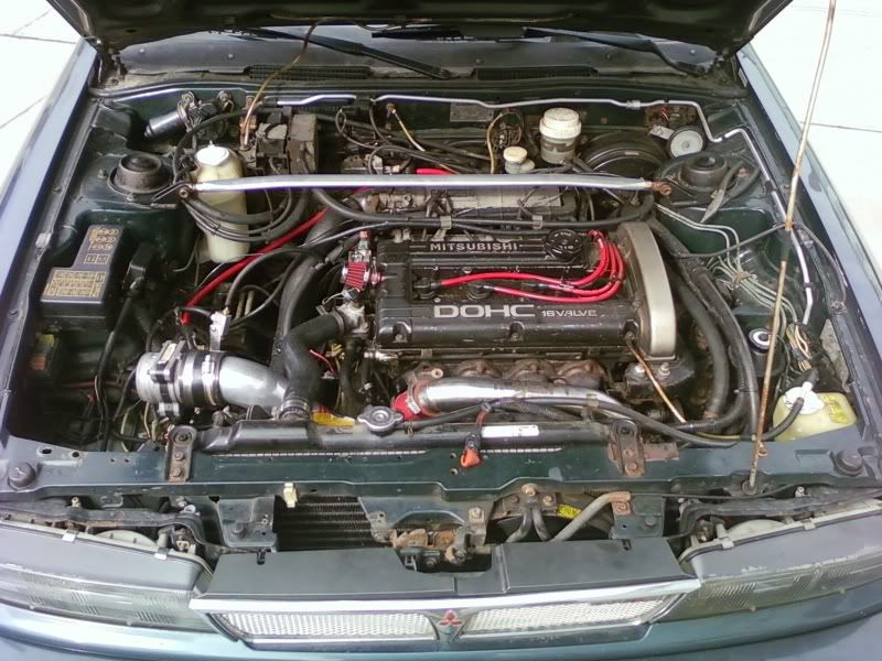

so i am finally posting pics of under the hood, it is not 100% done, but pretty close, i just need a blue air filter, blue NGK wires, nice timing cover, wire loom the battery cable and a catch can.
here is a before:
and here is the afters! What do you think?

I saw this car in person before you bought and WOW...looks awesome, you really brought it back to life bro /ubbthreads/images/graemlins/applause.gif
good job on a clean build! Best of luck man!

Looks good. I'm assuming the bov is in the way of your strut tower bar. I could take that off your hands if your not using it anymore haha.
