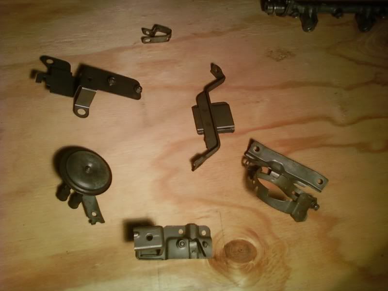

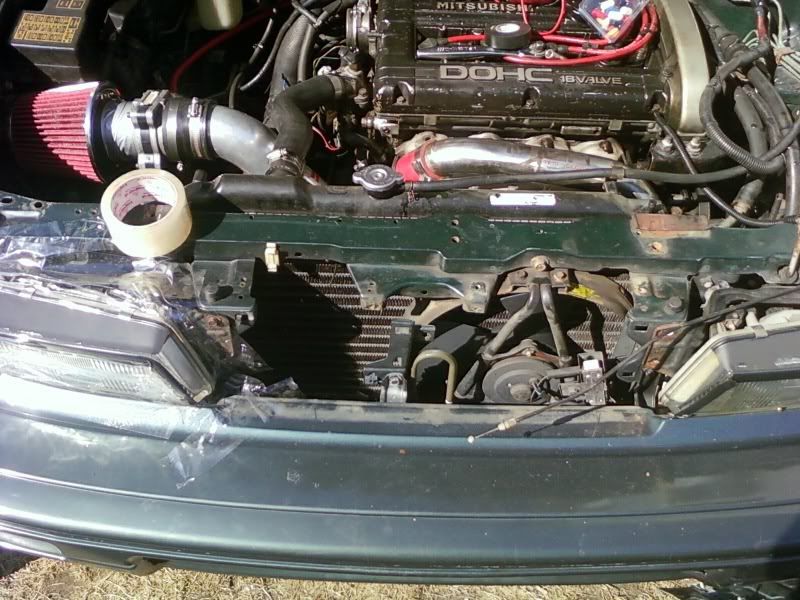

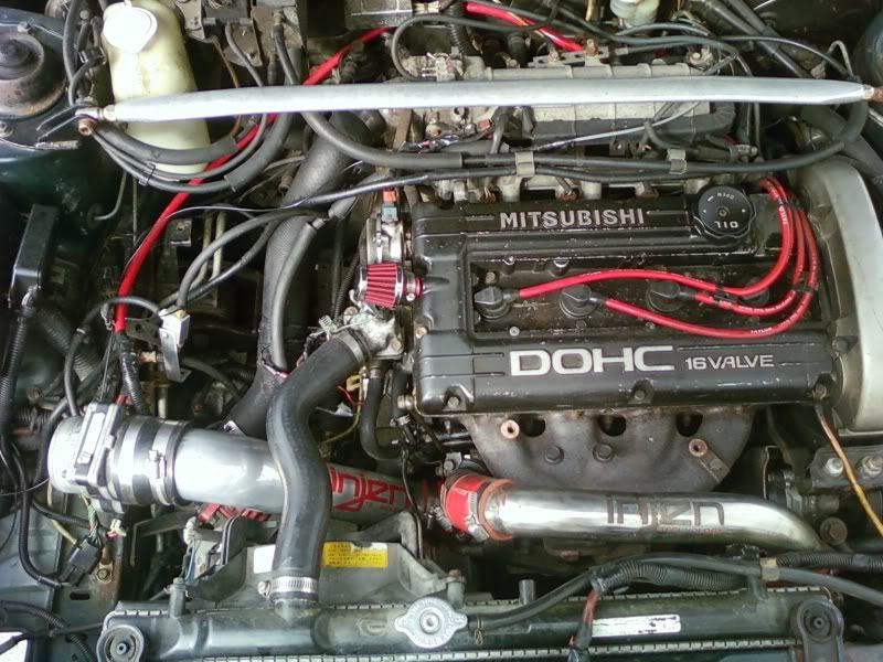

Ok so this is what i have been doing the last week or so while waiting for my ecu to come back...
i have been trying to restore under my hood so it looks good again!!!

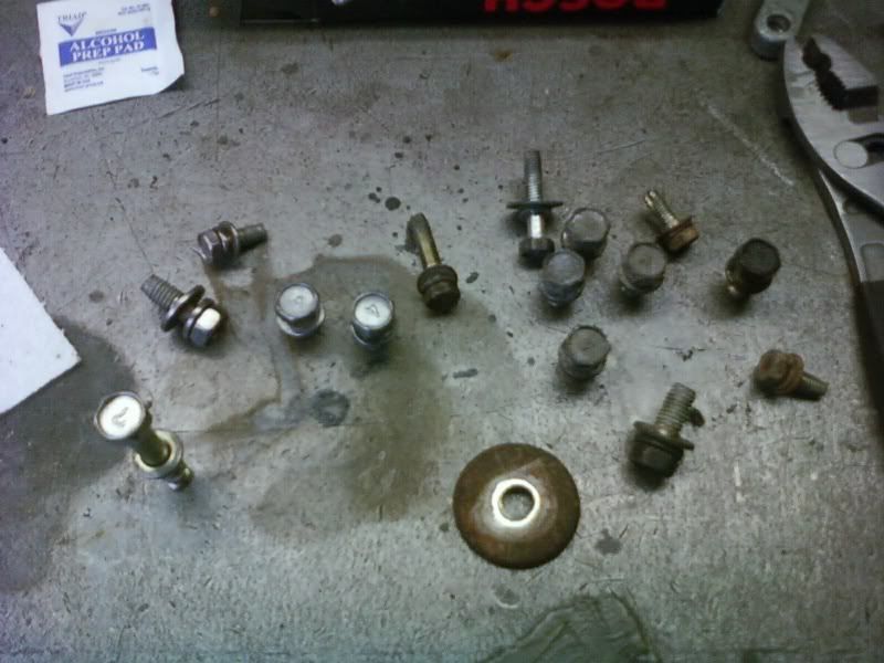

i have been removing every bracket and bolt that is removable and that you can see from everywhere. been sand blasting and painting everything. i repainted the tops of the headlights and housing, i will have a bunch of pics soon but, here is a few before shots of under the hood.

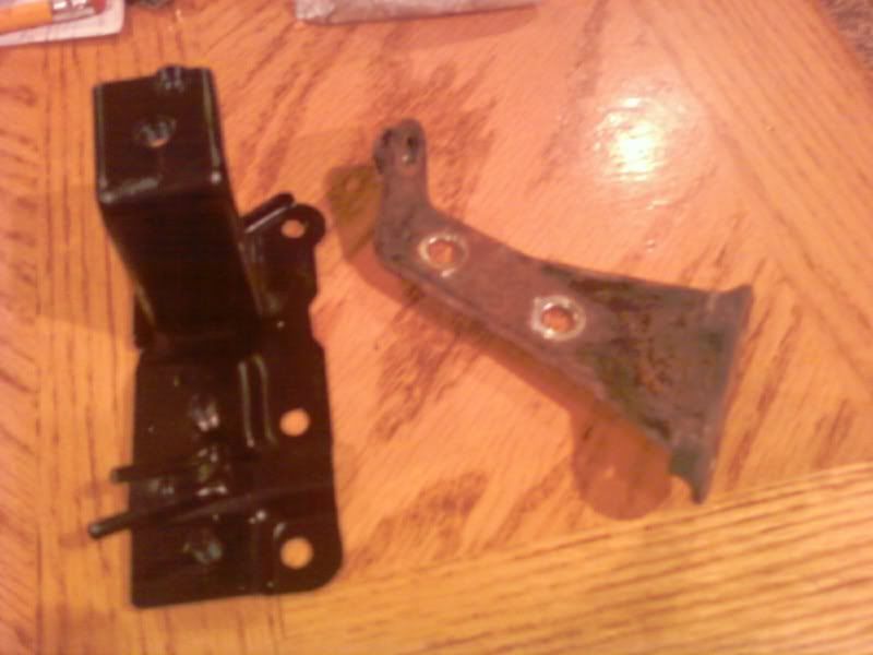

Before and After Misc Brackets and Bolts! looking at pics don't do them justice, my father was asking me today why i would spend money on new brackets, lol they really look brand new, i painted them with Dupli-Color Trim Paint. i will get more pics soon
some bolts after the wire wheel

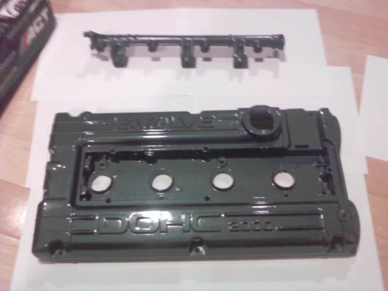

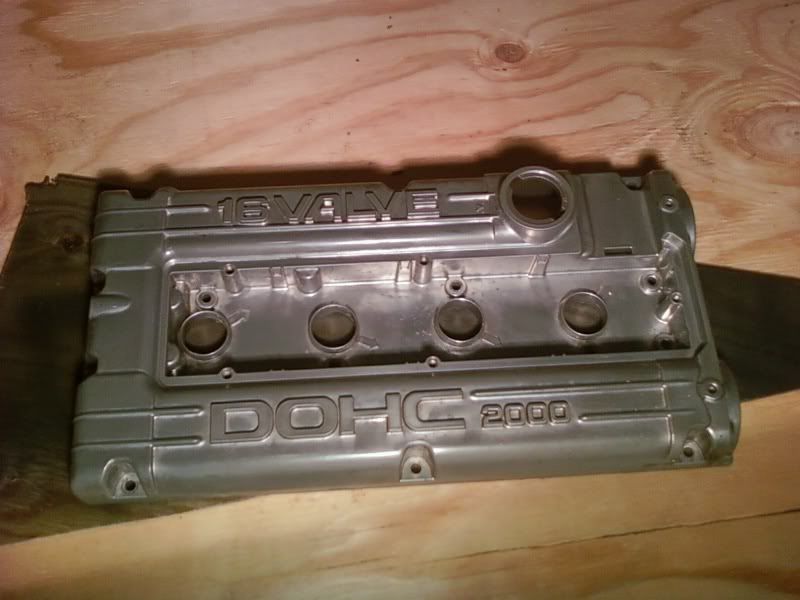

i also Painted my VC, Fuel rail, Roof Molding and the windshield cowl. what do you guys think? here is what it looked liked after sitting in my attic for 6 years, i had it chrome powdercoated like 8 years ago
i hope you guys enjoy, i have been working my but off under the hood, completed pics to come real soon!!!!!
11,016
Looking good! That little detail stuff is a pain, but makes a difference.
Hope all the paints last in the engine compartment environment.

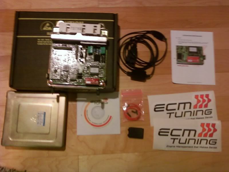

Ecu and DSMLINK came in today! which reminds me i ordered my AEM UEGO Wideband at the same time, should be here soon!
