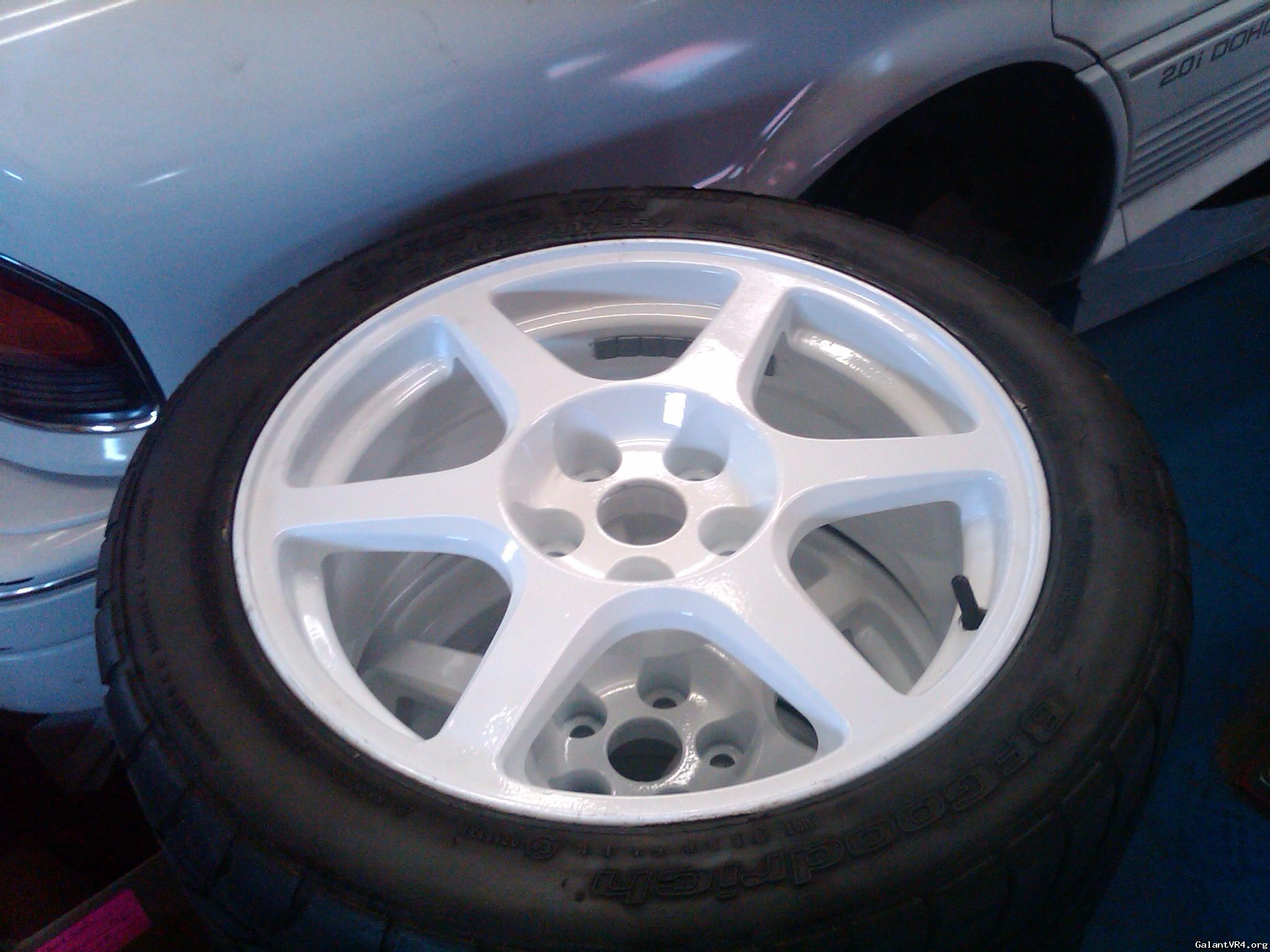

I just got these back from powder coaters when I was back in NM a few weeks ago, turned out great and have KDW sport's mounted up. At this point I'm just day dreaming about fitting 16"s and was curious if anyone had any pictures of them mounted. Thanks for the responses.
