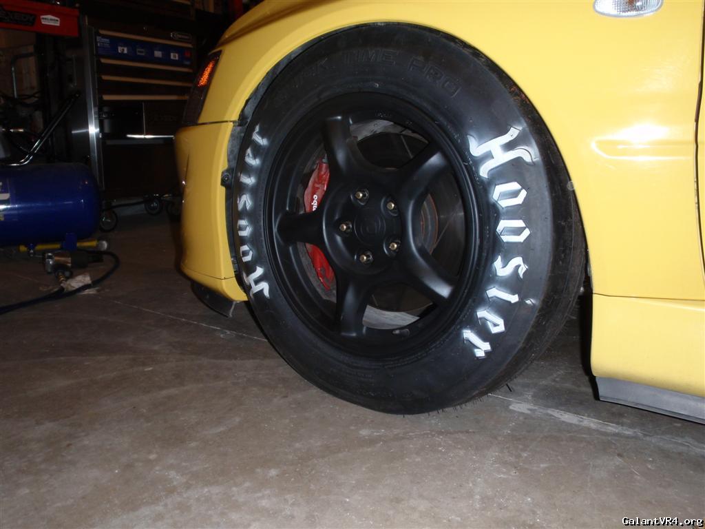

ive been search for a while now in the board and in tuners but cant find anything about what im looking for.... for those that has the 3kgt vr4 brakes on your car has any of you guys try fitting them with the FD wheels? i saw this click those are FD wheels on an evo with has the oem brakes.... looks like they fit.... and i did a research of wat size oem evo rotors are and they are bigger that the vr4 ones.... 12.65" evo vs 12.36" vr4 rotors.... what you guys think? will they fit?

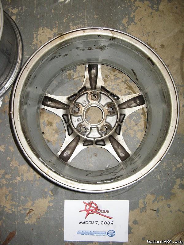

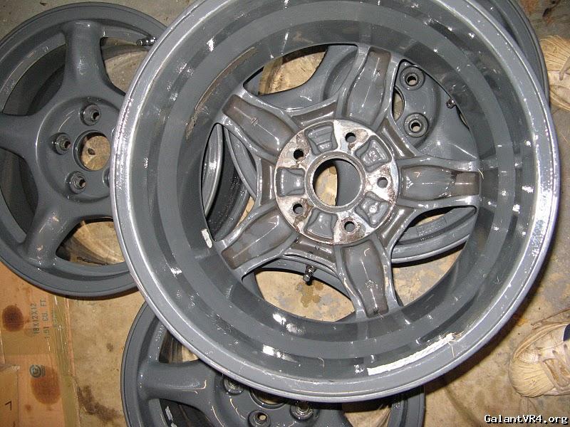

Here are some pics from the EvoM thread:
non-reinforced that fit w/ 50 marking
reinforced that do not fit
difference in barrel design between both generations of wheels

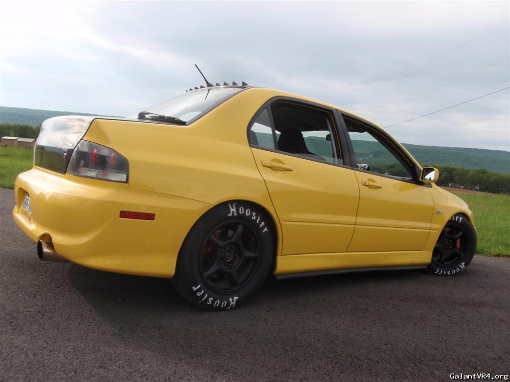

It would be interesting what a Gvr4 would look like w/ the spacers, 3kgt brakes and wheels up front. It might have "macho chicano" look w/o proper negative camber or flares. I'm running evo8's w/ my 3kgt brakes but the difference in weight interests me.
Evo wheels are around 20 lbs. w/o tires compared to the non reinforced FD's which are 13 lbs.; would be a trick drag racing setup and some Hoosiers like the evo's are runnig.

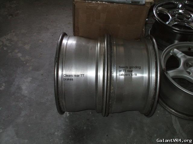

As I understand it, you need to run spacers with FD wheels anyway. They are 16x8 +50 the rears will clash with the trailing arm, unless you cut and weld like gtluke:

The fronts fit fine without any mods, the backs need the notching.
