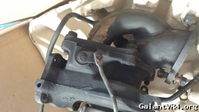

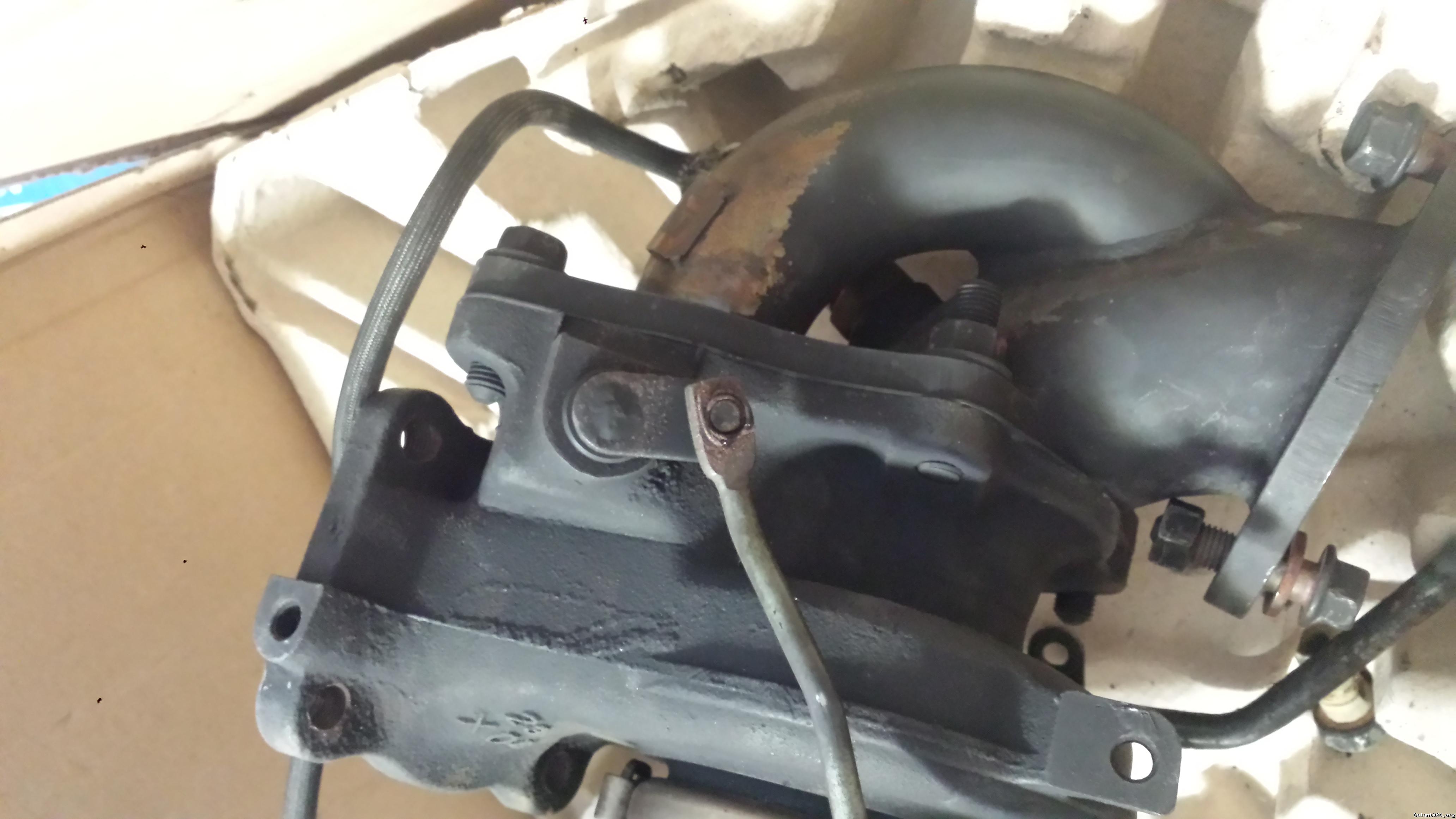

If the numbers match then it's whatever the numbers say. And they are saying it's a big EVO 3 MHI. Most china made turbos will not have the stamped numbers on them.
coyotes
Nov 15, 2013
1,544
Seattle, WA
the number on the compressor side indicates standard big 16g: 49178-01(42)0
the number on the exhaust side seems to indicate evo iii housing: 78-13700 070 F5
I am glad to know it's MHI though. I think Brett just wants to give me a hard time
3,479
I'm being completely serious. That doesn't look like a MHI turbine housing. The X04 markings match the Ebay type turbine housings, which is why I brought it up. The casting looks clean, so I wouldn't really worry about it either way. The CHRA is what matters, and I mentioned the funny looking turbine housing as a precautionary measure for you to make sure you don't have an Ebay turbo on your hands. Paul is a trustworthy guy, so I'm sure you're ok.

the evo 1 16g looks different then the evo 2 and 3 turbos. the turbo he has is an evo 3 big 16g and looks exactly as it should.
EHmotorsports
Sep 25, 2012
1,283
Beaverton
look at the link i posted Brett it looks exactly the same.http://www.extremepsi.com/store/product.php?productid=16296\
coyotes
Nov 15, 2013
1,544
Seattle, WA
Paul didn't advertise it to me as an MHI, I don't think there are any other housings though that would put those codes on there. Most ebay turbos say EVO 16G or TURBOCHARGER on them real big. I'll take the o2 housing off and see what the wheel and wastegate look like.
I don't think FP would touch a non MHI housing and port it out.
coyotes
Nov 15, 2013
1,544
Seattle, WA
Quoting GSTwithPSI:
See the X04 stamped on the on the turbine housing? Just saying, looks like an Ebay housing to me, whether it came from FP or not. Not saying it's junk, just saying it ain't MHI, yanno? Who'd you get that turbo from?
Curious. I see that. But the item is advertised as a "Mitsubishi" Evo III turbo. So that auction has to be for a MHI turbo, it says no fakes.
mitsuturbo
Jun 2, 2008
3,552
Near Seattle, Washington
Genuine MHI turbine housings have the triple diamond embossed on them on the outside of the lowest point of the volute. IT should precede the number you've posted here. I don't know that any of the chinabay knockoffshit has that on them. I would suspect they probably do not, as mitsubishi somewhat aggressively pursues those that use their logo illicitly. Who knows, though. They kind of do whatever the hell they want in chinese labor camps.
coyotes
Nov 15, 2013
1,544
Seattle, WA
Yeah there's no mitsu diamond anywhere on the turbo. I'm guessing at least the exhaust housing is not mitsu, however it was ported out by FP. The compressor side, I have no idea. Just gonna run it, don't care. It's not a cheapo ebay turbo at least.
