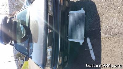

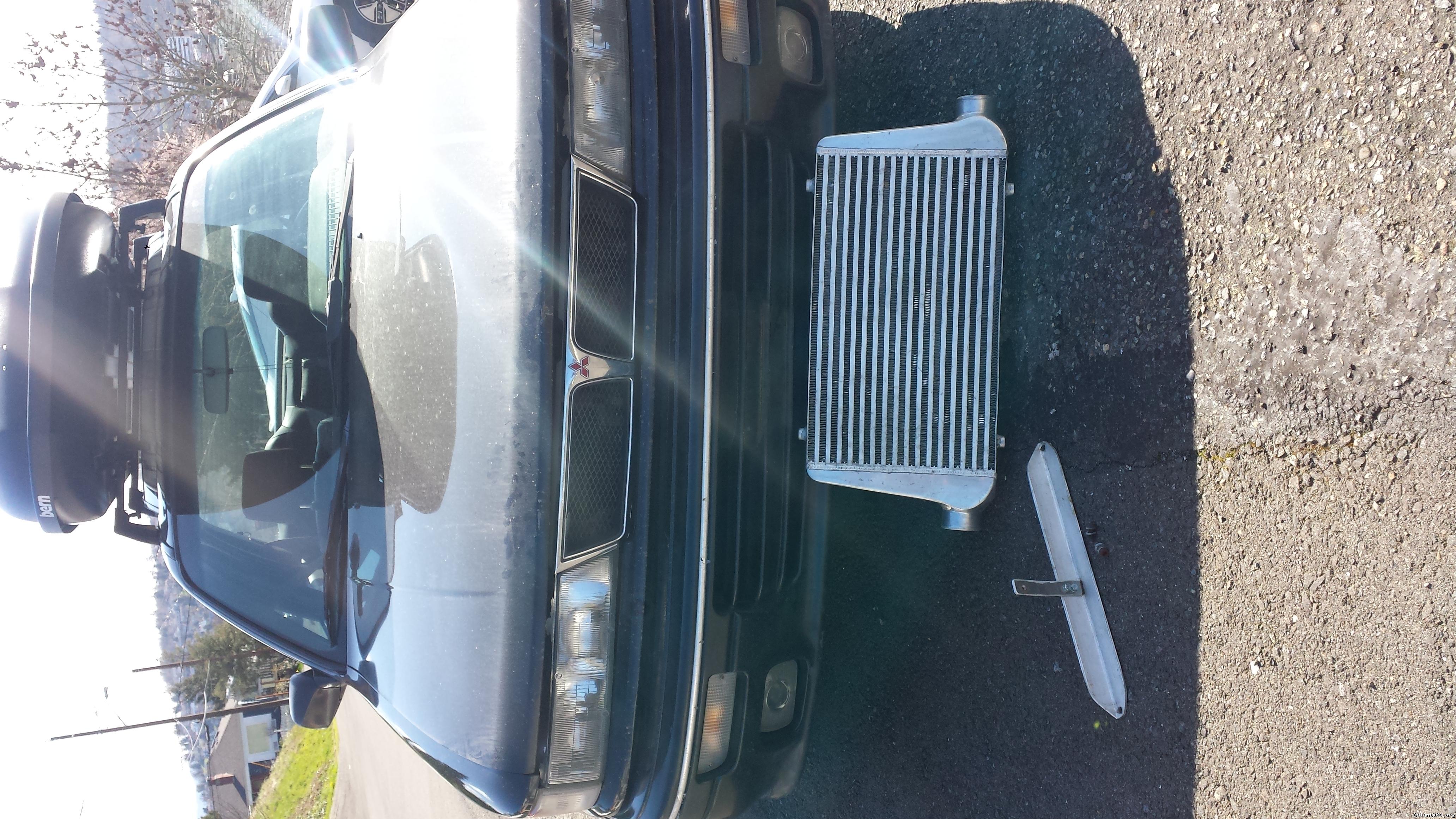

I ended up aborting my install. After having the bumper off and mocking everything up, I feel my FMIC is way too big for my needs. I also don't want to cut the crash bar unlike the rest of you. /ubbthreads/images/graemlins/grin.gif So I am going to sell the one I got and get a smaller one that will tuck under the bumper without much cutting of anything.
Maybe by that time I'll have relocated the battery to the trunk.

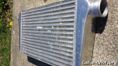

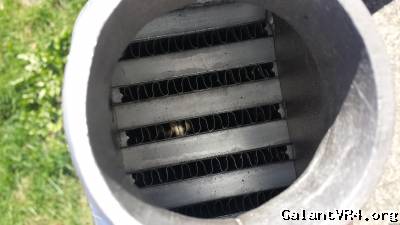

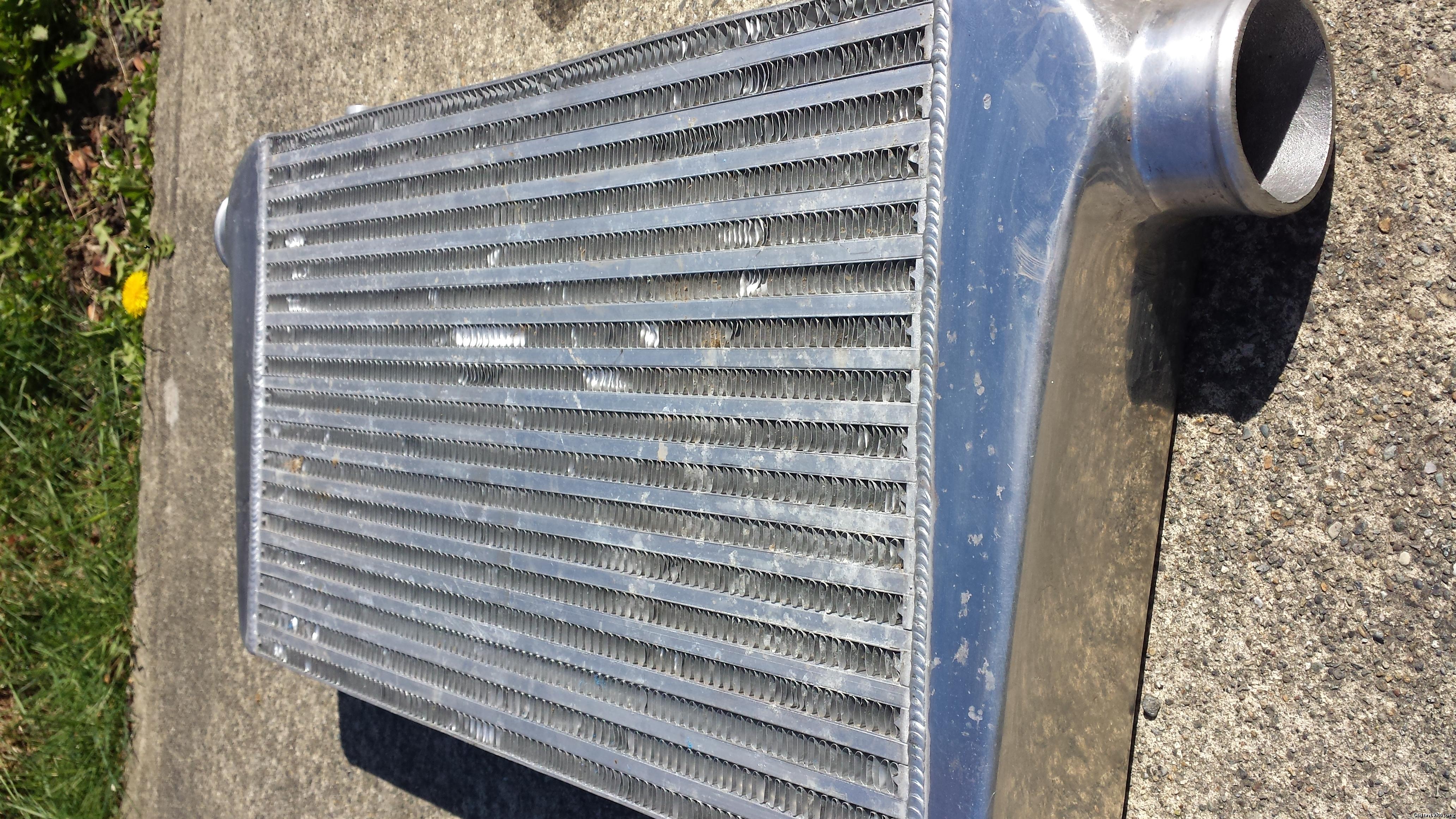

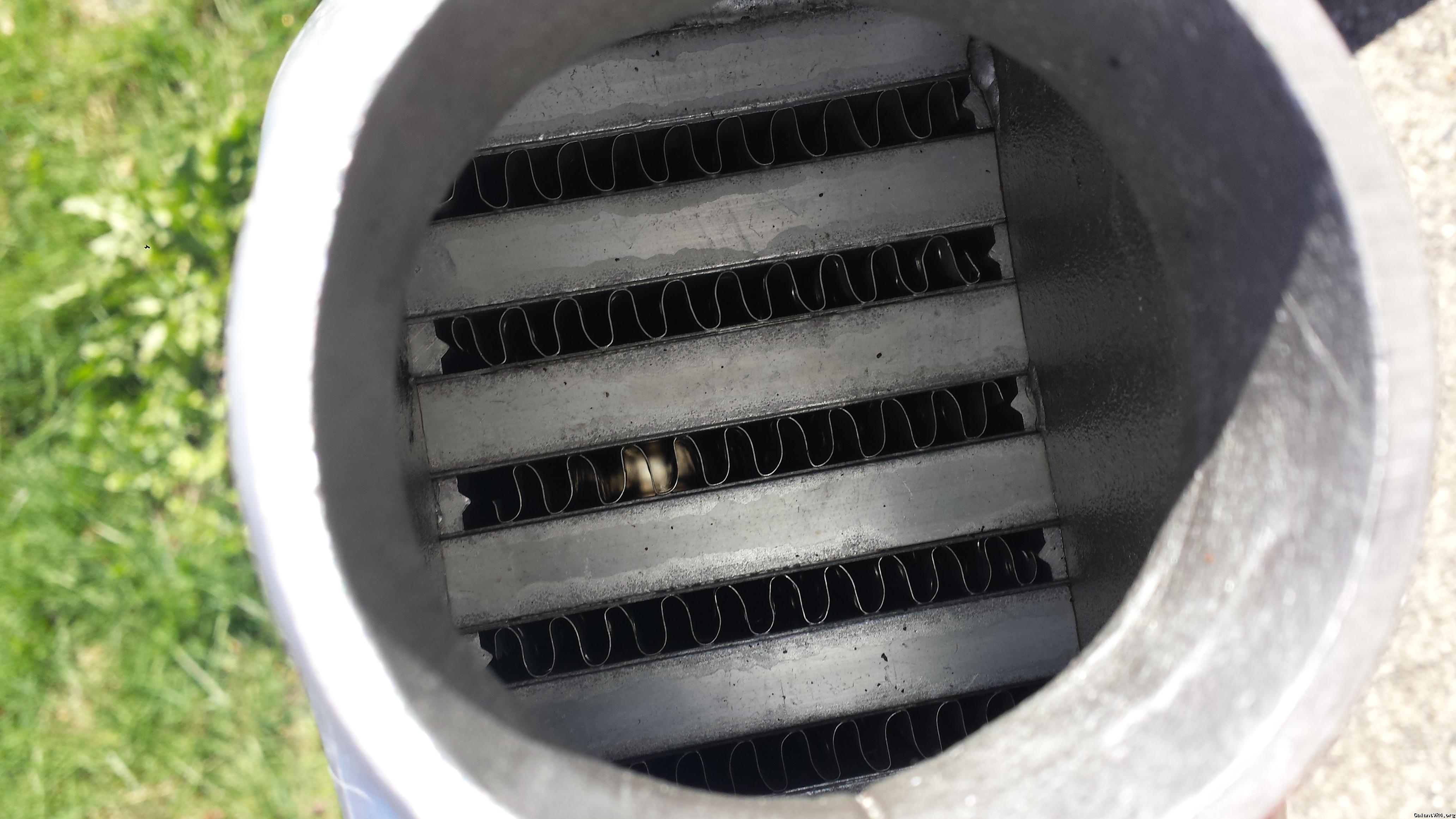

Here's the intercooler I'm putting up for sale. I'm basically just going to replace this one with one half the height and a little thinner.
Dimensions:
12" tall
27" wide inlet to inlet
2.5" inlet diameter
3" thick
I'll post it up for sale soon.
