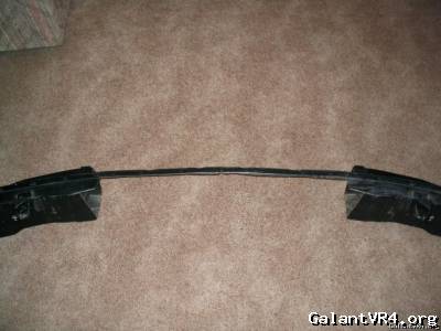

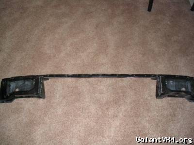

found a pic for ya... so as you can hopefully see from this shitty pic, that some of the back of the of the bar was trimmed out. not just the whole thing hacked out the middle. so it should still service its purpose as a crash bar and still have intercooler flow...

I wonder how thick that one is? There is no way to fit the one I have now without some major hacking. Kinda sucks, I misunderstood the position of the crash bar before I went into doing this. I do like the look of the intercooler sticking out, but I really don't want to chop the crash bar up.

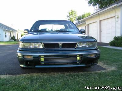

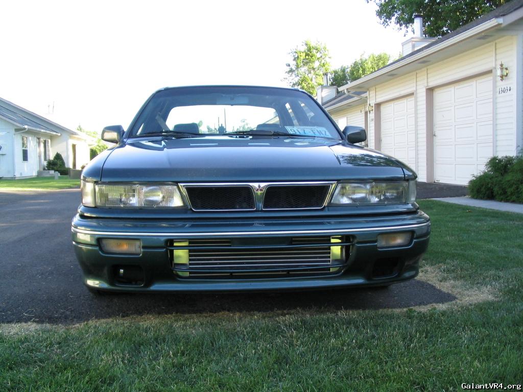

Keep the A/C fan. The intercooler mounts in front of it. Here's Mark's car, which does a good job depicting how the intercooler meshes with the A/C fan. I believe his core is larger than yours as well.

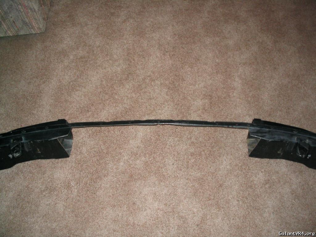

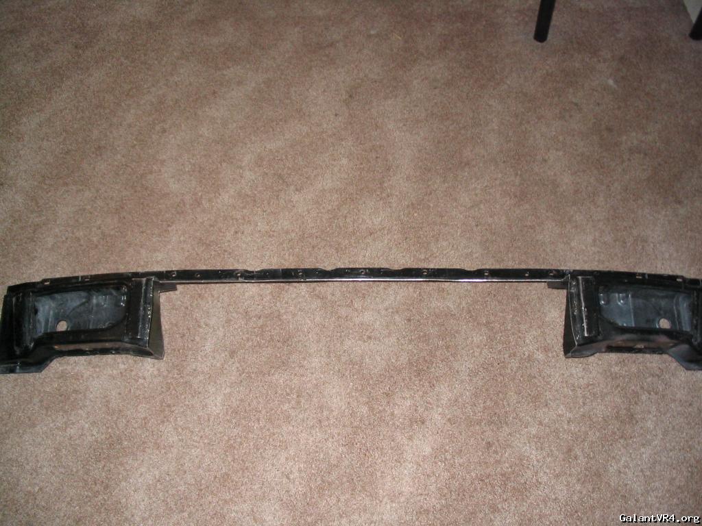

Also, here are some old pics of my USDM crash beam after modifying it to fit a FMIC. I left just the very top to support the urethane cover:
This isn't the core I have now, but a smaller custom one I had built. But this shows what it looked like behind the USDM bumper. If I ever did it again, I would have left all the slats and not cut any of the urethane. I might even get a new JDM bumper because I'd rather have the slats in it as well. Oh well, live and learn.
