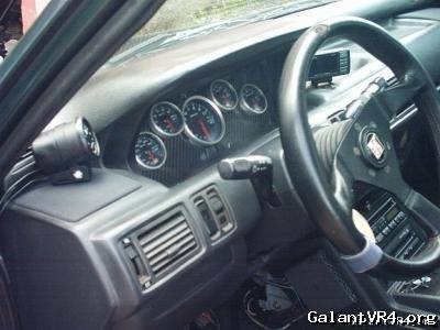

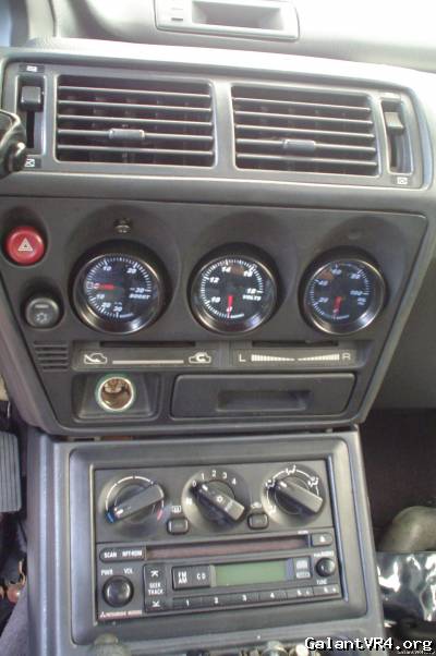

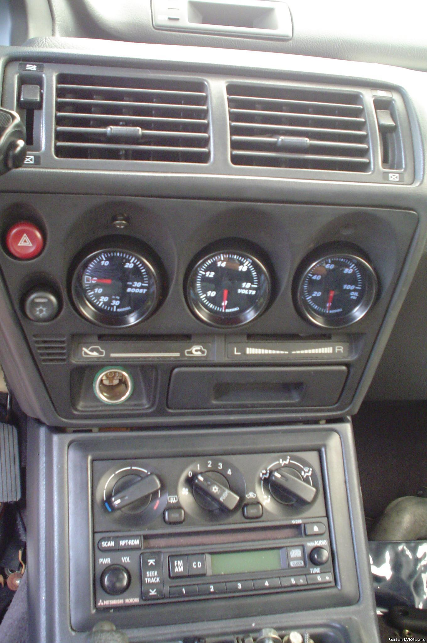

I guess I'll share since I just installed my gauges this past weekend. Boost on speaker grille, Evo MR cluster below the stereo (not using the boost gauge). Nothing special really...

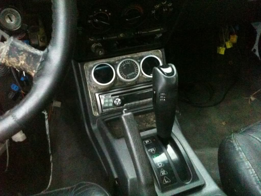

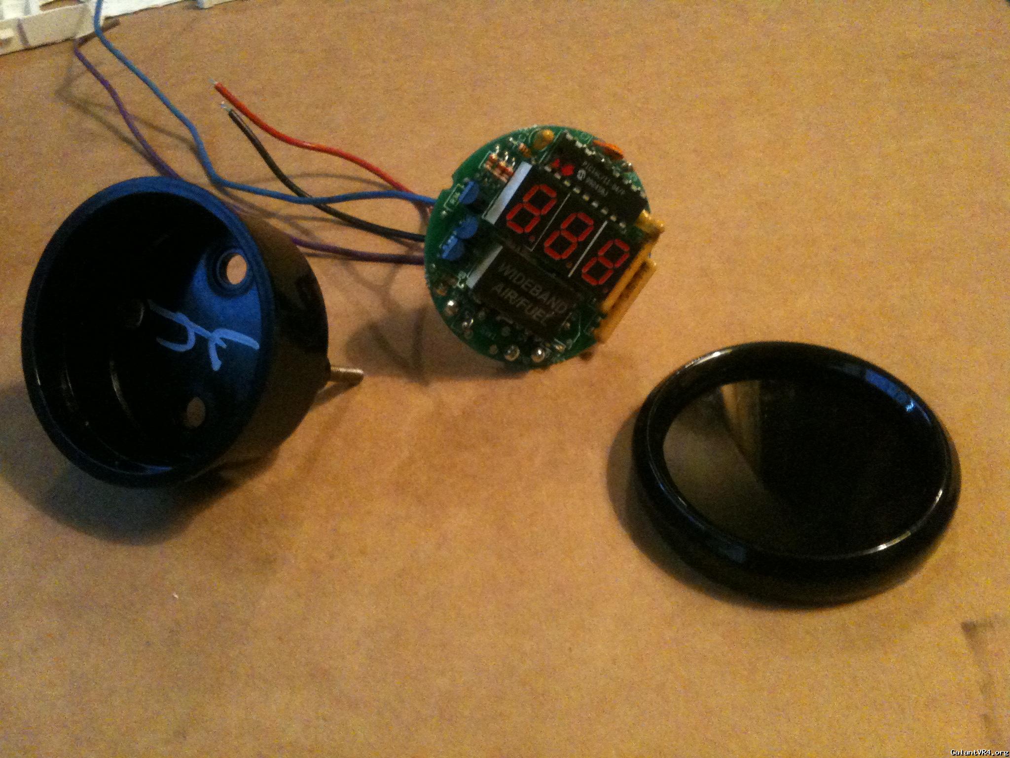

I'm currently working on stuffing a wideband gauge inside the clock housing. Actually, I've done that - just need to put it in the car when I get a chance.

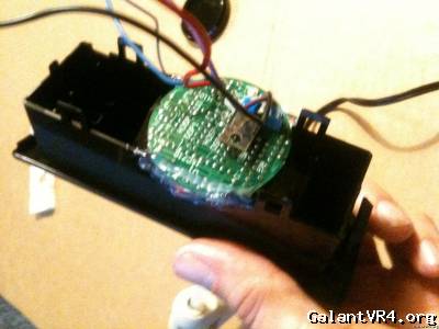

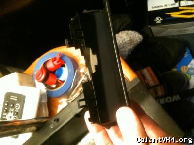

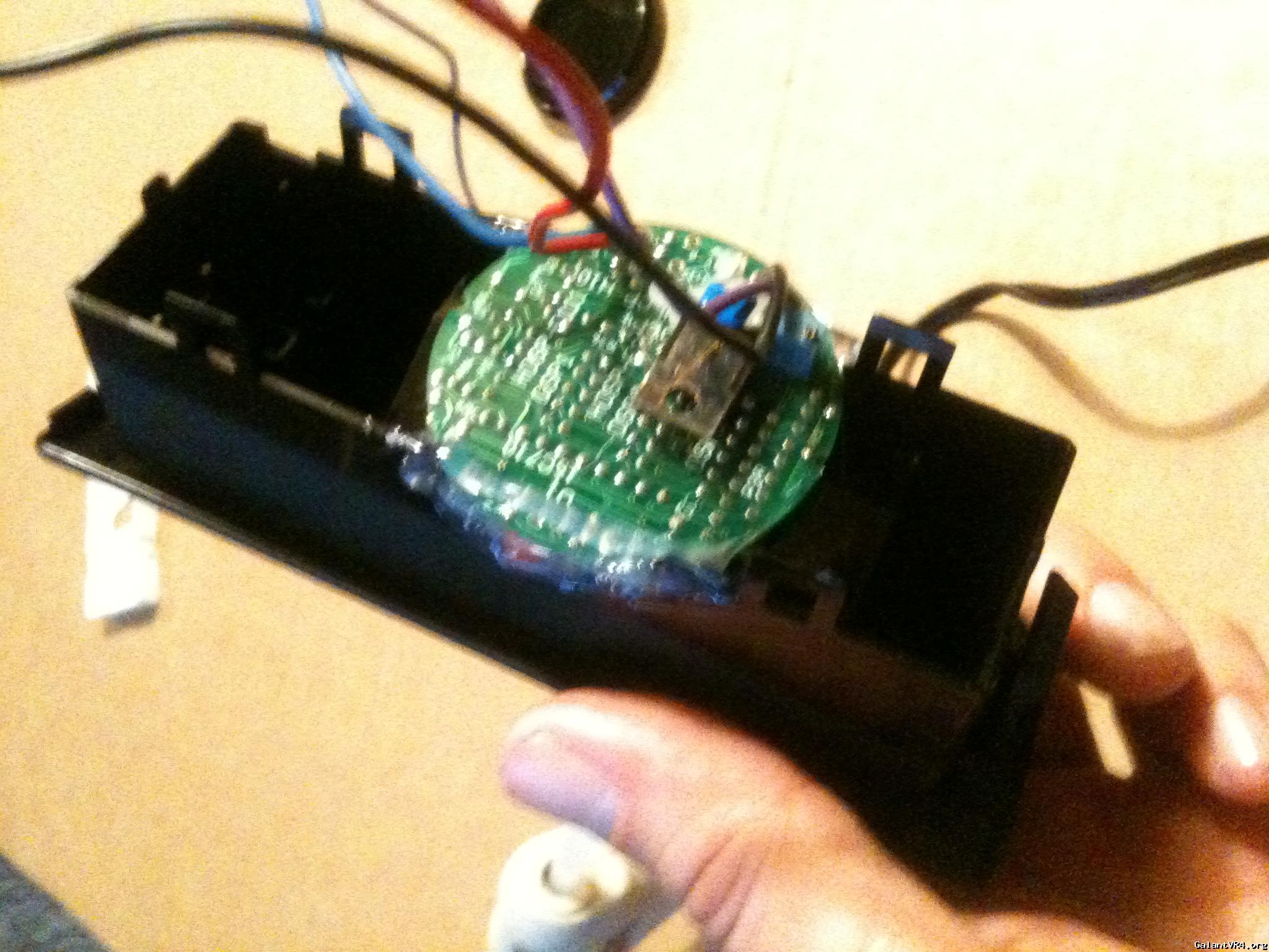

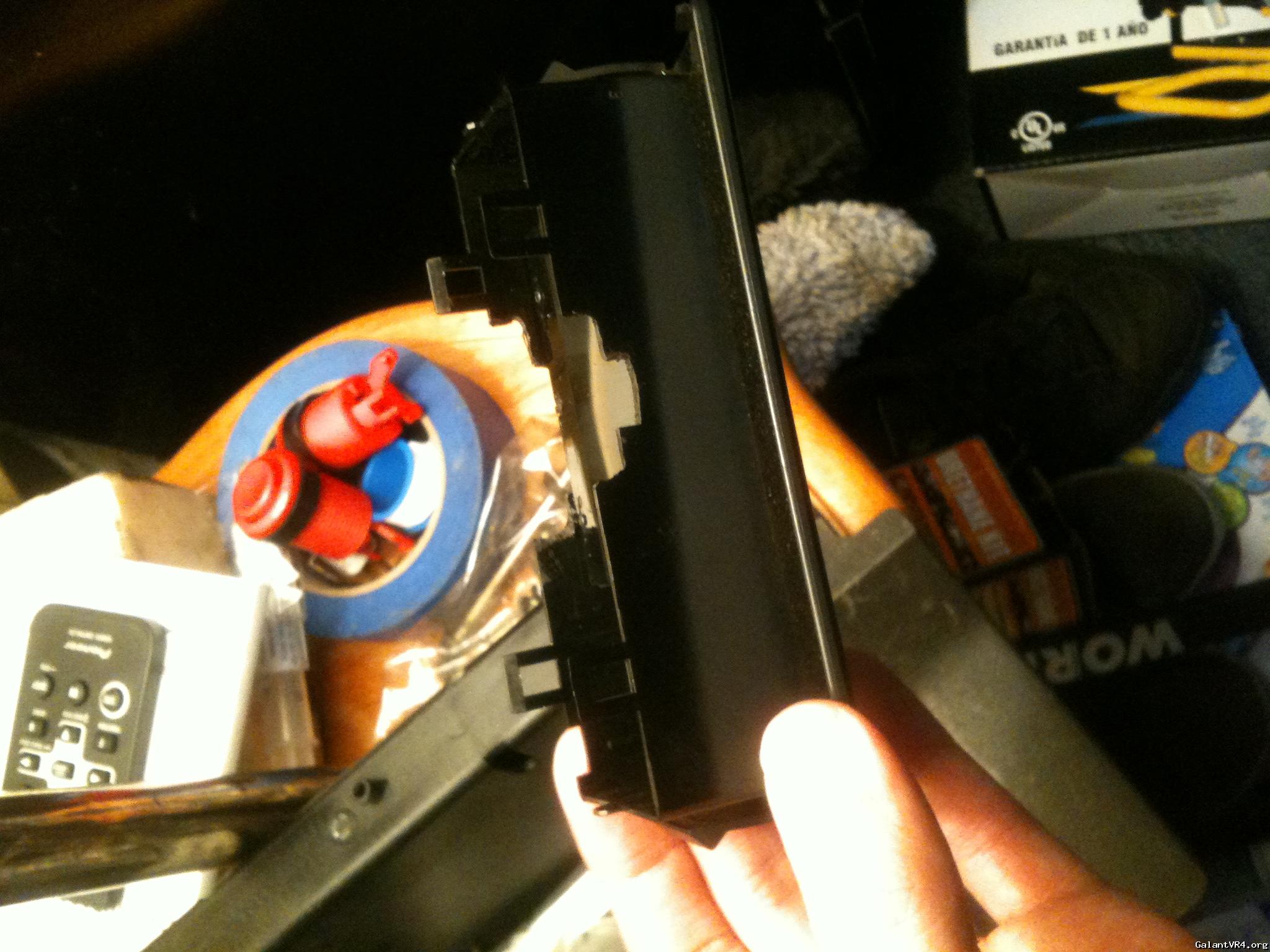

I took apart an extra Innovate DB gauge I had laying around and put the guts in a spare clock housing. It only took a little bit of time with a dremel to get it in there. The next step will be stuffing this thing in the dash. I'll need to cut a small portion out of the plastic frame behind the dash that surrounds the clock. Shouldn't be a big deal...
I managed to get the back piece of the housing to clip back on over this. I don't have a pic at the moment. There's a small portion of the PC board that protrudes from the bottom of the housing which is why theres a need to slightly mod the dash so this will slide in.

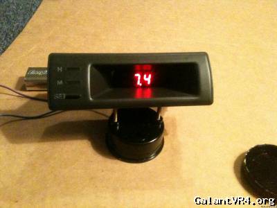

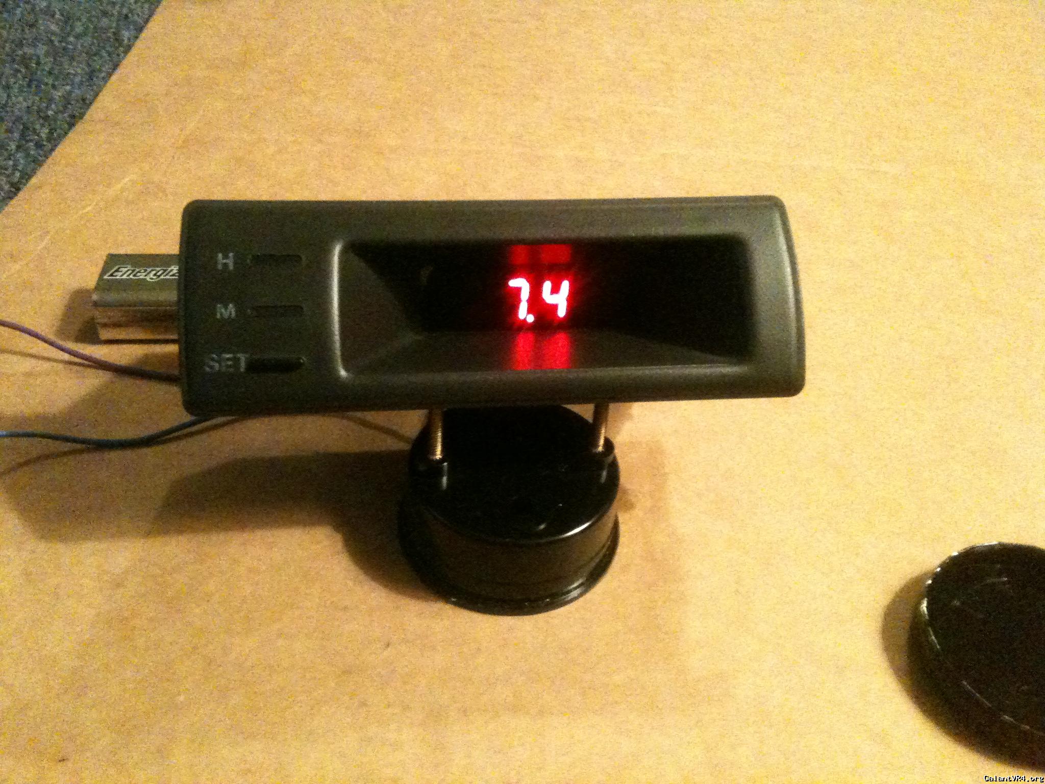

A teaser of the thing lit up by a 9V battery.
