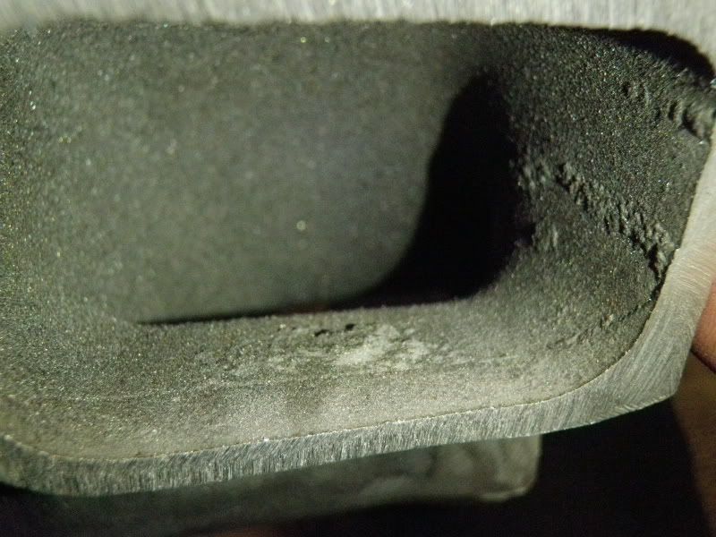

welp... decide to do some work on the ol' s###box.
whats this... on just a factory manifold
ohhh no what happened
then spent some time cleaning up the runners...
before
after
going to buy the metal i need to finish tomm so stay tuned for some updates...

Looking good. On the stainless welding I would up the flow rate on your regulator, post flow at least 8sec and make sure your tungsten is clean and nice and sharp. Brown is bad, good luck with the rest of the build.

GolfBall
1900/2000
Galant VR-4 org Post #: 1051028 posted 02/10/12 01:41 AM     Remind Me!  Send Private Message   Edit Post
DUN DUN DUHHHHHH...
got the manifold finished up, wastegate flange added...
adapter pipe with wategate flange
and got the downpipe done...
then started my oil drain... i know its funny looking but i wanted to keep it metal for a bit so the head from the manifold doesn't melt it.
