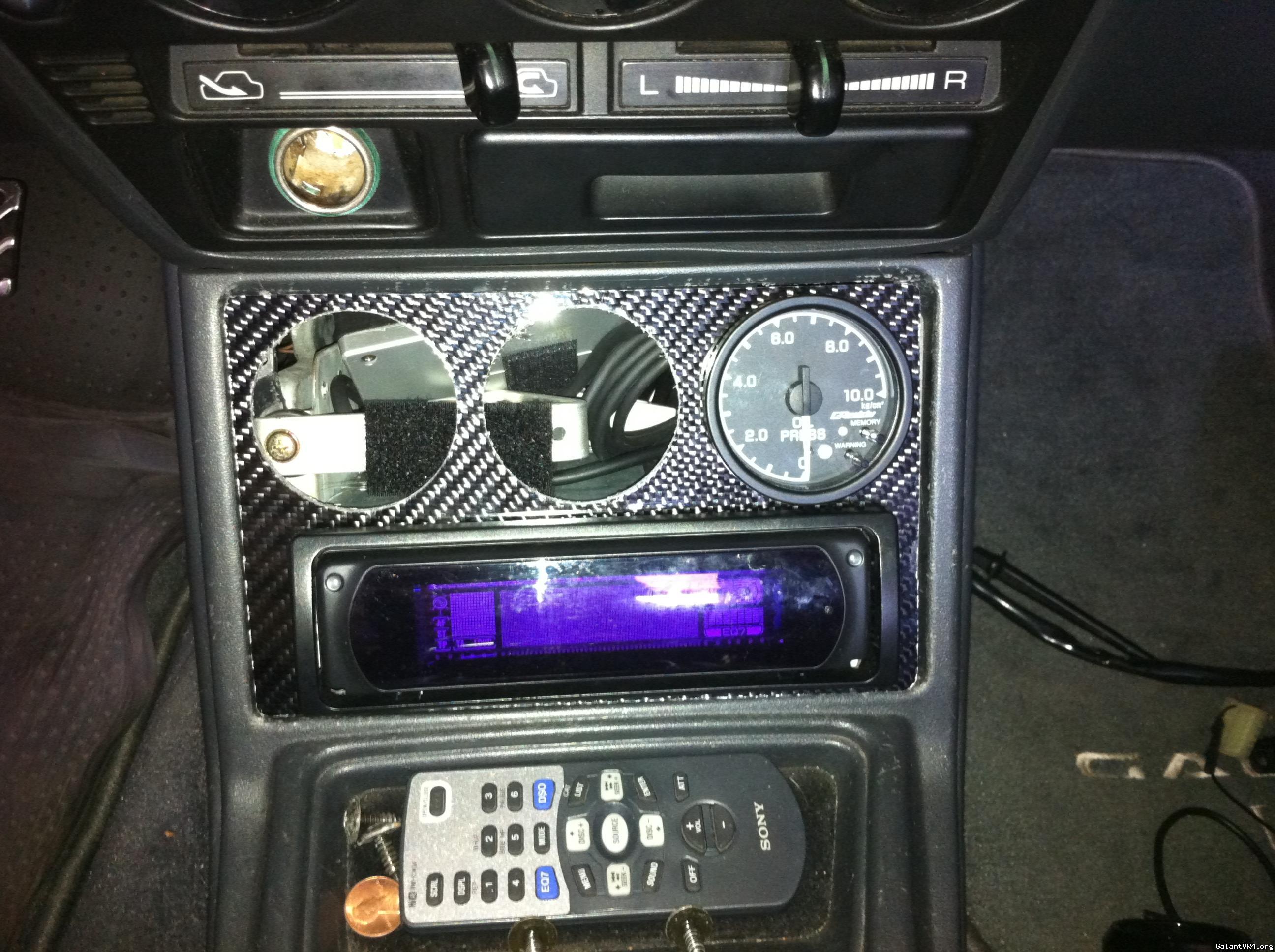

As a sidenote, I had the same thought as you, but as I noted others made a full 2din plate for gauges and radio.
as far as I can see using the single din surround its simply too big, the gauges wont fit in the single din spot in the surround.
Prolly why everyone made a 2din plate for it all and skipped the surround. /ubbthreads/images/graemlins/smile.gif
Picture from another member to illustrate my point, notice if you add the surround to that I doubt you could fit the gauges.
I like this idea, but I don't know how to go about making something like it. If someone had this for sale I'd be interested.

Well even if you used the single din bezel you still need a plate behind with circleholes in it for gauges.
so you end pretty much with the same work.
Im making 1 as we speak.
I took a piece from a cardboard first and made it in that until its how I want it. with holes and everything.
Then I bought this: Carbon Fiber Sheet
you could also make it of Alu and coat it after. but im going the full CF.
The you just put your cardboard sheet on the CF sheet and cut. then end.
