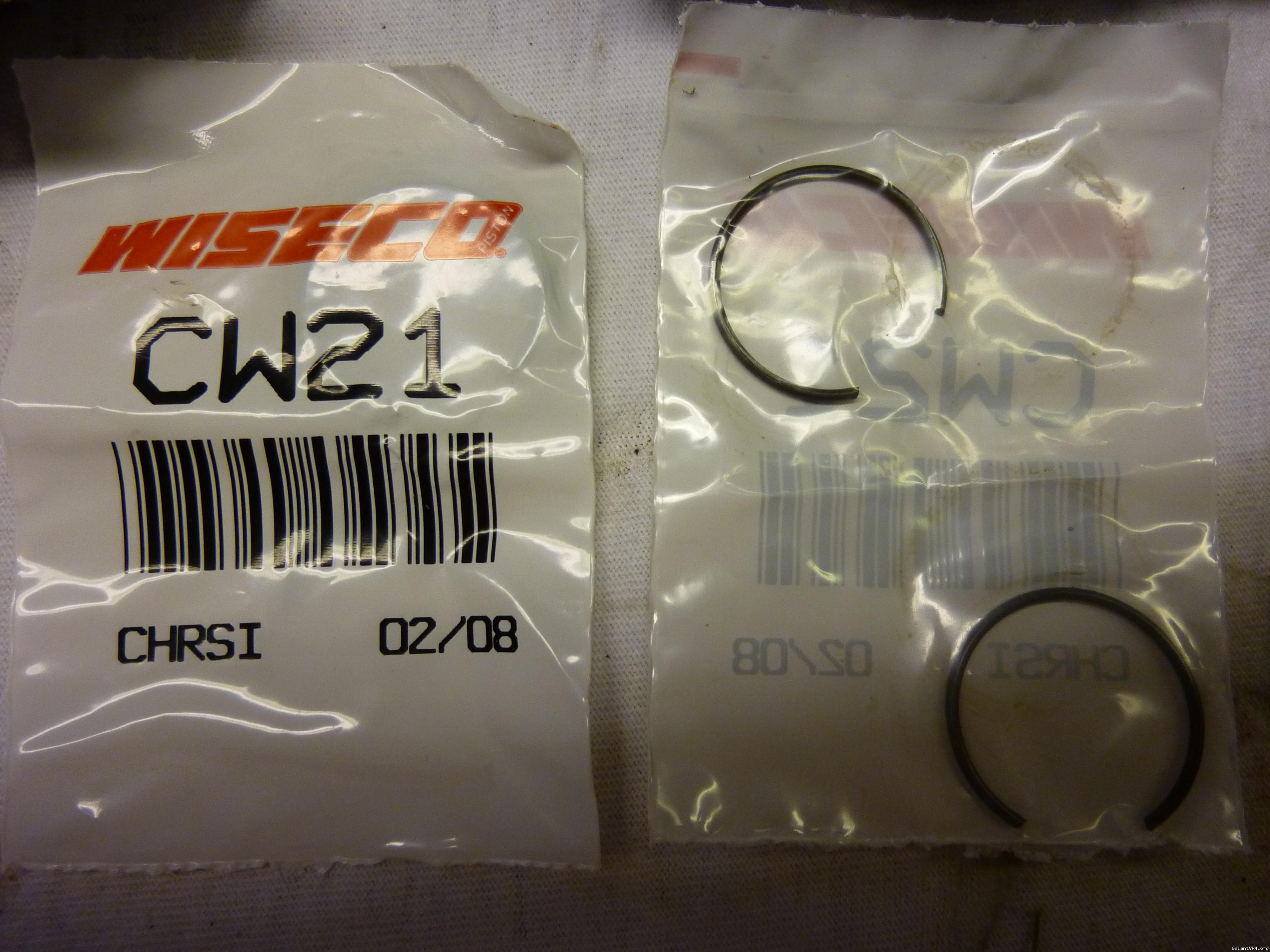

Maybe I'm calling these things Spirolox and they're not. Maybe they're just snap rings. Here are some pics to help:

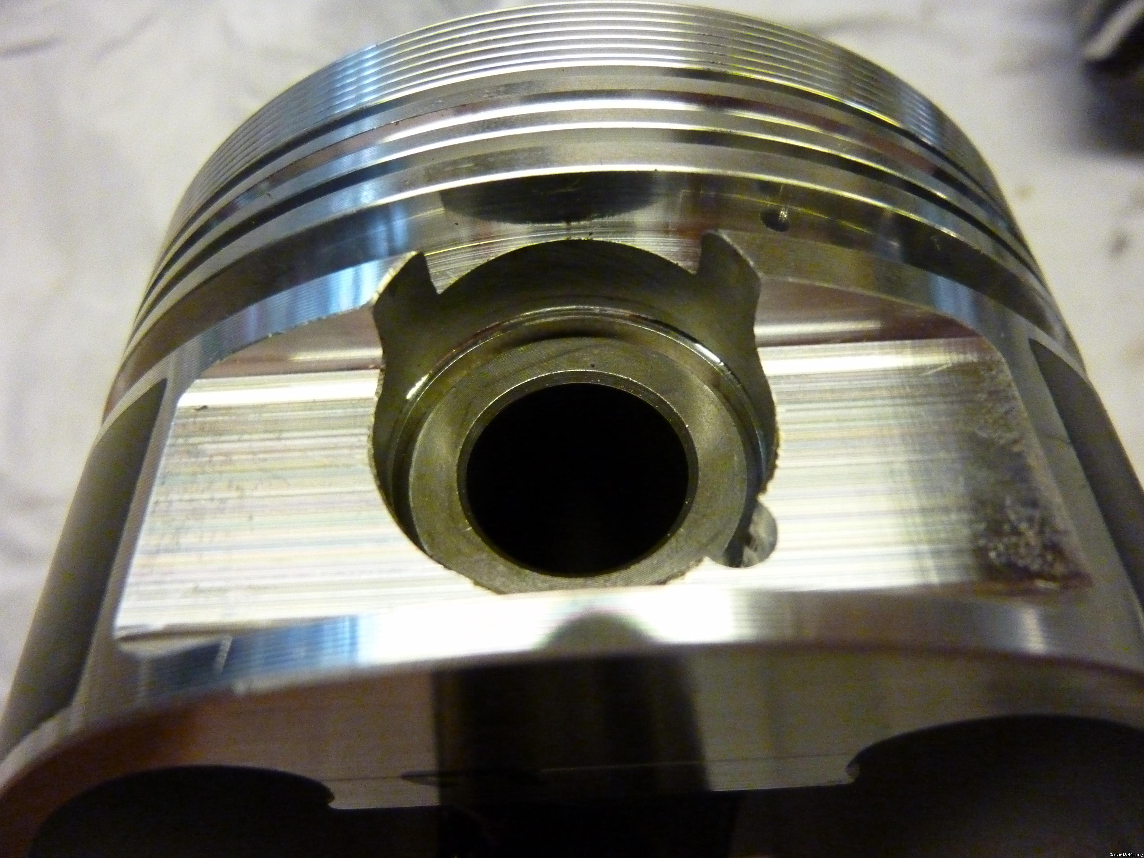

Here you can see the groove the snap ring, Spirolox or whatever they are fit into:

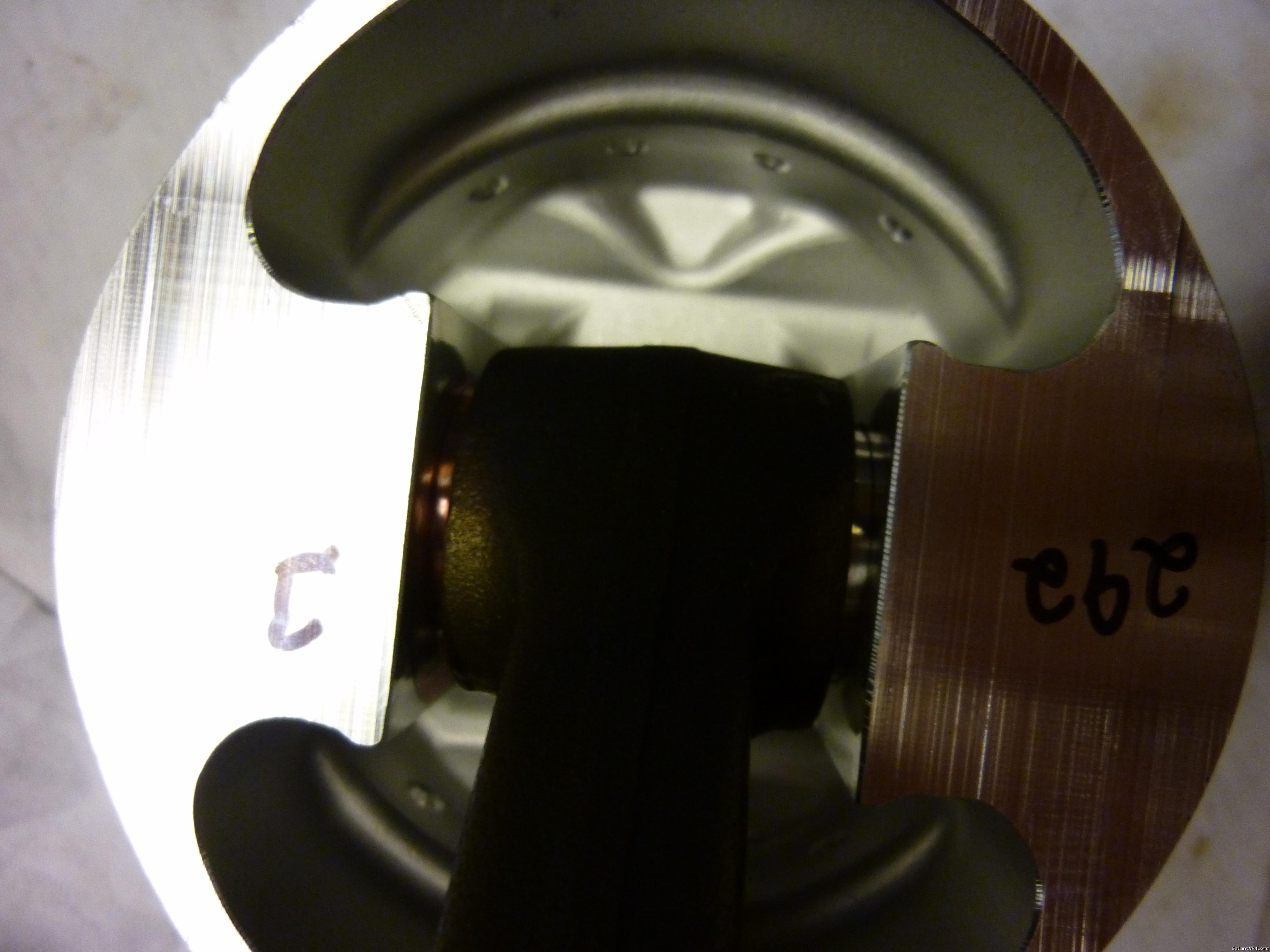

And this shows how the wrist pin presses into the small end of the rod, but floats within the bore of the piston.
My issue is how to center the wrist pin in the rod. Any suggestions? Has anyone done this before?

Those are snap rings. They install like any other (aka, compress, get an end seated and work your way around), but are for retaining a full floating piston and rod.
If you're set on using the stock rods make sure you have the appropriate wrist pins and have a machine shop press them in. The snap rings will not be necessary.

It is true that the crank will position the rod where it needs to be. But the issue is not the location of the rod in relationship to the piston; that will take care of itself. The issue is the wrist pin in relationship to the rod. If you look at the 3rd photo above it may help. I want the same length of the wrist pin sticking out from each side of the rod. It will be a trial and error process because you can't see anything when it's set up in the press.

Gotcha. Yeah, just gotta keep measuring and pressing a little until you get it where you want.

Don't use the snap ring to retain the wrist pin when using the a non floating wrist pin setup.
On a full floating wrist pin setup, the distance between the 2 snap ring grooves is exactly the length of the wrist pin itself, the rod will adjust to the center of the wrist pin as the engine is running.
In a press fit assembly where the rod is press fit onto the wrist pin, it may be impossible to find the perfect center. When a press fit assembly is running during service, the rod will try to move on the crank and will be the variable that will put the small end of the rod where it want to sit, fore and aft, when the wrist pin is pressed fit into the small end of the rod then this will move the wrist pin forward or backward depending the rod final position on the crank. If you have the snap rings installed in this scenario, this fore and aft movement of the wrist pin might be enough to dislodge the snap ring from its groove and walk it towards the wall.
