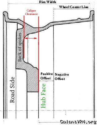

The off set has little to do with the fitment of the brakes. Spoke design is more critical for brake clearence than offset. The offset could be 100% spot on but if the spokes curve in to much they could hit the calipers.

Brake clearence is low on that wheel I can tell you that. They will clear most standard brakes. But not BBK. Brake clearence is all in the back pad of the wheel. Nothing to do with the offsets.

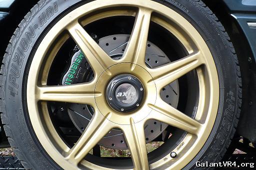

I had to use a 5/8" spacer on mine to clear my 17" axis rims. Ending up doing back to match but front sticks out a little further then the rear. Calipers just barely clear rims. Those rims look good.

I agree that, for caliper clearance, offset doesn't play as much of a role as spoke design. Having a smaller offset will get you as much room as possible though.

The distance between the hub face and the back of the spokes is the critical part. I don't have the measurements at hand so, from memory, you need around 45-55mm to clear 'large' 4 piston calipers (Evo Brembos) and around 40mm to clear 'small' 4 piston calipers.
