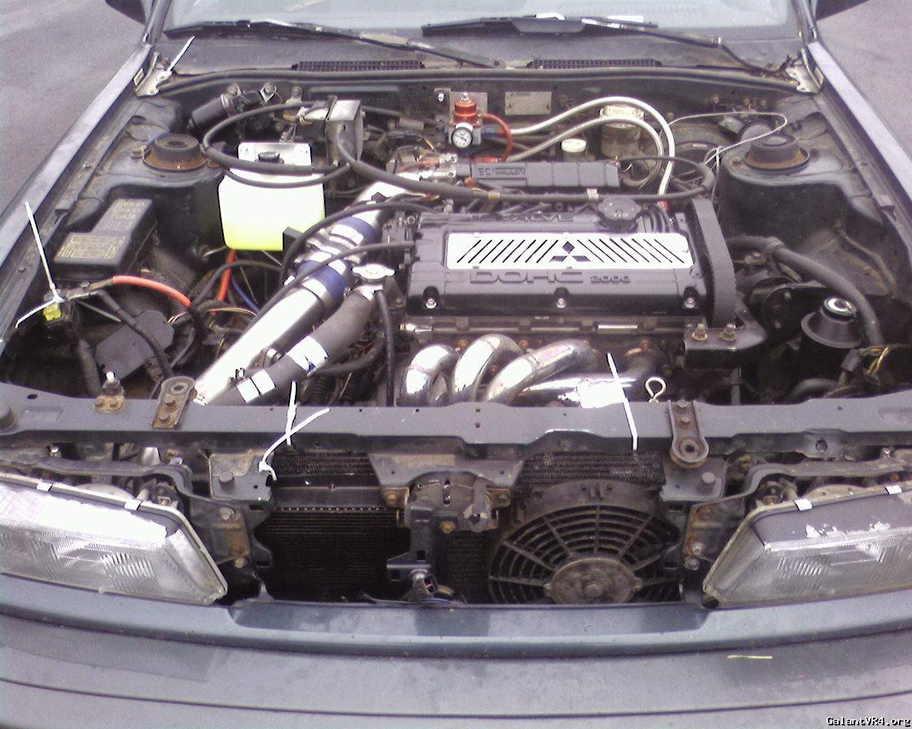

If you want to do it for cheap, I have a suggestion.
1987 Audi 5000CS
I think it was the same up through 91
I bought mine at a junk yard. $50
No rust, perfect condition (minnesota is a rusty state, if anything can make it 20 years with no corrosion, thats simply amazing)
The radiator fits PERFECTLY where the AC condenser used to be
Room for intercooler pipes on both sides of the radiator with MINOR trimming of plastic tabs
This baby is thick! 2 full inches! (replacement radiators are like 3/4 thick)
Having been disappointed in replacement OE radiators, let me attest to this one's quality!
There is minor fabrication required to make mounting brackets and lengthing radiator hoses, but its totally worth it! (you also need a DSM water neck w/cap)
Great suggestion! Are the water fittings on the radiator on the same side, like stock, or does one hose need to be a lot longer? Also, did you source your oil cooler and rad fan from the same car? If not, then from what?
Yes, bot fittings are on the same side, the placement is a little different then stock, some muffler pipe and extra DSM radiator hoses solved this problem quickly.
There is an overflow tank tube on the drivers side of the radiator that also needs to be blocked off.
If you want more detailed pics I can get em up monday.
The fan was taken off a friends DSM as payment for my services. its a 10"
(www.siliconeintakes.com has good fans.)
(This radiator measures 12x24 so you cant run the straight blade 14" fans, only the 12" fans, or 10 if thats what you have)
The oil cooler I got from MAPerformance.com, all the an SS lines, fittings and adapters $160, kinda pricy, but I cant afford to lose oil pressure, if i leak coolant i can survive that problem.
