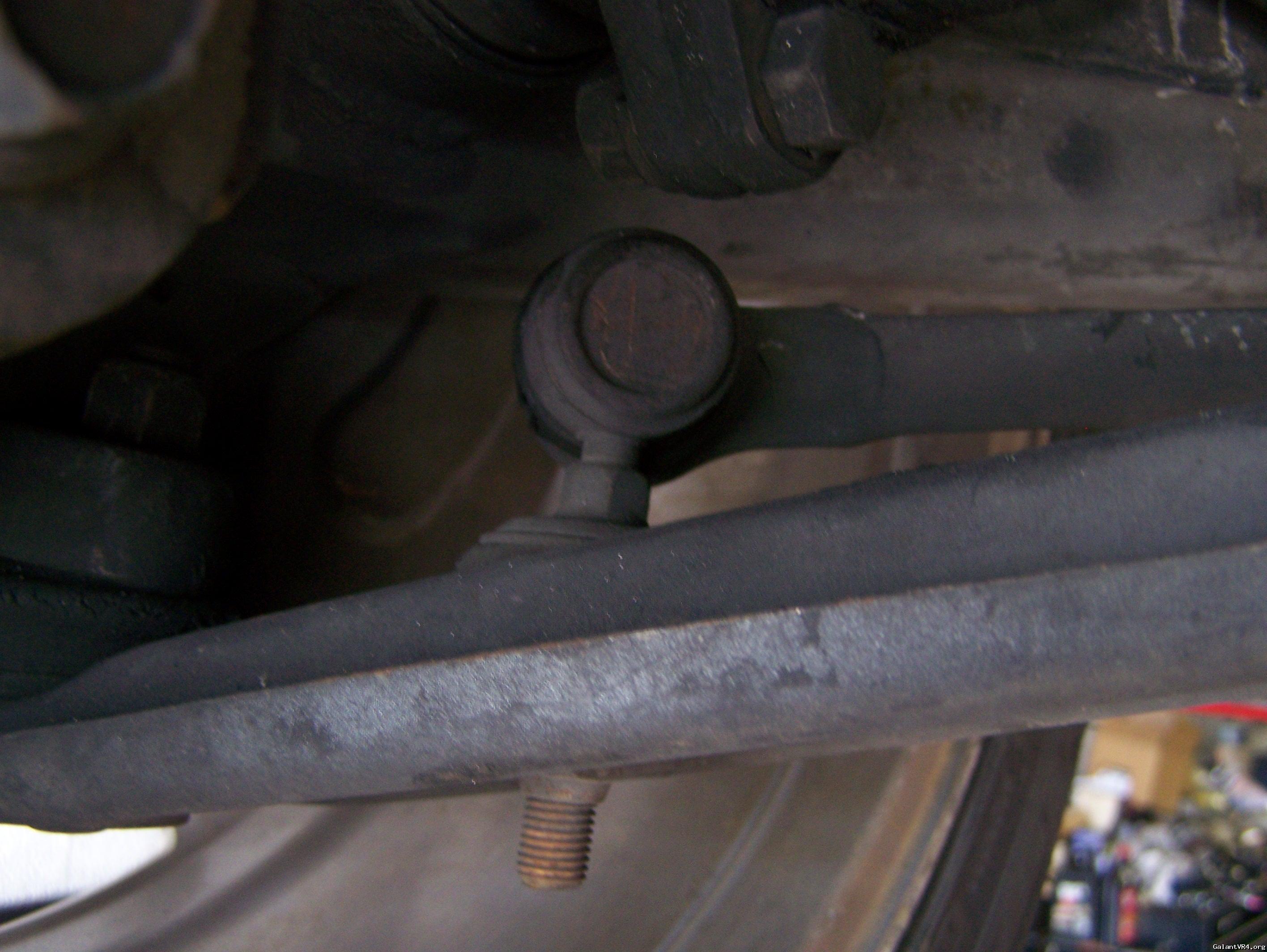

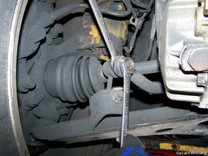

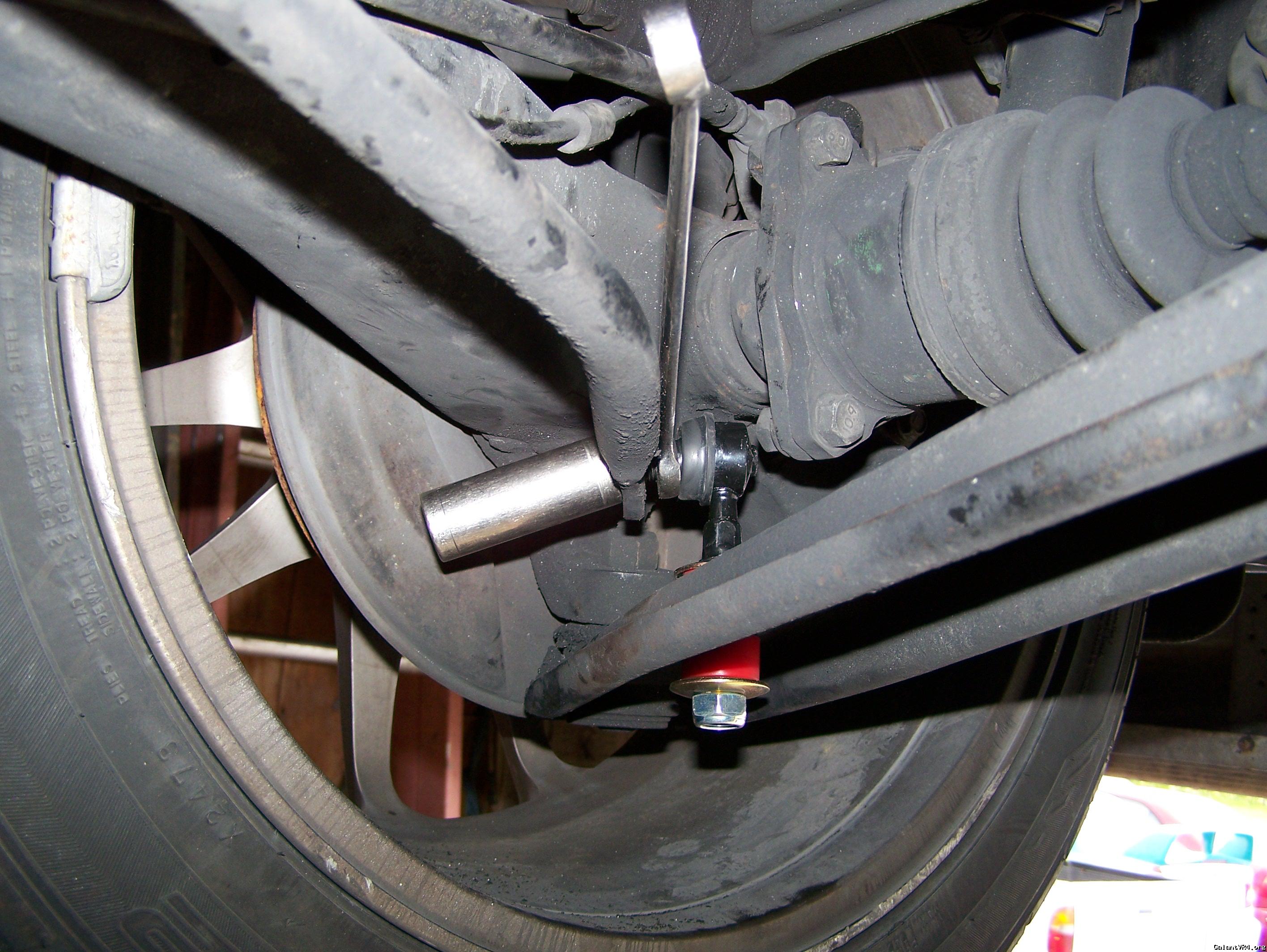

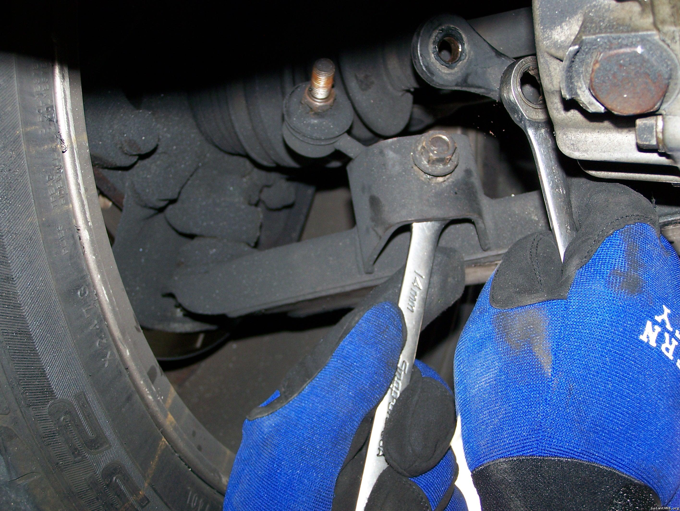

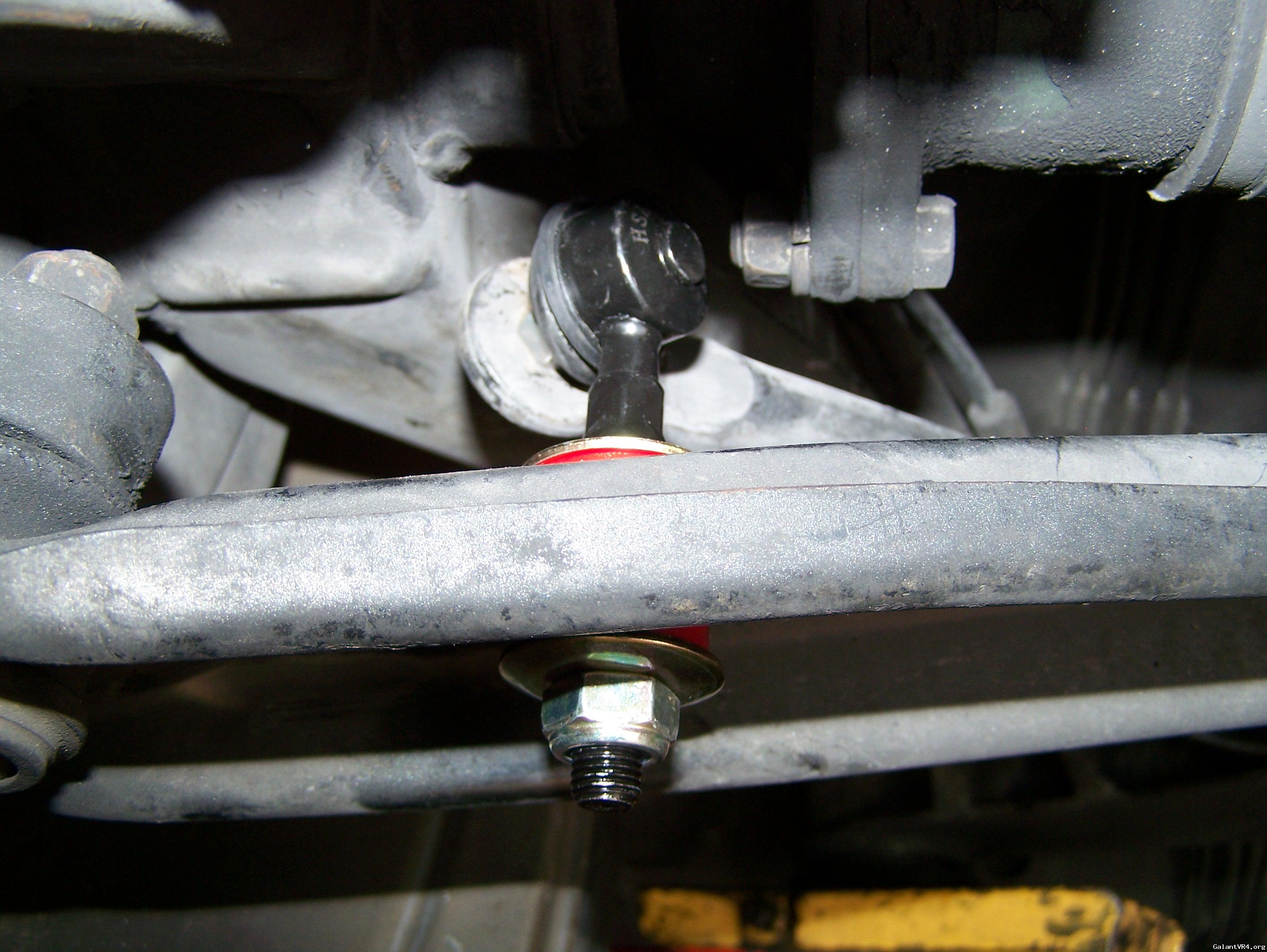

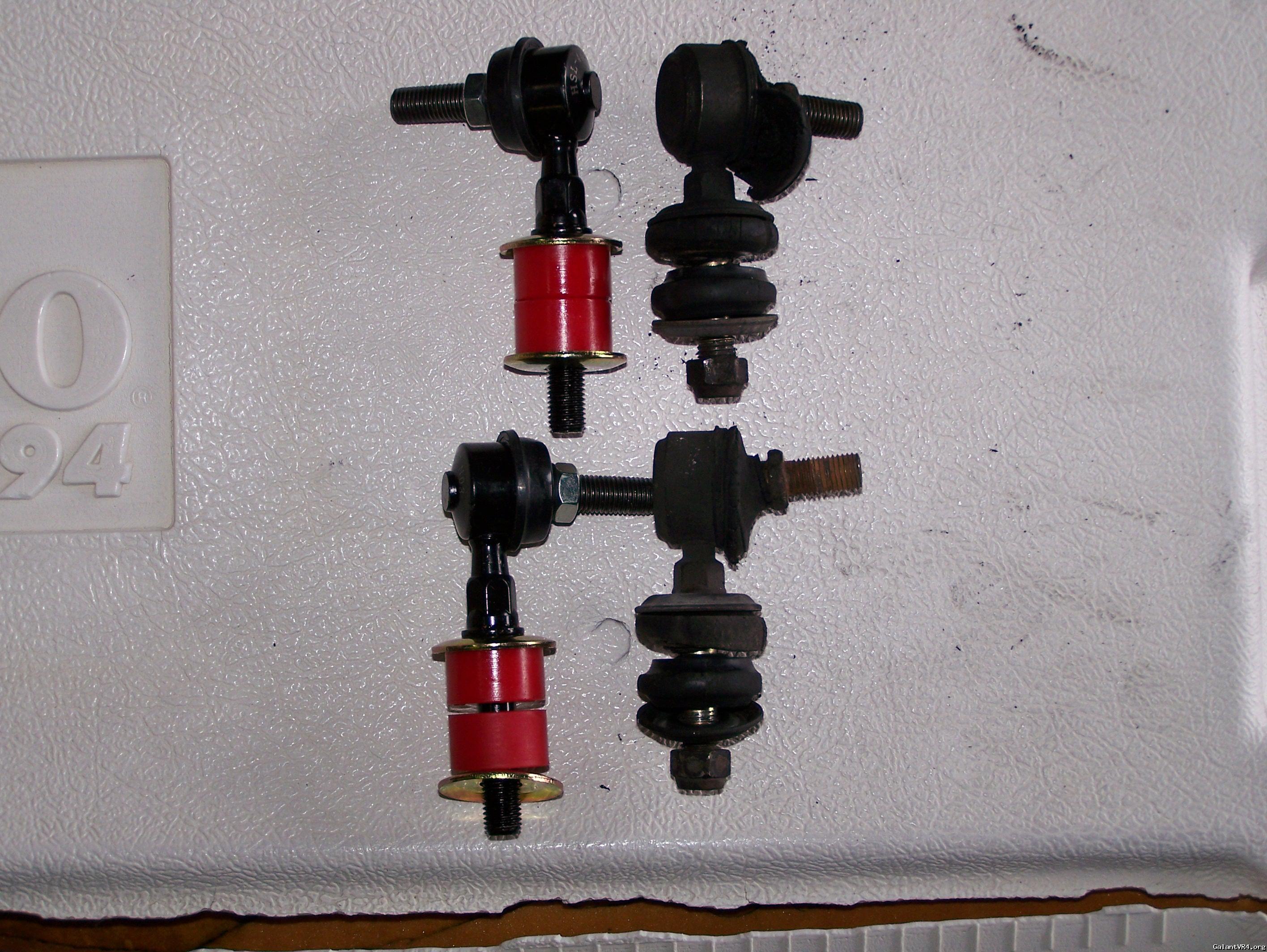

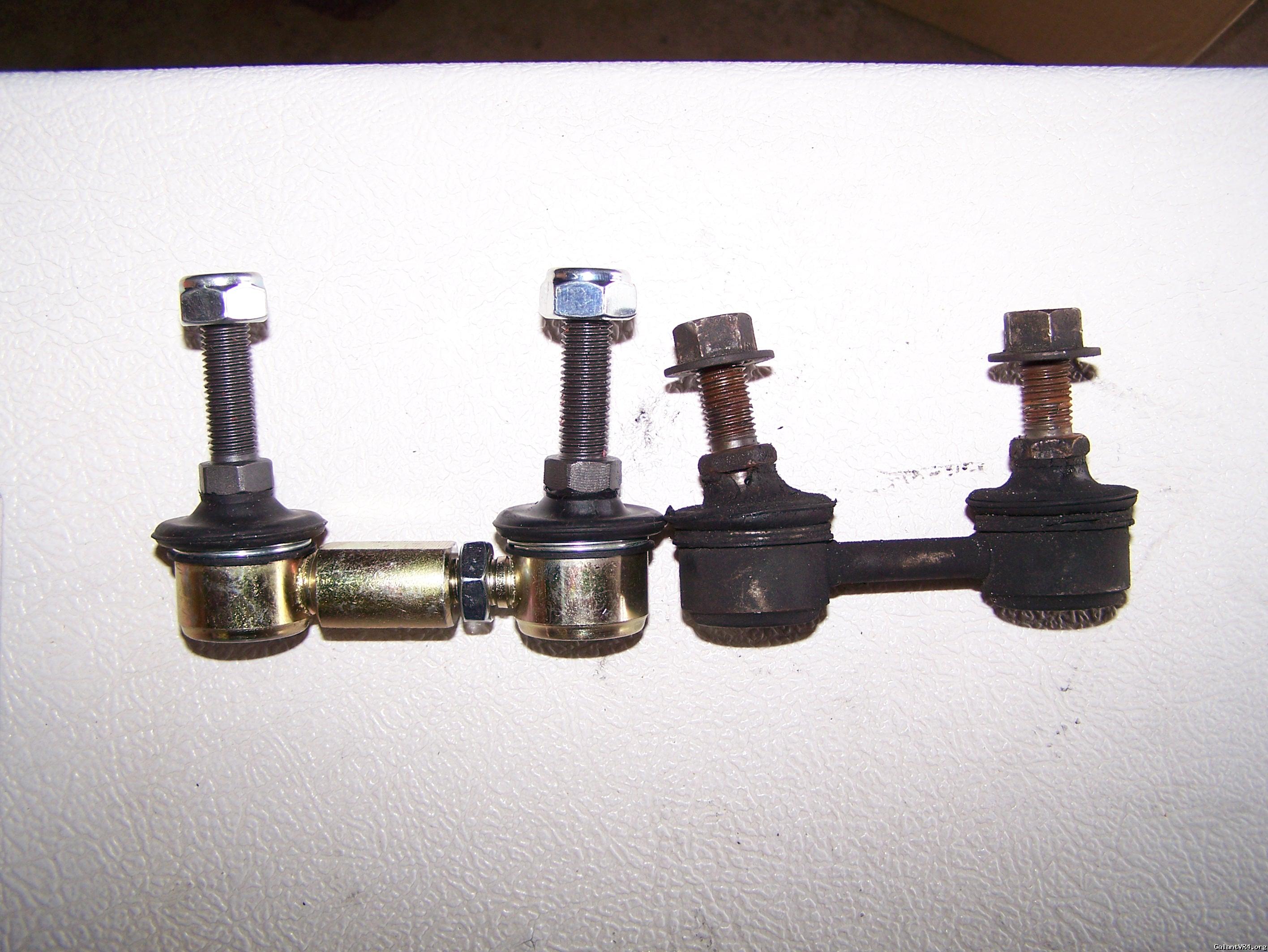

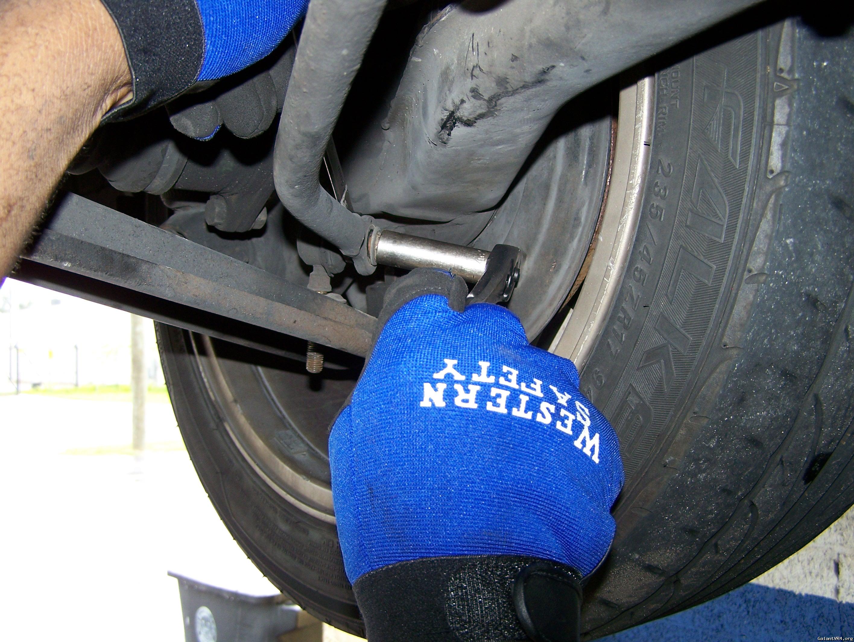

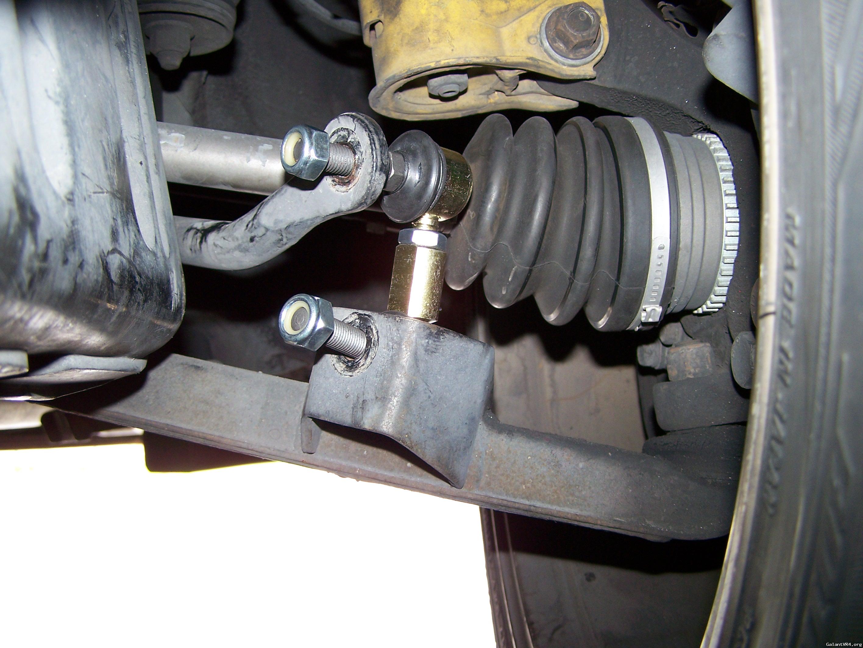

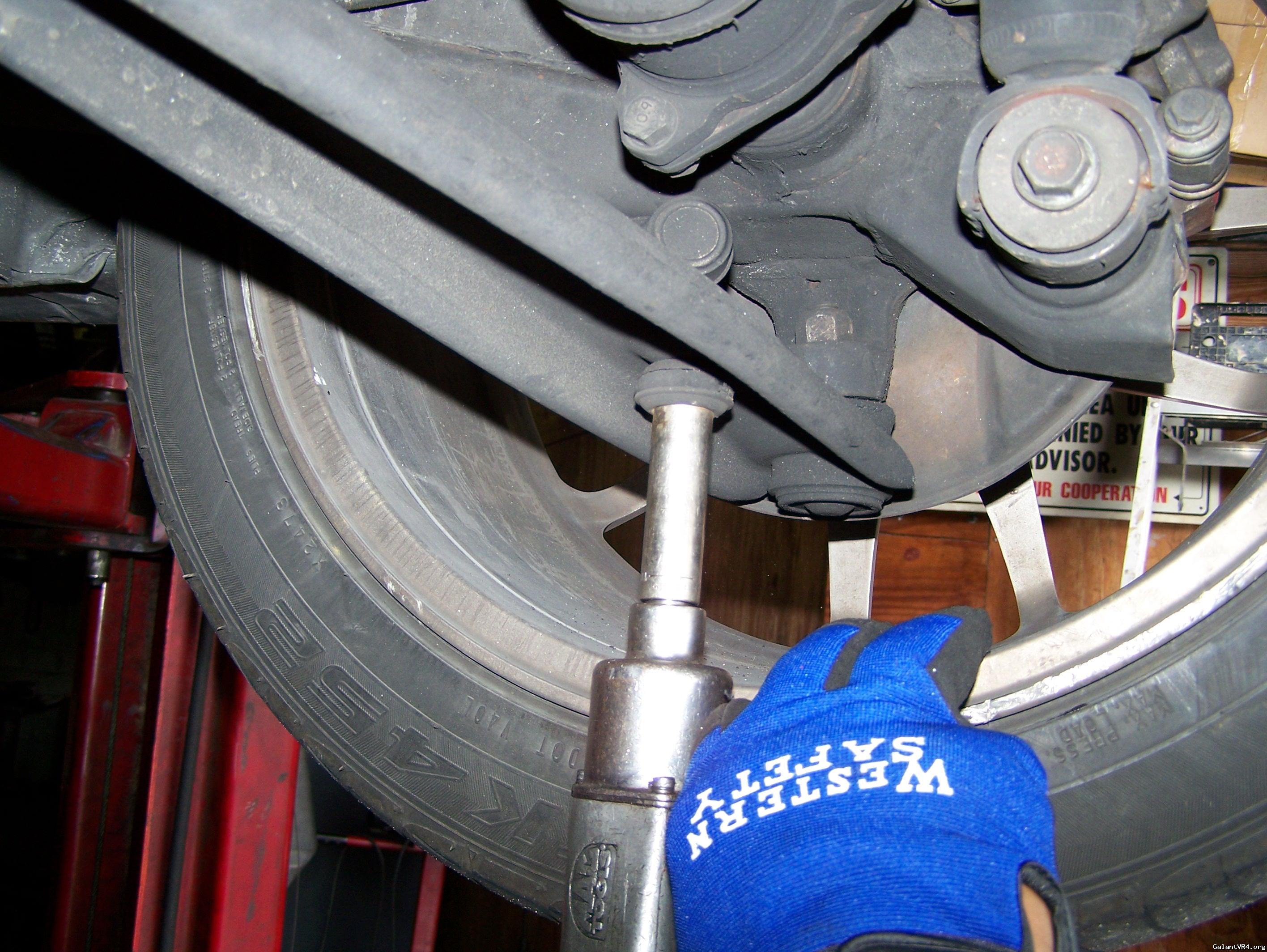

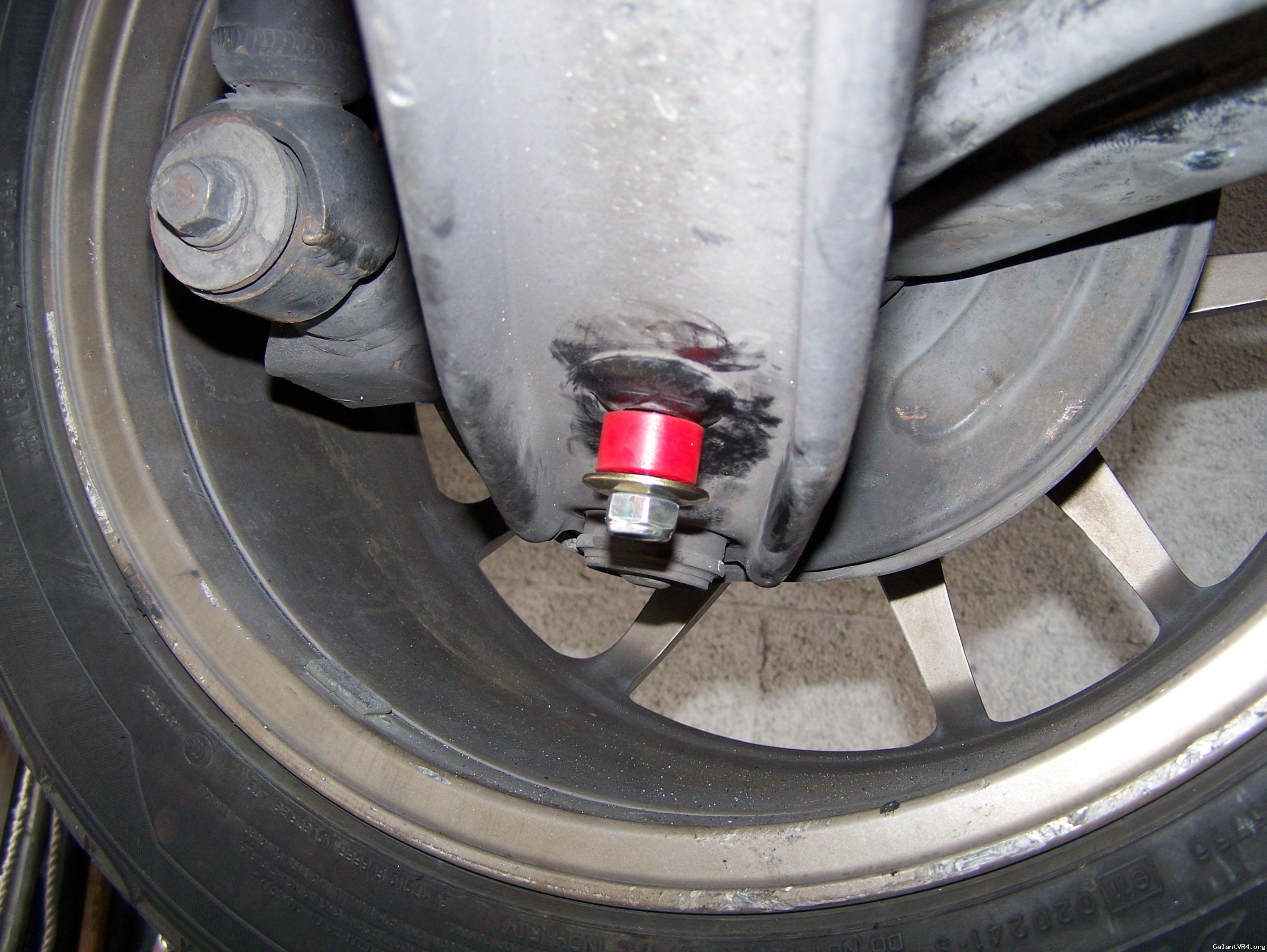

Finally, we were able to install the rear endlinks on my stock sway bar. Everything went smooth /ubbthreads/images/graemlins/applause.gif I've relayed the info back to Whiteline & I'm waiting to hear back on pricing & availability. There were some differences between the length of the Whiteline bolts (longer) vs. the oem ones but that didn't interfere with anything at all. My endlinks had to be the original ones. I know I've never changed them in the 8 years of owning this car.
Tools required: 14mm deep socket, 17mm deep socket 12mm wrench/spanner
Onto the pictures:
We also did the fronts as well.
