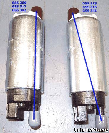

I am getting ready to buy a walbro 255 ... I thought I read somewhere on here (can't find it now) that the 2G walbro fits the galant better than the 1G ... is this true or does it not matter?

I definately could be wrong. I just put a new GSS-341 in my car right before I dynoed it 2 weeks ago. It already had a GSS-341 in it. The GSS-341 was installed years ago & it's been so long I don't recall if I did any mods back then.

I have a GSS315 sitting on my coffee table, neatly cradled in a FACTORY gvr4 fuel pump housing. The 341 should work fine.
I have a GSS341 sitting (brand new) right next to the assembly. It looks identical, and should drop right in. No worries.
I'll pull the FACTORY-STOCK pump assembly out of 555 tomorrow afternoon and compare stock vs what i have here. I'll take pictures and post them as well.
It looks like i may have done a little bending on the tube to get this pump to work, though. It's honestly been so long, i can't remember. I'll be sure and post something that will show any differences in mounting in detail.
EDIT: after looking at this link, it appears as though i must have bent the tube from mounting plate to pump, but it still worked out ok

I'm a little confused, you mentioned "factory stock" assembly, but the images with the walbro installed show hose clamps and fuel line.
