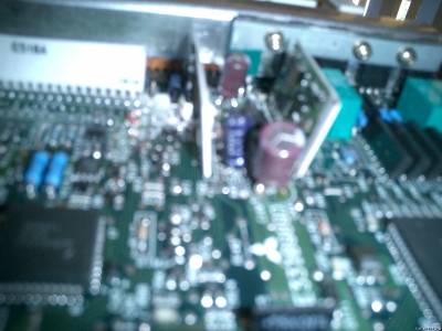

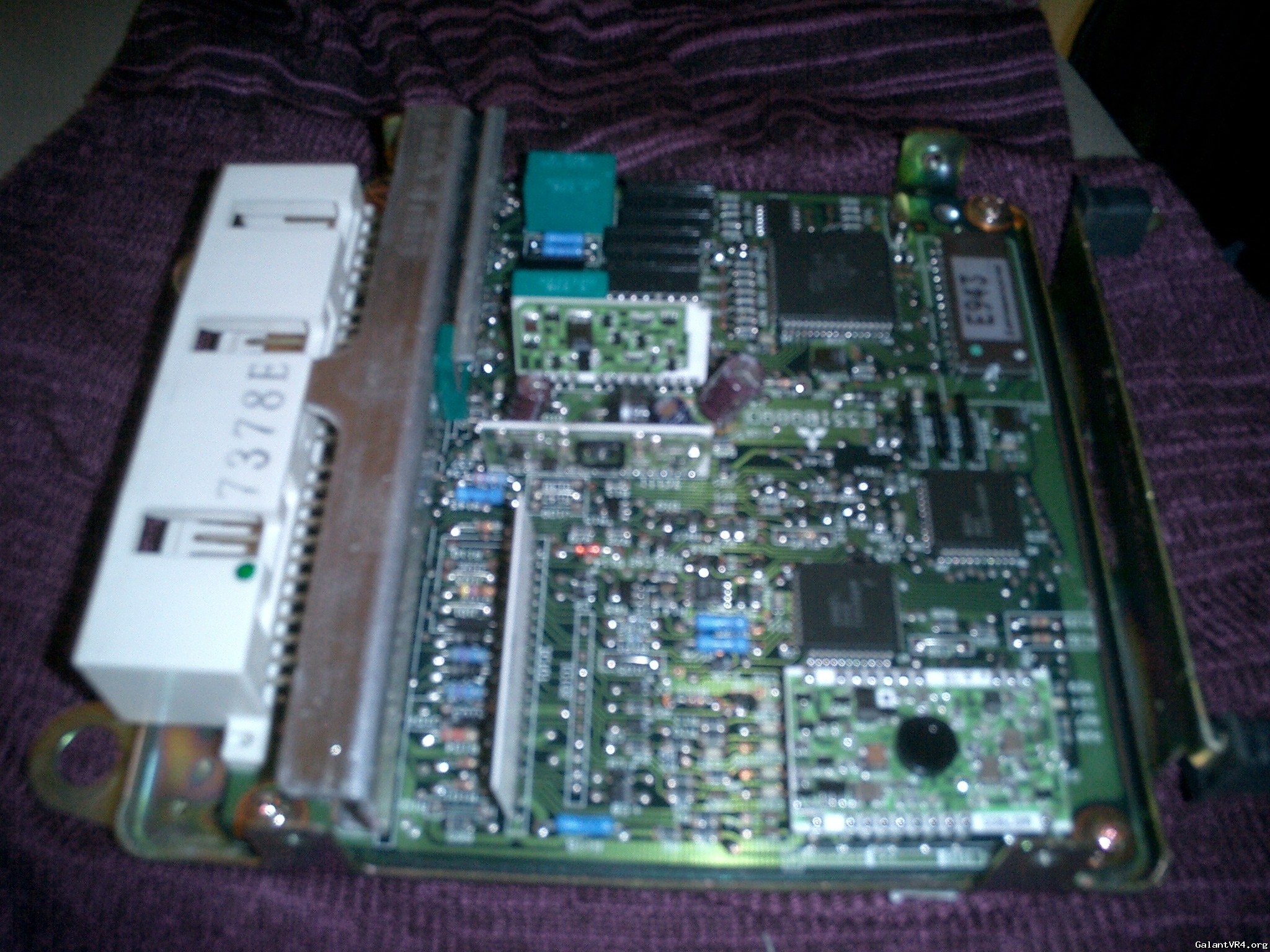

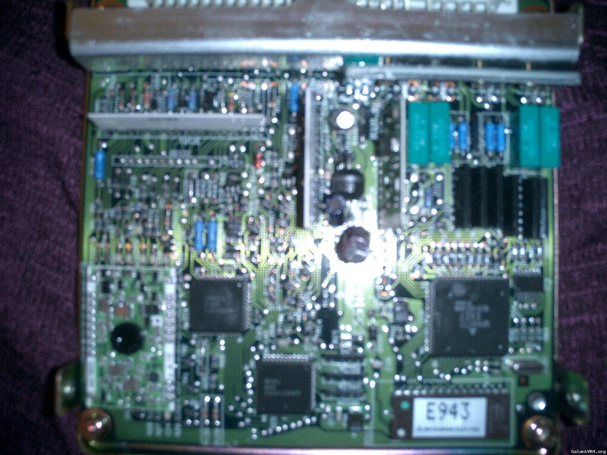

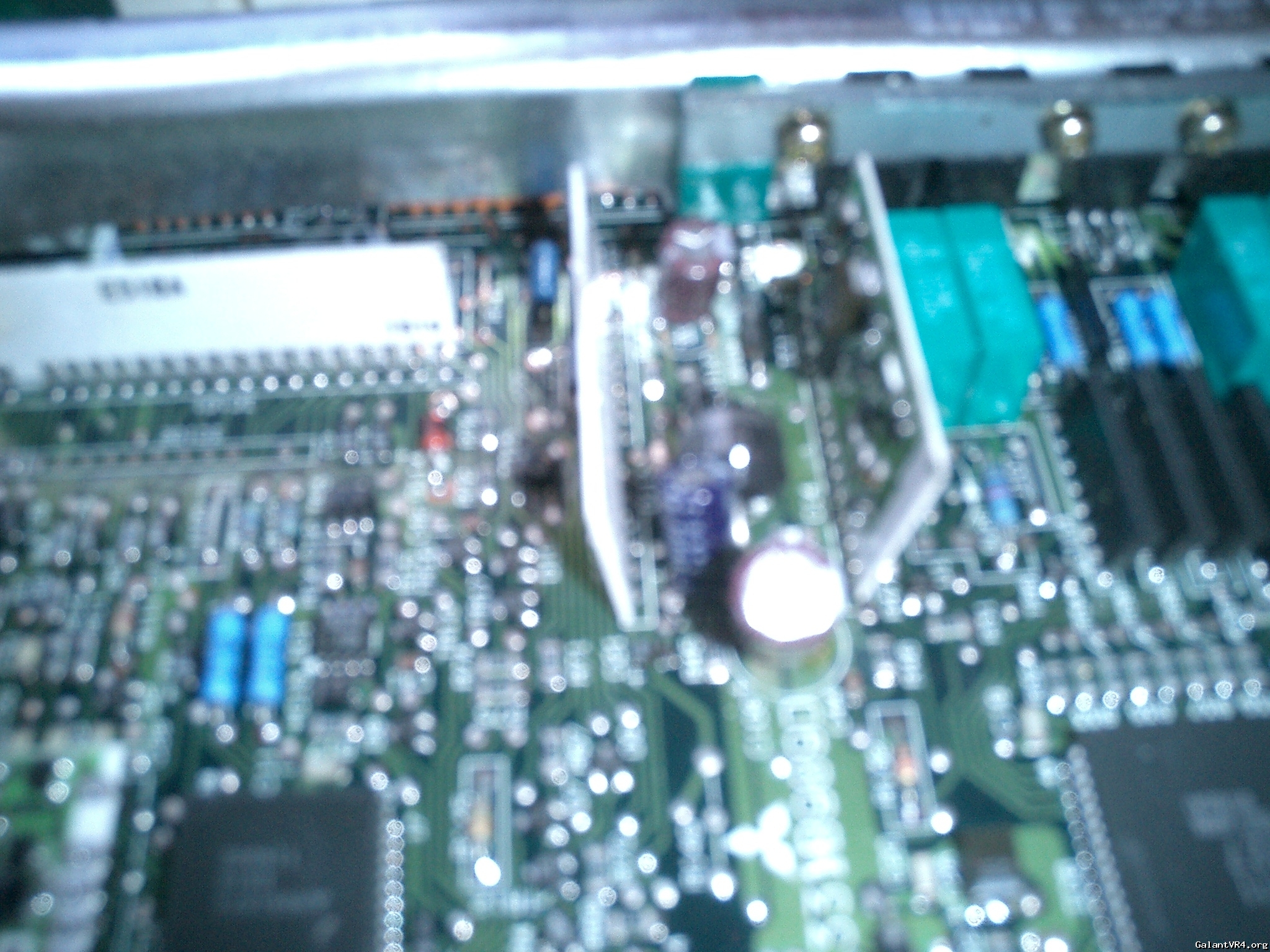

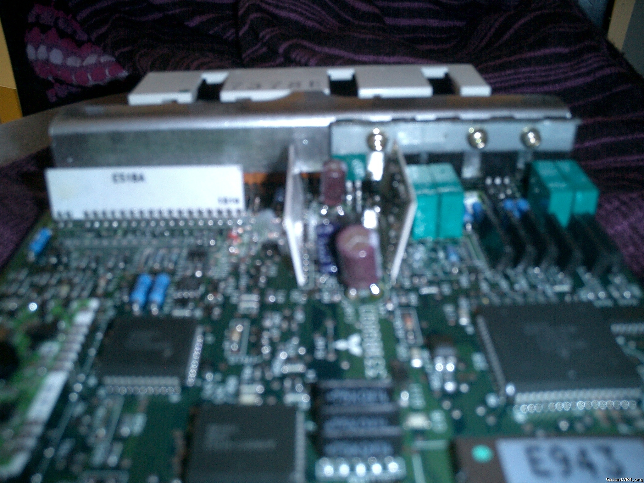

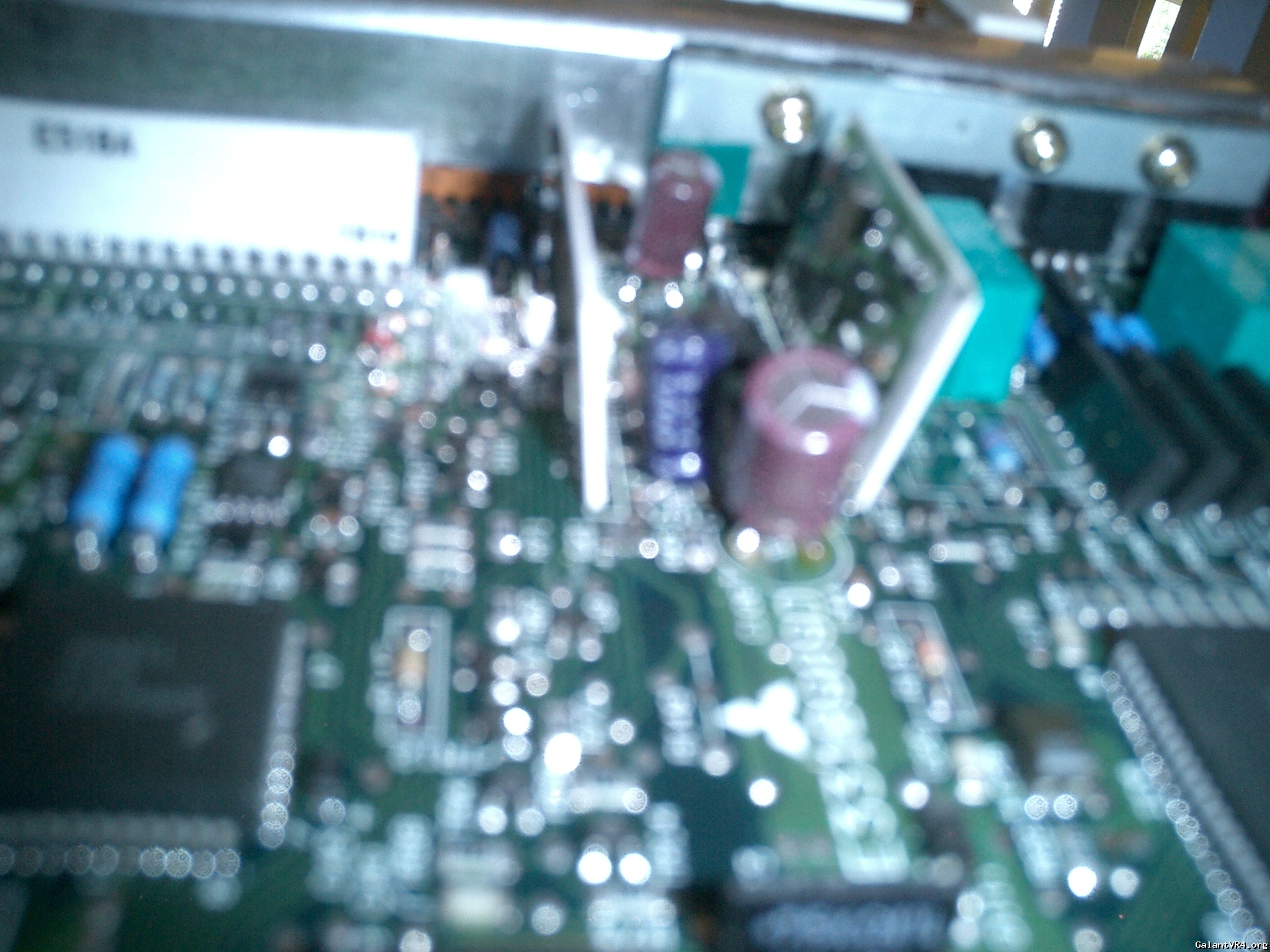

getting ready to send ecm to keydiver,posting pics of ecm boardto make sure it is ok.
this is a spare ecm i have. the board looks clean there is a sticker on it that it was rebuilt in june of 08.
Its hard to tell from those pictures, but it looks pretty clean, like someone got to those caps before they leaked real bad.
