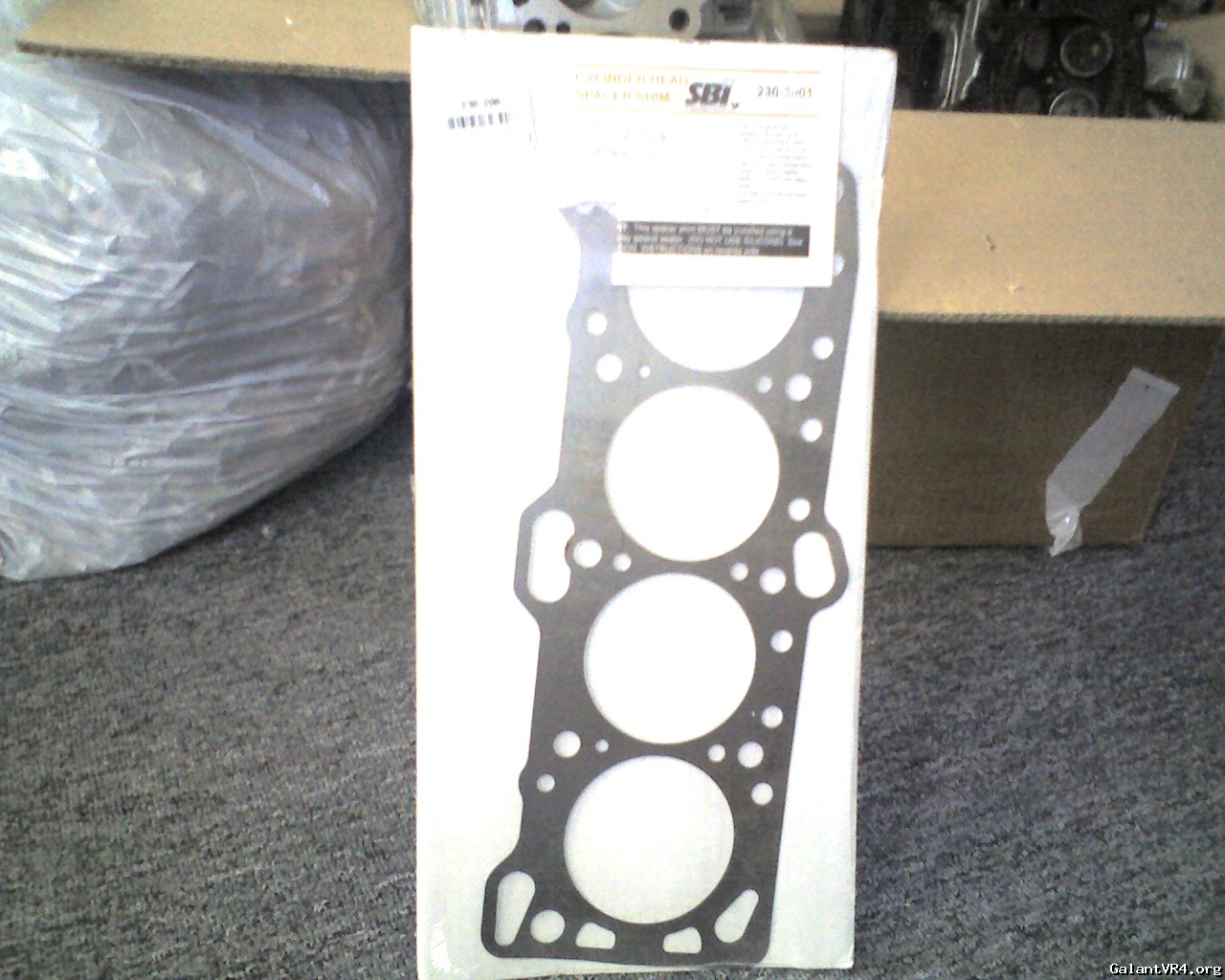

Just got a reman. head and it came with a shim. The instructions suggest a sealant to be used but doesn't say which one. Has anyone used a shim with sealer?
johnnyRacer
Jan 9, 2005
780
Tampa, FL.
The way it was explained is that after the head goes through its machining process for flatness the compression ratio will be higher now. To correct this a metal shim is used to bring the CR back closer to spec.

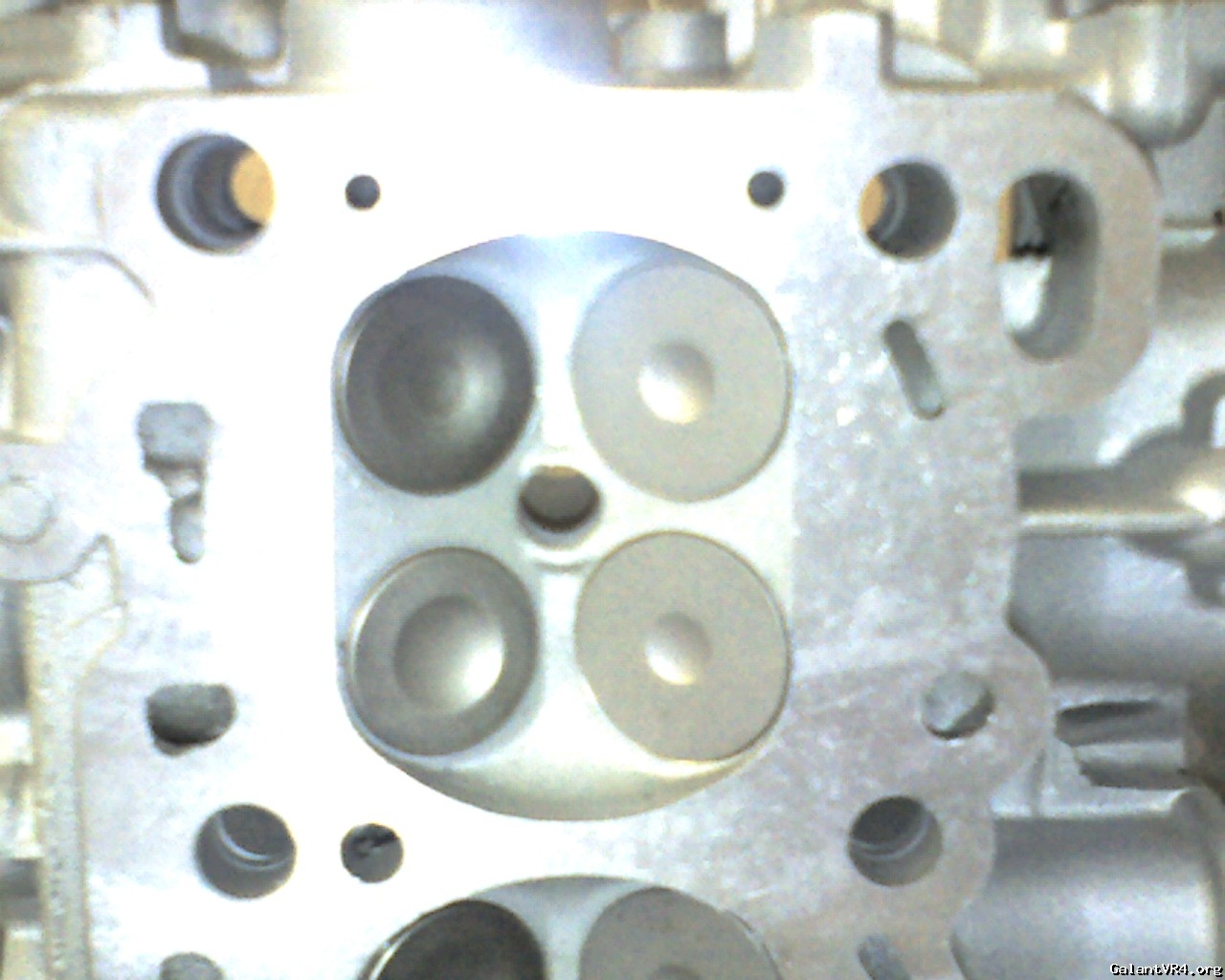

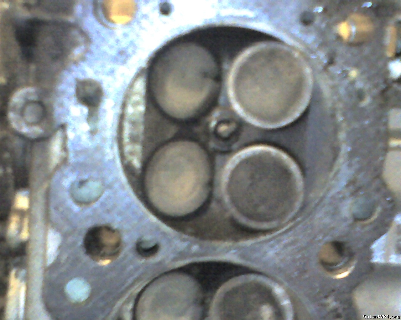

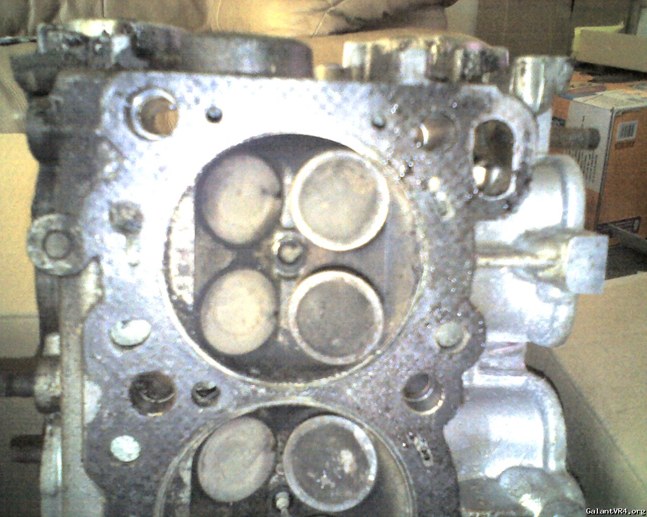

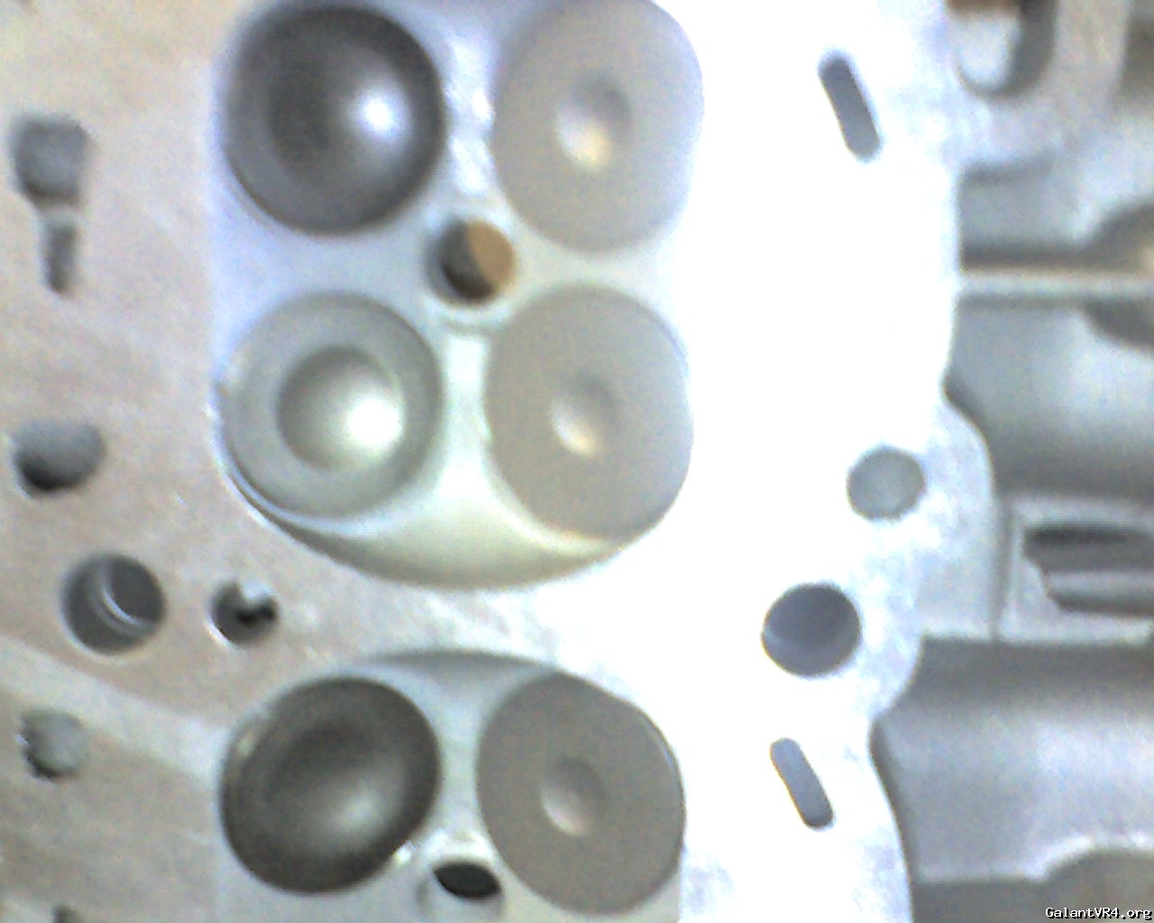

I talked to the machine shop that I got the head from. They said I can go without the shim, especially since I'm planning for 20+ psi of boost. When I ask how much was shaved off he assured me that it was minimal. Here's a few pic, what do you think?

The OEM MLS gasket is thicker than the stock one by about .4mm after it's compressed (stock = 1mm, MLS= 1.4mm), which is just under .020 inches. If you just run the MLS gasket without the shim, you should be back very close to the stock compression. The MLS gasket is thicker precisely for that reason (shaving the head or block during a rebuild, without having to use a separate shim like that).
Spacing the head out a bit with it shaved that much is important, since your piston-valve clearance will be affected, and also, your valve timing will also be a degree or two off due to the shaved head, because the distance from the crank sprocket to the cam gears will be shorter by half a tooth or so.
The combination of the two could potentially result in piston to valve contact, which is bad. You might be fine if you degree it back in with some adjustable gears, but using the thicker gasket is the most foolproof way to go.
The sealer you want is Permatex Copper High Temperature Gasket Spray, or something like that, and you should use it with the MLS gasket

The cheapest two options would be to either acquire a MLS gasket, or just go ahead with the shim and an OEM composite gasket. The first option is better, but if you aren't planning to push the motor hard (you mentioned a DD motor, I assume with a small turbo), the shim+OEM should be fine.
