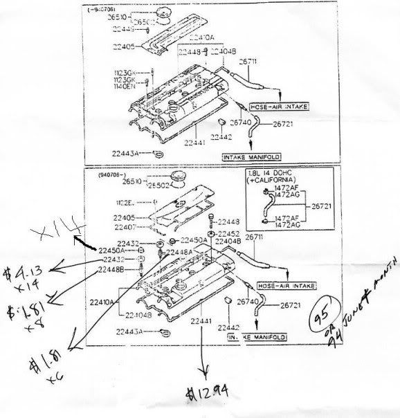

Gottcha. thanks for posting the part numbers too, dsm06. hahaha i like your thinking curtis! that was my first thought to do something like that. the gear was bent a bit in the removal...

Oh, and the gasket kit you'll need is for a 95 hyundai elantra gls with the 1.8.

The washers are also required (rubber coated). The nuts too.
You will need a different valve cover gasket (from Hyundai).
Keep in mind also, not all spark plug covers will fit, the Hyundai ones have a tiny difference in the bend near the oil cap.

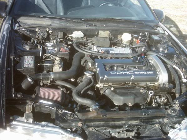

Got all the washers and nuts when i picked up the cover. glad to hear that someone else has ground down those two by the cam gears. that's what i was thinkng of doing. thanks for all the responses and help! now all i have to do is find a carbon fiber cam gear cover like bazeng's.....

To remove my valve cover I loctited the studs to the nuts on the cam gear side (4 of them)
The other studs are ok to stay. Also if you have adjustable cam gears, sometimes the bolts off the cam gears get in the way so you have to back them out slightly to clear the valve cover when removing.

I loctited all the studs to the head so they don't come off when undoing the nuts except for the 4 on the right hand side (next to the cam gear cover).
The 4 cam gear cover ones I loctited the nuts to the studs (so they become bolts). This allows you to angle the cover enough so it doesn't get stuck under the cam gears when removing.
On the HKS cam gears, the bolts holding the cam gears together are a bit long and need to be backed out slightly to get the rocker cover off otherwise it gets stuck.
