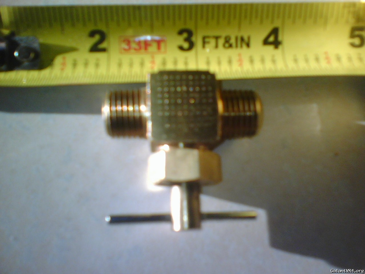

Here's a pic for you Paul:
The overall length is about 1.5" and the ends are 1/4" NPT. If you want it jut let me know and if you want a pair of barbed ends to screw onto it I can get them for you too. I just need to know what size hose you are planning on using for a bleed. Also, the nut just under the handle can be tightened to prevent the valve from coming out of adjustment.
