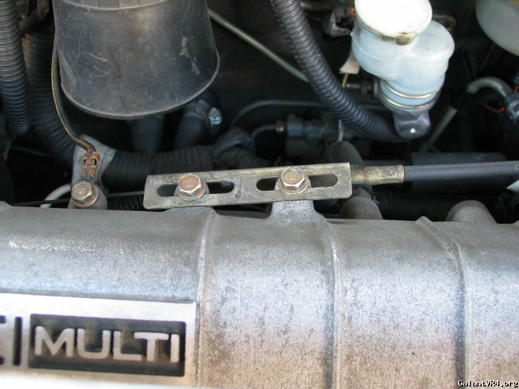

After making sure there is plenty of slack in the throttle cable, it's time to investigate why.

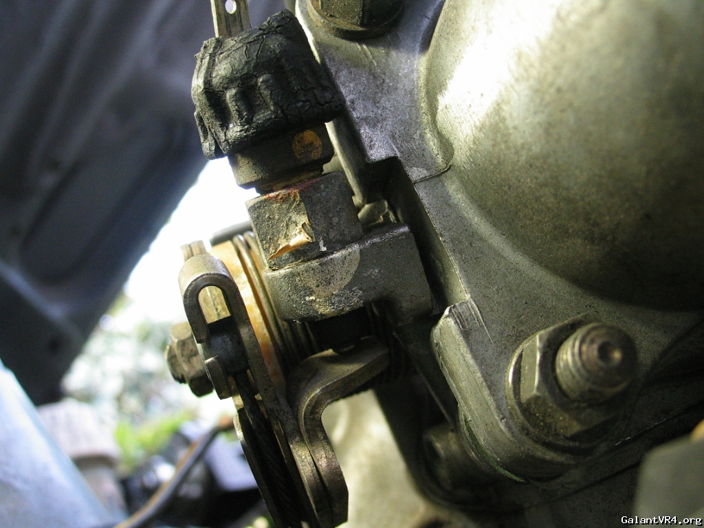

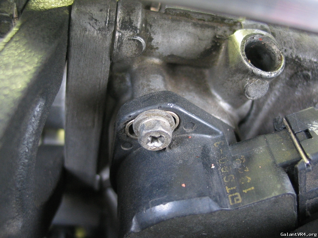

Can you shoot a pic of where it is in the adjustment range?

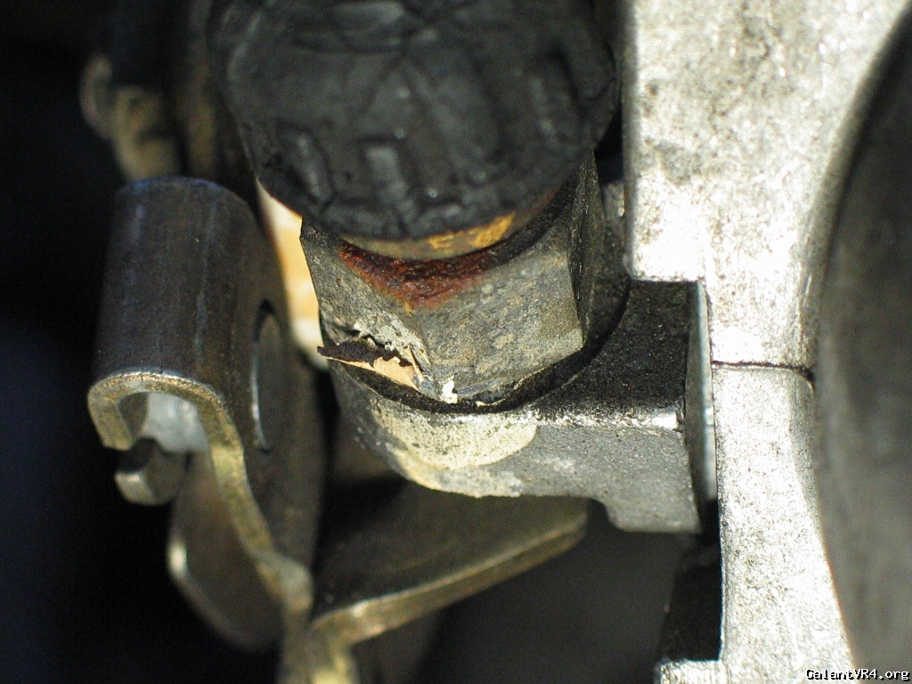

Also, please shoot a pic of the closed idle switch, showing where it is in it's adjustment range as well.
With those two pics, we can determine how much, if any, the position of the tps, (or throttle plate), needs to be adjusted to get things to the sweet spot.

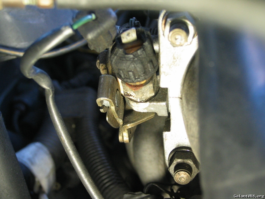

Thanks for all the information. I will check them all step by step and take some pics;for sure the isc was in the 0 Deg. position when I start it up and even the temp. reached normal and it only changed position when I turned on the A/C.
today I took some pics for idle switch and throttle cable, hope those pics can help you guys to find out the adjustment range and position that will fix the problems,for sure I still need to do the boost leak test and check the throttle plate , fast idle valve,isc!!!!!!!!

Thanks for the pics, shows you're serious about fixing this. /ubbthreads/images/graemlins/smile.gif
I can't quite see what I need on the closed throttle switch though... We need to see how many threads are sticking out. Can you shoot one from the same general area, just from lower, pointing up? That's probably the best angle to show the extension of the switch thru the body.
I must apologise for not asking you for a pic of the tps from the side. We need to see where it is indexed in it's adjustment range.
With that info, we can help you get started figuring out what might be out of range.

I unplug the wire just for took a pic and the switch was worked properly when I used the palm logger to check it,I will post the side view pics tomorrow when get back from work.

I will do the boost leak check later when I get the tool done,I took some pics today with the good view angle ,hope that work,if need more let me know.
