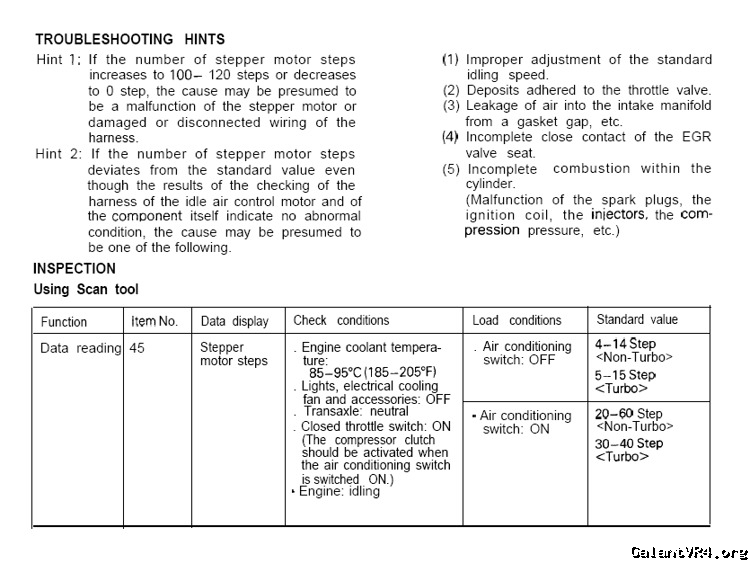

Scott just sent me this. Sheds some light on the situation
I always liked to see mine around 10, with the engine fully warmed up, no fans or accessories running. That way I knew I wasn't going to get idle surge from the ISC not being able to lower the idle enough, but I also knew I had a lot of range above that if needed to raise the idle. Remember, the ISC is just an air bypass, so "0" means its not bypassing any air past the throttle blades.
Jeff, that is exactly how i set it. I believe what the vfaq meant by centered, is inbetween the 5-15 tolerance (5+15/2=10). John was right though, when you do ground the pins the ISC is set to 9. I just didn't notice it the first time
