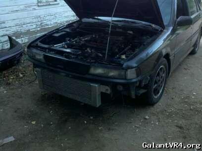

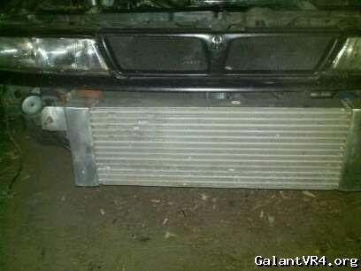

What kind of fmic setup are you running?

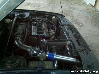

It's an Ebay core, 24" x 12" x 3" not including the end tanks. 3" in and out with Ebay universal piping. The setup is slightly different now than in these pics. There is 4 less couplers because some joints were welded, and the cold side piping is 3" from the I/C all the way to the engine. The pics show the old 2.5" into 3" pipe. The hot side piping is 2.5".

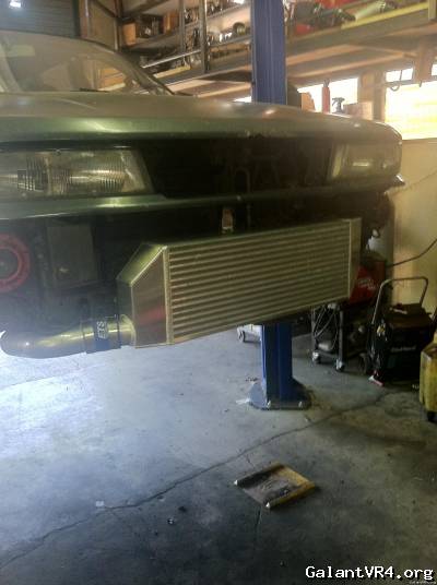

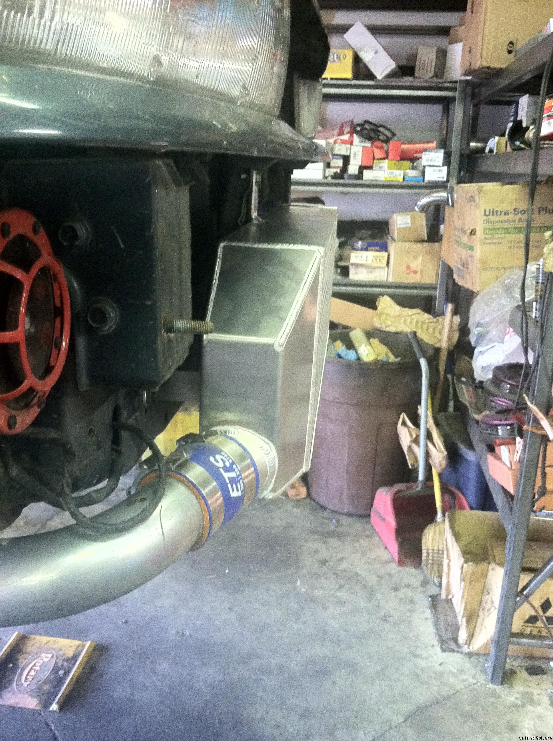

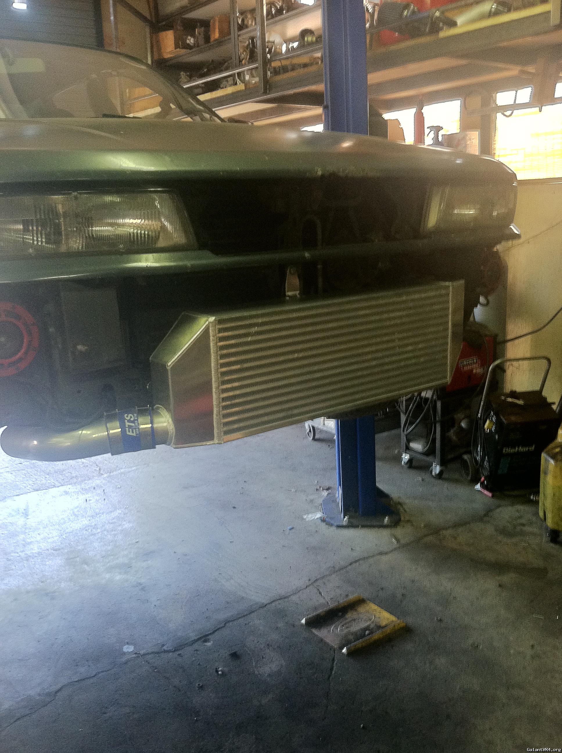

I have a griffin core custom made intercooler for a gvr4. short route version. sorry pics aren't that good they are off my phone. will try to get some more in the next day or so.
