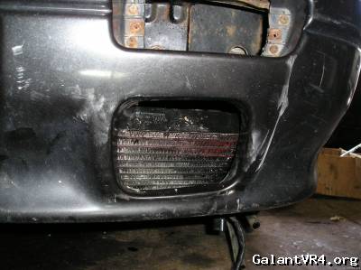

I have the ETS kit with a anodized black core and matching black piping, think I paid around $900, that was of course a few years ago when they first started the anodized cores. I paid a friend a case of High Life to cut the support with a torch.
With my JDM bumper on you can't see the intercooler unless your right up on it which is exactly what I wanted, also you don't need to worry about cutting with the JDM bumper since you rid the car of that heavy support.

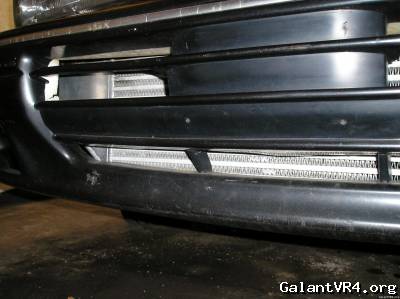

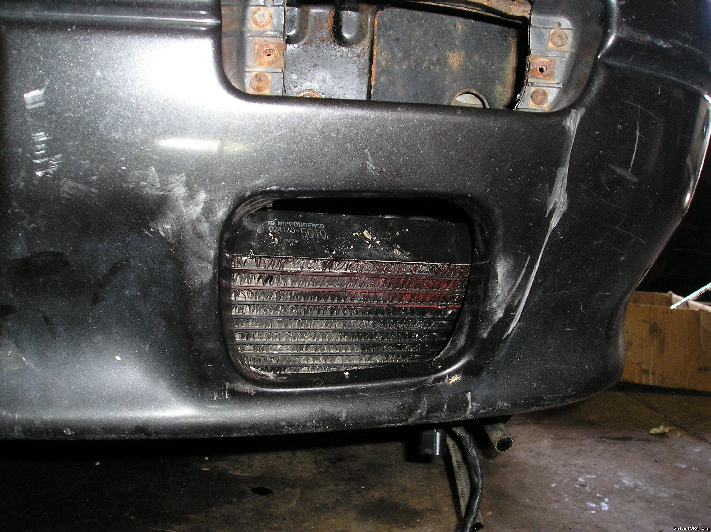

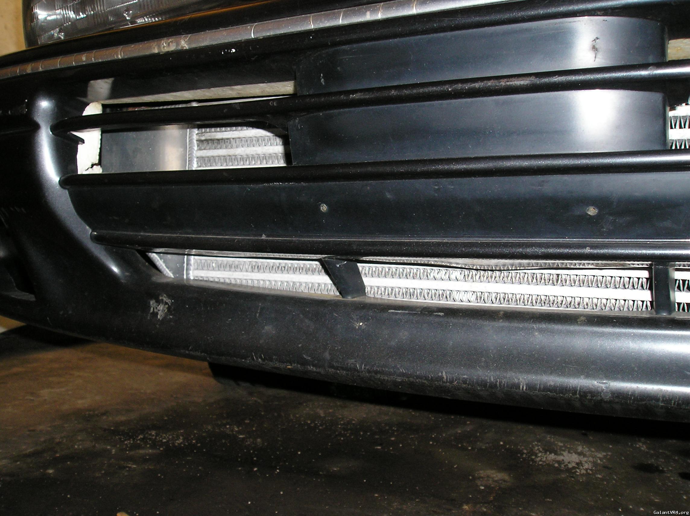

I really like the ETS kit, but i already had a custom kit fabbed up w/a CXRacing core. If your going to go w/a "ebay"fmic. CXRacing cores are the best cores sold on Ebay IMO.
what I really like about this core is it's 11"[not typical 12"] tall which is unique and it clears the hood support bracket w/o any cutting. its solid,good welds, thick/durable end tanks.
also...CXRacing has some of the best IC univ.pipe kits out.Good t-bolts & quality couplers.;

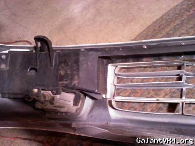

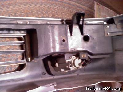

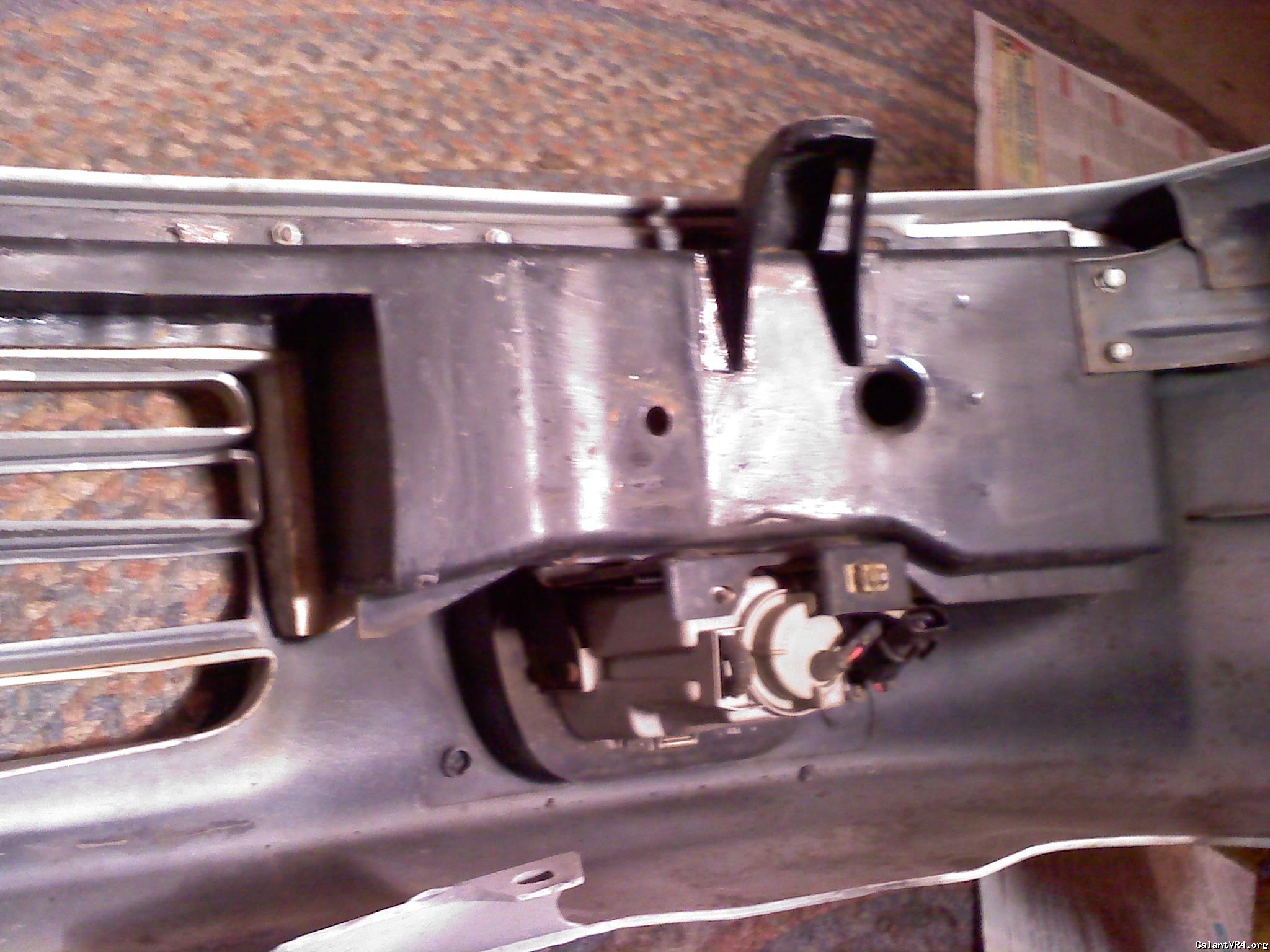

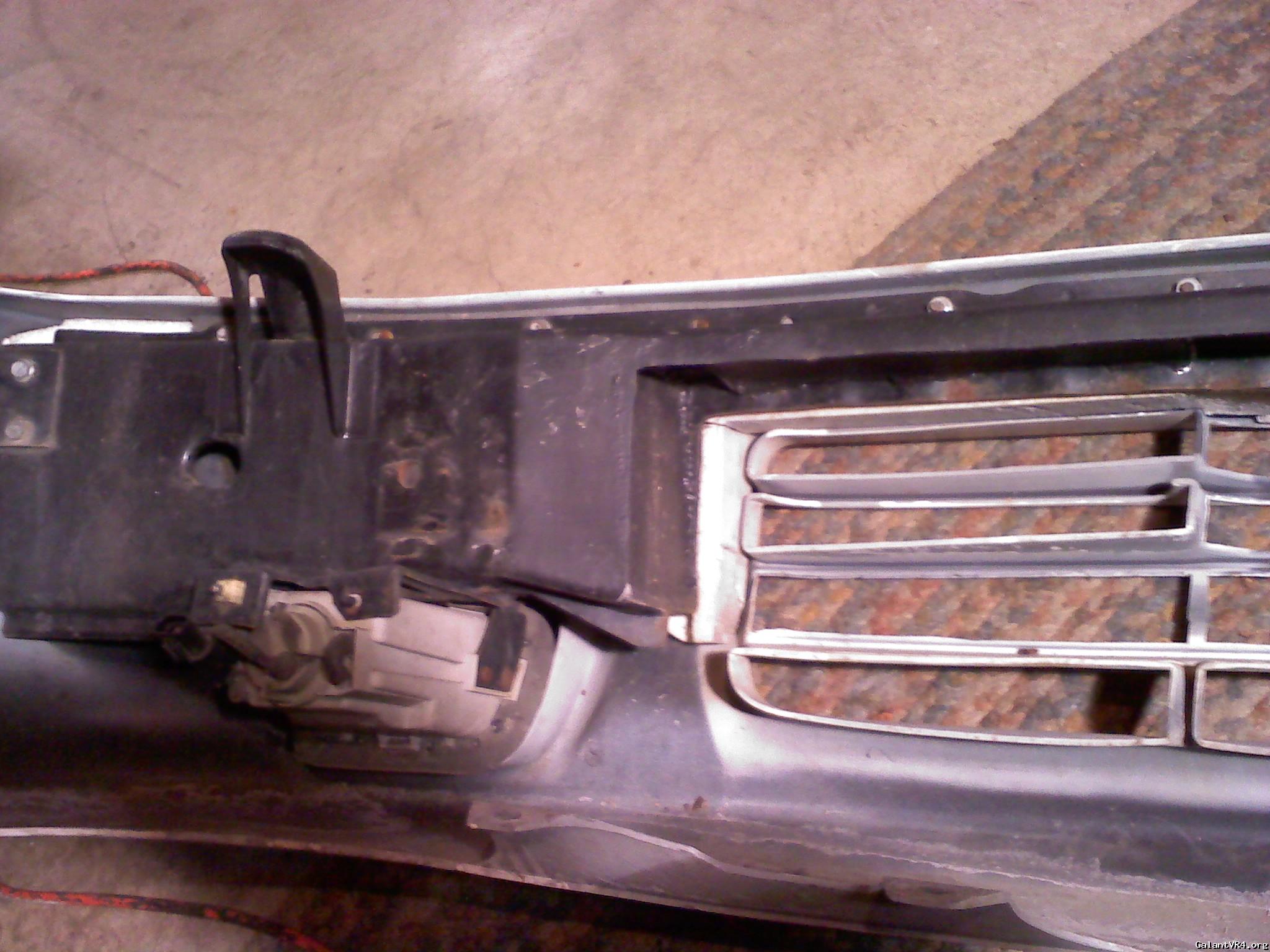

Brian, take note of this thread and the pic of the cut front bumper support:
Its a good idea to leave a portion at the top if you can so that the urethane doesn't sag over time. I think that might be welded on though if you look at the other pic in that thread.

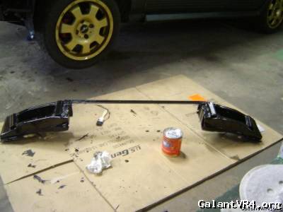

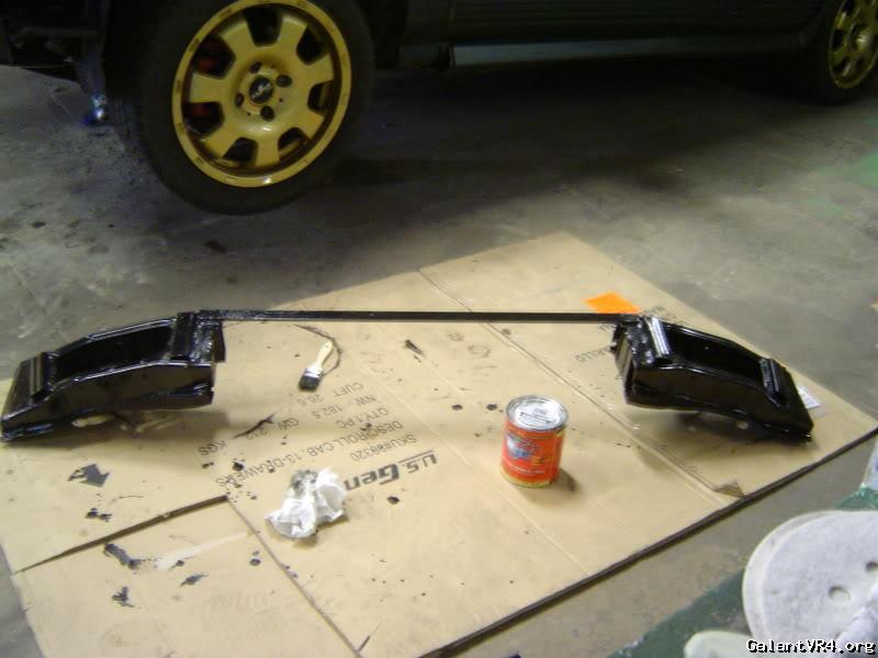

I don't know if this will help but this is what I did. I was afraid of cutting to much of the bumper support away so I used the metal that I cut away to reinforce the bumper, on the top and sides.
You can see on the sides where the ends were boxed off, and the top was reinforced inside the lip which you really can't see. Needless to say its definitely more rigid. I then Por-15'd the whole thing which is the only reason it looks as good as it does.
