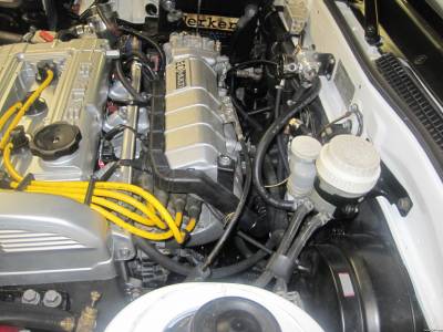

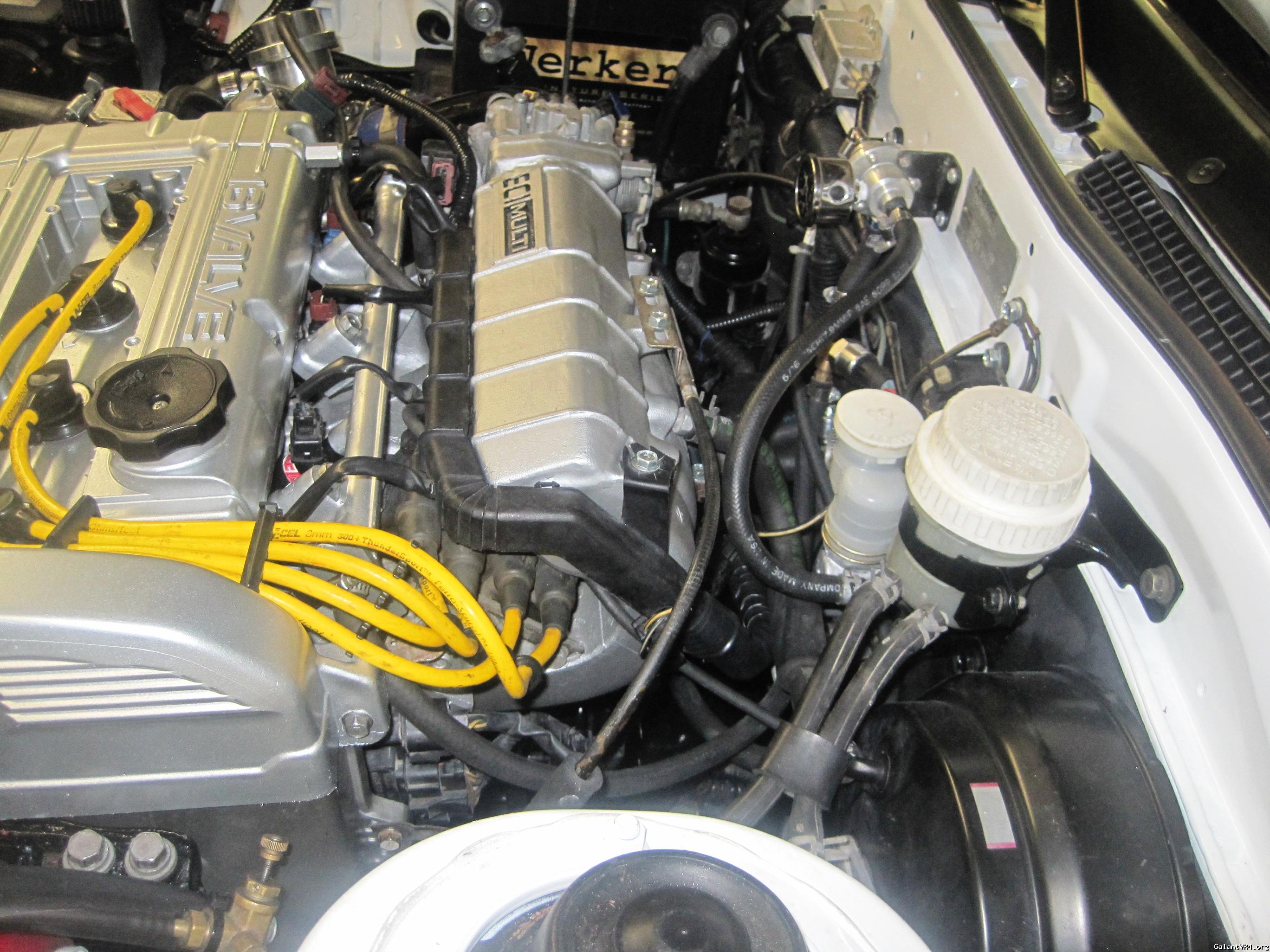

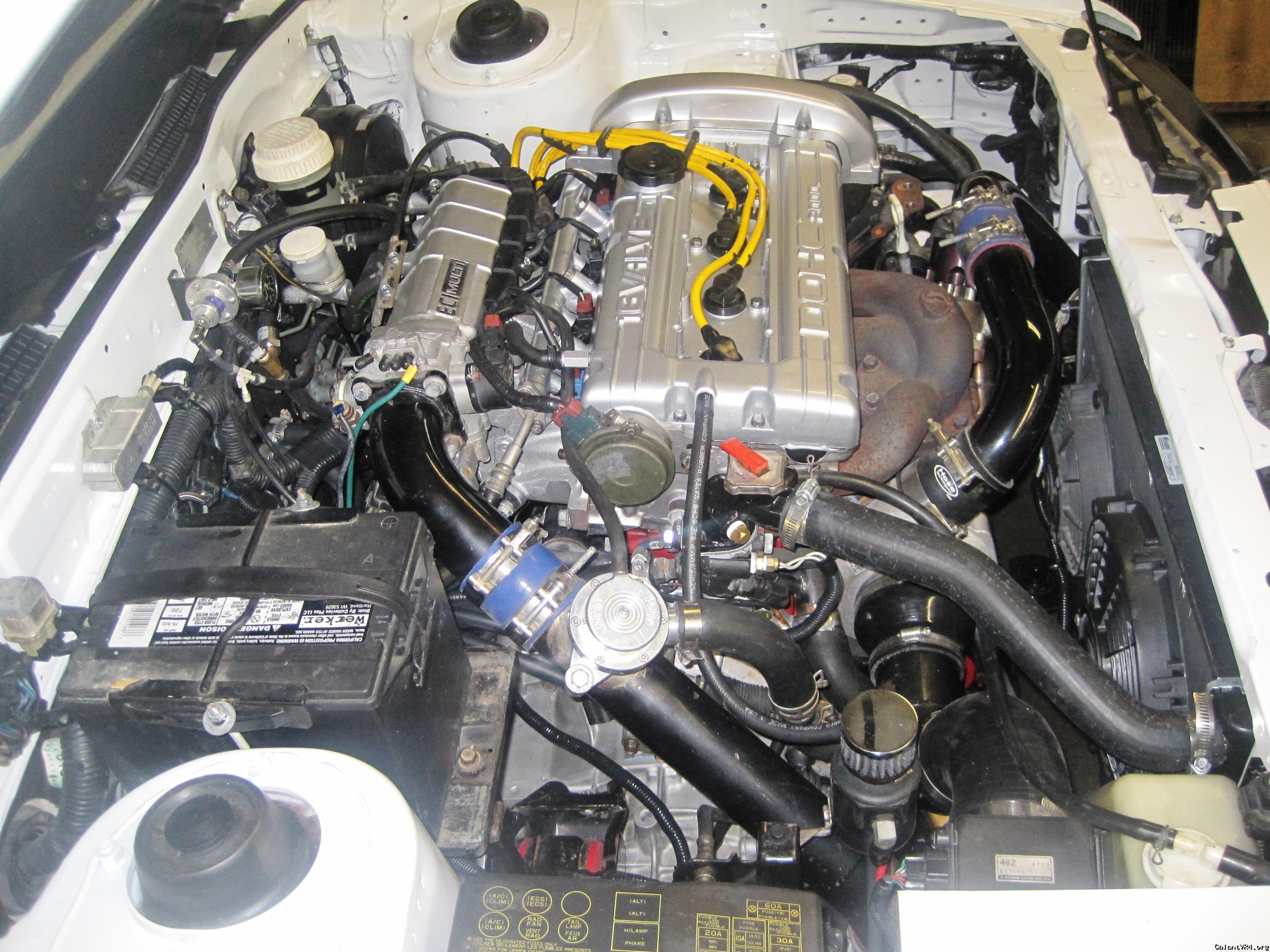

OK, got the injectors back from Cruzin Performance. Car runs good in the garage but it is raining out right now. So the test drive will need to wait a little bit. /ubbthreads/images/graemlins/frown.gif

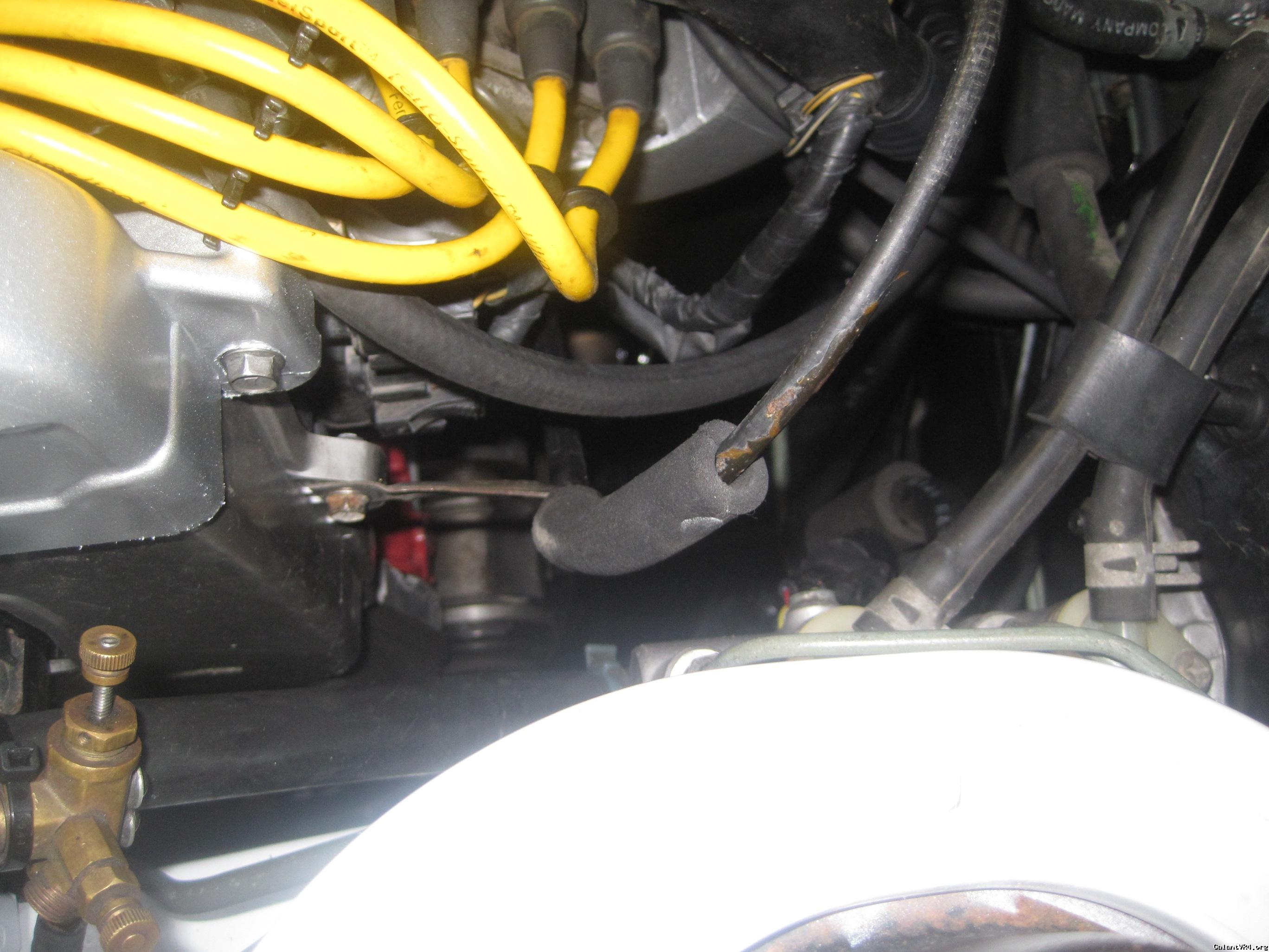

I had to replace the upper timing cover so I took the opportunity to repaint the cover, mani, fuel rail and took Josh's suggestion and rerouted the throttle cable under the intake. I used the longer of the two brackets that was on the fuel rail and bent it a bit and relocated it to the front timing cover. This will keep it up and stable so that it will reduce the vibration damage that can occur if left to dangle.
I really need to redo the battery tray. It looks bad.
Well, here are the latest pics. What do you gents think?

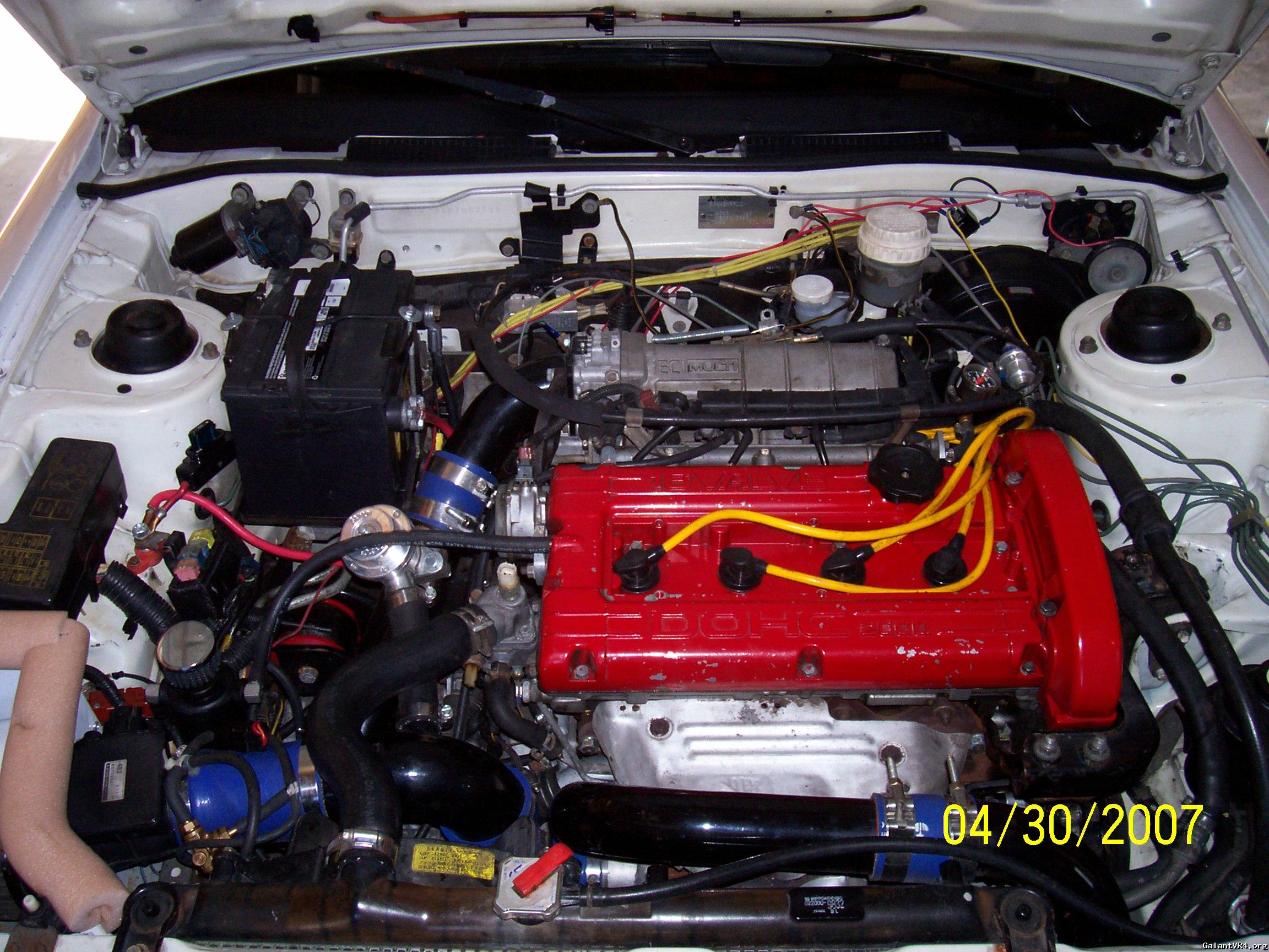

As a reference, here is what it looked like before.
cheekychimp
Apr 19, 2004
7,333
East Sussex, U.K.
Terry,
It's really close and the work really really does show. The battery tray is an easy fix, but should be done as you have stated to bring everything else up to the very high standards you have set with the rest of the engine bay.
Two things I would say if you want that engine bay to gleam as well as be practical, either get the exhaust manifold heat shield back on (or ceramic coat the header) and change those plug wires.
I read what you said about those plug wires being significant Terry but they just don't work aesthetically in there. I understand the philosophy of not changing something that isn't broken, but at the same time your current battery tray works ... it just doesn't look as good as it could. We are talking about looks here. Get some plain black wires in there, get that heat shield on and you will have one of the cleanest engine bays on the forum.
I'm jealous, well done. The hard work and tribulations of the last 12-18 months have paid off. Go out and enjoy driving her!!!

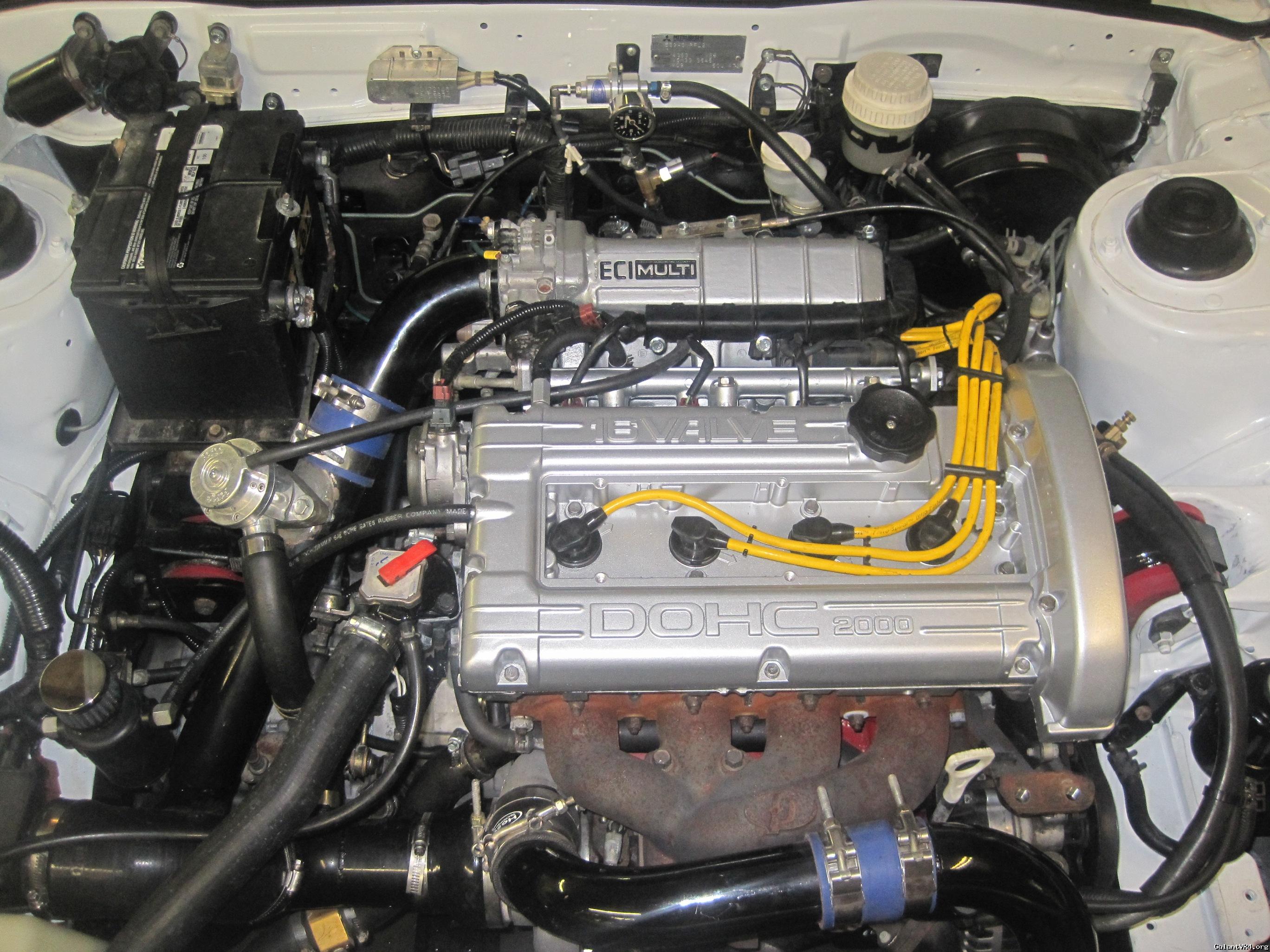

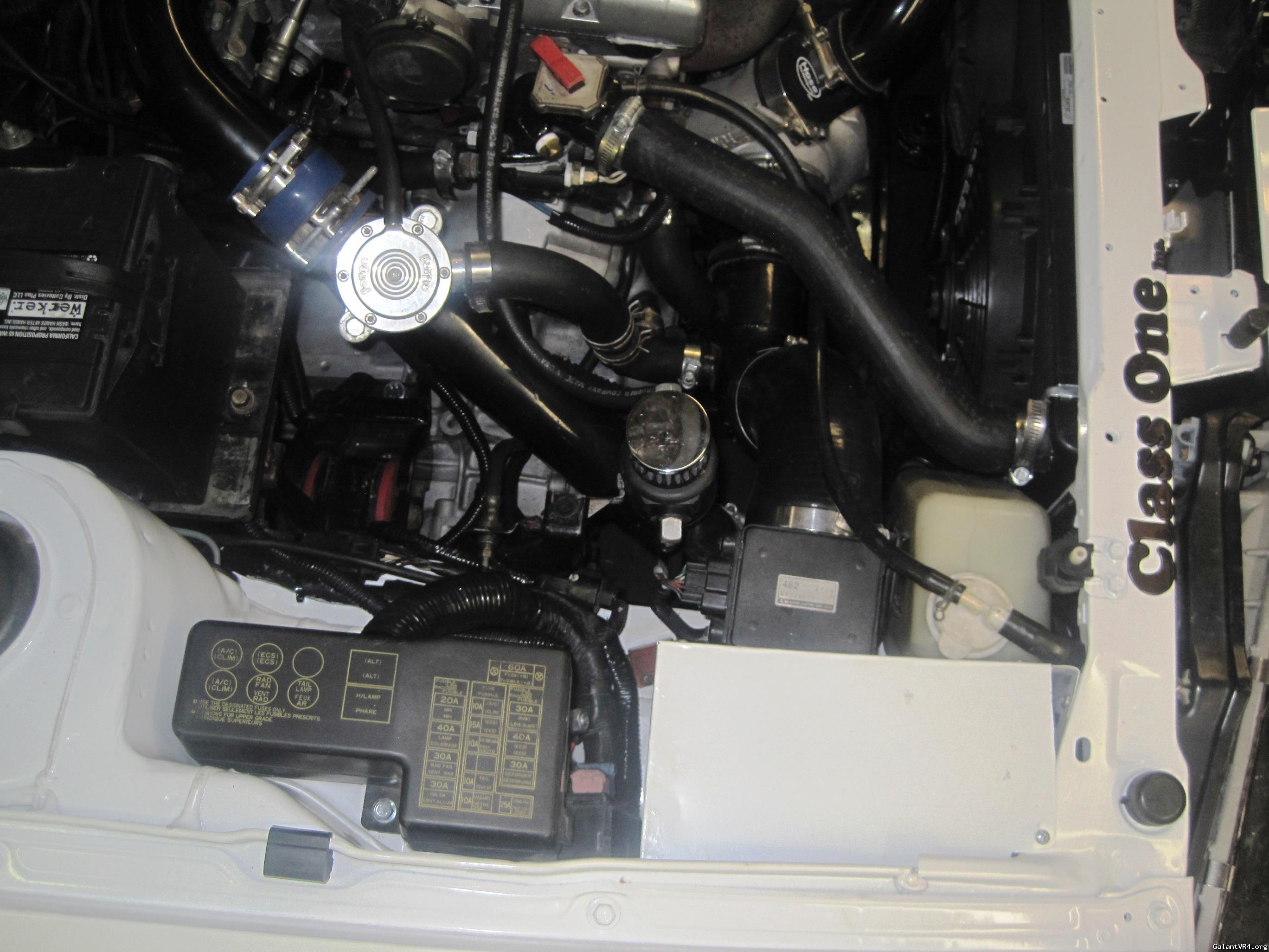

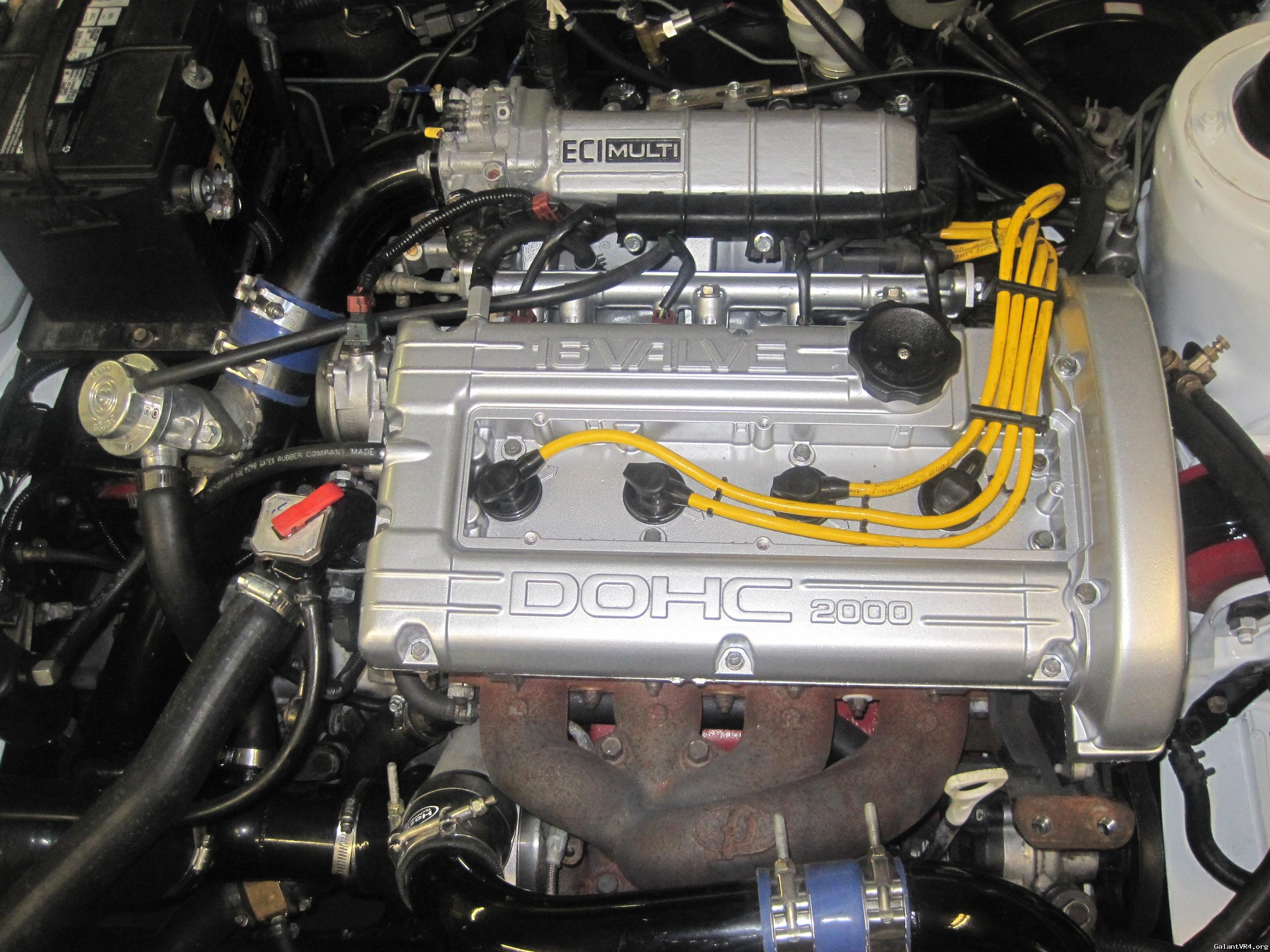

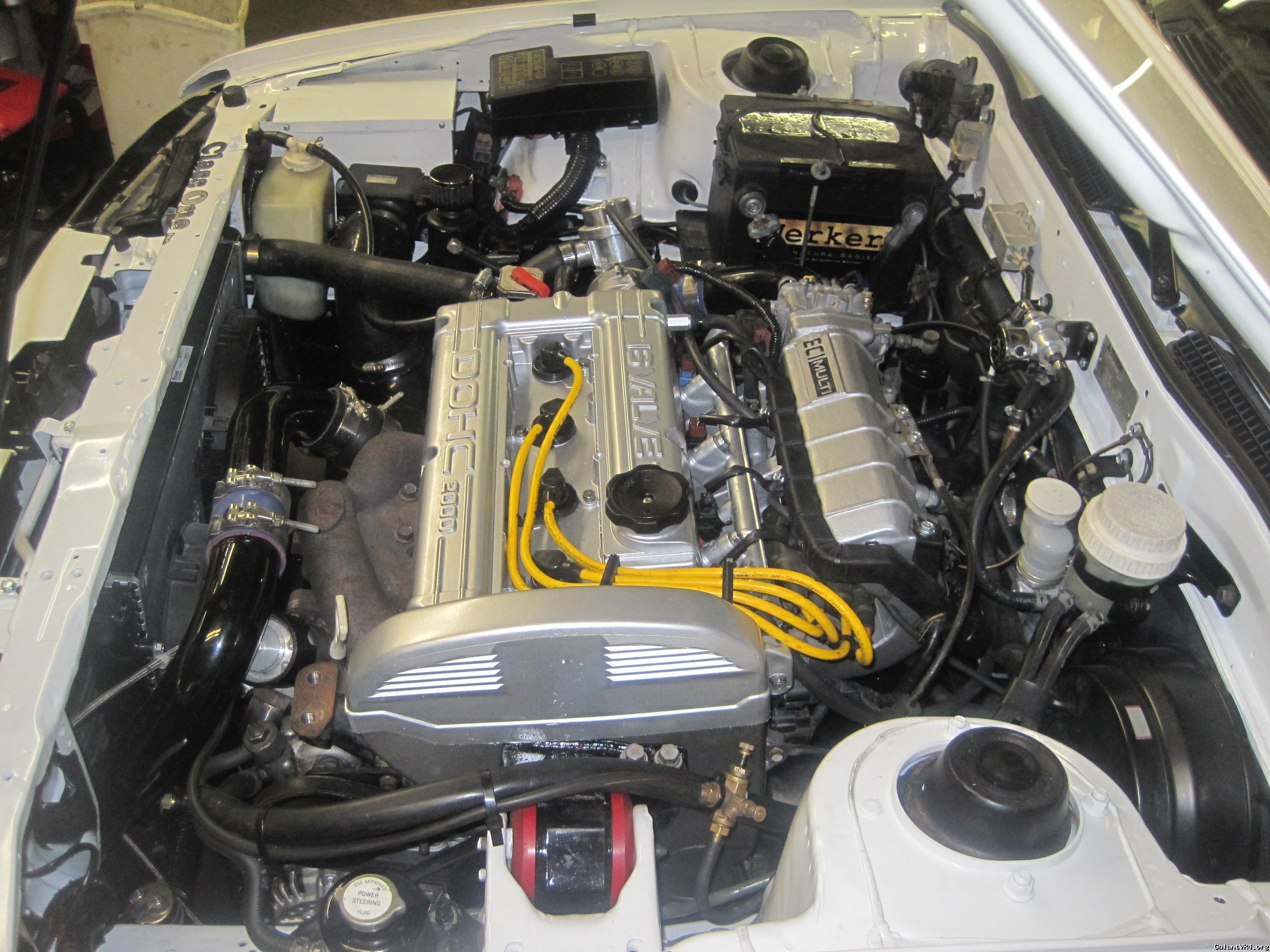

Just reminiscing of the summer projects on 425/1000.
Here is the battery tray/piping fix project.
web page
I also did a new Whiteline front swaybar a month ago and now have a rear Whiteline bar to be installed next spring along with Whiteline and Custo strut bars to refinish and install.
I will be in the market for some front AGX struts (or similar) early next year as well because now my focus is on upgrading the suspension.
