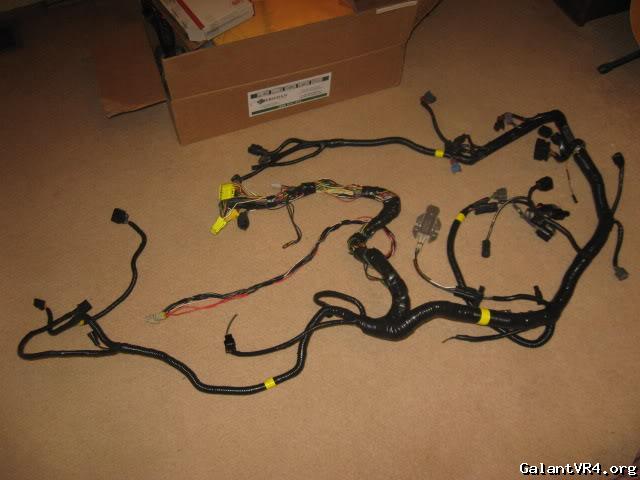

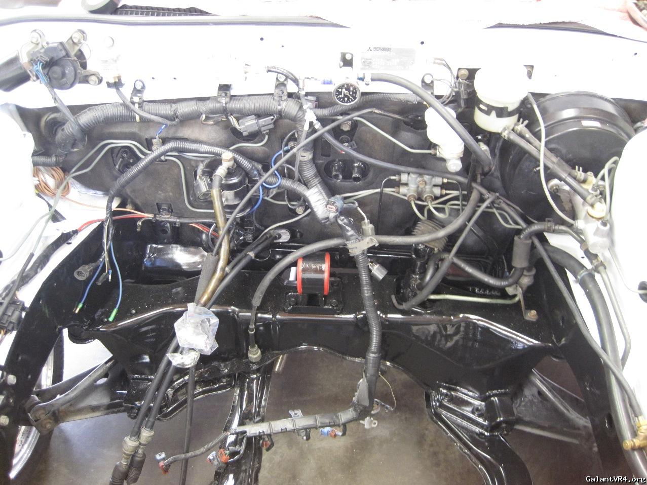

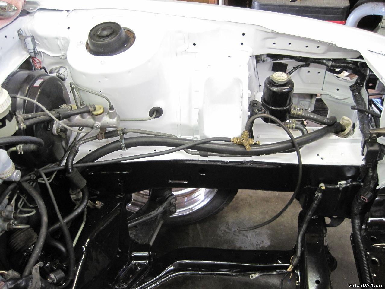

Spent 5 hours cleaning the looms, re-taping, securing, routing, etc... Things are getting to the point where I can stop on the chassis and prep the motor. It needs the oil pan gasket resealed and a good cleaning. Then I just have to wait until I get the tranny back and the clutch sorted.
Things should be real clean when the motor is in.

Motor is clean and pan gasket redone. Broke the plastic handle on my new 2G dipstick /ubbthreads/images/graemlins/mad.gif. Reinstalled the IC core and hood latch stuff. Ordered a new Scirocco radiator, should be here Monday. Can't mount the oil cooler until I see exactly where the new radiator will sit. Pretty much coming to a standstill for a little bit.
Need to bleed the brakes but need Kevin's help. Maybe get to that this weekend.
I will wait to reinstall the front bumper until the motor/tranny is back in.

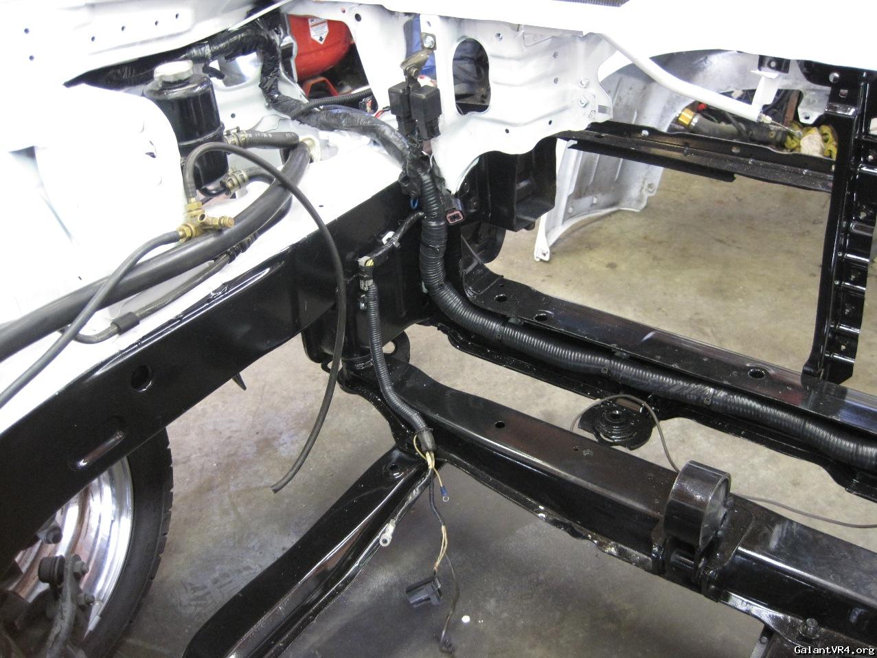

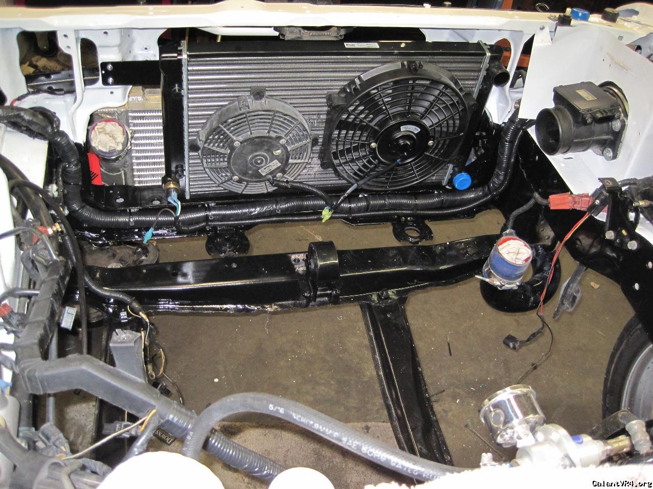

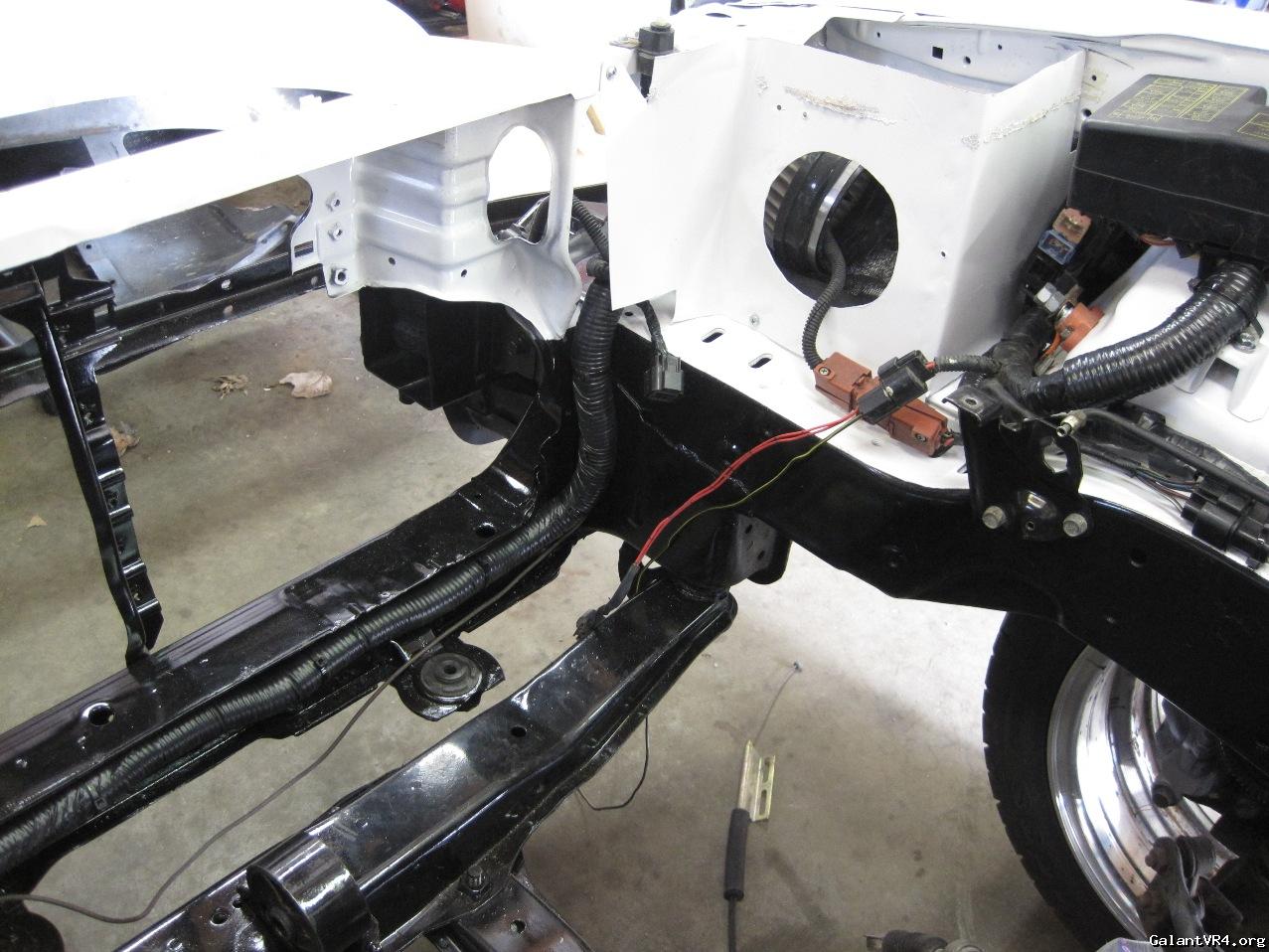

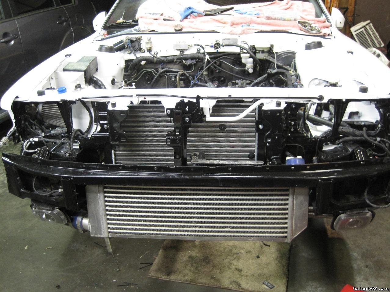

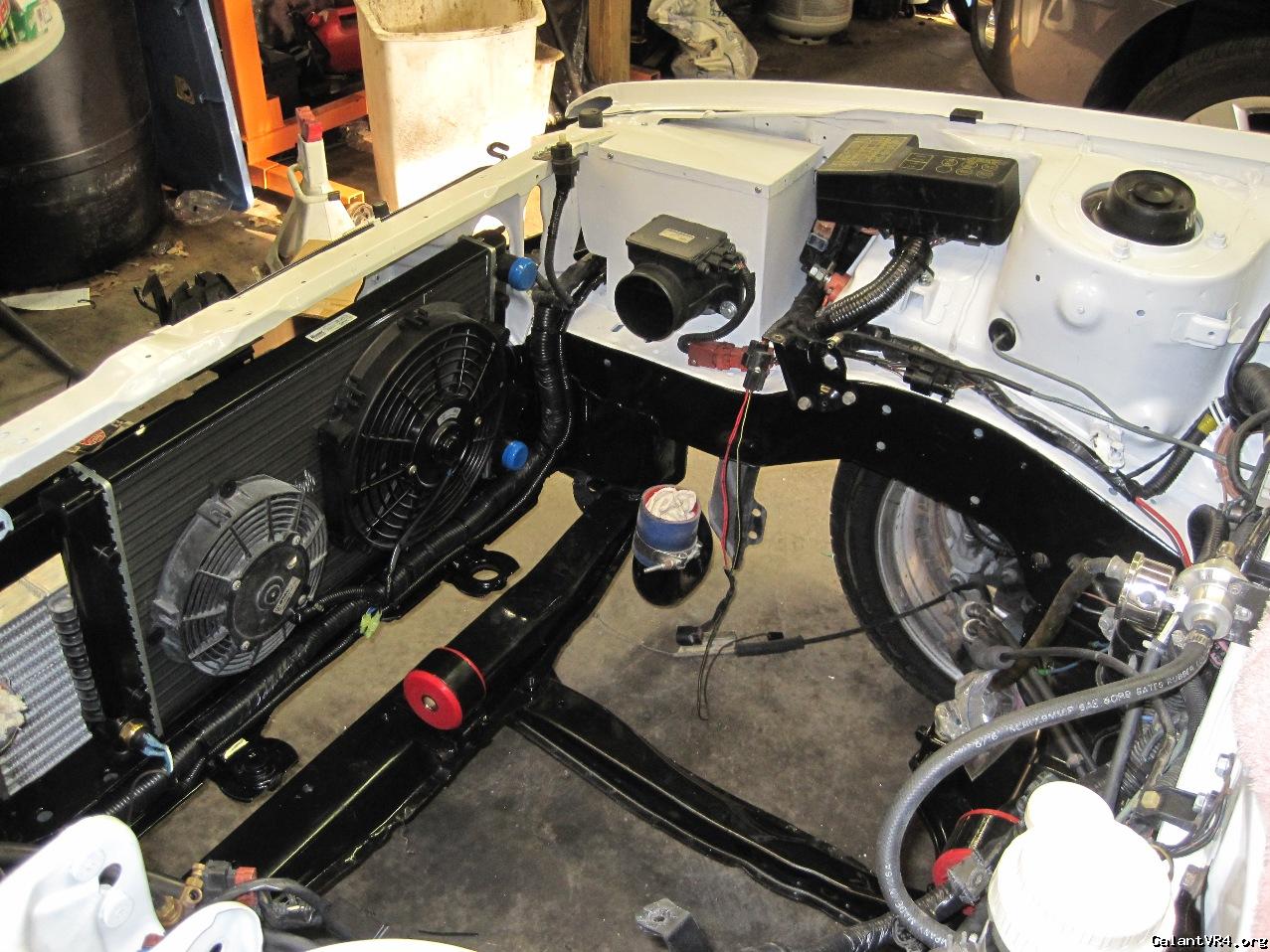

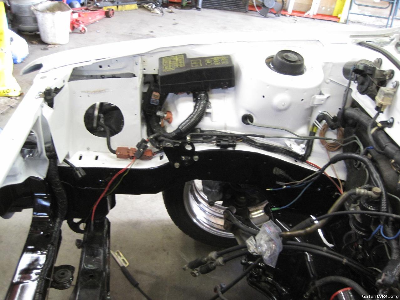

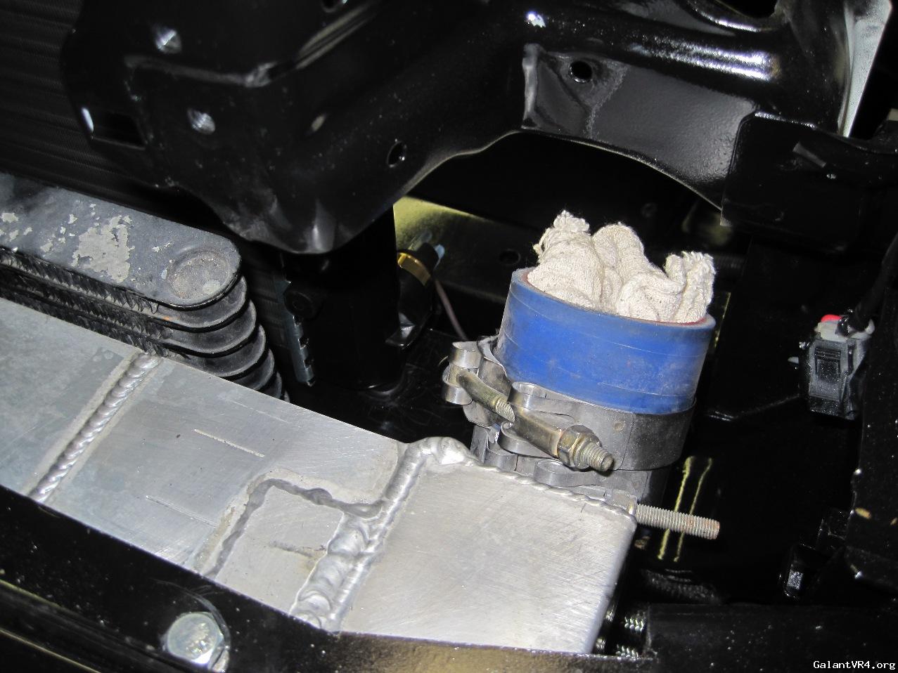

I got the new radiator in today. Along with the oil cooler. Did the wiring harness, basically just redid the factory harness with new wiring and a different thermo switch.
I think the car is ready now for the motor and trans. /ubbthreads/images/graemlins/grin.gif

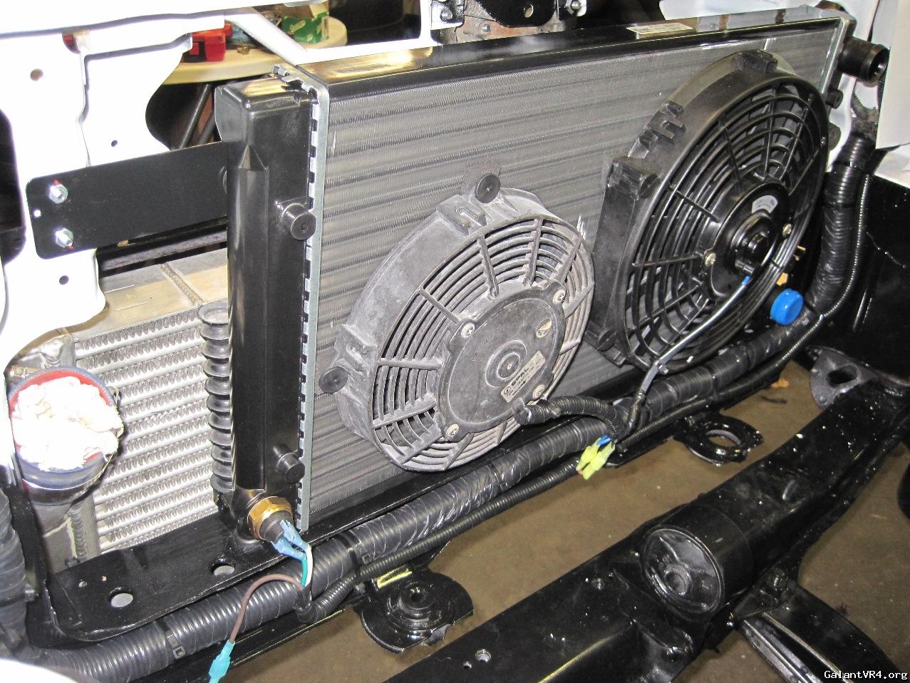

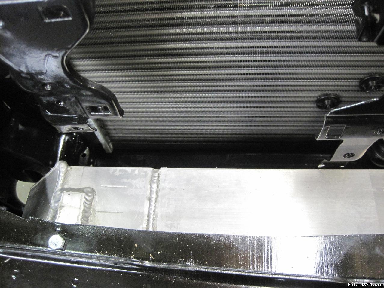

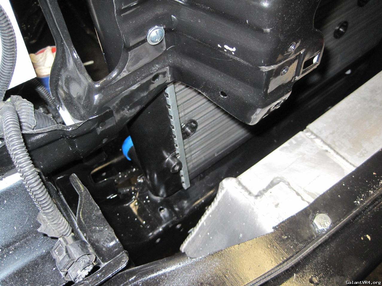

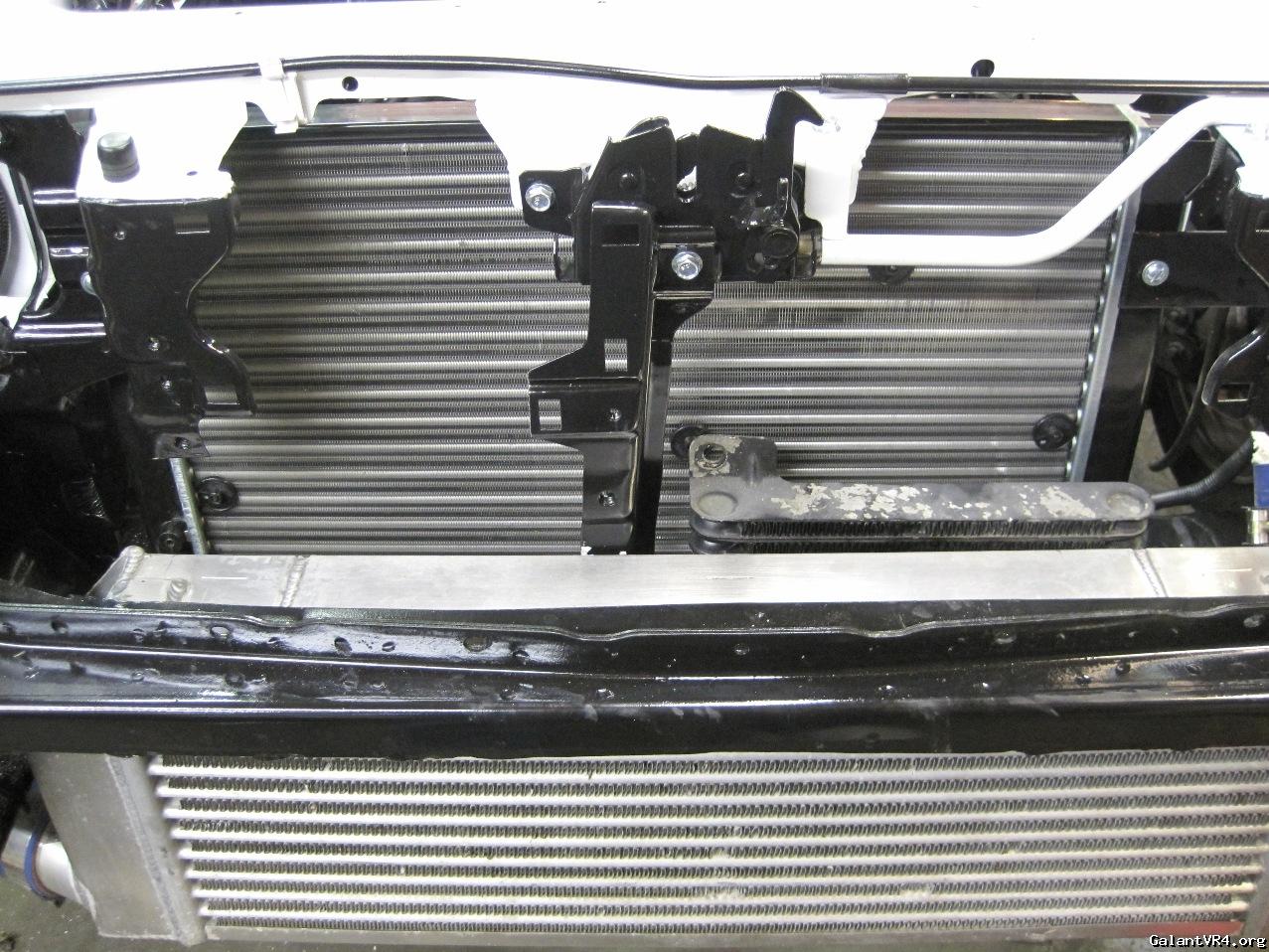

This is a stock replacement Scirocco radiator (ebay = $61.00 shipped) and it has two pins that point down. I drilled holes in the core support and used large rubber grommets to protect it. Then two screws hold the radiator to the upright supports (had to make one bracket) with rubber isolator washers. Already had the fans (not really the best setup but I just used what I had). I still need to cap off the over flow nipple on the rad because I will be using the nipple on the TEL T-stat housing but that wont take 5 minutes later.

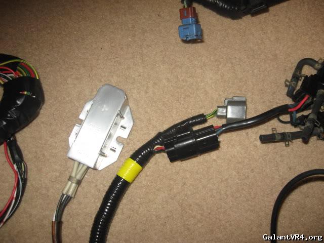

Looks great man! McMaster-Carr has the cable ties that you need, just search for "mountable cable ties". Also for an added touch I grab a roll of yellow electrical tape from Lowes and wrap various places on the harness for that "oem" look. Here is my turbo dsm harness that I modded to go in my swapped colt.

I don't want the yellow under the hood.

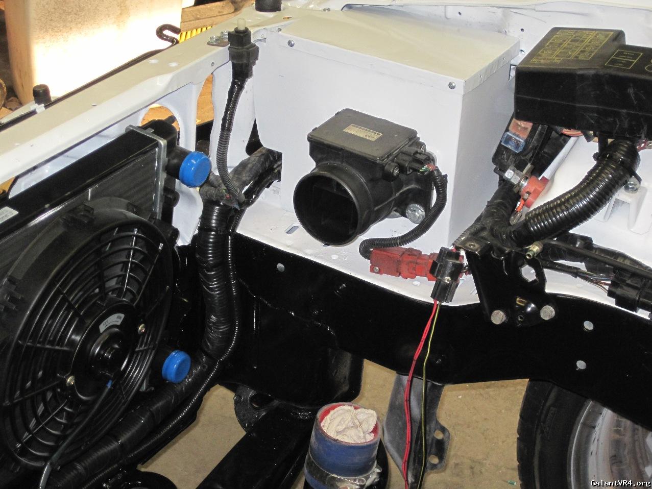

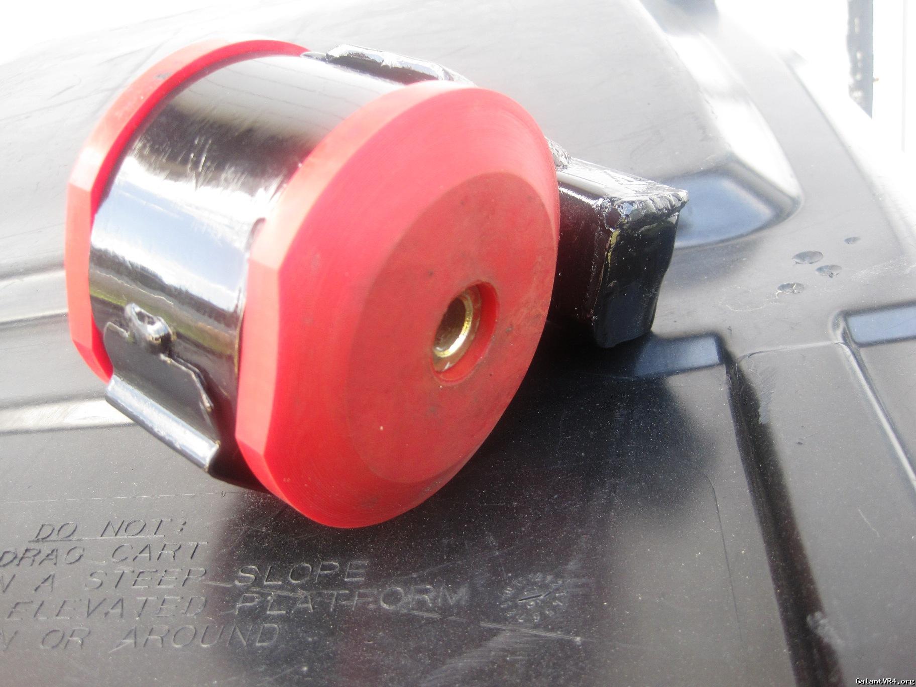

In that last few days, I have been just filling time by working on the coolant piping since the new radiator needs the TEL water neck and such. I have also remade my cold air box. It is a fully enclosed box and gets its air from below. I also have to push the MAS down as far as possible so the new rad hose does not interfere with the MAS to turbo piping. The new box turned out well but I may remake the top lid after I get a little more sheet metal.
I got my new lower front motor mount from Energy Suspension and had a hell of a time getting the old insert pressed out. Ended up using a sawzall and put two cuts into the inner ring so it could just pop out. That worked well.

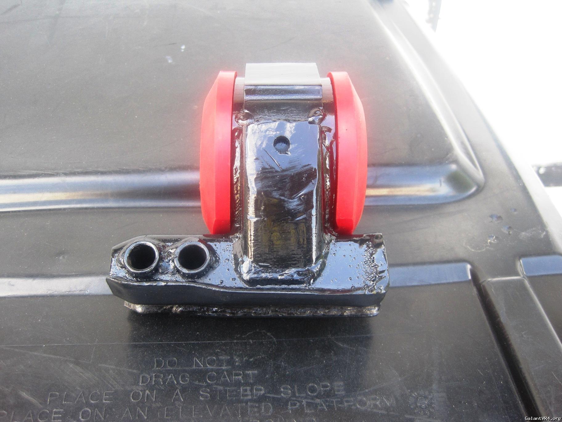

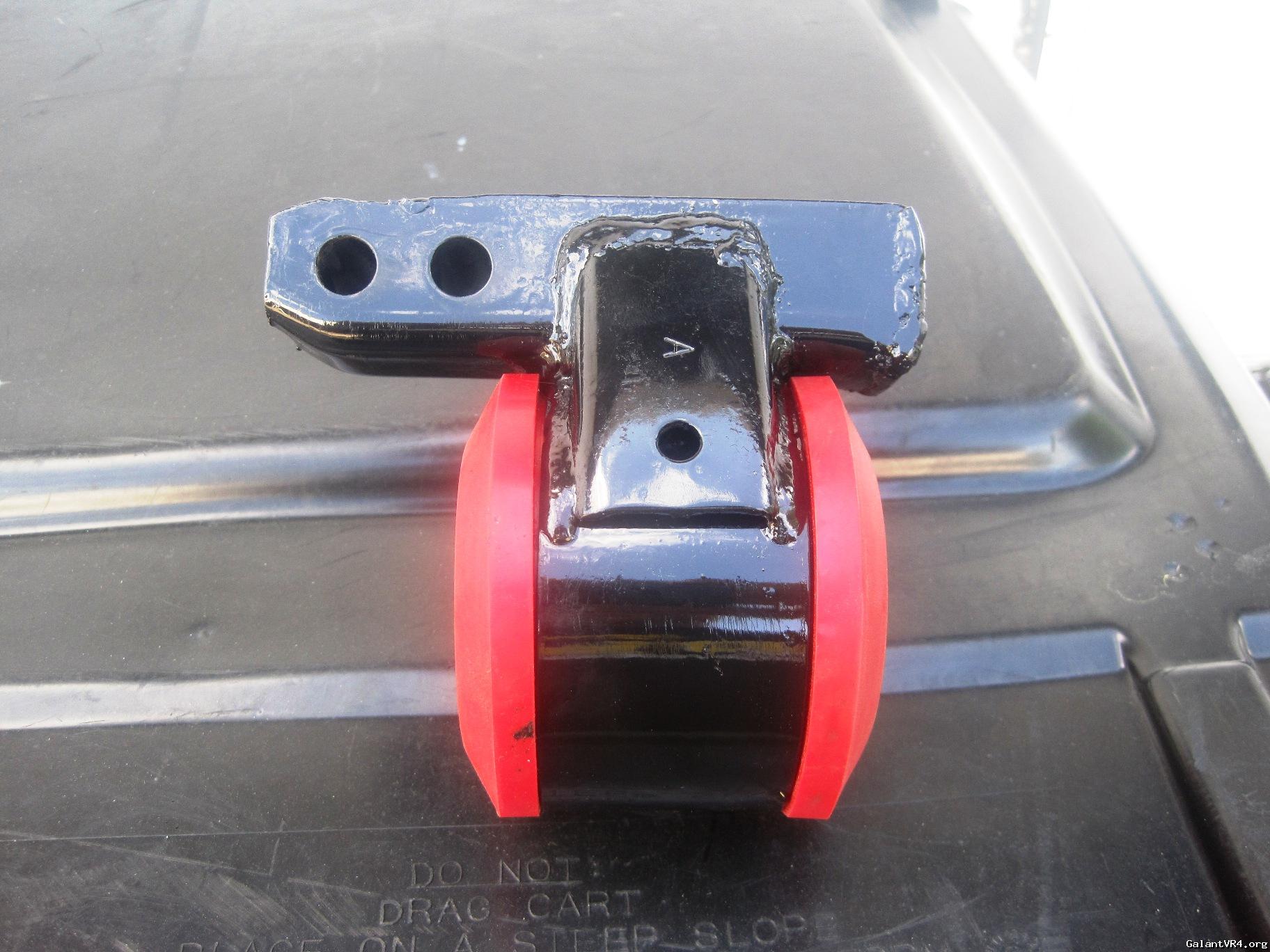

Finally getting back to the project. Transmission/T-case will be in my hands on Sunday. I just got an El-Cheapo 110v welder (no gas /ubbthreads/images/graemlins/frown.gif)from my dad and my very first project was the front top engine mount. I cut the "J" off and boxed in the end for strength. I had to adjust the wire feed a little tighter because it was slipping but for my very first weld, I'd say I did pretty well.
The paint is drying so I will take a pic tomorrow.
