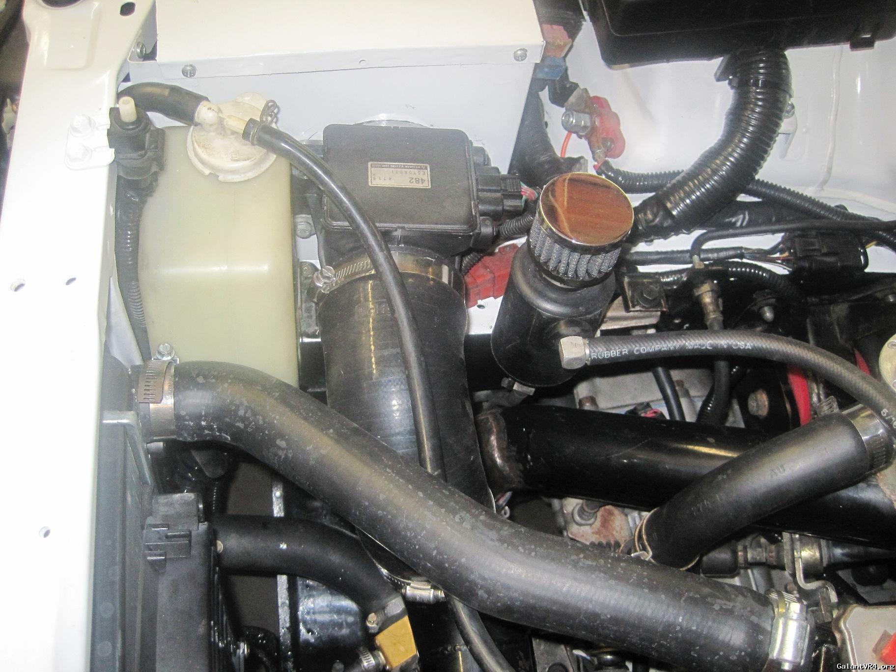

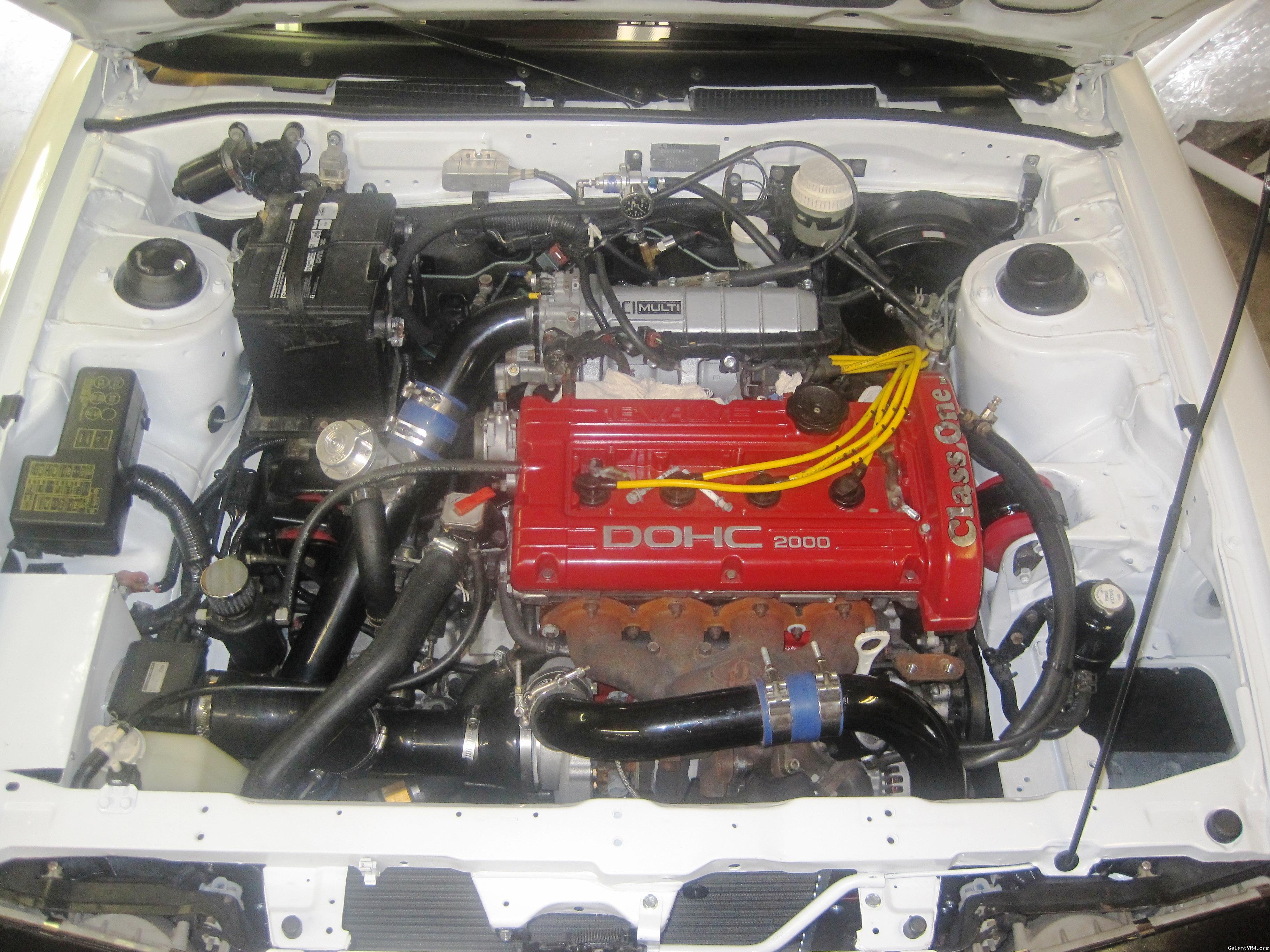

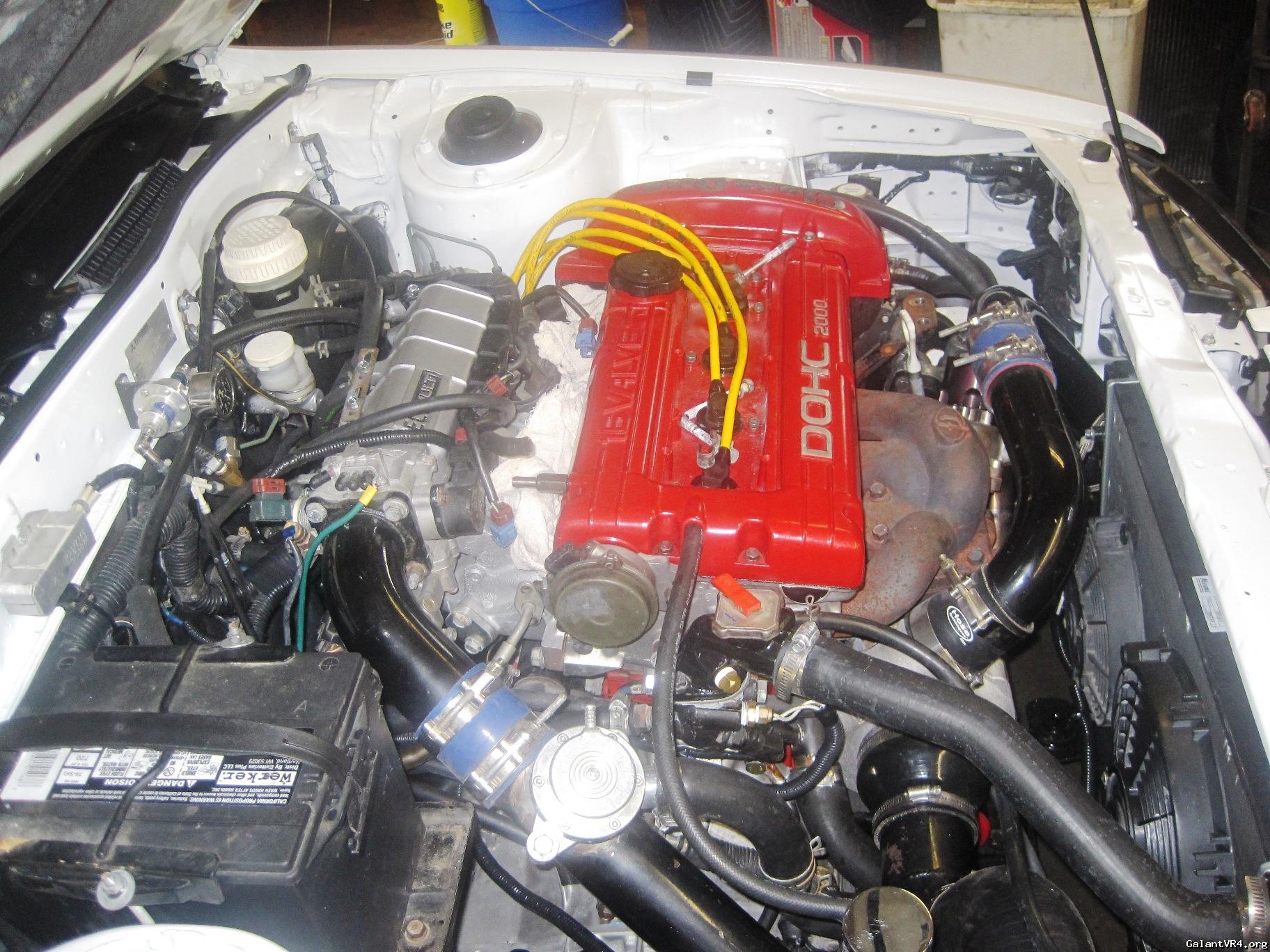

Here are a few pics of the radiator finished and over fill bottle. Again, I still have quite a little bit more tinkering with pipes, battery tray/placement but for now, I just want to drive it for a while and enjoy it.

Wow, I'm very impressed! Good job on the entire engine bay! Now I look at mine and feel a bit embarrased! /ubbthreads/images/graemlins/dunno.gif
Quoting Terry Posten:
I don't want the yellow under the hood.
Are you getting rid of the spark plug wires too?

Those wires was one of the first mods I did. The ONLY non-stock thing done to the car when I got it from the repo bank was the PO had shoved 45 degree angled plug wires (like you find on a Chevy) down the plug tubes. Took me 15 minutes to pry them out.
I may replace them sometime but as long as they work, they signify the beginning /ubbthreads/images/graemlins/grin.gif.
