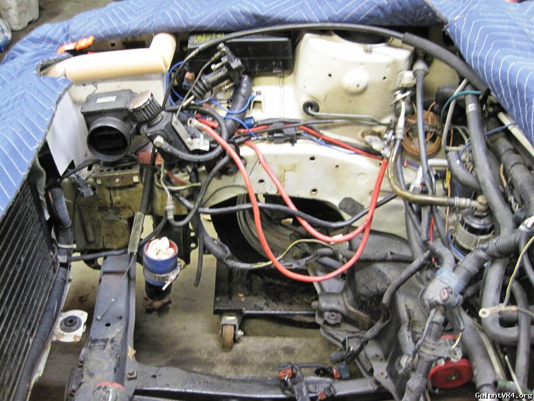

I can now see. Tomorrow I should be able to get the engine bay stripped down to be ready to de-grease and tape off. AC comes out, ABS comes out, and a whole lot of cleaning and "keying" the surface.

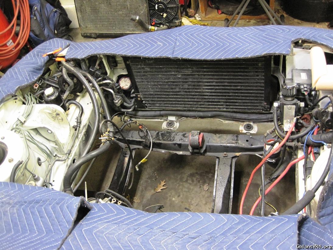

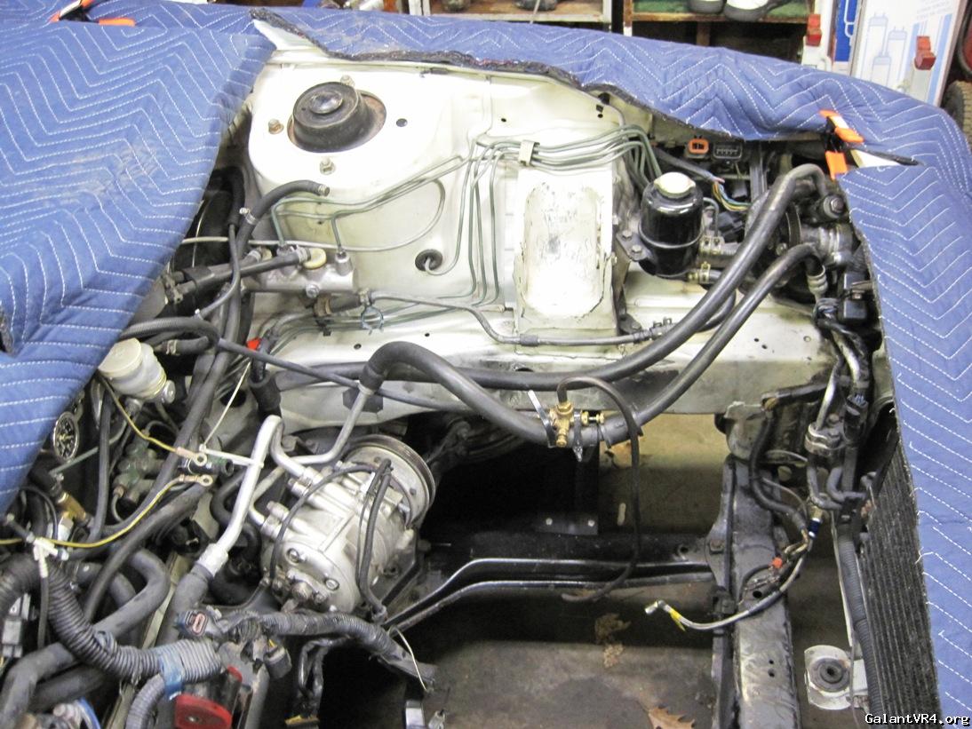

This is what I am starting with.
Be doing this job for the next week, come on over if you can. /ubbthreads/images/graemlins/grin.gif

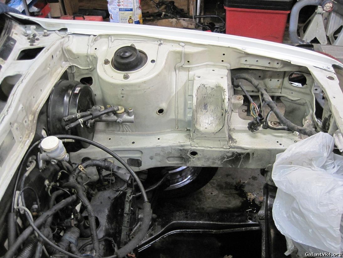

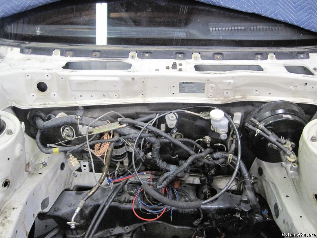

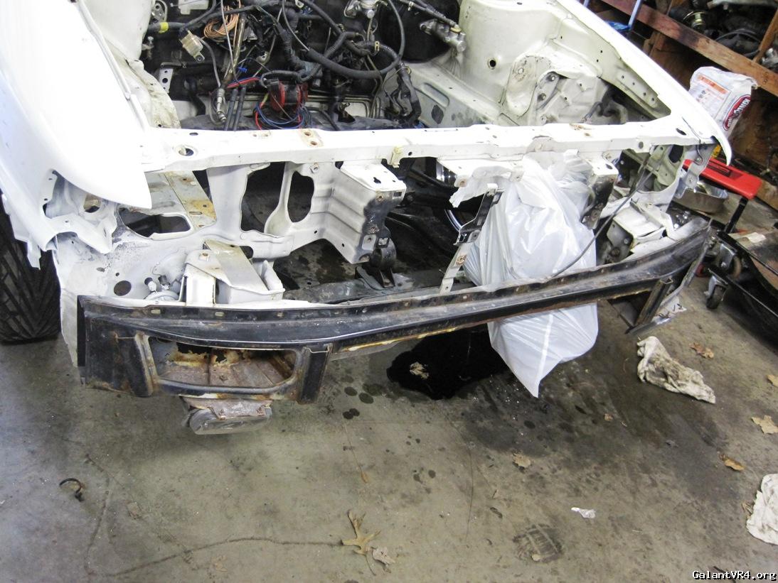

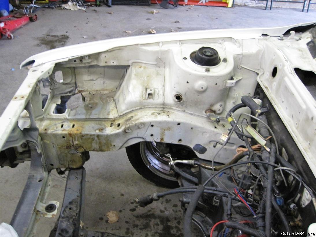

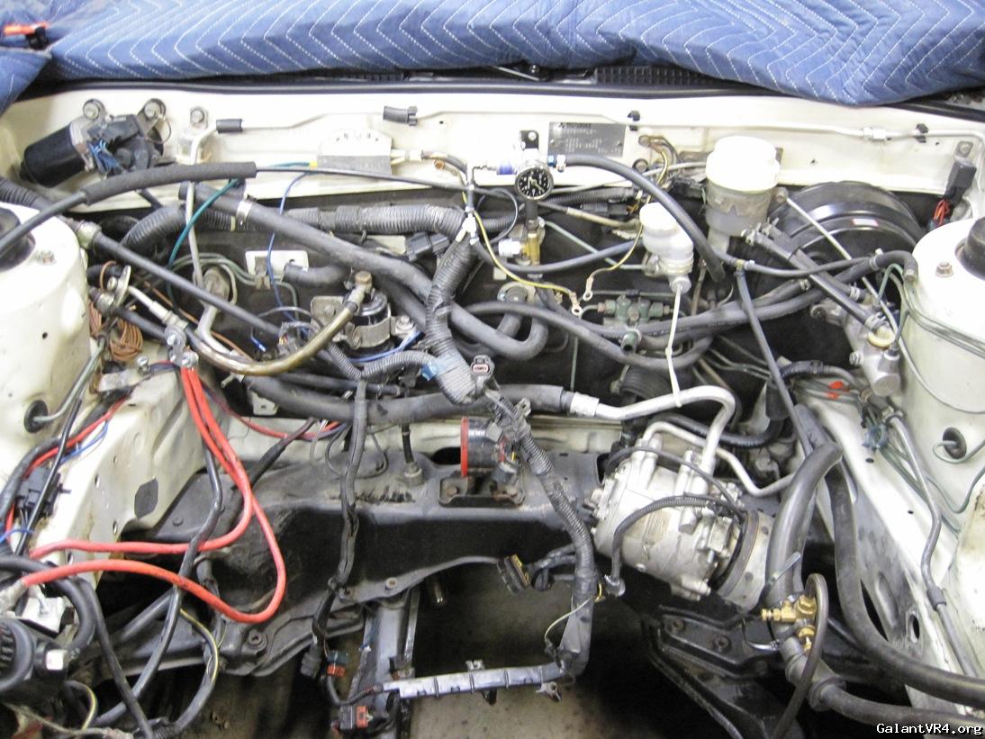

Started around 1pm, 3.5 hours later, this is what I have.
Need to source new Ty-wrap pieces that have the body pin to secure it to the car. Should be able to pick them up at auto zone.
I will push it outside tomorrow after lunch and spend a few hours washing. I have decided to paint the upper fenders, top of the rad core support and upper firewall white. The frame rails and front end will all be black.
I am a little sore, not used to wrenching anymore. Gonna take it easy for the rest of the day.
BTW - Anybody know if the brake master has something to disconnect inside the car or can I just take the 2 nuts off and the valve body will fall off?

Looks nice bro! You did all that pretty quick! Can't wait to see the finished bay, I bet it will look really nice. Is your fire wall matt still pretty clean? Or are you going to clean that up somehow? Maybe with a carpet cleaner can with a brush top? It looks ok from the pics but I was just wondering.
Good work, oh and I do believe you can just unscrew the brake master and it will just come right out, the just mask off the booster.

The firewall blanket is in good shape, just a cleaning with water and degreaser should do the trick.
I want to have the front end completely black behind all bumper, grill, headlights, etc... Then I want the frame rails and all the engine cradle structure black to hide all the drips-n-stuff that happen.
That's good news about the master, that will make cleaning and spraying a lot easier. I have to use baggies and rubber bands to protect all the gas lines, steering rack ports, rear brake lines, etc...
The hardest part is going to be the wiring. Inside that white trash bad is the whole engine bay loom and it is DIRTY. I will bucket wash it and try and be careful to not damage any of it. Old wiring can be brittle and I don't want to have a re-wiring mess on my hands.

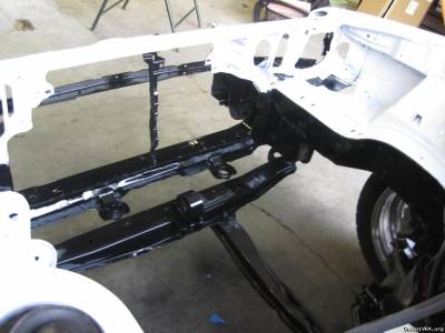

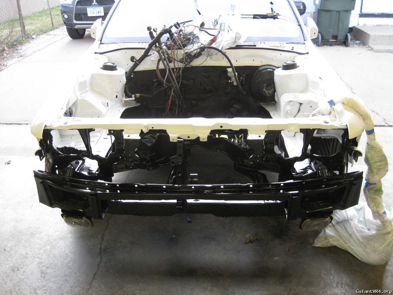

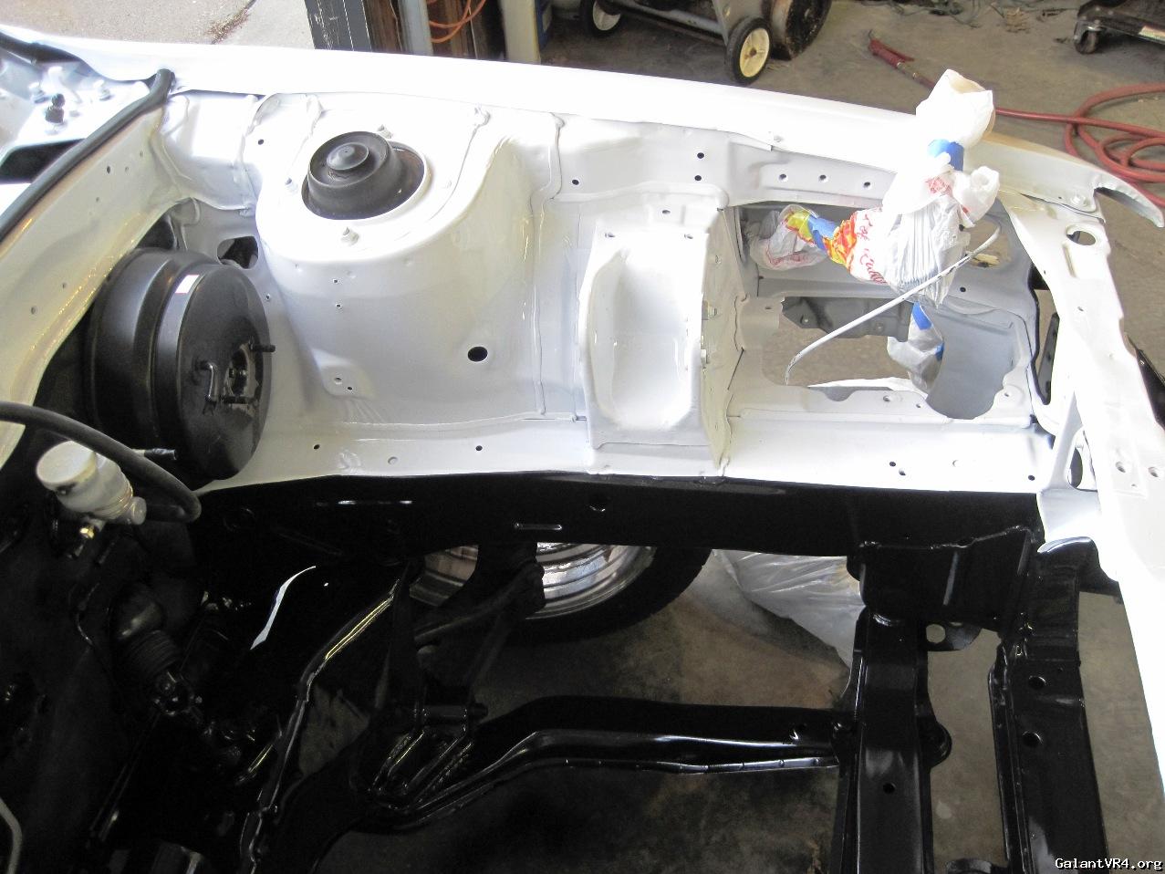

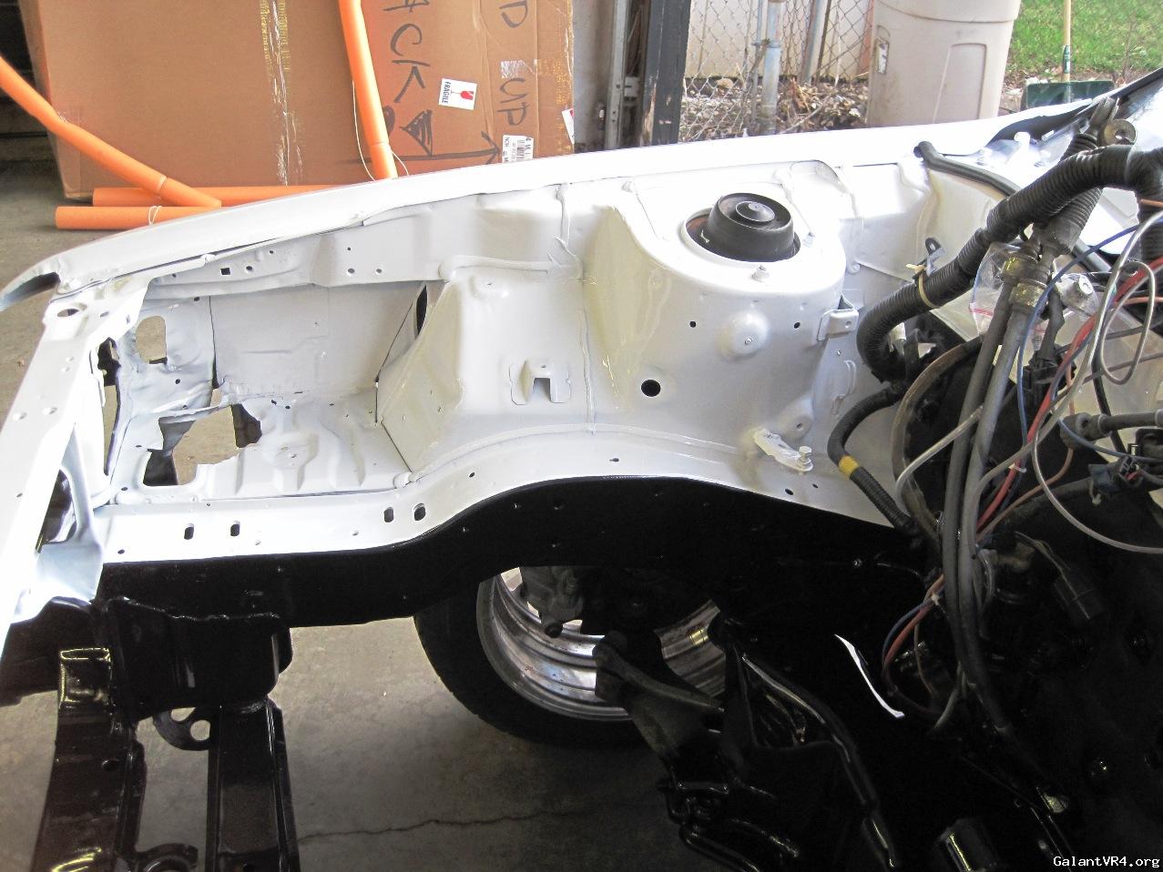

The white is sprayed. Took me about 2 hours to clean the entire bay and then another hour of taping off where I wanted the white and protecting the body.
It has been sitting in the sun for about 3 hours and I will give it a few more before I put tape on the fresh white paint to mask for the black.
It looks 10000 times better. /ubbthreads/images/graemlins/grin.gif Pics later tonight.

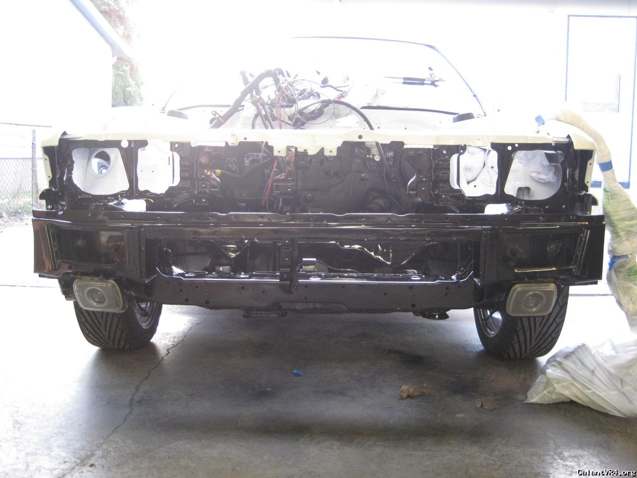

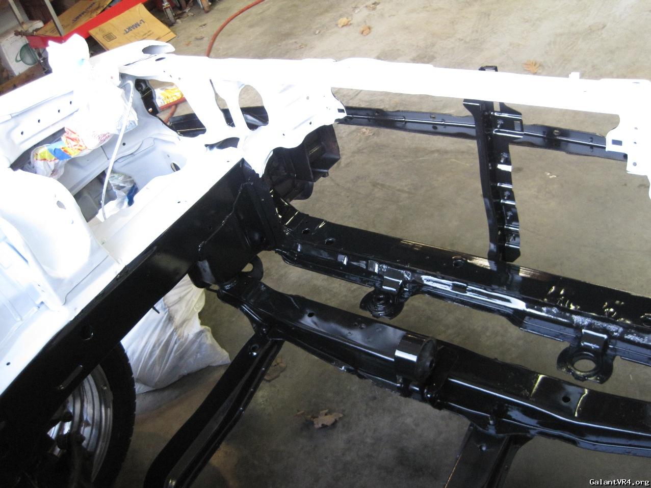

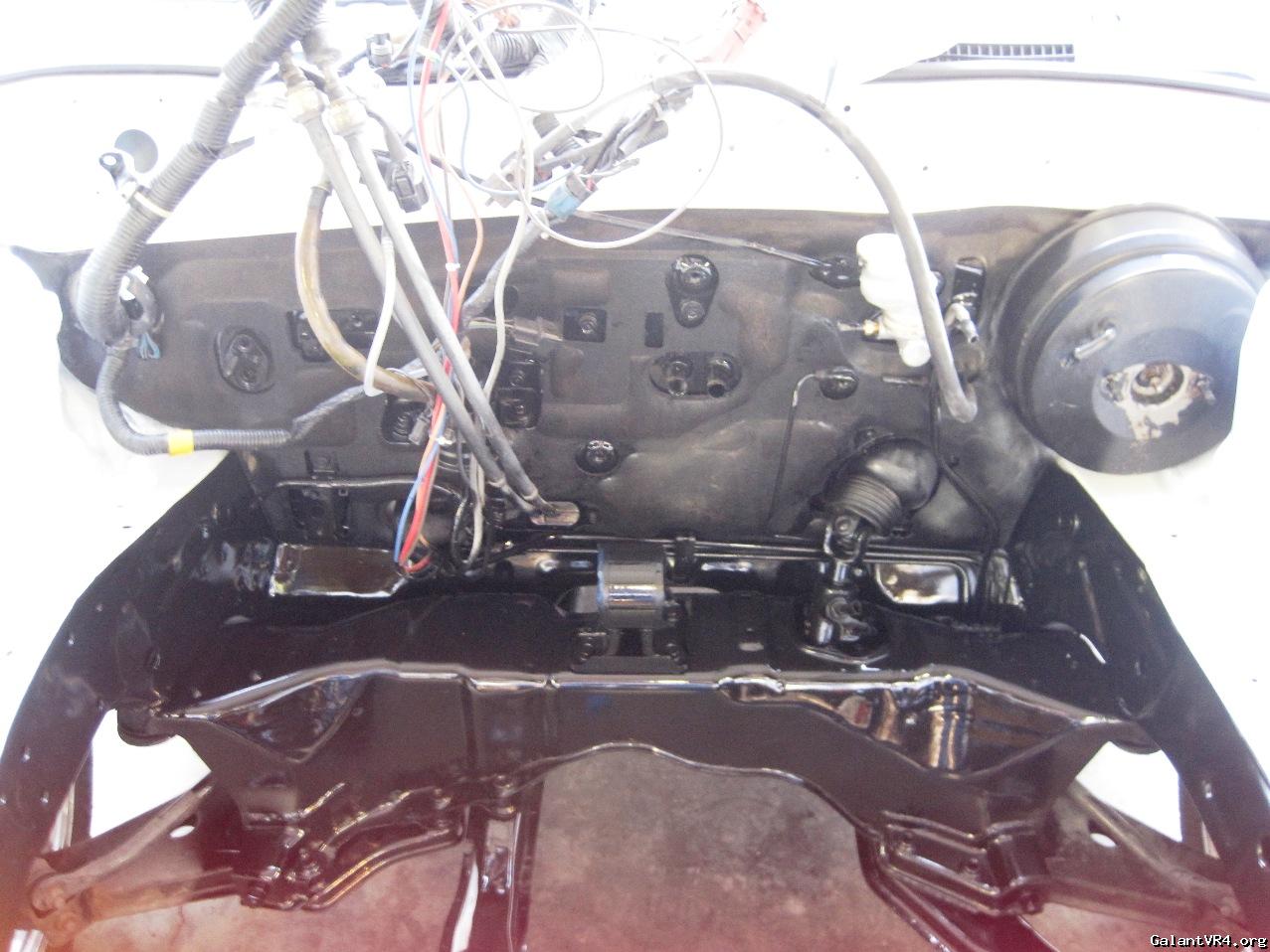

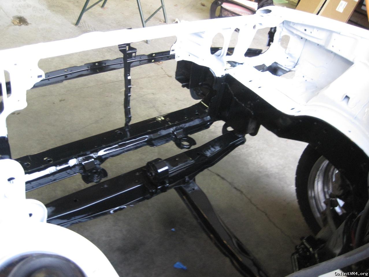

Black is done, completely un-taped and wrapped. Black is too tacky to let the harnesses down yet. Need to let it dry an hour or two before I can push it back into the garage. Tomorrow will see the wiring looms set back into place, run the clutch line, install the ABS delete brake kit, and install the power steering lines.
Still have to paint the power steering and clutch cable brackets but that wont be until tomorrow. I'm beat, my "spray paint" finger is cramping up and my back is sore from bending over all day. Time to watch some TV and do some homework /ubbthreads/images/graemlins/frown.gif.
Now for the pics:
