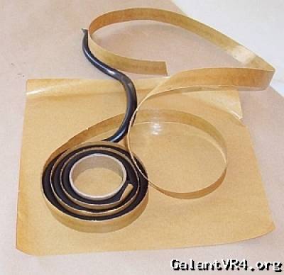

spooling has the right part posted. I used the same stuff to seal up my rear quarter window the other year (no leaks). It was readily available at a car parts store. If you don't see it at the store, just ask the guy at the counter.
deez
May 29, 2004
1,150
Chico, CA
3M Strip-Calk Part No. 051135-08578 its nasty stuff, won't come off your clothes if you get it on so be careful.
holeshotmoe
Apr 7, 2005
1,298
VA
I call it black, sticky, nastiness. This is what they used to use to stick front and rear windshields on to the chassis with. There's a stickier, nastier version that sticks the plastic sheet under your door panels to the door. You can get it in various diameters. Paint thinner and kerosene cleans it pretty good.
...Oh shoot, somebody already posted a link to the stuff
