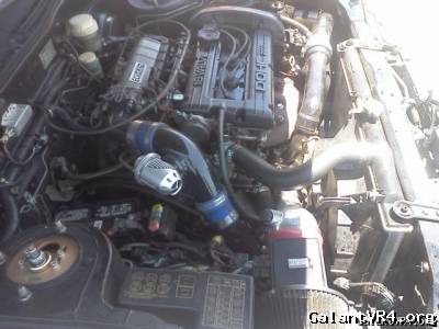

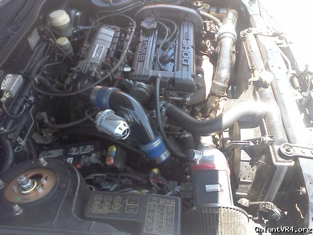

I'm trying to clean the car up a bit, I want to get either a different blow off valve or just make this setup less ghetto. The recirc. pipe is off a stock 1g bov, but the pipe itself is some kind of weird plumbing crap. I thought an open bov would be a nice option to explore. As for the sound, the car is at 20psi on an evo3, so I hear all the pshhh I need to lol
