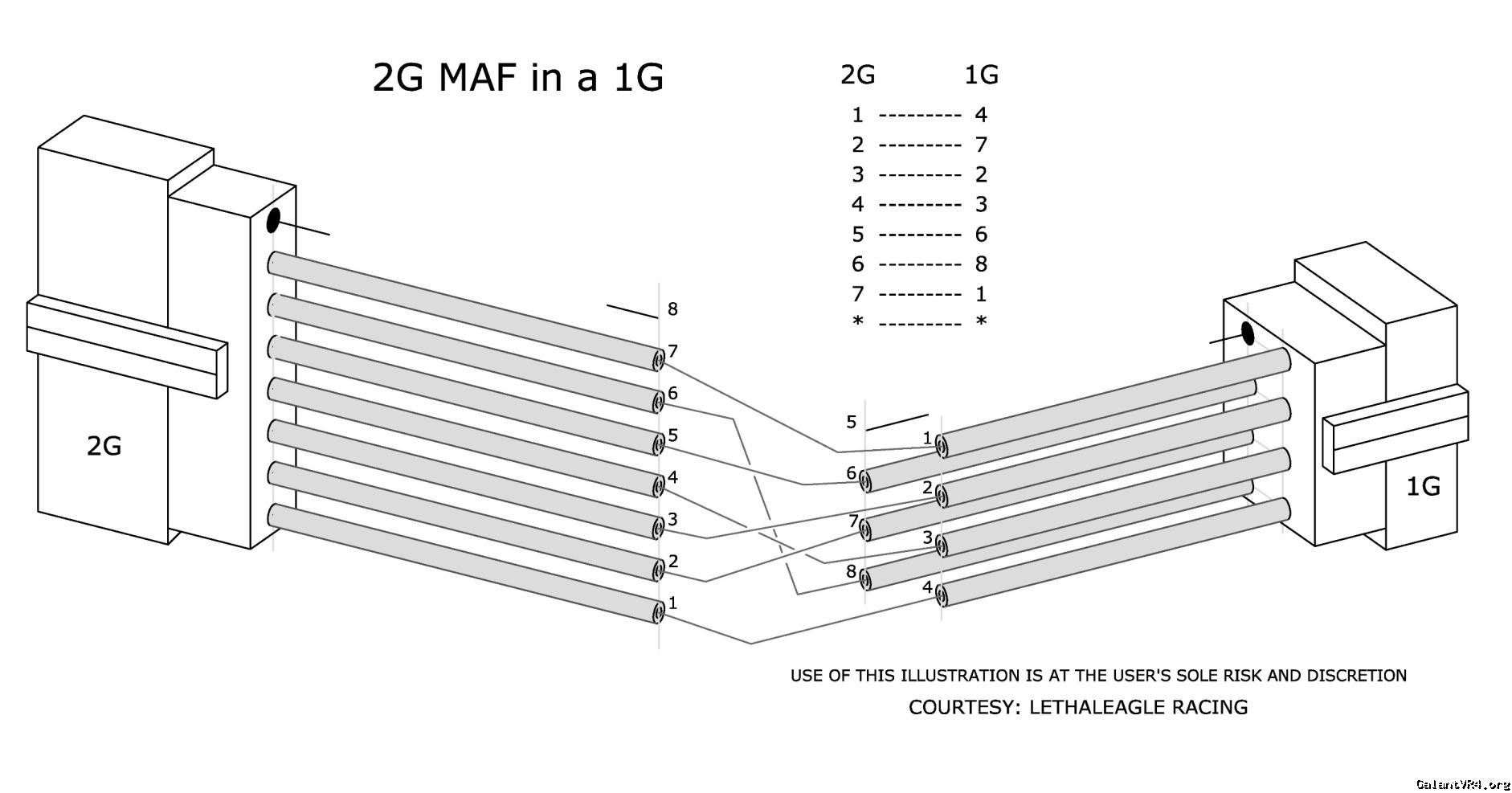

Here is a diagram on how to wire a 2g mas in a 1g car. Keep in mind that the 1g plug is the stock harness, if you are making an adapter harness. Or you can just buy a premade adapter harness from the sticky in the FS: section
