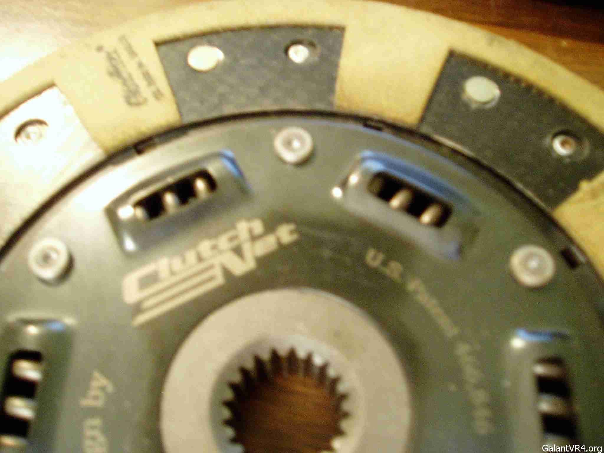

Is there a specific brand of clutch that DOESN'T throw springs? On my 2GNT I had a Spec 6 puck ceramic and it threw a spring after 5k miles. I got a Clutchmasters 4 puck ceramic and that threw a spring after about 15k miles. I now have an UNSPRUNG South Bend clutch that I have yet to install... How much difference is there between sprung and unsprung? Is it night and day? Is it worth taking the risk of buying a sprung clutch for my VR4?
ClutchNet has a patented design on their discs and they DON'T throw springs. Just look at how well they're enclosed, then look at others. The guys that I know that are running these are very hard on their cars. I have not seen one break yet.
The difference is that with a sprung clutch, some of the energy from the clutch drop is absorbed by the springs and not your drive-train. It is NOT worth it to run an UNSPRUNG on your GVR4... not if it destroyes your transmission and drive-train. And you should stay away from puck clutches with the AWD.
3X Red pressure plate with a kevlar/kevlar disc. That setup is $480. If you use a standard street disc it's $410. The kevlar disc will stand up to more power/heat and last longer, worth the extra $70.
*Note* I have the 3X red pressure plates custom made for our application. They don't list it for our cars on their website.
Thanks for the reply... I've never seen a clutch like that before!
