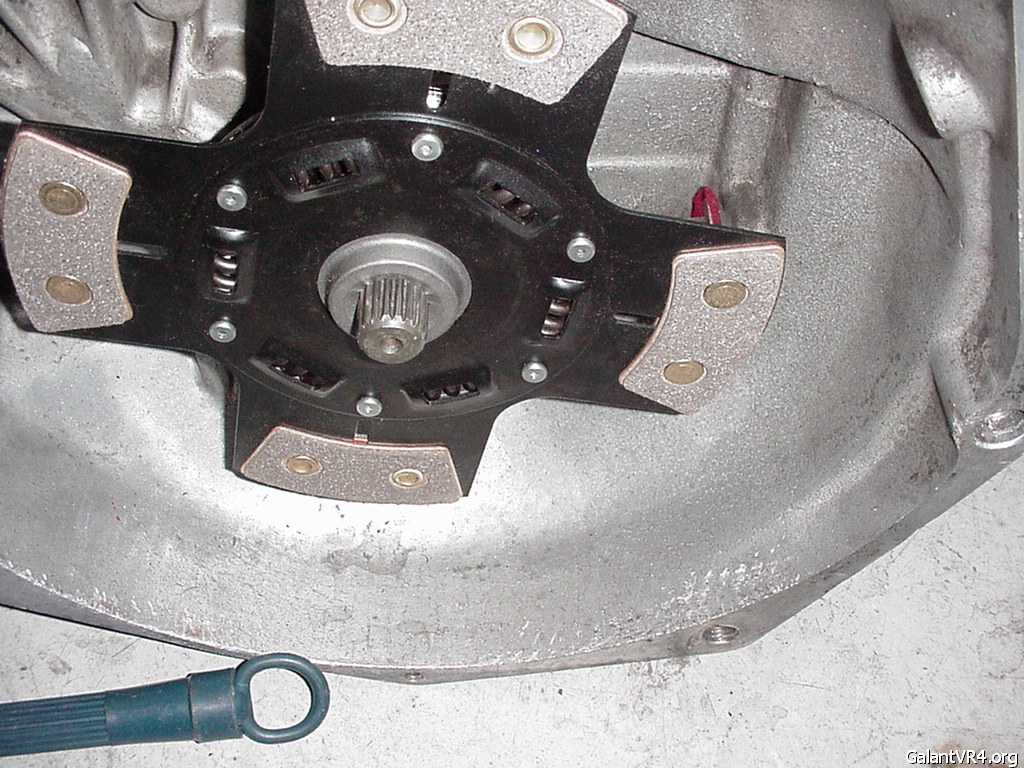

^ They are good in V-8 applications only. I just bought a clutchnet 4-puck for the Daytona. I have only driven it on jackstands so far /ubbthreads/images/graemlins/rofl.gif, but it seems really nice.

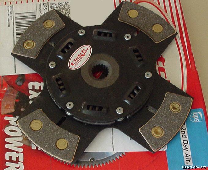

the flat black galant will be using a Clutchnet as well. which of the clutches are you going to run?
If you use a ClutchNet, you'll need a custom made pressure plate (laser cut 3X red) and a kevlar/kevlar disc. This is my favorite combo, but to each his own.

No, I don't have Dale's old car. I have not dyno'd my car but I'm pretty sure it's making over 400hp. It's powered by a TEC T4 turbo... The 3x red pressure plate and kevlar/kevlar disc combo runs $480. $410 if you choose to go with a street disc. The kevlar will engage/hold power better and last longer.
