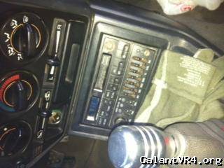

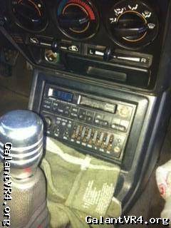

I put a different shift knob that sits deeper then the stock knob.
it is at least an inch shorter.
I pulled the boot up to it.
