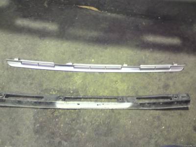

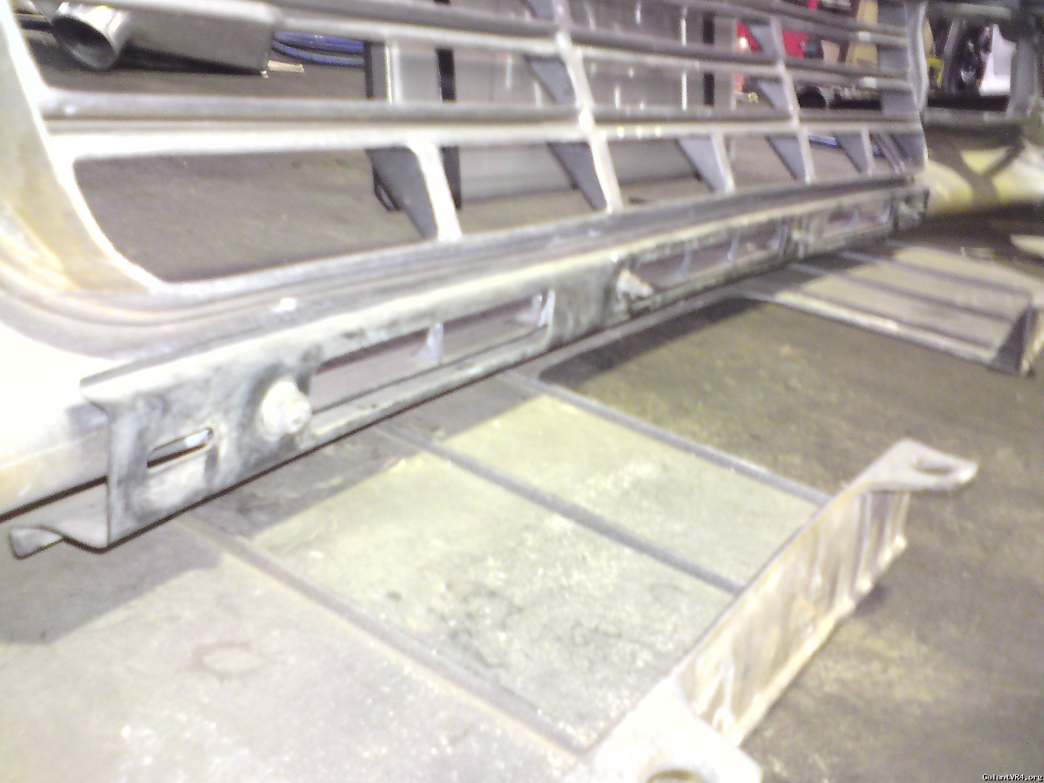

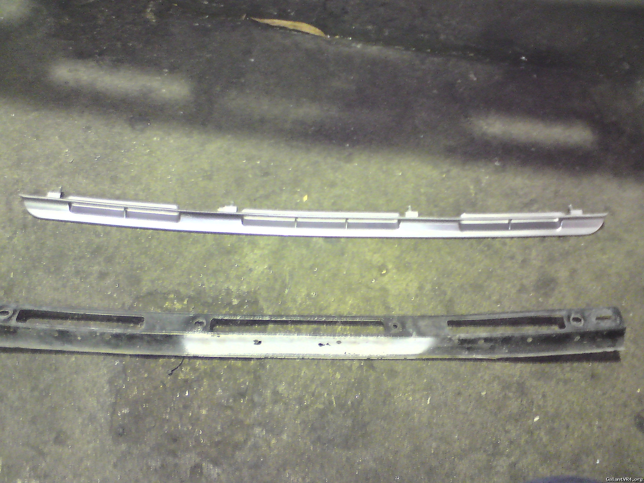

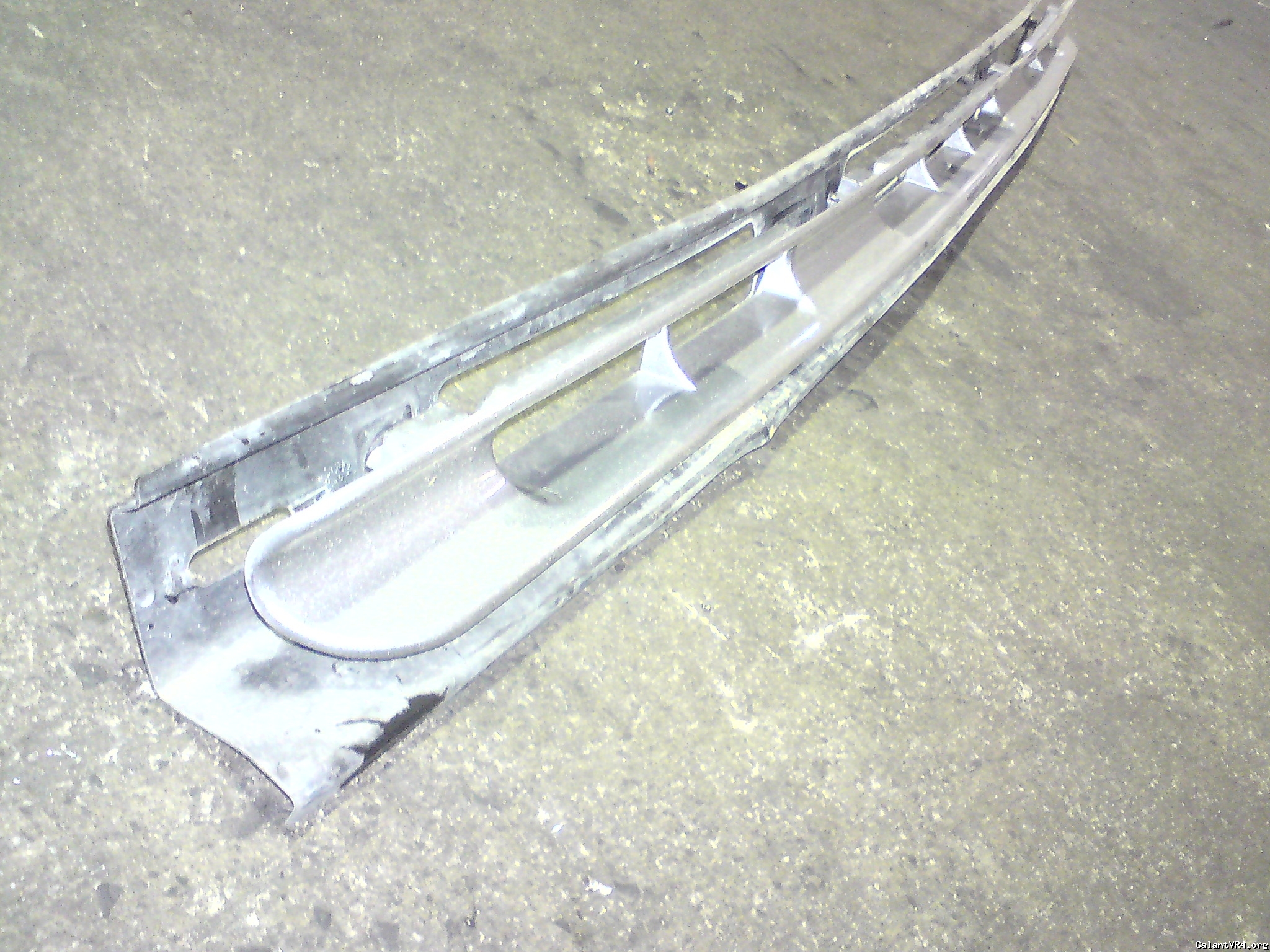

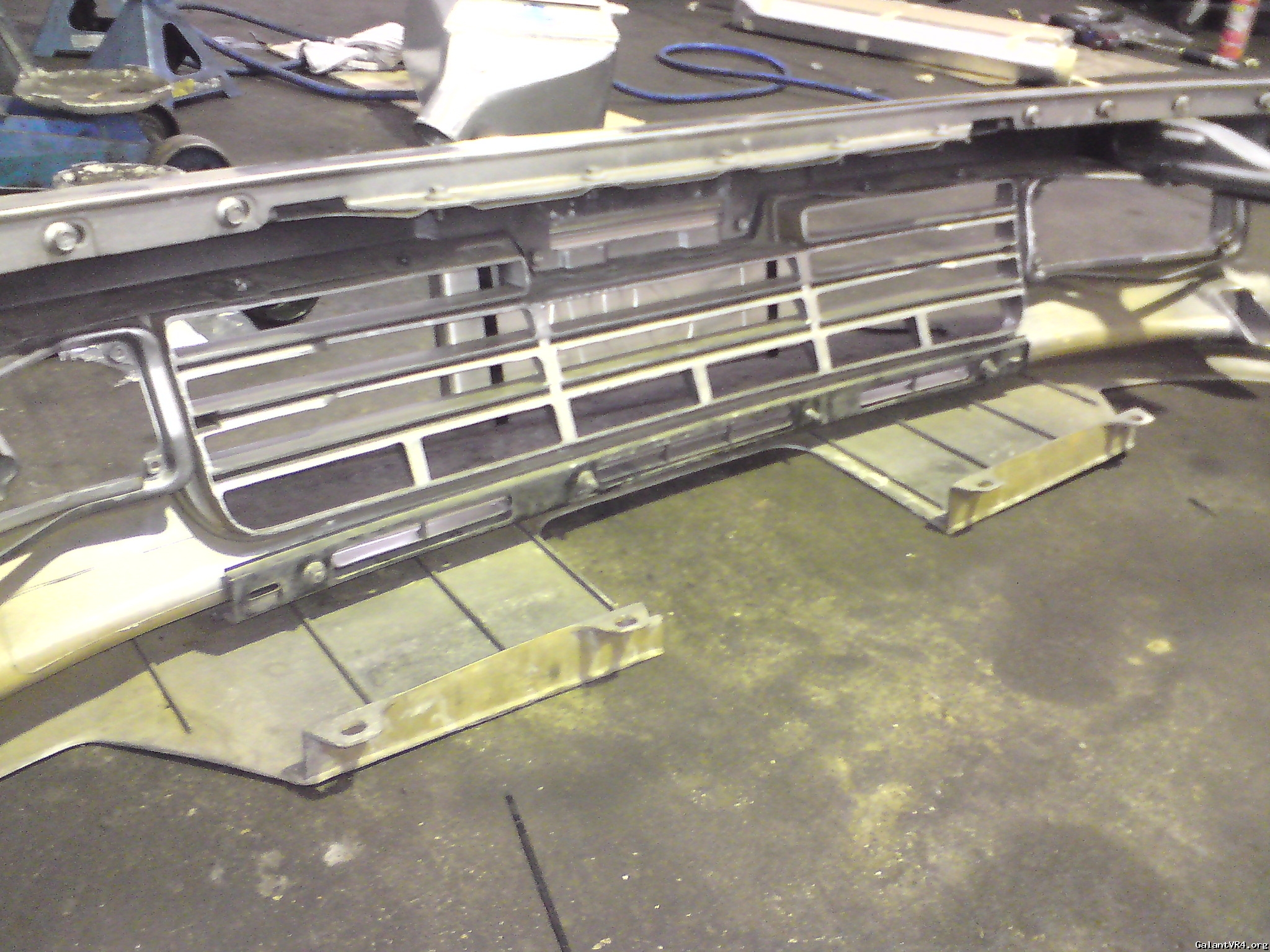

I can't quite figure out how that metal support works. Does the metal support clamp the plastic bit in place?

The metal support just keeps the front vent(plastic bit) in place.
The plastic bit has 4 studs comming off it which passes through the bumper cutouts which then feeds through the metal brace. The bumper is pretty much sandwiched in between the metal brace and the front plastic vent.

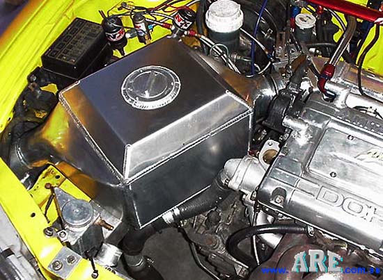

Yes, I will be using 2 coolers. One air to air and the other dry ice to air.

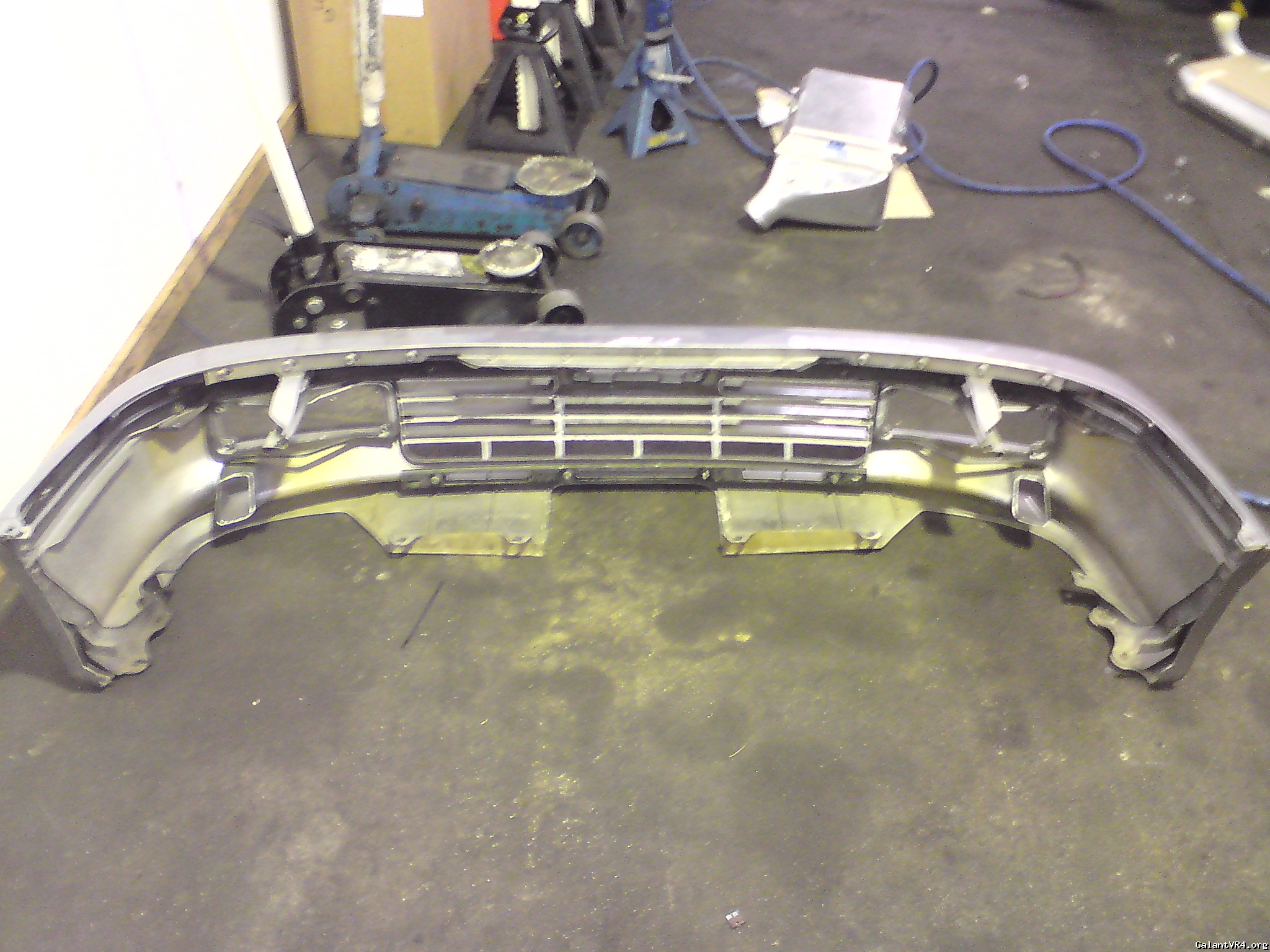

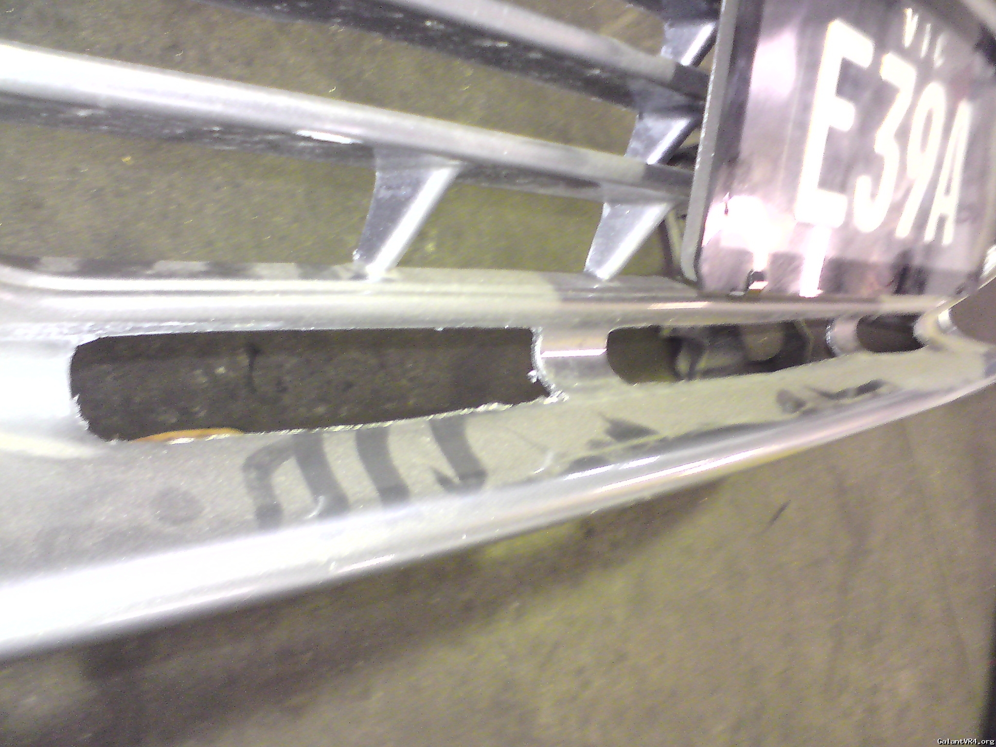

btw, did you buy it separetly? it looks like you cut the holes in your bumper.

dry ice to air intercooler? i think i have now just found out what i will be researching at work all day /ubbthreads/images/graemlins/smile.gif

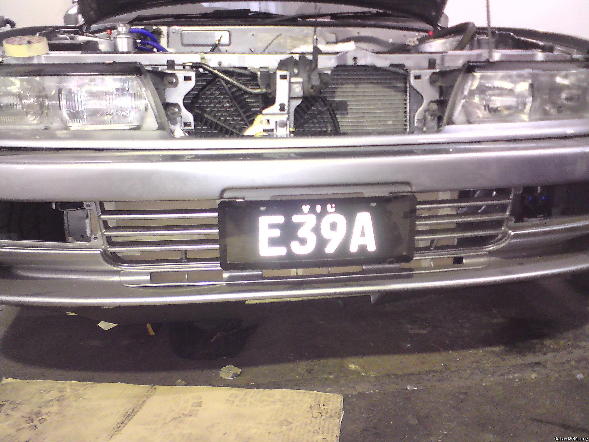

That is an OEM RS bumper. I just though I'd show you guys so if anybody wanted to try and make one they could!

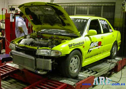

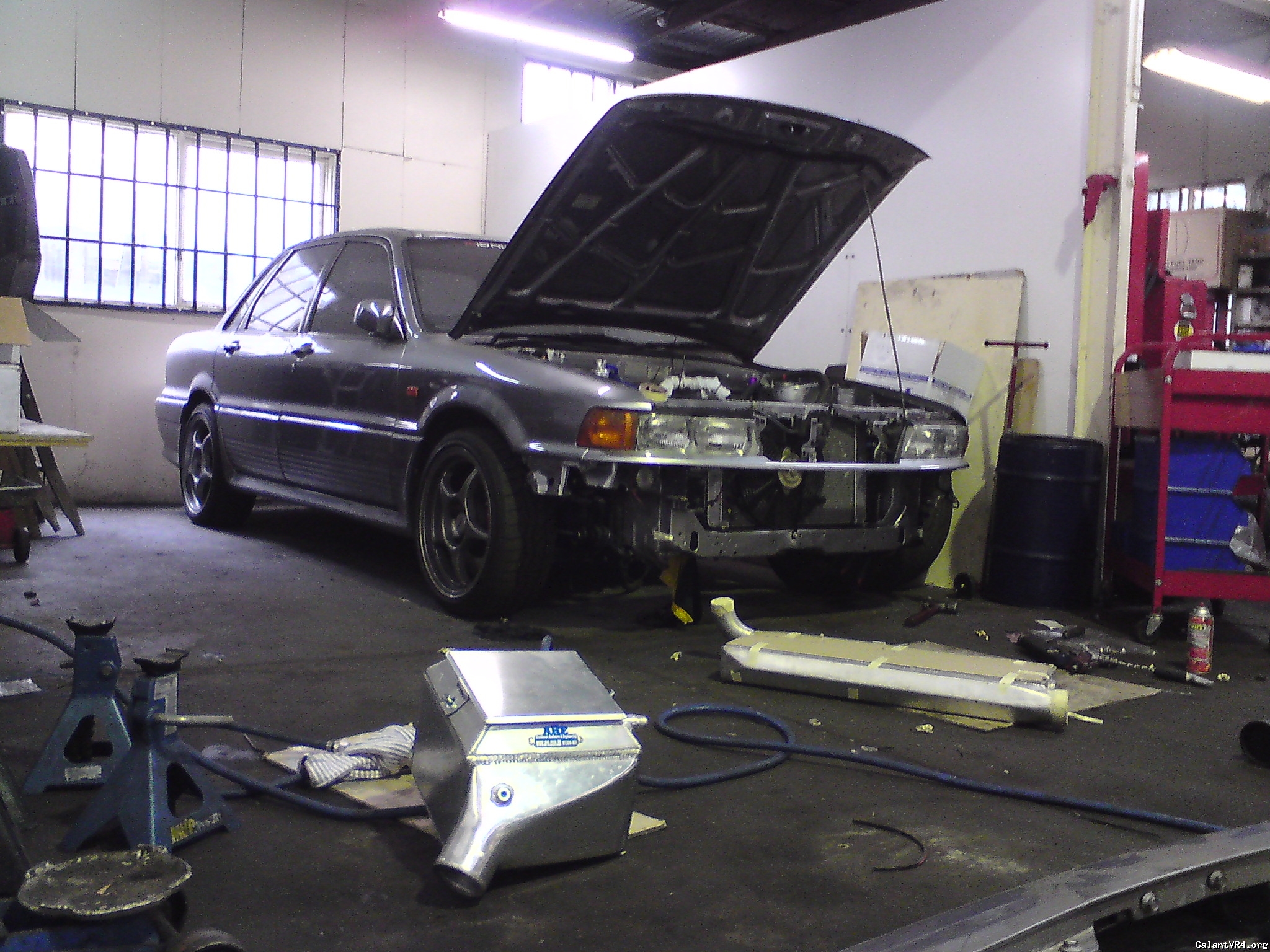

As for the Dry ice to air intercooler
Here's more info - not of my car, but the cooler was actually made for this car as a test. I ended up purchasing the cooler and will be using it in the VR4.

I have seen these before and heard of others that make them, but never saw any hard data on them...WOW!!
I saw the APC evo in one of my mags recently, it is awesome!!
