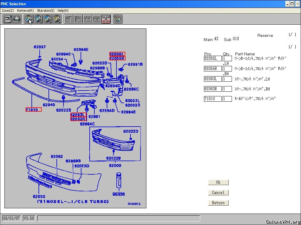

PNC #'s, Part #'s
62040 **NO DATA** Front bumper cover ????
62063L MB549501 L-shaped, mounts to frame brackets 1 per side
62063R MB549502 L-shaped, mounts to frame brackets 1 per side
62055L MB595125 Upper corner at wheel well bracket, to fender
62055R MB595126 Upper corner at wheel well bracket, to fender
62002L MB546037 Lower corner at wheel well bracket
62002R MB546038 Lower corner at wheel well bracket
71010 MB545972

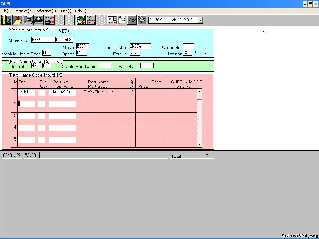

Is this from the vin # i gave you? e38a-0002553

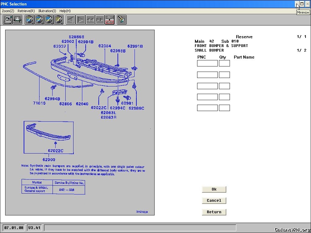

It appears to be the trim piece that usually is imbedded in a recess at the main hoop that runs around the top of the bumper and falls in line with the side body mouldings. The bumper is a one piece deal minus the trims as far as it is pictured.
Sorry about the VIN # I must have missed the "3" at the end but I updated the thread with new pictures to show you what it should have looked like.
Now get this, "No Info" for the bumper cover itself comes up now!!! /ubbthreads/images/graemlins/frown.gif

So your looking up 62040 ? I thought i remember looking it up a year or so ago & it said the same thing.

Just for shoots and giggles I looked up the E38A galant to see what a basic bumper pic would come up like in Euro Caps, and voila, I got just the center section with colour match center moulding strip and then this->

the last pic is the wrong sevtion for a vr-4 with an e38 vin.

The bumper cover should come up if you pick the kit onthe lower right. It'll be a crassh repair set in white primer. (#82000)
yes the 71010 is the trim

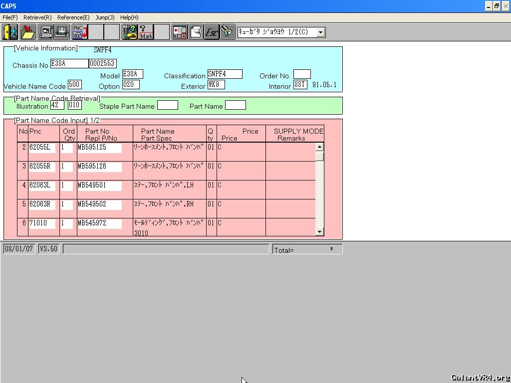

Here's a screen cap from that chassis number
That also gives the vehicle code automatically, the model code and the build date, colour option and interior option.

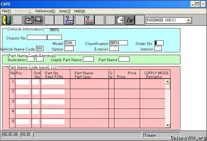

Here's the same info from the vehicle and the model code:

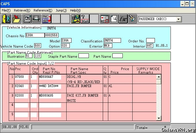

Here from the vin number you supplied i can get the bumper face kit to show, but it is an "rs" vin as the rs emblem comes up .
