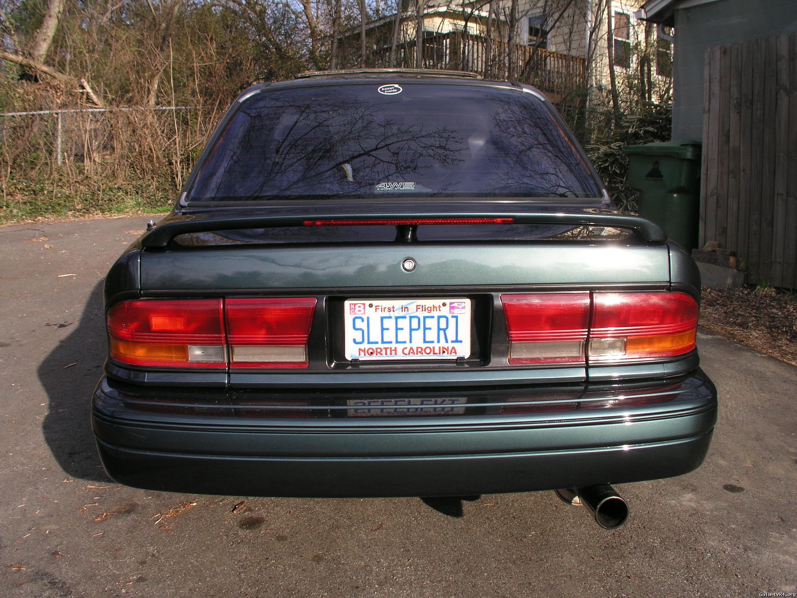

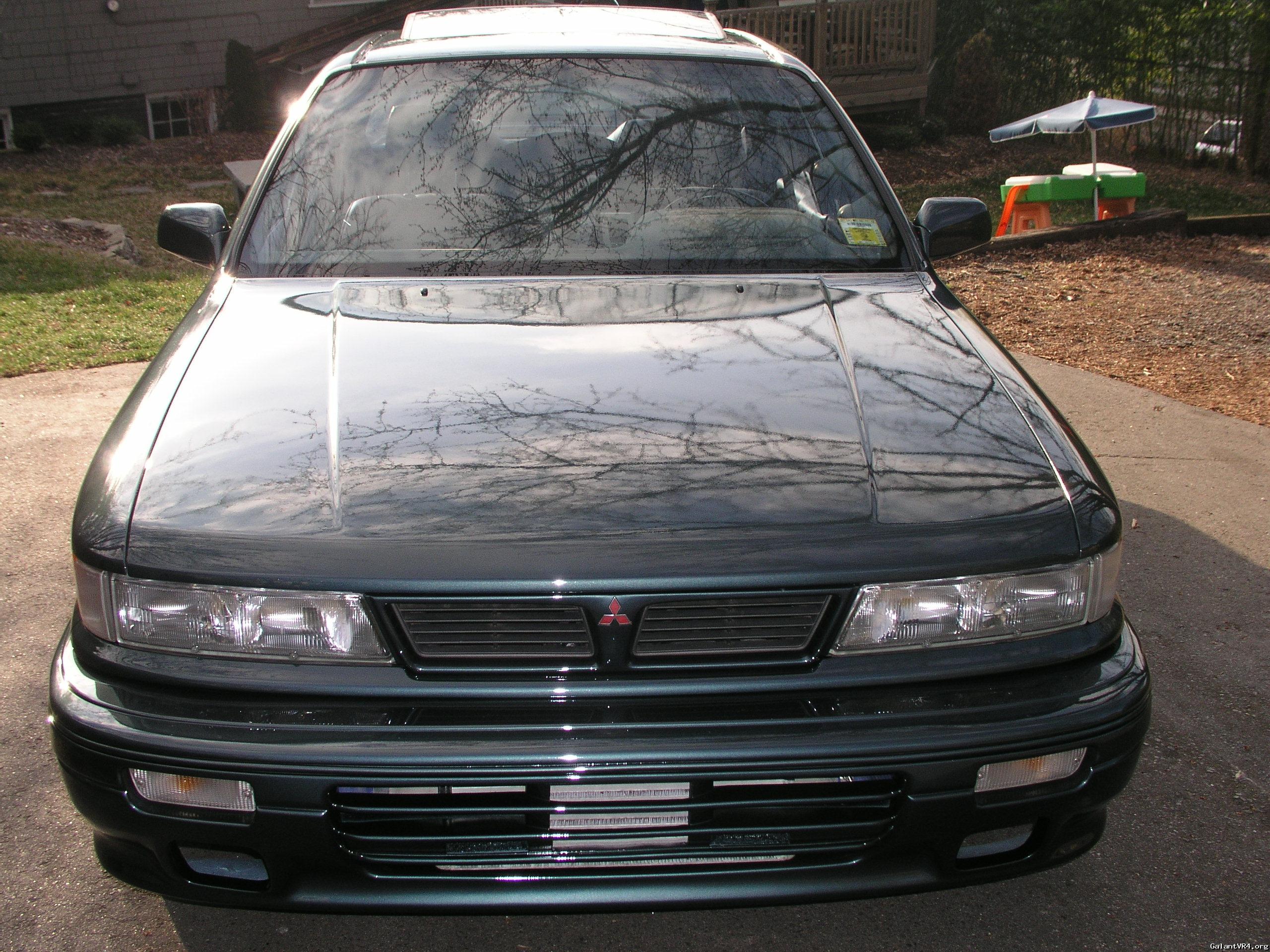

I had my chrome trim painted to match the body color:
That looks great! Was your chrome stripping peeling at all before you painted it?

It was peeling. The guy who repainted my car just pulled the old stuff off, bought new stuff that is the same width, scuffed it, sprayed adhesion promoter and shot the base coat and the clear. Then he put it on before the paint was cured. It had the adhesive already on the back.
