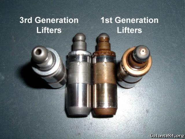

THIS:
I have a brand new build. Lifters are noisy as hell on cold starts. I accept that the break-in oil could be contributing, but after a chat with EHMotorsports, we decided revised lifters were in order.
you may be able to see why...
He says he can get them in without pulling the cams, so we're doing it when it goes back in post-break-in for a service, a rear main seal (doh), and some helicoil work on various bolt holes on the drivetrain we found stripped during the build.

tekic, Did you do the oil mod? Do you know the thickness of your head? What HG did you install?
Keep in mind the head is oiled last, so pressure and flow are reduced by the time it makes it to the head. But from reading of the Kiggley HLA regulator, the HLAs need about 15psi.
It can take 30 or so minutes for them to shut up with 50psi or so being pushed through them so they can lock into place.
Also if the HLAs have age on them, and went thu several infrequent oil changes they can varnish up causing the valve to stick. Cleaning them as the FSM says can make matters worse by softening the varnish.
At this point disassembly or replacement of the HLA is needed.
Now these come from the same manufacture that Mitsubishi used when the factory was buying them.
They are the revised 3g style.
EfiniX, If you have not ordered a set, I would suggest the above set.

Thanks, Bogus. With the 264's, definitely something worth having. And you read my mind as I already ordered them!
And for the record, Bogus did the oil mod on the head he sent me already, so the revised lifters are definitely a must for me as well as they tick pretty loud on cold mornings.
