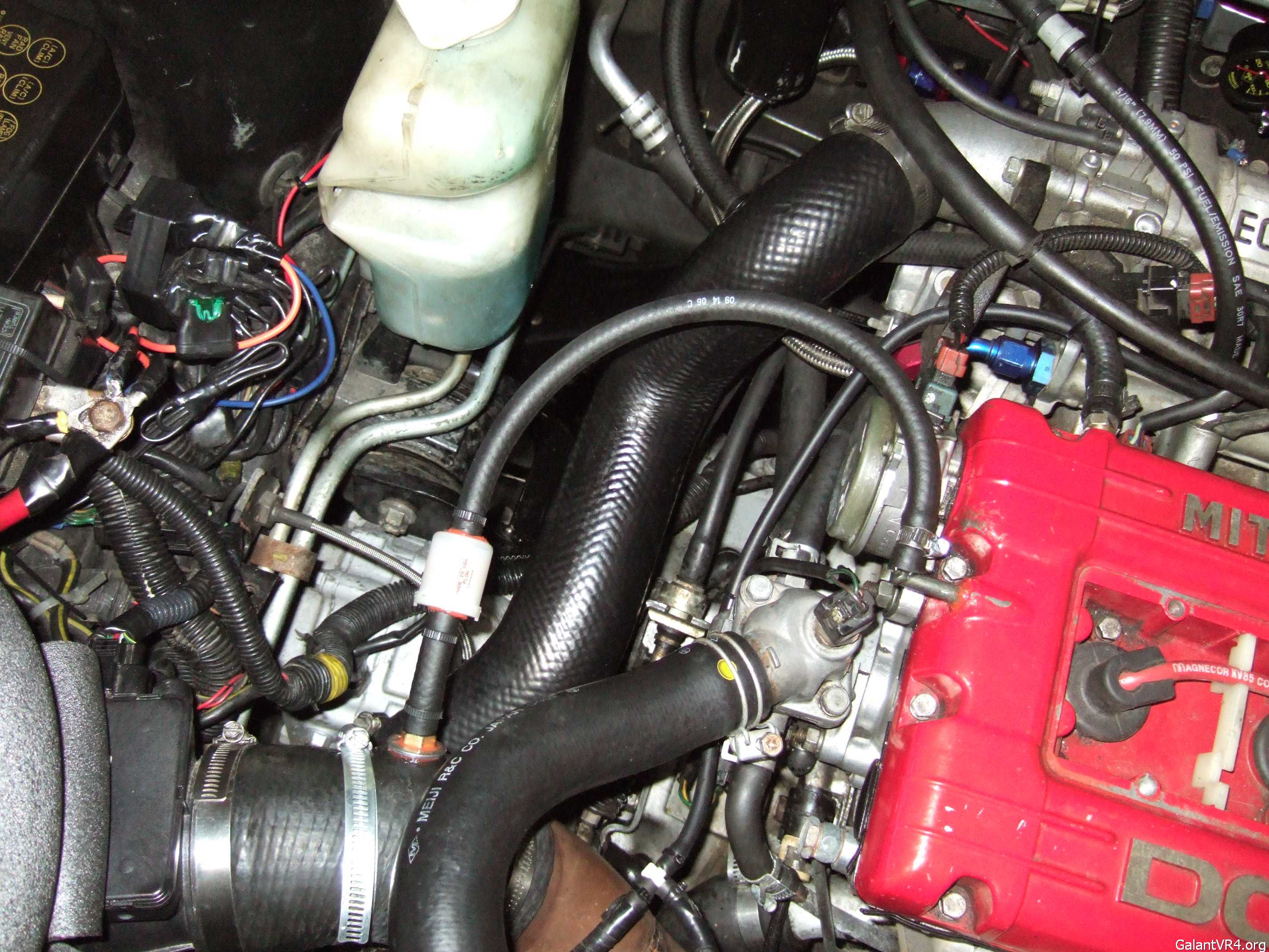

I'm going to try this for a little while and see if I get any oil in the intake pipe. I put a brass barb in a soft part of my intake pipe, and attached that to an inline filter that feeds from the valve cover vent elbow. So essentially it's setup like stock with a filter:

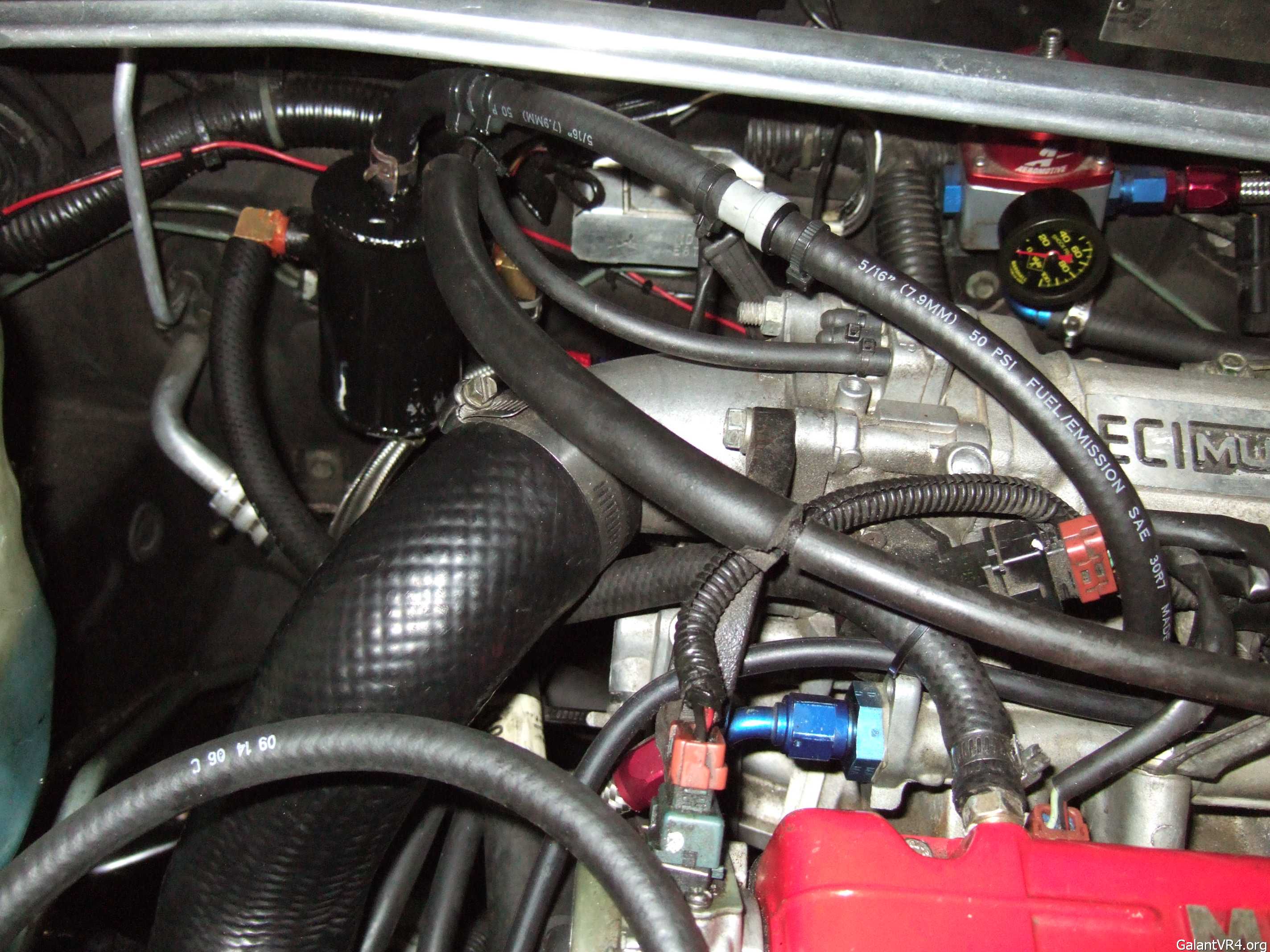

I ran a straight fitting from the PCV valve hole in the valve cover. This goes to a sealed catchcan. I blocked the opposite hole of the catchcan. Then I ran a hose from the top of the catchcan to a fitting on the intake manfold. There's an inline plastic PCV valve in that hose:
I didn't test for any intake leaks, so I'll be interested to see if that inline PCV valve can hold boost. Any comments? This is by no means permanent, and can be modified pretty easily.

At this point you're completely not emissions compliant anyway so I don't get why you don't just vent them both as I recommended. /ubbthreads/images/graemlins/dunno.gif It'd keep the gunk out of your intake tract and your intake manifold, plus it will eliminate any unmetered air from getting into the intake system.

I was under the impression that venting the PCV valve (with no vac pulling it open to evacuate) doesn't help draw the crap out of the valve cover. I also thought the air coming out of the valve cover breather tube was metered air that should be routed back into the system.

If you replace the PCV valve with a fitting, and vent everything on the VC to atmosphere then you don't have to worry about any metered or unmetered air being involved with the breather system. If you put the hoses off of the VC down near the bottom of the car, the air passing under the car will pull the fumes out of the crank case. Besides, you change your oil often so sludge won't be a problem.

Well sh*t, all that work for nothing. I'm leaving it as is for now.
I had both vented to atmosphere before, through a filter on top of the catchcan (no PCV valve) and it made a mess out the top of the filter. I also got some nice sludgy oil/coolant sperm-looking mix in my catchcan with it setup like that. I don't want that juice blowing all over the bottom of my car. The catchcan should catch anything coming via that route, and I'm hoping the inline filter will catch anything coming out of the valve cover breather before that air goes back into the intake pipe. Everything is dry right now, and I plan to monitor frequently for oil residue. If my intake is getting greased, I'll change things.

Update: My valve cover breather hose spits the funk out just ahead of the steering rack down onto the road. The other hose (with PCV valve removed) goes into a catchcan with a filter on top. This setup has resulted in the least amount of spewage from the catchcan filter, and frees up a port on the intake manifold to use for something else.
