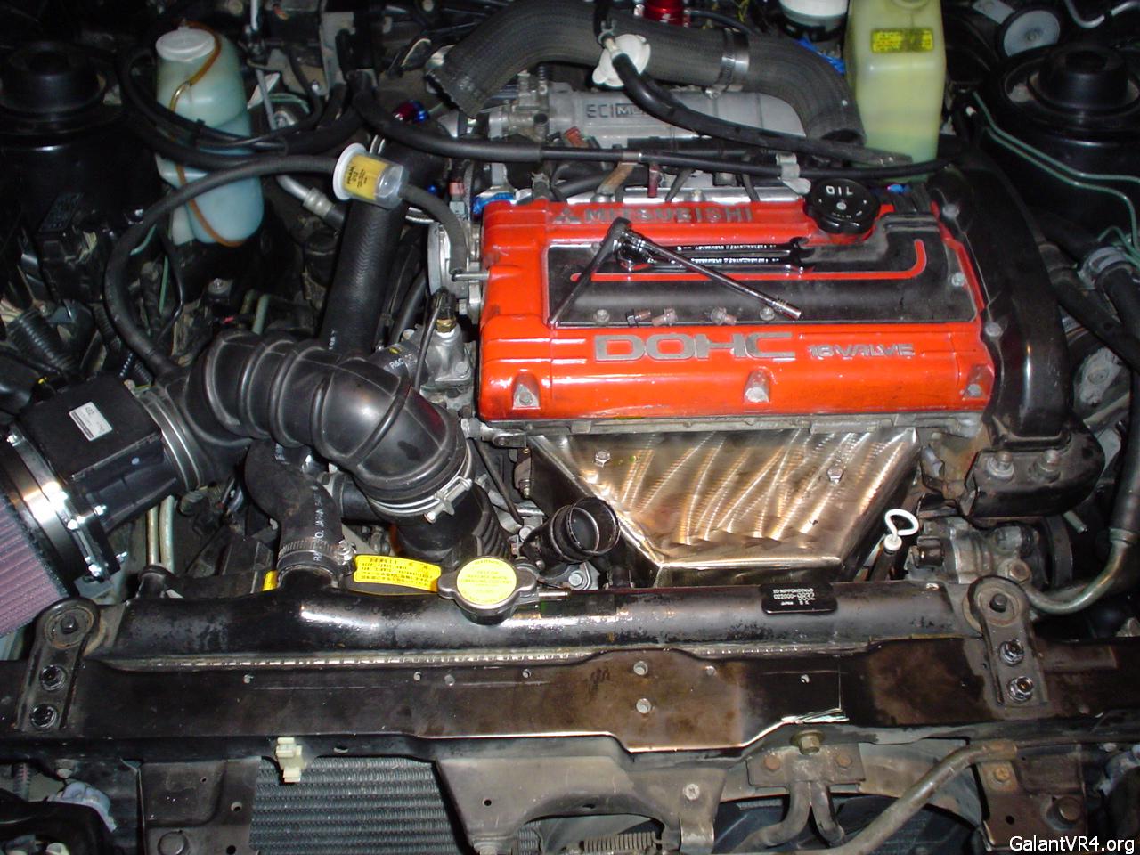

I have the same thing on my car. So far I can see oil being collected, but I haven't really looked at the inside of my IC piping to be sure that NONE is getting through. Here's a pic:

TOF, you might as well just run the valve cover vent to a catch can. Having it plumbed to the intake ahead of your MAF like that is really the exact same thing. Your valve cover vent is still sucking in non metered air when the PCV opens. The only advantage to your setup is that the air is being filtered.
The reason to run that vent back into the intake, is so that all air entering the engine has been counted. Your AFM (in this case a GM MAF) is well down stream of where that valve cover vent is hooked up to. That vent sucks air right in through your cone filter, totally bypassing the MAF.

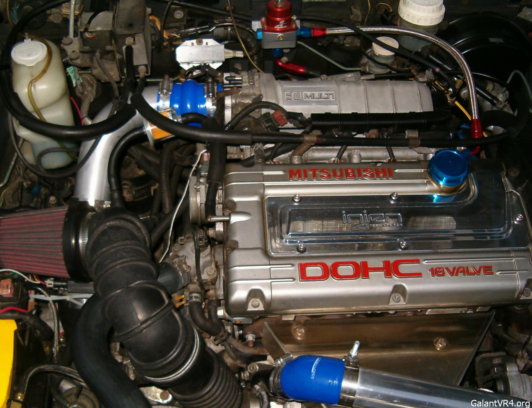

My catchcan vent typically blows oil spray all over that side of the engine bay. I'm currently running NO pcv valve. I've routed both the valve cover and pcv outlets to my catchcan. The useless filter sits on top of it.
I'd like to get this back to as stock as possible by:
1) Adding an inline filter to the valve cover vent and running that beneath the car and out.
2) Re-installing the pcv valve and routing a hose from that to the catchcan.
3) Blocking the second inlet for the catchcan, and running a hose from the top outlet to a port on the intake manifold. This way the pcv valve is vaccuum activated, but the catchcan can hopefully catch oil in its liquid form before it gets to the intake mani. Obviously oil vapor can still pass to the intake.
So in this case, I would not be doing anything with the metered air coming from the valve cover vent.
Would this setup work, or will something screwy happen? I'd like to get the pcv valve back into the system and operational.

When the PCV opens it will pull air out of the Valve cover. When you leave the vent tube open it can suck air through that and into the intake manifold, this will be unmetered air. Not much air but it will be there. After having my catch can a while and reading up on it more I too am going to put a pcv back in. I am going to tap my Dejon intake pipe for a barb fitting though and do it exactly as stock, with the exception of a catch can between the PCV and IM and filter on the Valve cover vent to Intake pipe hose to try and stop oil build up.
