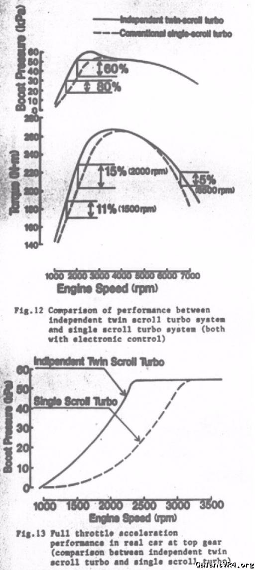

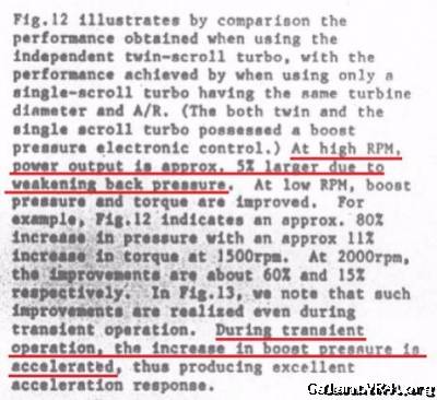

Extract from a Mazda technical paper on single vs twin scroll turbos, comparing two otherwise identical turbos:

Thanks for that. I was never completely sure if the decreased back pressure would actually help the turbo breathe any better with results
