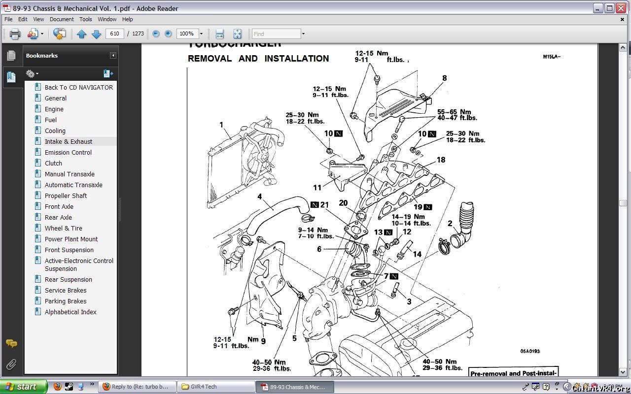

what is the torque specs for the manifold to turbo bolts?
971of1000 Well-known member Joined Oct 29, 2008 Messages 100 Location joplin, mo Jun 4, 2010 #1 what is the torque specs for the manifold to turbo bolts?
TRBODSM Well-known member Joined Feb 4, 2009 Messages 278 Location Northglenn, CO Jun 4, 2010 #2 I am pretty sure they are 40-45 ft lbs.
