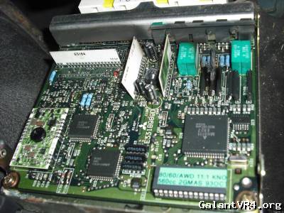

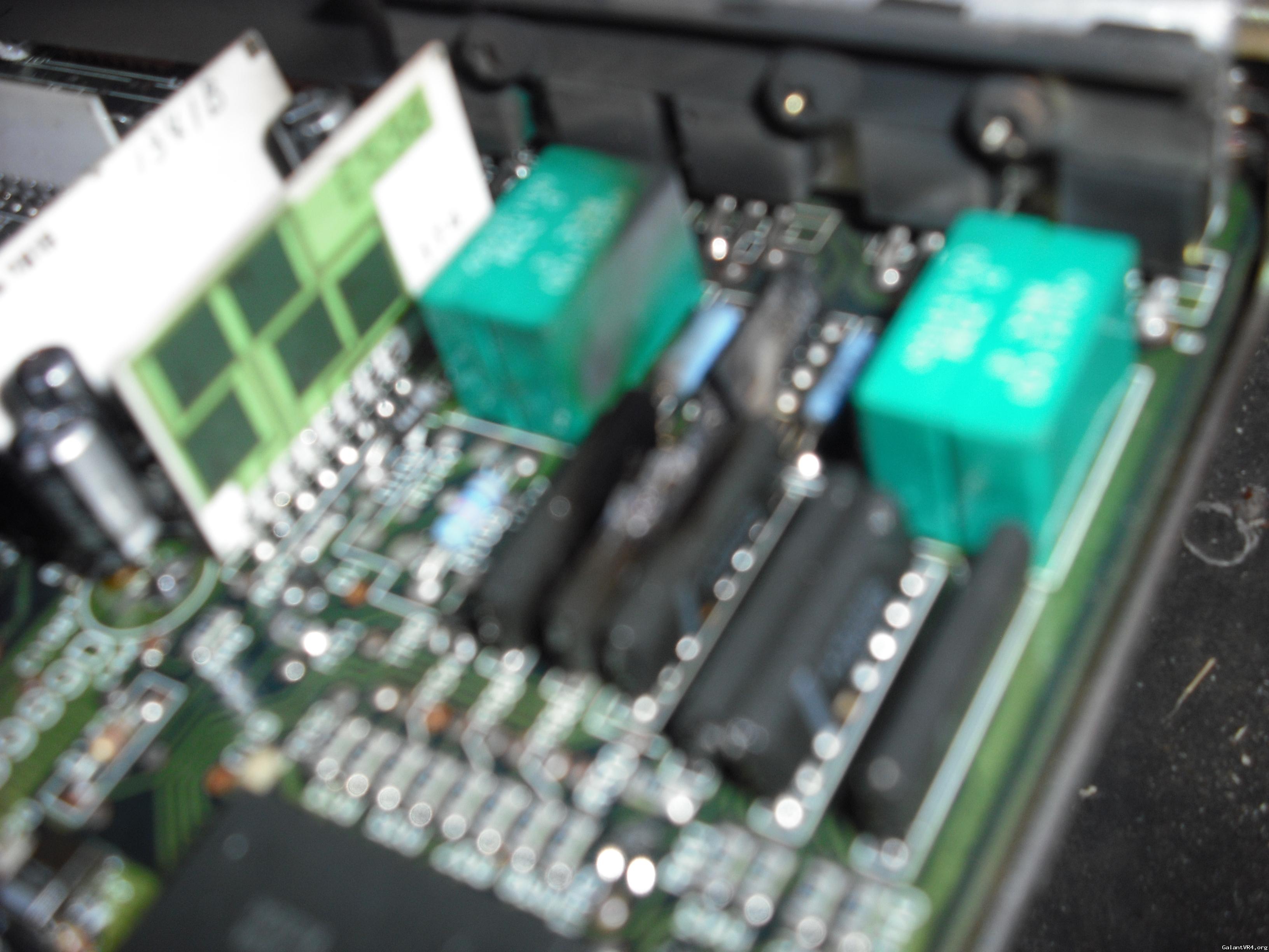

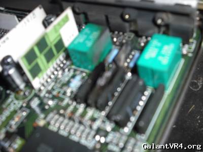

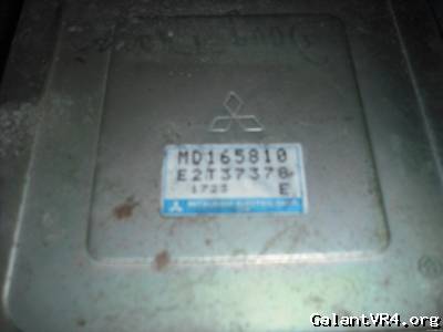

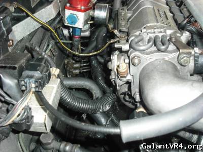

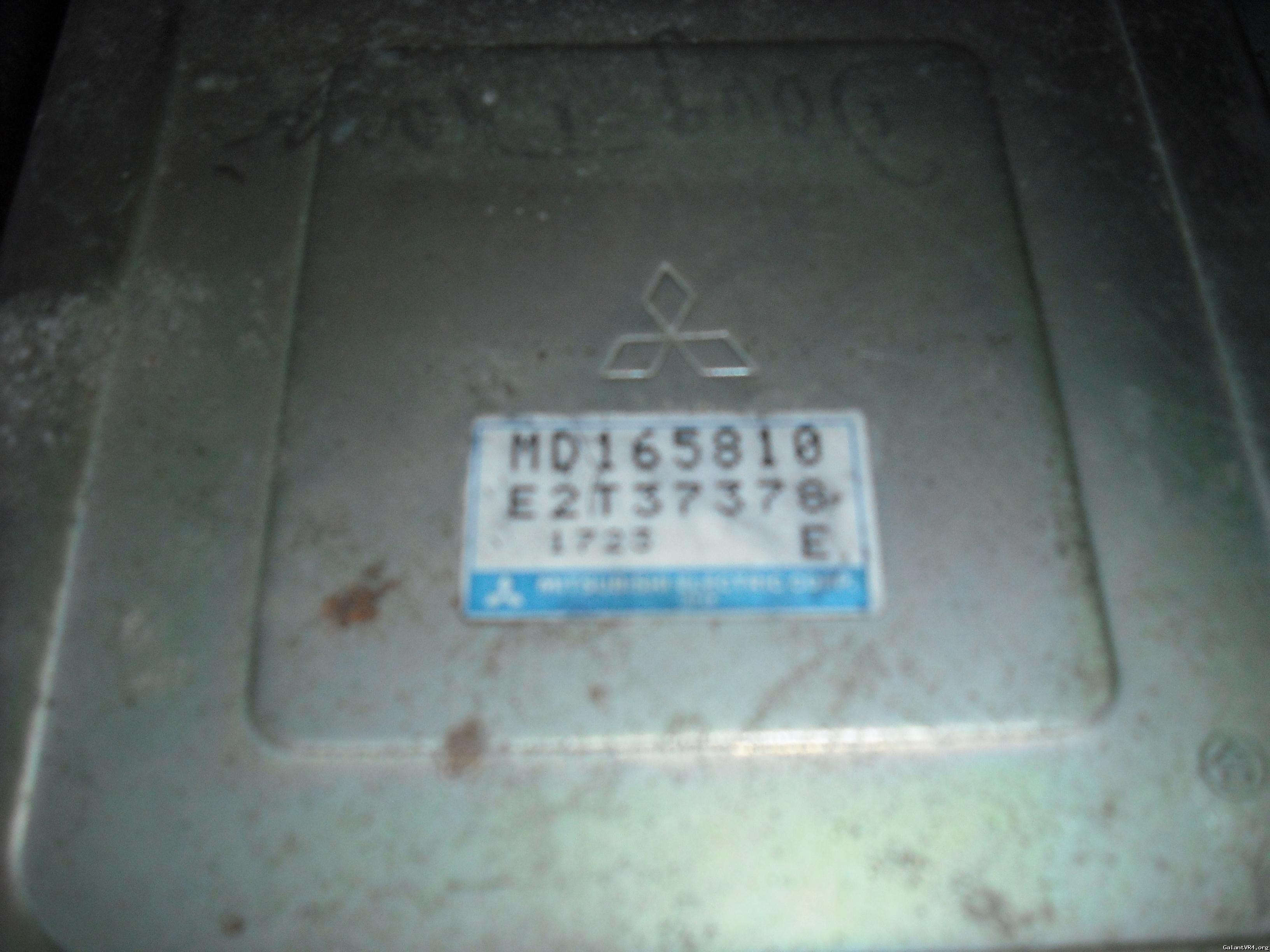

Sweet Jesus... Your IC105 driver is toast. Most likely cause is a coolant leak from the FIAV into the idle speed control circuit causing it to short out the ECU. BEFORE you plug another computer in you need to pull your ISC and check it/replace and more than likely replace the O-ring seal on the bottom of the throttle body between the FIAV and TB...
Your best bet is to replace your ECU rather than try to repair this one.

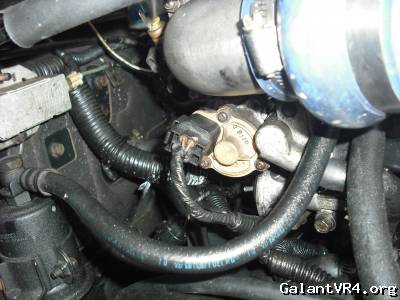

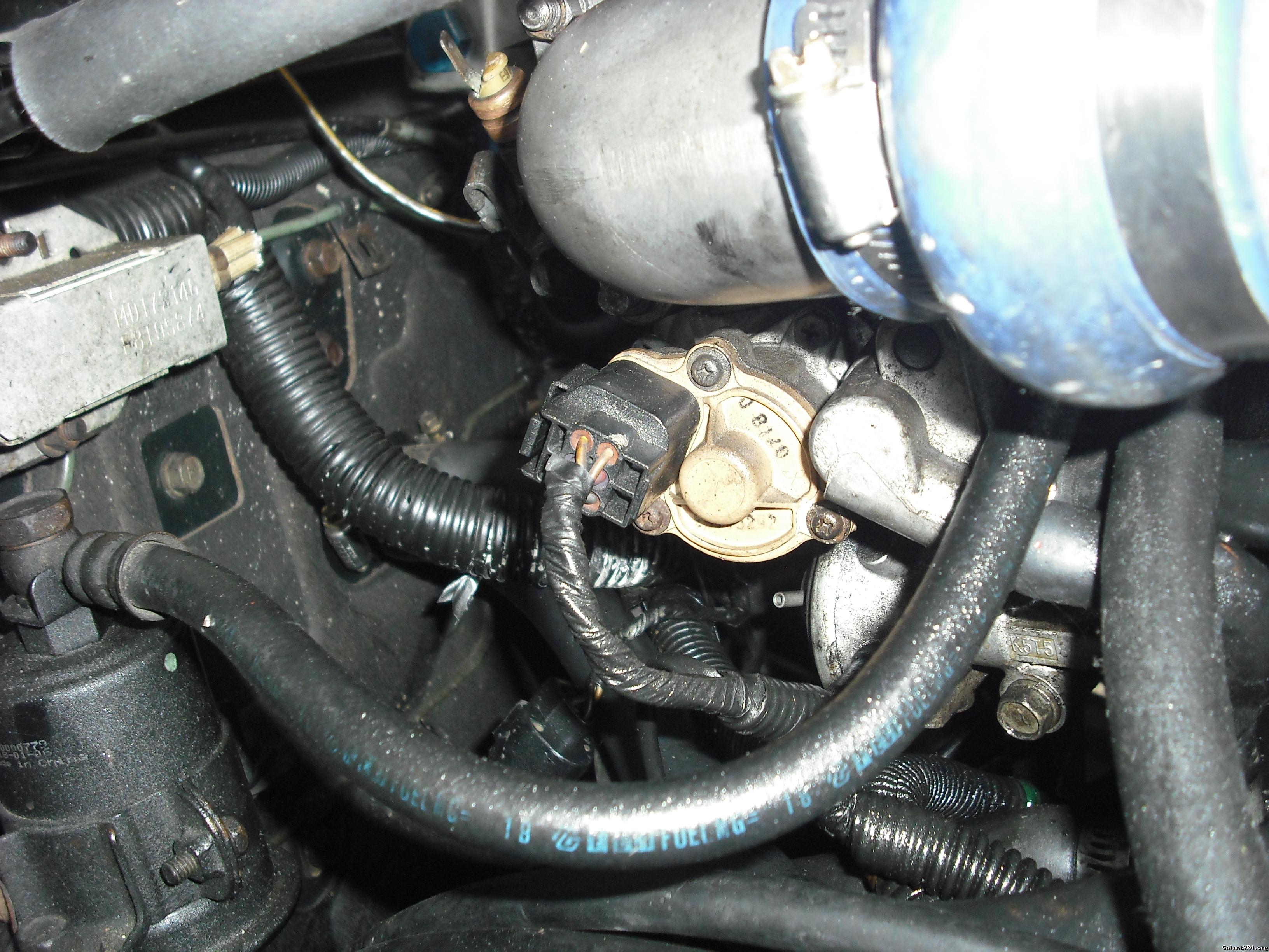

the part i need to check and replace is the tanish piece in the first pic. if so how do i test and a complete engine gasket kit should have the o-ring right

That is the piece you need to test and NO, a complete gasket kit WILL NOT contain the proper O-ring to fix it, you have to buy it seperatly. For instructions on how to test the ISC you should head over to VFAQ.com and browse over their tutorials.
AnotherNewb
Apr 25, 2010
1,472
Orlando, FL

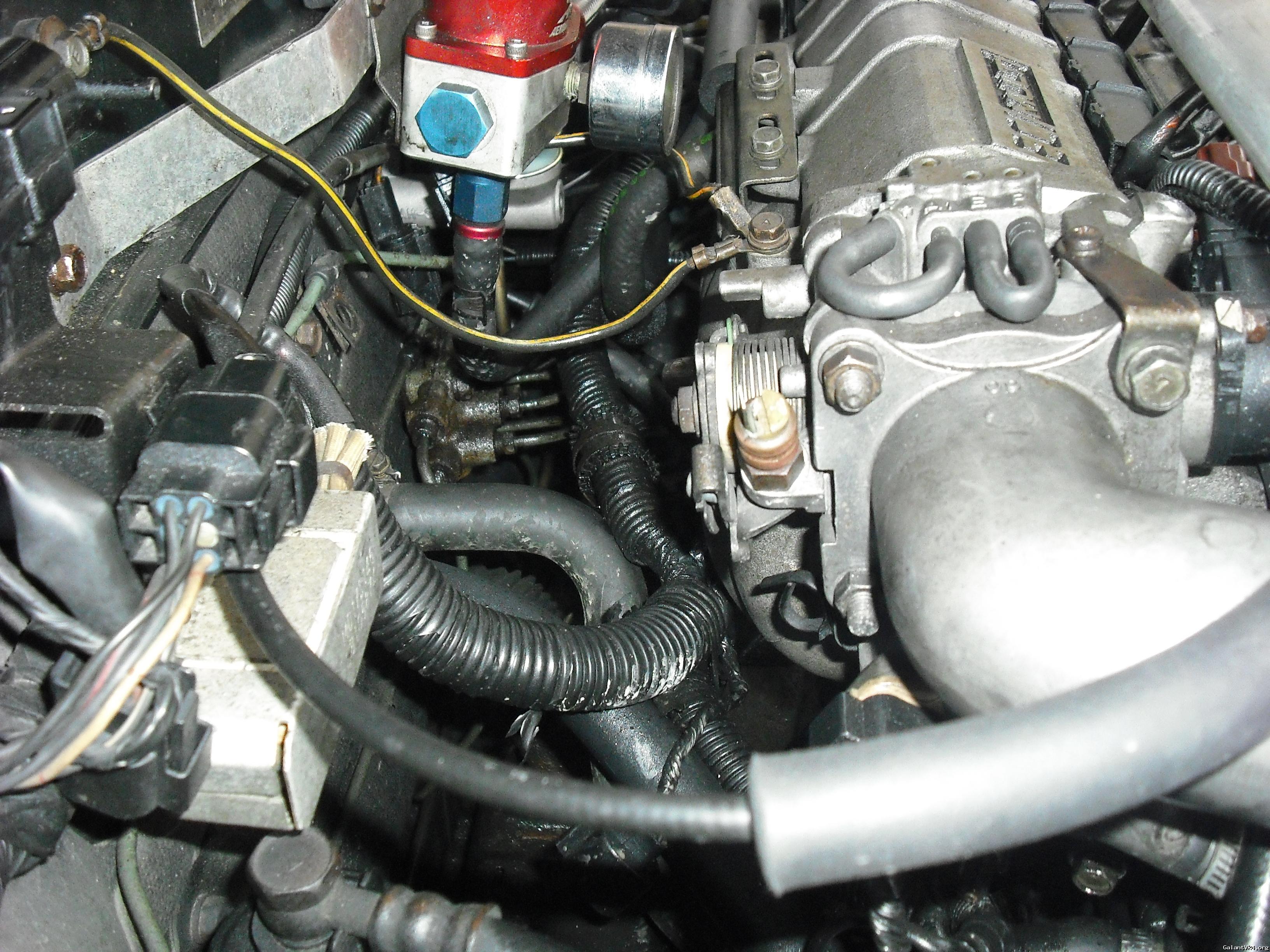

Yep. Test the ISC, replace if necessary. Make sure coolant isn't getting into the ISC's passages and replace the o-ring between the FIAV and TB.
Since you are going to have the throttle body off (assuming the FIAV o-ring is leaking) you might as well rebuilt the TB now.
I'm not saying to buy your rebuild kit from ebay, just posted the link as an example. The FIAV seal is the funky looking o-ring with 3 passages. This is the seal that is most likely leaking and caused your ISC to shot out, thereby shorting out your ECU

But I should mention that the ISC may have shorted out and been repaired just no one noticed the damage to the ECU. This is why you should properly diagnose everything before you start throwing parts at the car trying to fix it.
The IC105 controls the ISC. Fixing this may not correct your originial problem regarding fuel consumption and how to tune, or it very well could.

so if i bought a regular ecu (stock) would i just be able to solder in th e plug for the chip and be good to go or is there more to it. anlso what cars can i pull one from?
Diego
Dec 9, 2007
2,132
It's hard to say, Eproms were hard to find back in the beginning of this whole tuning aspect.
Some turbo 91-94 t/e/l had Eproms, some
Gvr4s were picked through in the beginning because everyone had an eprom.
So go scour your Jyard, but when you don't find one, you'll be back, asking the people that have already saved you the hassle of looking.

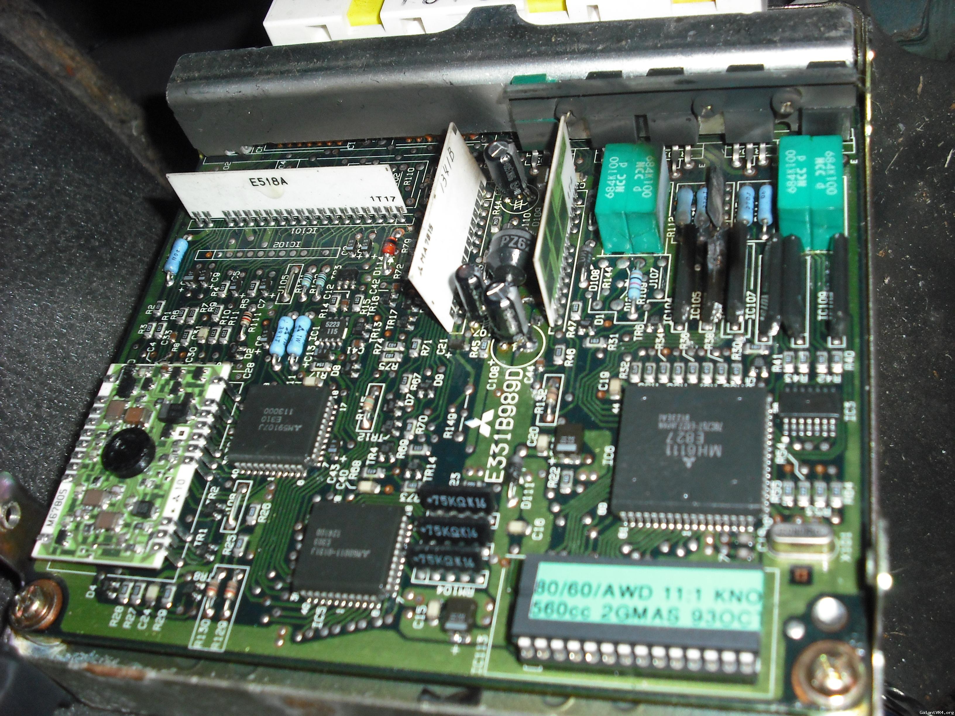

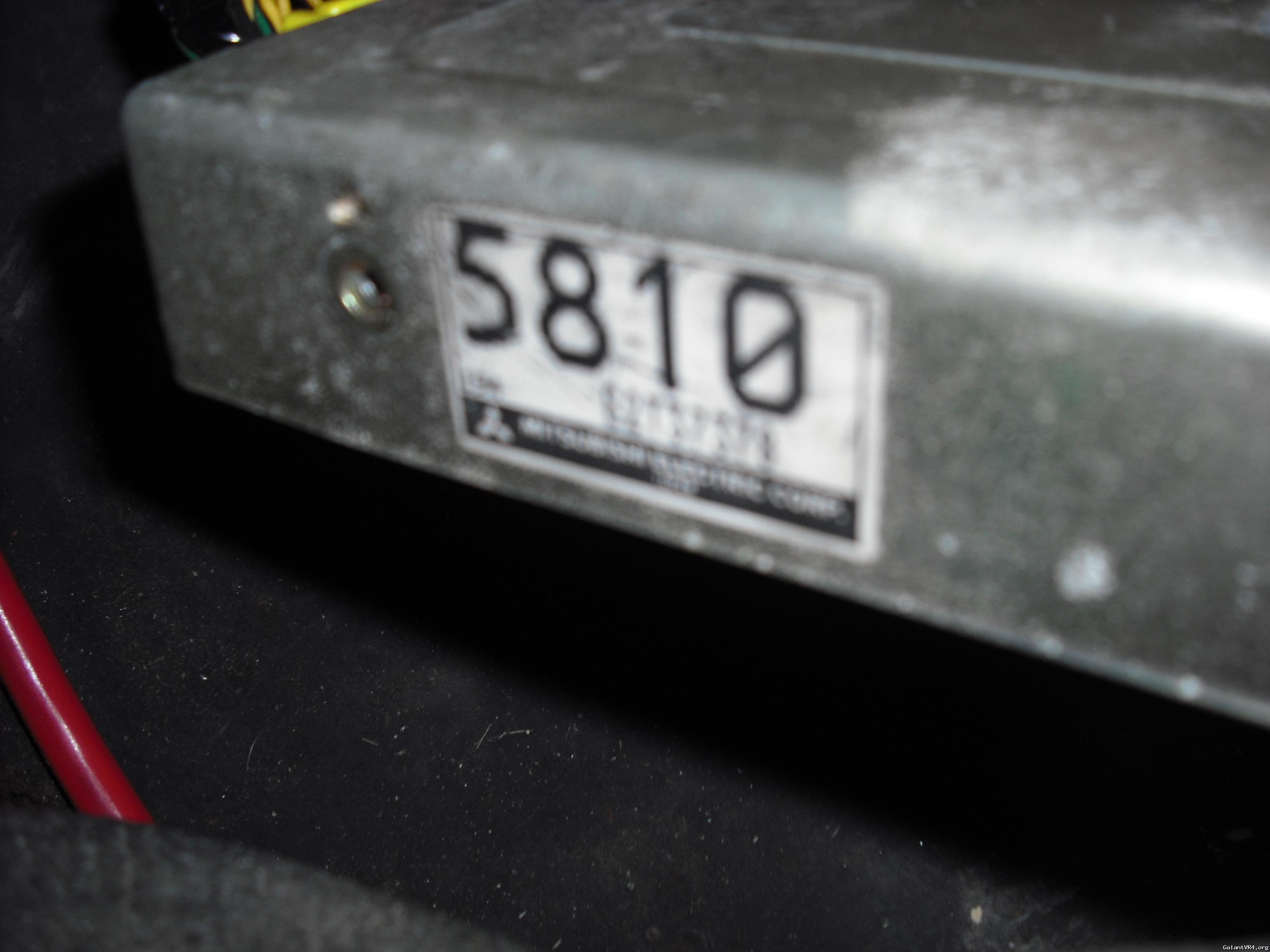

i didnt know some cars had eprom and non eprom i thought the eprom ones ment it just had the socket soldered in already /ubbthreads/images/graemlins/dunno.gif
so i just talked to a friend and knows where i can get one for free from a salvage yard. But how do i tell if it is eprom or not.
