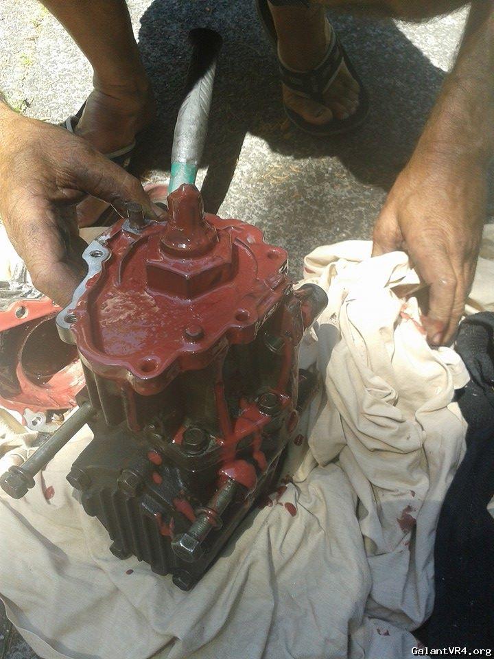

No data, the car is still on a base tune until i get some passes in one day, the transfer brakes on launch, ive had three launches and broken three transfers. Before this i raced the car most weekends for years even running 9 second passes and have never broken one. The difference is ive gone from a twin plate to triple plate clutch, drag slicks from radials that had abit of wheel spin, step two launch control at a higher RPM than the antilag that i was running before.
