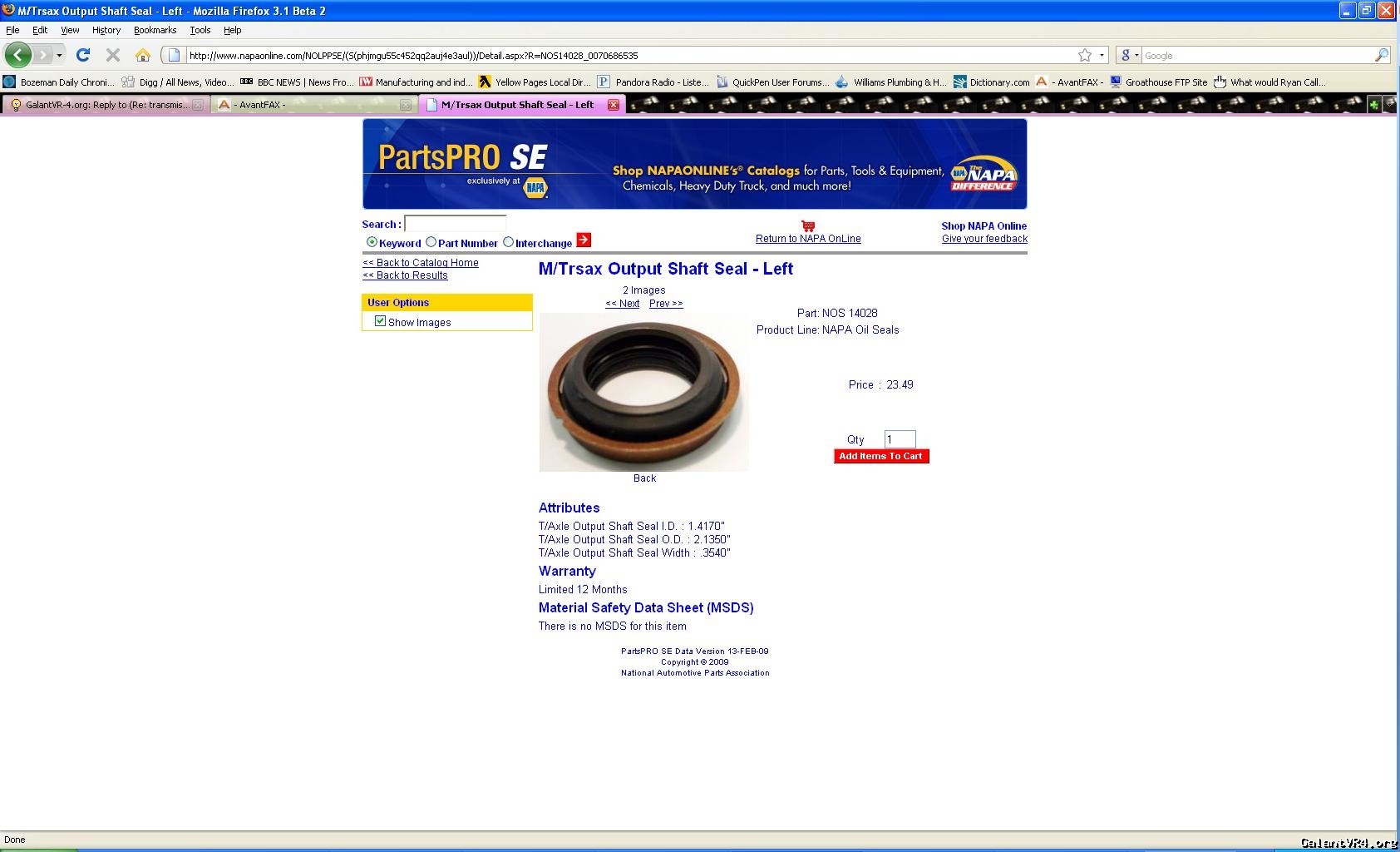

alright, just what i wanted to hear! it looks like there really shouldn't be much of a problem (famous last words!) as there is plenty of room around that seal now. gotta love 6ton jackstands right? so does the metal ring/flange around the seal come out too or does that stay in the tranny? its red in color and i couldn't tell if it was part of the seal or not. as always, thanks for the info guys!

That driver's side seal is pretty easy. The metal ring around it comes out also, as it's all one part. That ring also makes it easy to install, since you can *carefully* pound it in until that ring bottoms out. No worries about a crooked seal. Make sure the little hole in the dust shield part is at the bottom or 6o'clock position.
The axle seal you have to make sure to install straight and not too far is the passenger side.

perfect. sounds like that will be easy to do. i will order one today. 324/1k should be running this week if there are no more hangups! its been a long time coming, i can't wait!
