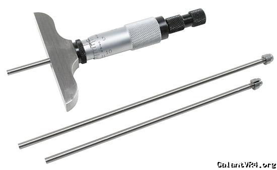

In my experience, a dial indicator and a fixture as seen here: RRE Flywheel Tech is easier to use than a depth gauge. There isn't a good a large flat reference surface on our flywheel to put the plate of a depth gauge against so you might accidentally rock it and mess up your measurement. $0.02
If you are using a depth gauge like this, there should be no rocking whats so ever.
