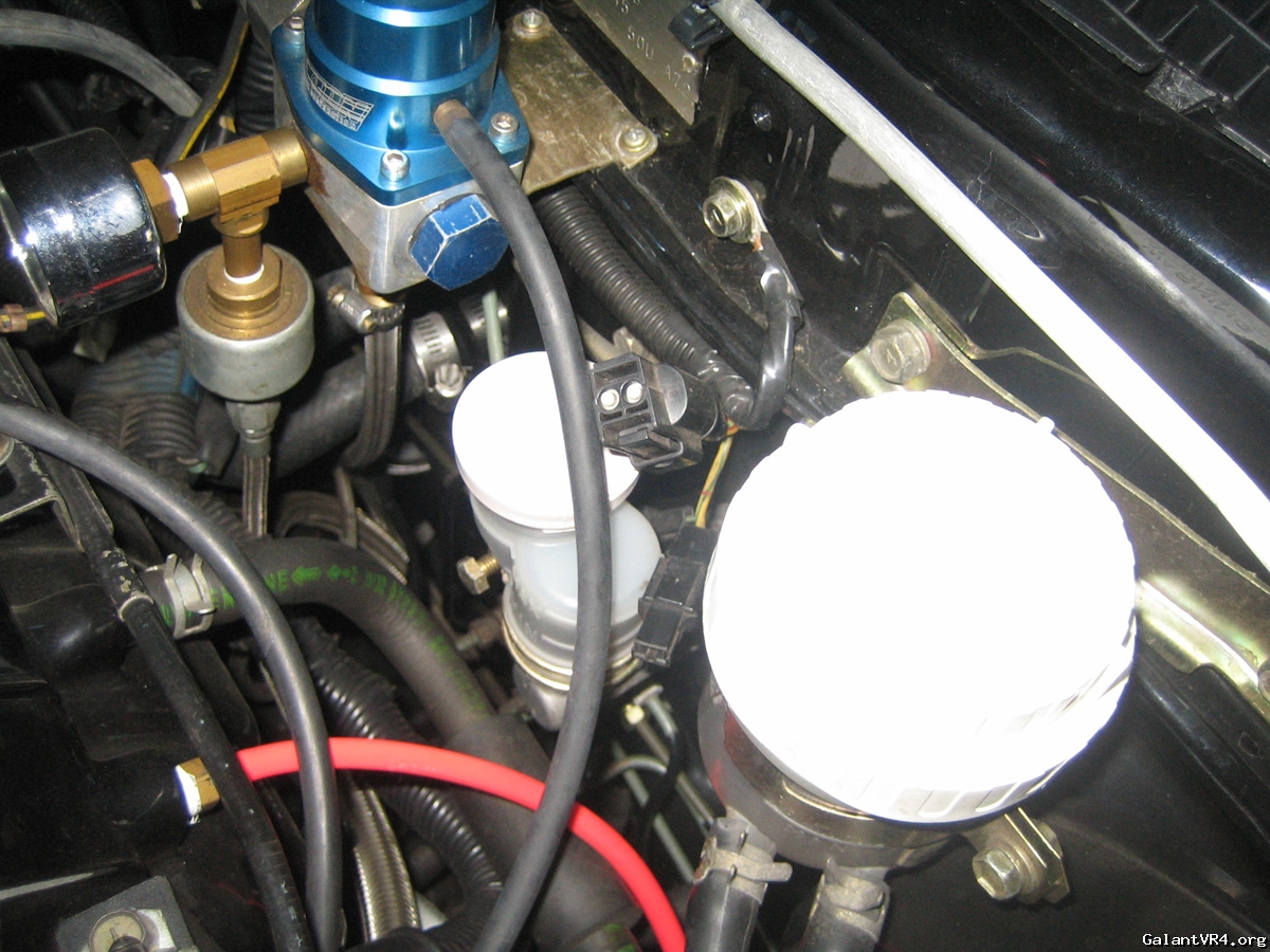

i was wondering if some one could send me a pic of the ignition-timing connector this pic doesn't really help to much,also which side of the connector would i need to ground to trick the computer so i can do base timing?

That pic doesn't help? It has a big stick pointing right at the connector.

the way I remember it is "thumb-shaped". Your thumb should fit almost perfectly over it. Plus there's only one connector in there. I suck at spotting it visually on a jpg /ubbthreads/images/graemlins/smile.gif

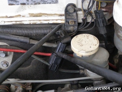

Is this the same plug?
It is yellow with a green main stripe and red little stripes.
When I grounded this and started the car I blew my 30A fuse for the ignition.

That is the fuel pump test wire. It allows you to test the fp relay or if you put 12 volts on it you can bypass the fp relay and the fuel pump will turn on.

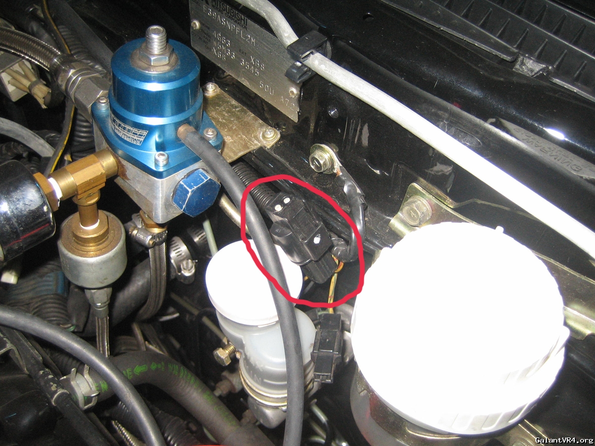

Holy crap! Look at the pic in the first post. There is a huge black rod (/ubbthreads/images/graemlins/hsugh.gif) pointing right at the connector! (The lower one)
This is the connector, circled in red:
It is almost oval shaped, with room for 2 pins in it, but there is only one small pin inside when you remove the dust cover.

OMFG...with closer inspection I found the culprit hiding within the loom /ubbthreads/images/graemlins/banghead.gif
